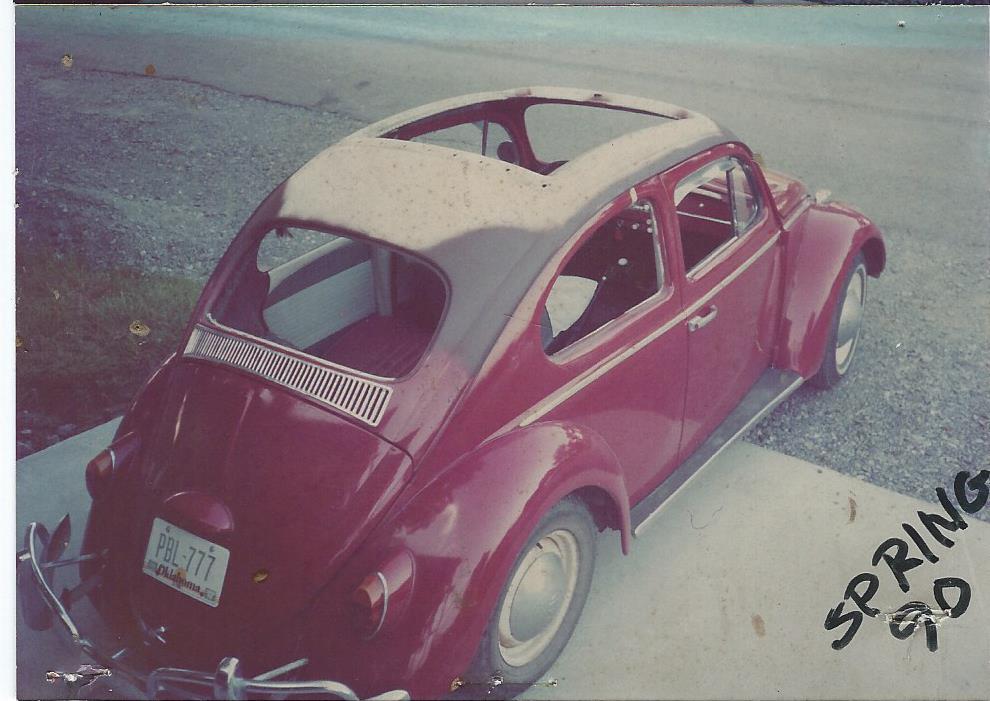

To start, I got my 64 Sunroof five years ago for $750 and it was painted like Herbie. The floors were fiberglass’s over and it had major issues and no title, but I was eleven and I was excited for it still. I got it running the first day I had it. It still has the original engine but has a later transmission. Here is it now
Then

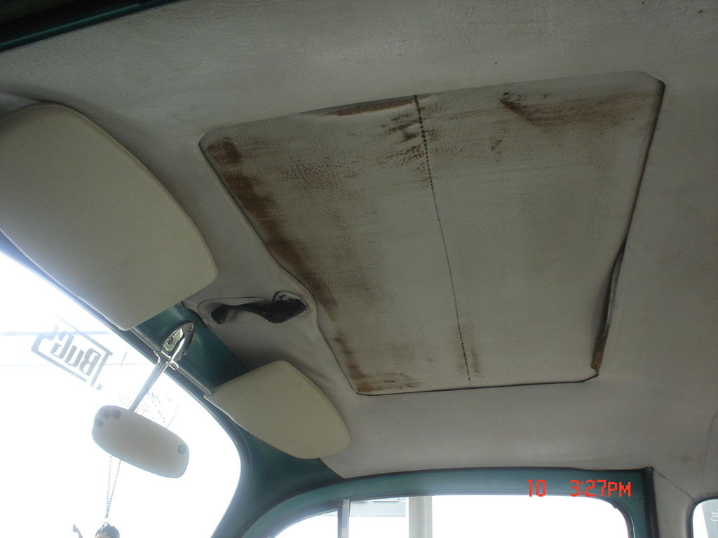

I always believed the 64 had unique sunroof crank handle and scratch guard and some of the sunroof mech parts.
The guard was more triangular shaped than the later ones. Seen here.
Later ones seen here
The cable guides and covers also seemed to change as some point. My 64 was unmolested when i re-did it 30 years ago and I remember parts that exactly match what i found on my bug in the sunroof area were hard to find.
The other curious thing was seat belts. Not sure when they became standard but my 64 had inner and shoulder factory seat belt mounts but no outer. Both sides missing. Thought maybe that was new for 64 and my bug was using left over 63 parts??? That always puzzled me.
My 65 parts car had the trianglular, wasn’t sure if mine was of not since it had lots of later parts.

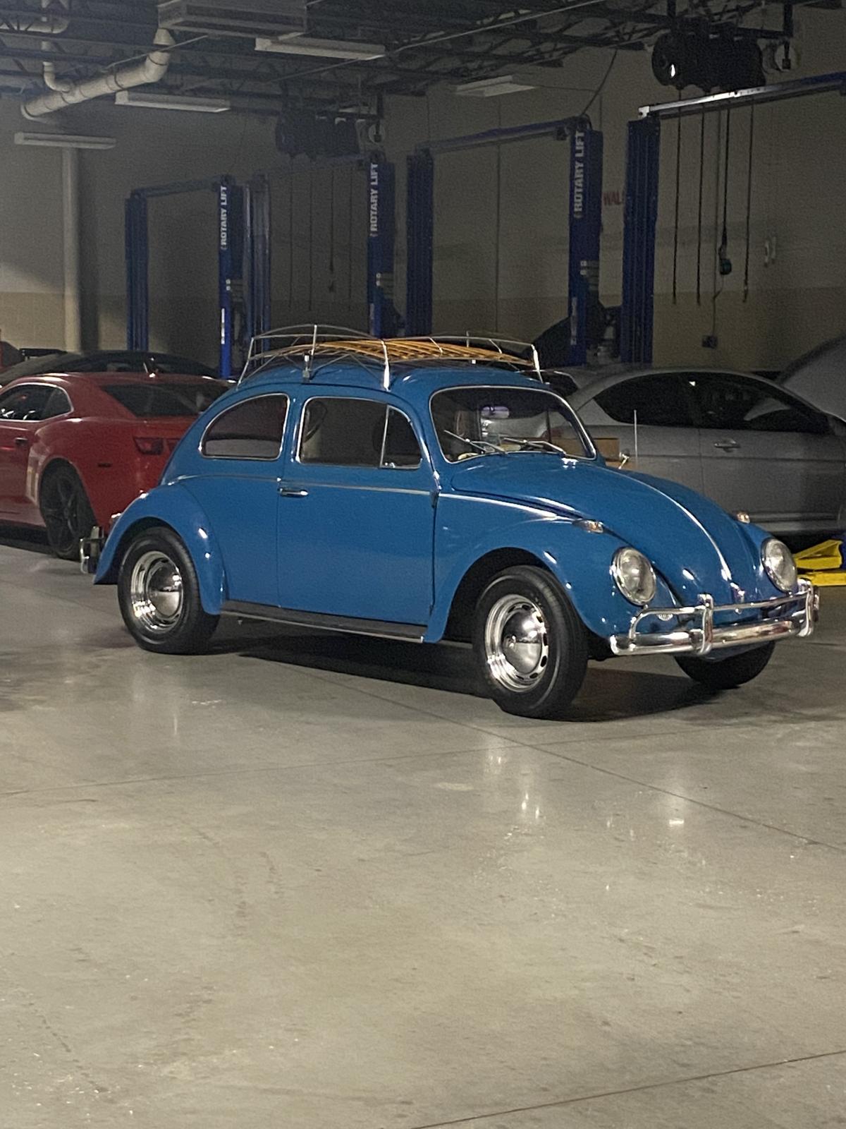

My old Oct 63 bug. Still had the peanut front turn signals and the small license plate light. It is a 3 month only lid with the later straight pressing with no 'semi W' past the light and the small bolt pattern light housing.

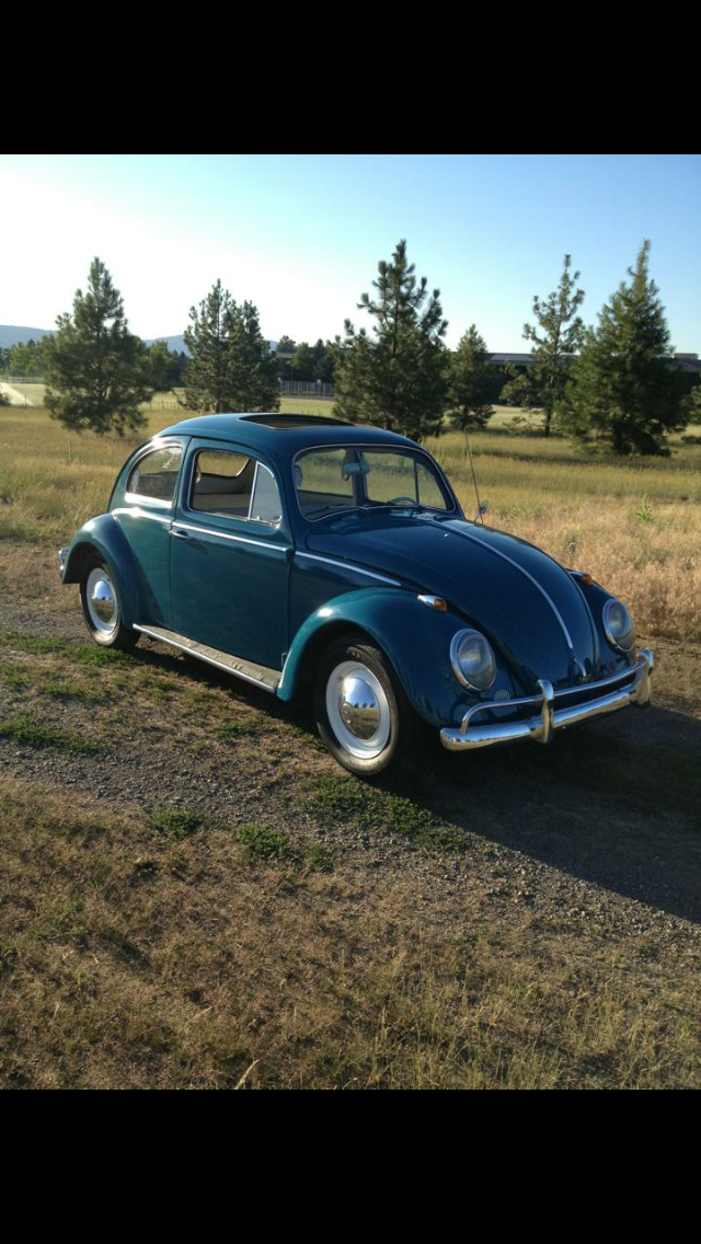

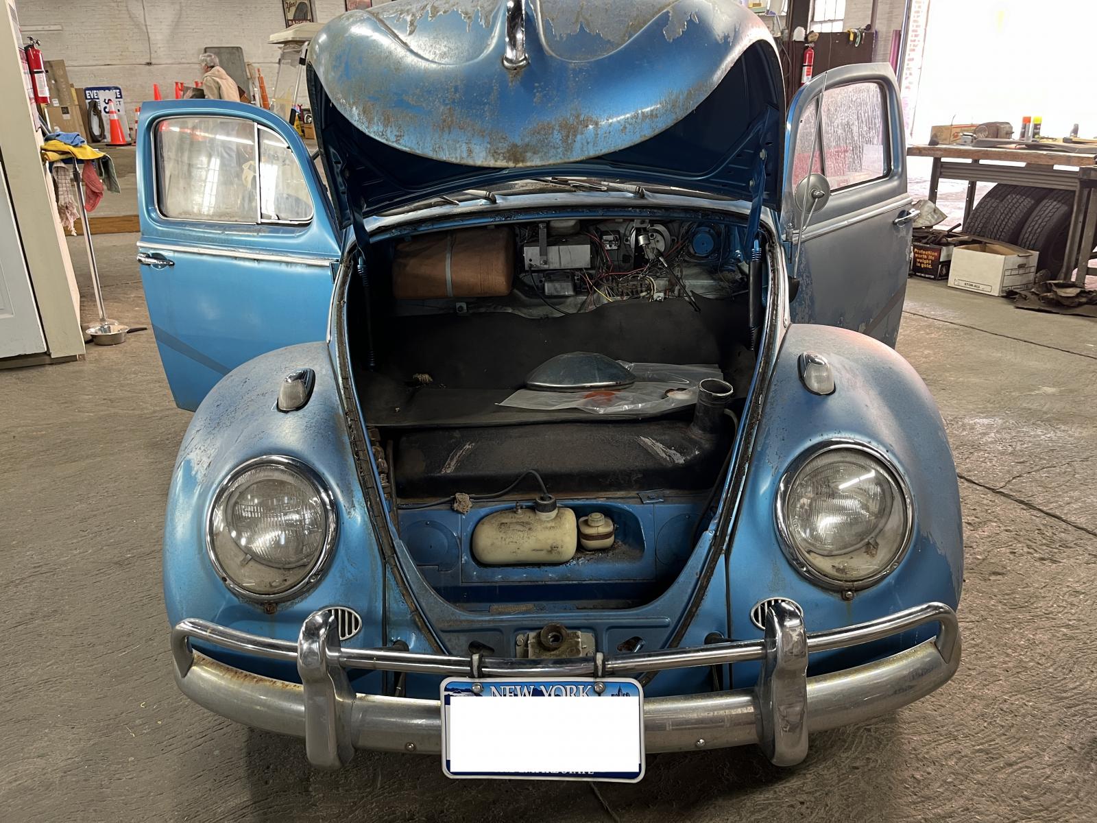

My 1964 sunroof that my grandfather bought in 1964 (European delivery to a US service member)...date of manufacture July 1963...I’ve had it for 30 years...original headliner and original seat covers completely intact...unfortunately I had a different rebuilt motor replacement installed in 1991...126,000 miles had 99,000 when I bought it from my grandmother in 1990...

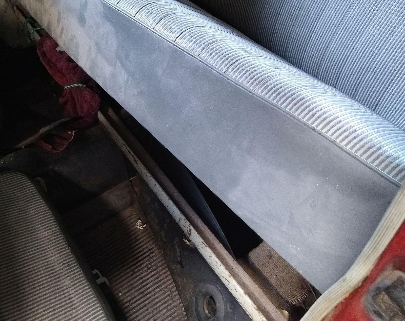

Unfortunately, it's not road ready yet. The only working brakes are the ebrakes. There's also a few other things I need to get fixed before the road (like the hole in the left front floor, lol.)
Here's a couple more interior shots. Yes, the seat covers are original, but they're in rough shape. I need to pull it out and begin cleaning the interior for better shots.

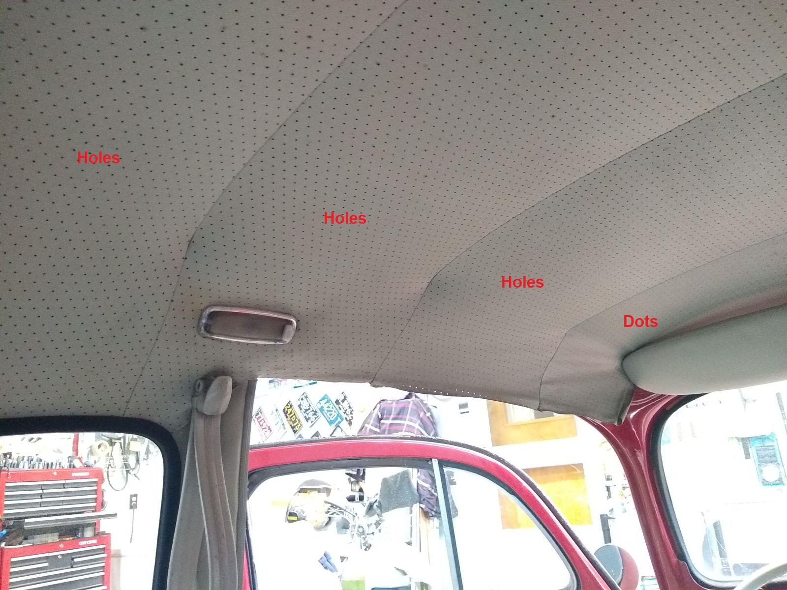

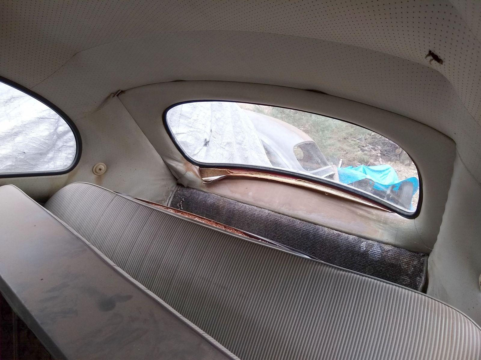

Gerb, Nice original interior. Mine rear seat is nice but fronts are a wreck.

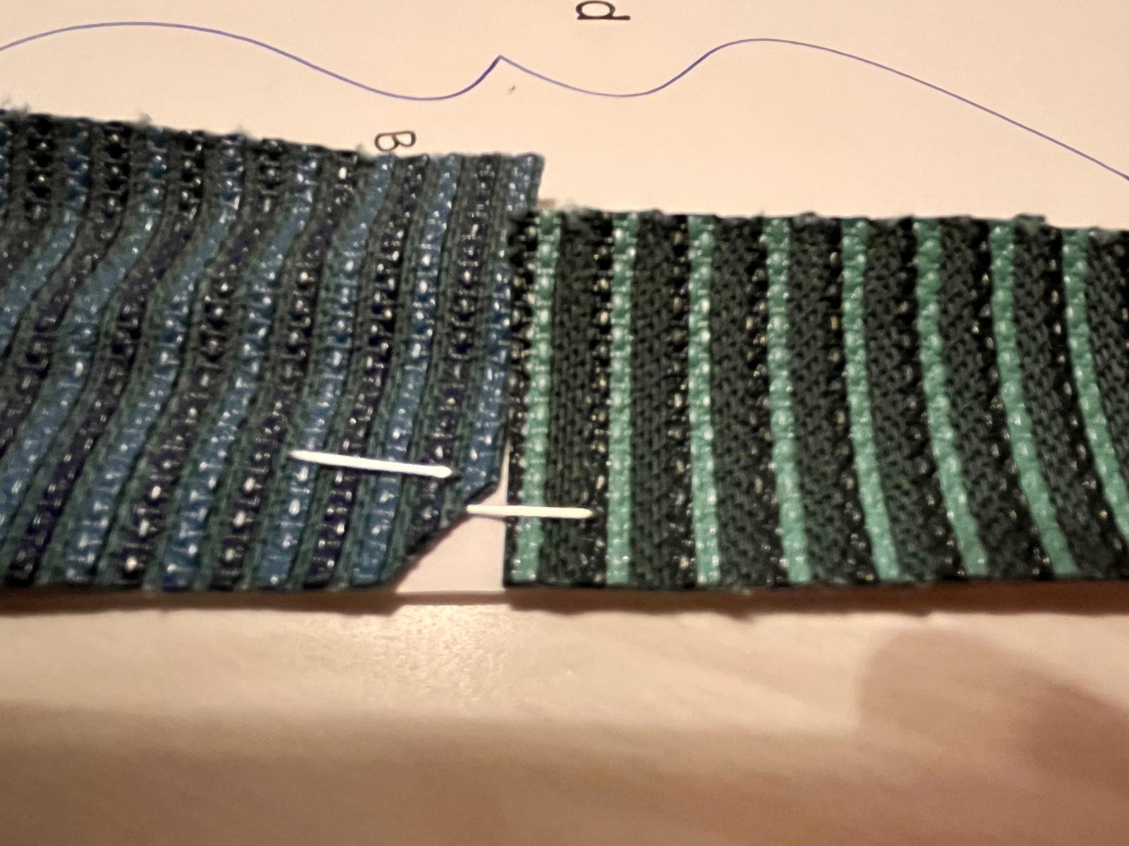

Some Q's.
- Can you post some more images of the seat covers?
- Also on your headliner is it a mix of painted dots and holes or all holes? Where is what?
- Is the rear window headliner panel one piece or two? Is it sewn (upper to lower) around the window or are the seams in the lower corners glued? If glued which panel is on top?
Thank you.
Some Q's.
Thank you.
- Here's a few more pics. Fronts are not good (I pulled the shirts off the backs for these pics); rear really isn't bad.
- Headliner has painted dots and holes (see photos)
- Rear window is once piece over the top and sides, with angled seams at the bottom corners. I'm not sure what's glued and not glued.
Thanks,
~gerb (Todd G)
