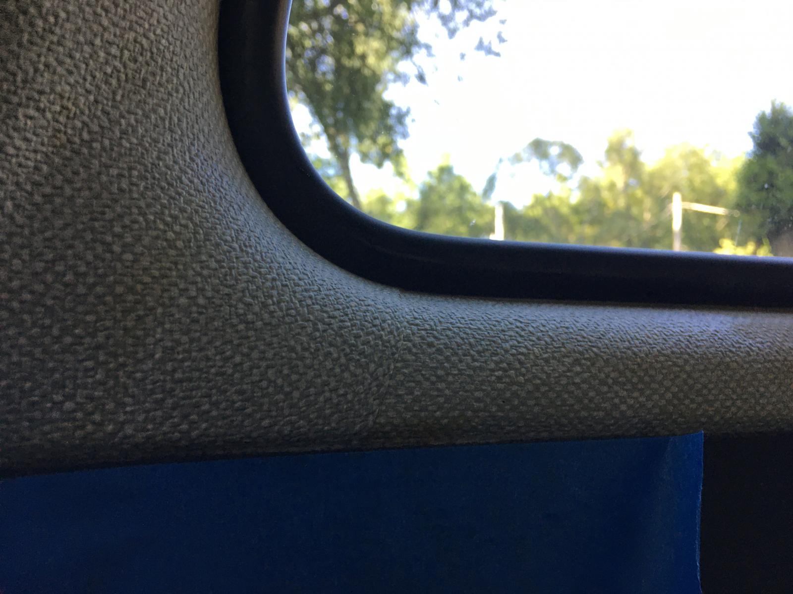

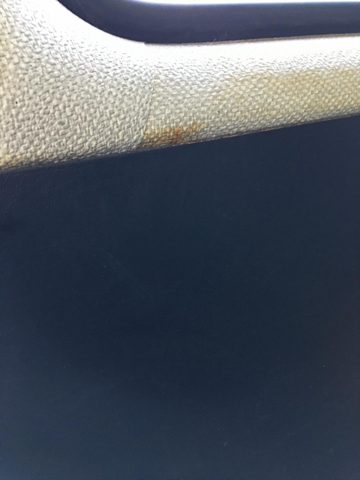

I think I have found an effective way to at least lighten the yellowing glue in our vans. tape off the area around it. It is peroxide and has a bleaching effect. Apply fairly liberally. I used a tooth brush to work it in a bit. Let it set for half an hour or so. Don't let it dry. Don;t put plastic over it. Wear gloves. Wipe off with soapy water. This stuff is cheap at sally beauty.

Huh. That looks pretty good I’ll probably try it why not? Might work on the tobacco staining too. Thanks for posting.

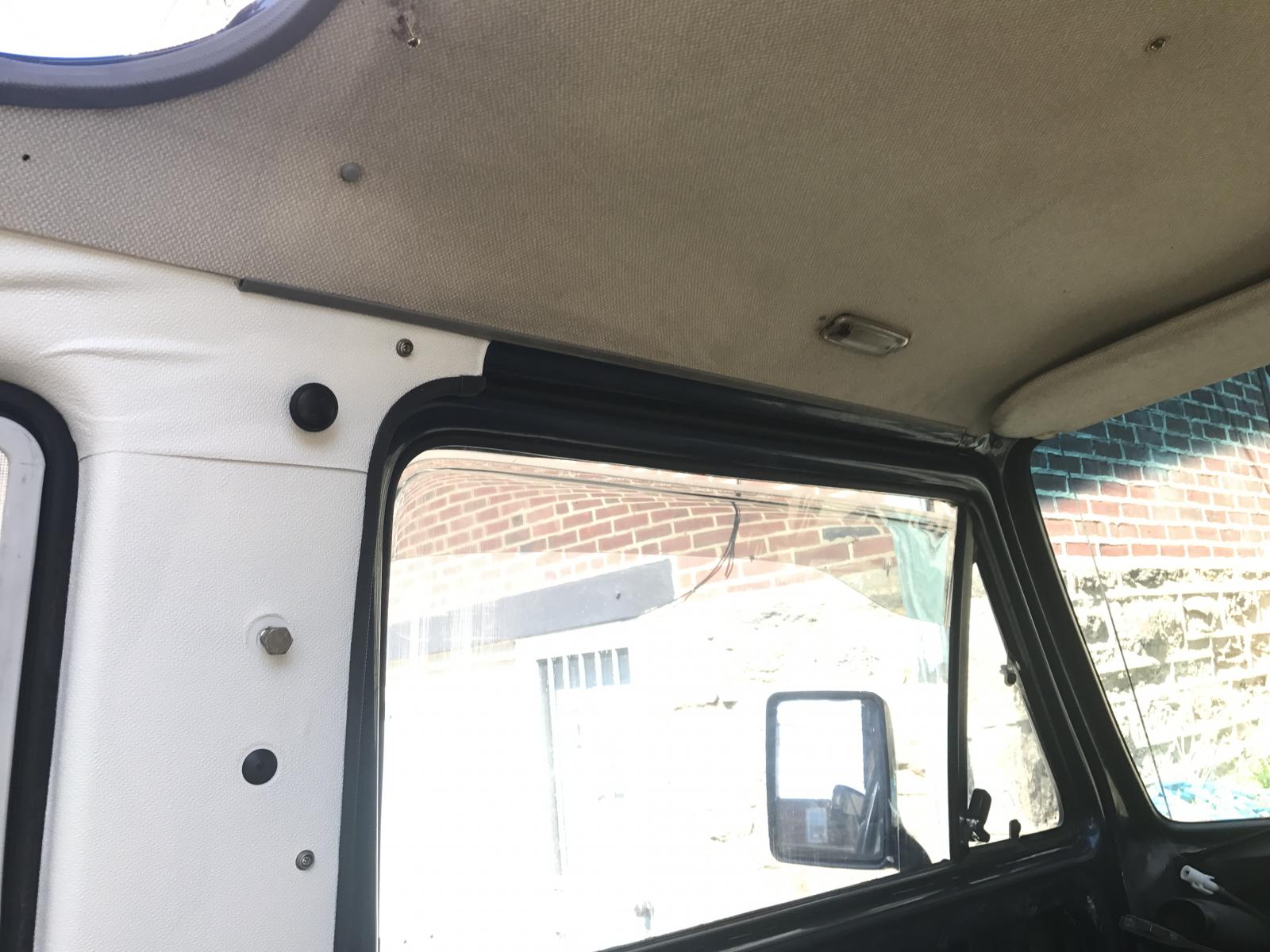

I had great luck using SEM vinyl dye spray on my headliner. 5 years ago I masked and sprayed the headliner and it looks brand new. I also picked a much lighter shade than the grey and made it offwhite for a serious increase in the roominess "feel". At night it also takes less lumens to brightly light the interior up.

i used SEM Super White 15103 - its a bit brighter then the OEM two color, but with all the curtains in place, it brightens it up inside.

I posted the color in my "how to" thread. If you can't find it in the next couple hours, I'll go out to the garage as I think there's a remnant there. And the color would be one I'd unhesitatingly use again. I put some time and thought and samples into my thinking and feel I nailed it.

15103 Super White. There were several "brighter" whites than this one.
