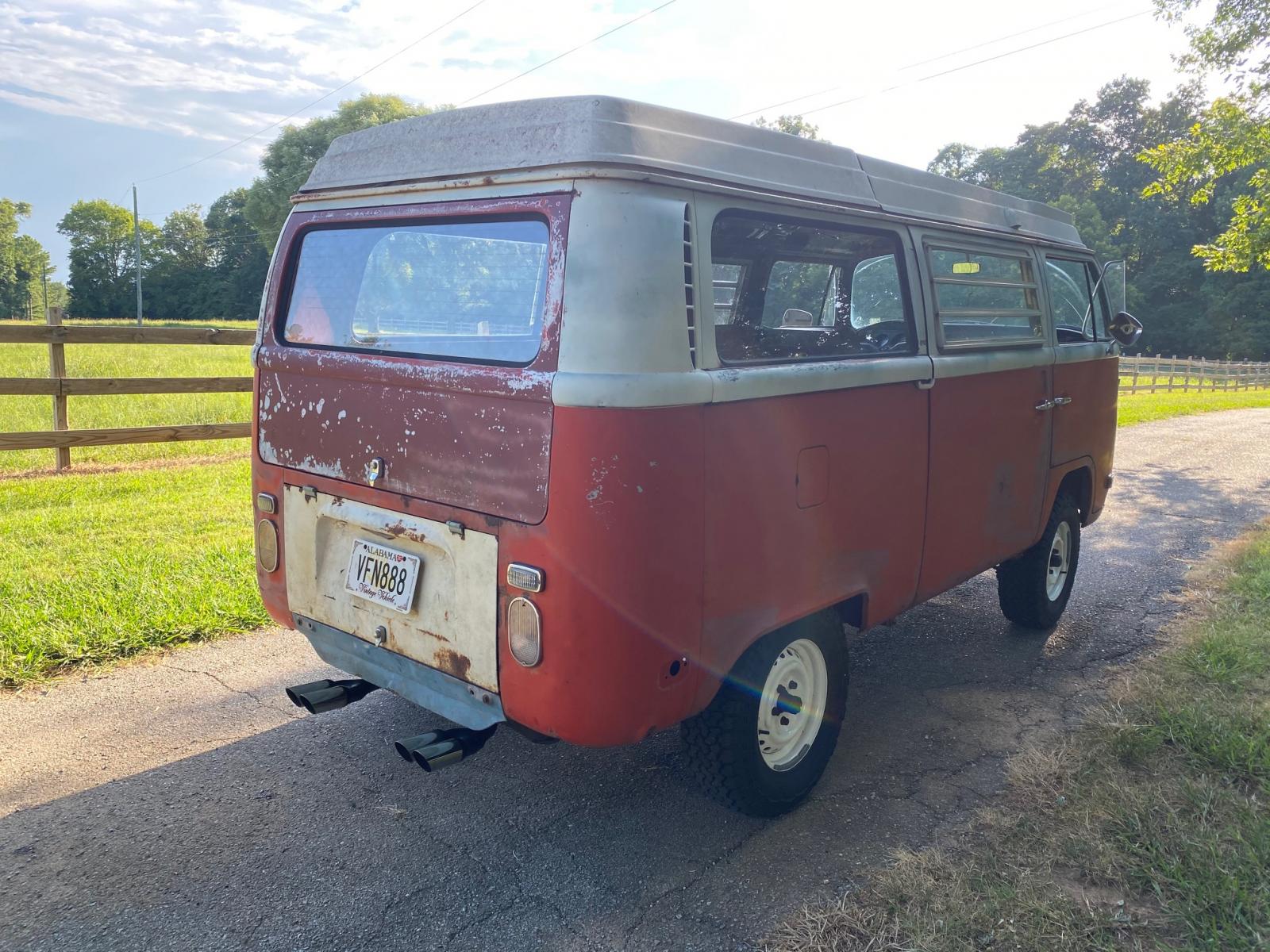

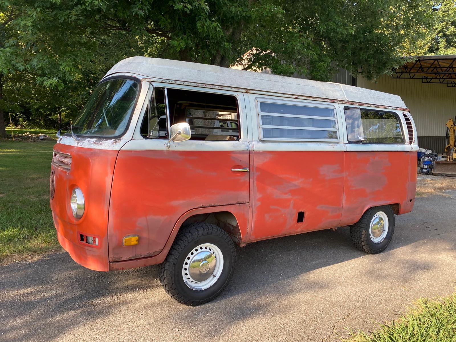

I thought I'd start one thread for our build, and just keep adding to it over time. I need to back up to March 29, 2018 to start the story.
We found Helga in the same spot she had been for the last 8 years: sitting in a suburban driveway in South Huntsville, AL. She was owned by a VW enthusiast family, but she hadn't seen the road in a very long time. The family was liquidating some assets, and we were lucky enough to rescue Helga.

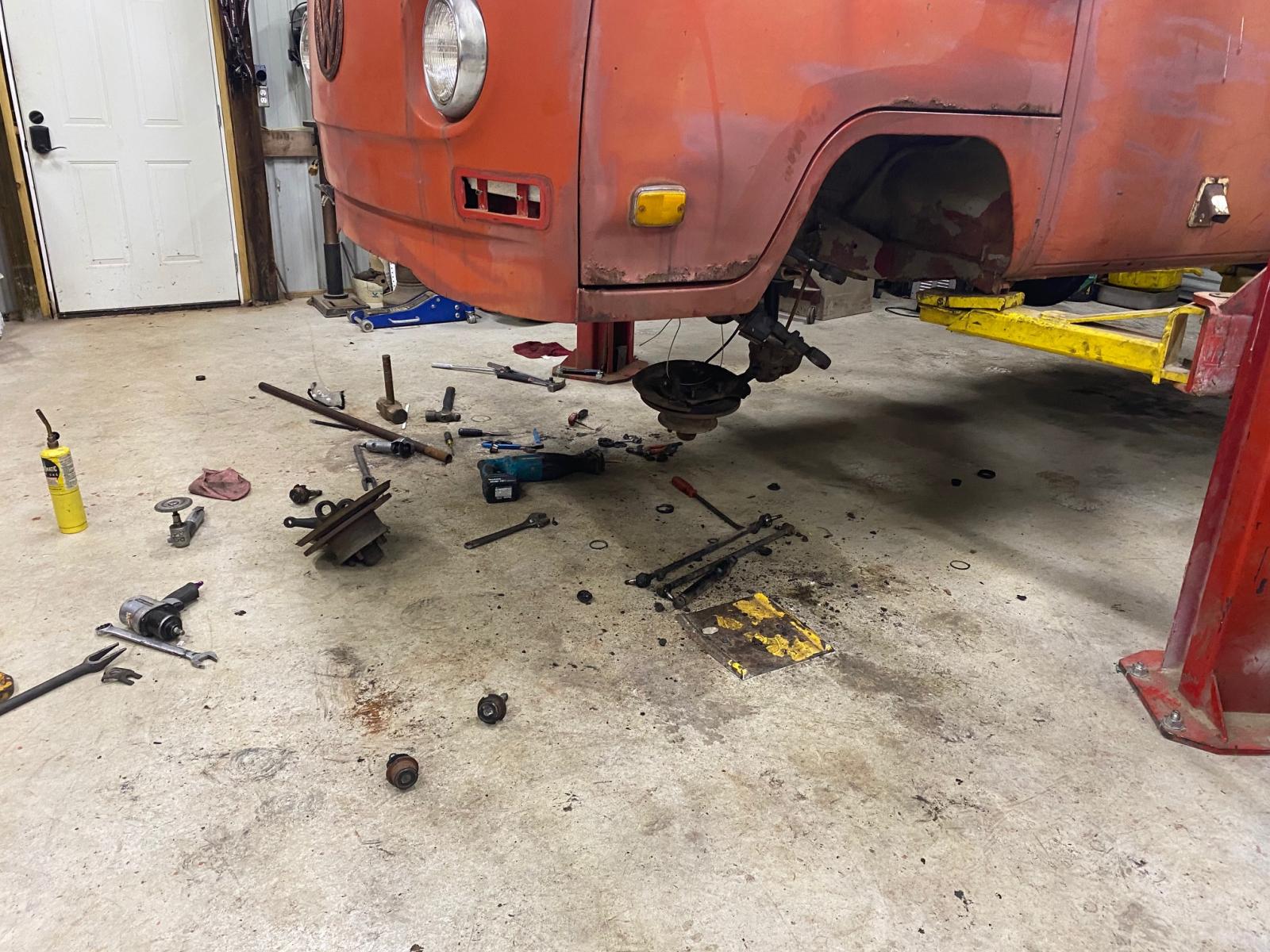

The rear brakes were locked up, so that was our first task. We rebuilt the brakes and installed new wheel cylinders.

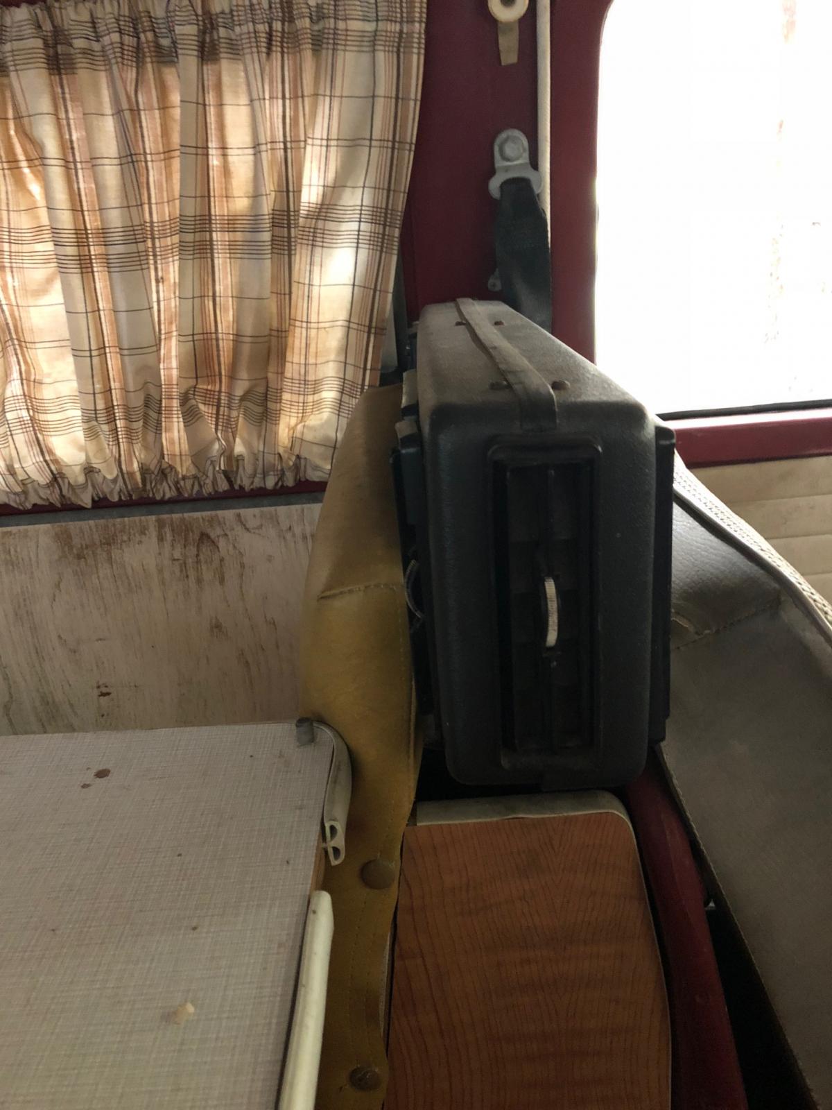

This bus was equipped with air conditioning. It was complete, but obviously had seen better days. We carefully removed all of the components. I may restore them someday, but they are just in the way at this point. I tried researching, but never really found a condenser / air handler like this one.

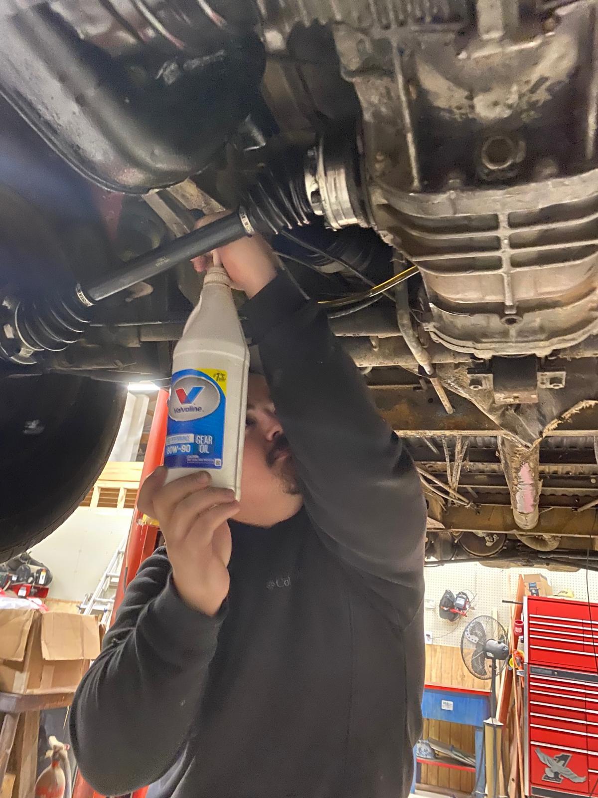

With the AC out of the way, we turned our attention to the transmission. The CV joints on the axles were in pretty rough shape, so we installed new ones. Drained the transmission, and found the fluid to be pretty decent. New fluid pumped in slowly...
It looks like someone has already replaced the coupler.

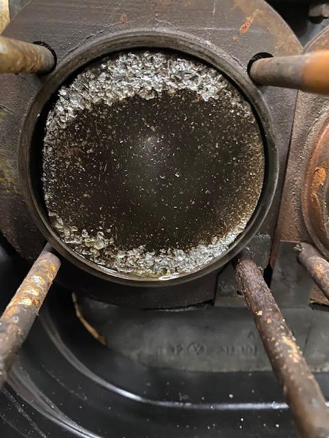

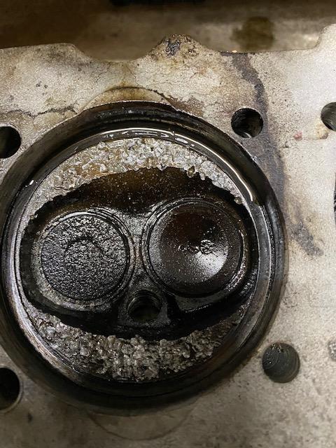

Tuned up engine didn't run any better. It smoked bad. After giving up on it "eventually clearing up", I took compression reading. (I know, should have done that day 1). Cylinder three showed zero.point.zero. Hmm...
The engine comes back out, and we start tearing it down. Pull the jug to find a melted piston. It all starts to make sense why this bus had been sitting...

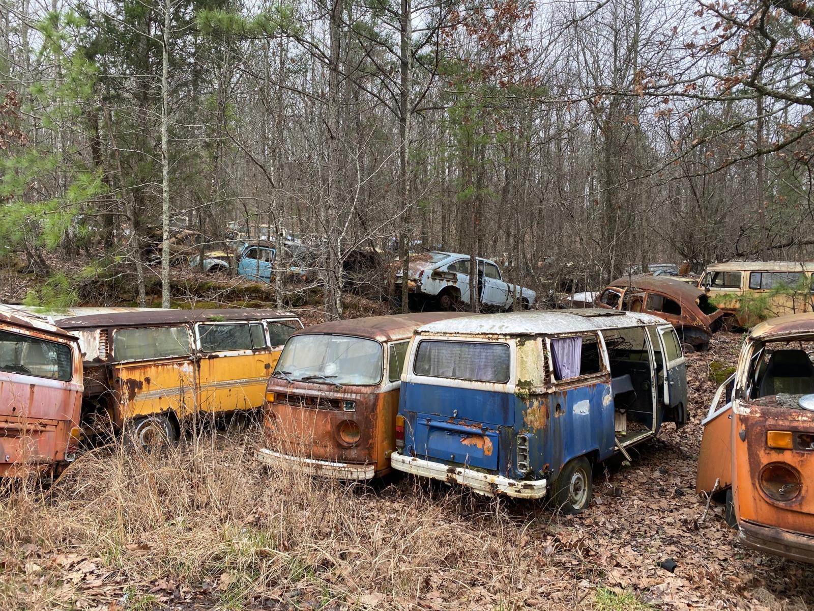

We learned about a VW graveyard about 100 miles away, so I made a trip to see if I could find a rear bumper. I met a neat old guy that has been doing VWs since the 70s. All his cars are scattered over a few acres of woods. He let me wander around and collect what I needed. I found a serviceable rear bumper, a good rear apron, the correct rear foam pad, and a nice set of hubcaps. We plan to go back again next weekend to see what else we can find.

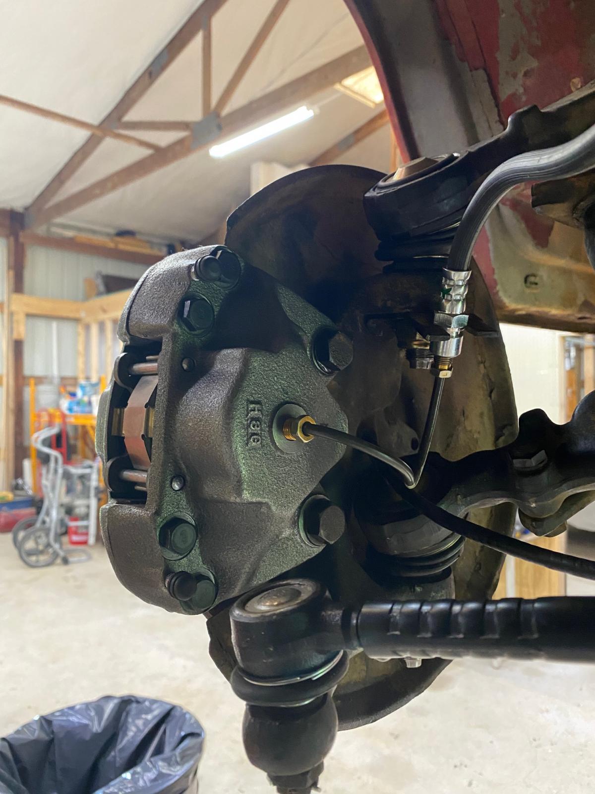

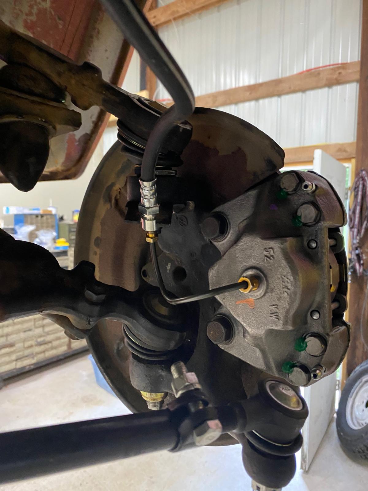

My original goal was to make the bus reliably roadworthy. I wanted to restore the mechanicals underneath first.
Rebuilt rear brakes
Installed new rear axles
Serviced Transmission
New shocks on all four corners
New ball joints
New tie rods
New front brake calipers
Adjusted steering box
New shifter bushings
New vacuum booster hoses
New brake soft lines

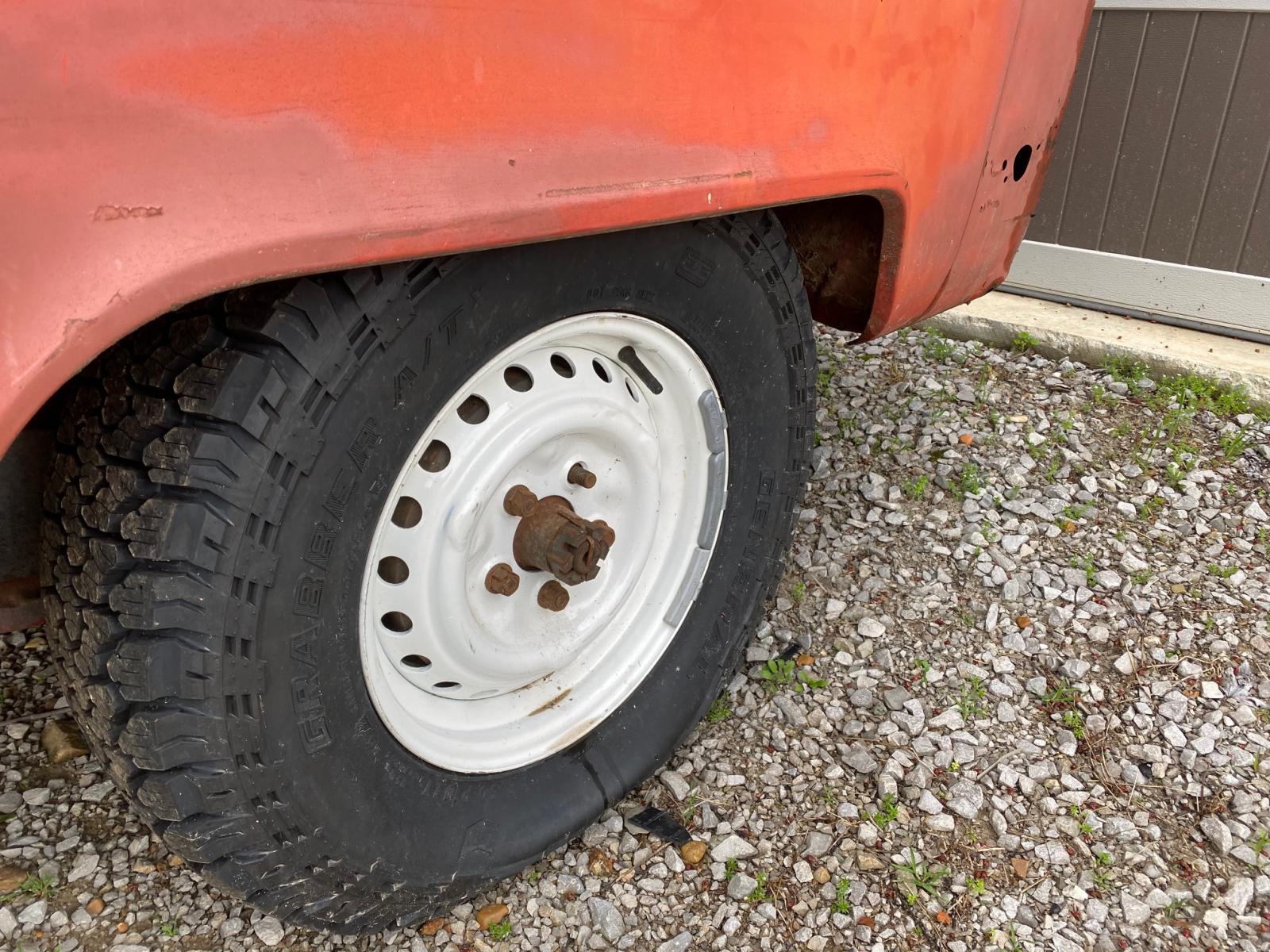

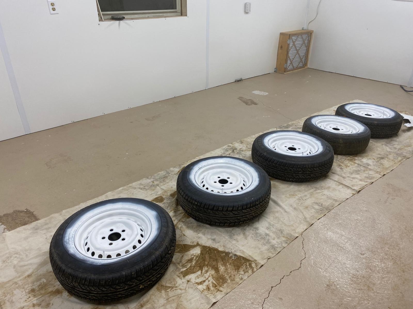

Cleaned and painted the original wheels with White Tractor Enamel.
Then mounted some Grabber Generals. This one didn't want to hold air initially, and had to be reseated. The old wheel had some crud around the bead that needed to be cleaned.

Nice bus! I have the same AC unit in my bus. Here is the link to its installation Manual. https://www.thesamba.com/vw/archives/manuals/9_71_campmobile_ac_instructions.php The compressor setup is slightly different than mine, but thanks for posting a picture of the underside of the condenser! Someone hacked mine off so it’s nice to see what it should look like. The bus looks solid, very good starting point for a project. Good work so far, keep it up!
Edit: here are some pictures of mine

Nice work, replacing the York compressor with a Sandan unit improves AC performance and reduces HP loss.

I have one of those evaporator/ air handlers also. They were made for about 1971- 1973 Westys only. I haven't got mine operating yet, but since we both live in the land of perpetual humidity, it's something that is increasingly important, especially as we age. There is a very helpful thread under Bay Window FAQs called "Installing a DPD air conditioner in a bay window" by 69 Bahamayellow that is very informative.
The York compressor belongs in the trash, but keep all the brackets, etc., For possible further adaption. The York compressor uses so much power that it is essentially unserviceable, but a modern Sanden compressor is the solution.
I like your version of the condenser under the bus with the fans at the end, it tucks up better, more ground clearance. It may benefit to a change to a modern parallel flow condenser.There are those who know a lot better than me, and Gilmore enterprises gets good reviews about their air conditioning prowess here.
