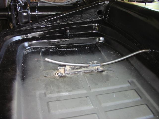

As I was redoing my floor pans, I was totally unaware of the tubes that the cable rides in going to the heater 'y's. Mine did not have these tubes and I have now sourced them used from the classifieds. As I read up on this, it appears they were tack welded down to the floor pan. I really do not want to have to strip a section of paint off the interior and exterior of the car to do this tack weld (plus my welder is out of commission at the moment) and then recoat, etc.
My question is this - since this is a non-critical mechanical item (i.e. not related to safety or general functionality of the car) would JB Weld hold the tubes down adequately at this point in the job?? Any other options to consider that I haven't thought of?

Using JB Weld to secure them may or may not hold up over time. There is enough potential for flexing of the tubes and/or the floor there (plus kicking / heel loads from backseat passengers) where the JB Weld could just "pop off" one surface or the other, eventually.
An alternate option to consider might be to source or fabricate some brackets which could be set over those tubes and then screwed or bolted to the floor, to hold them in place.
Ultimately though, this is likely a case where if you want those tubes to work correctly and be reliable in the long run, welding them to the floor (as was done at the factory) is probably your best bet.

Baldessericlan, I see your point. The best would be to weld it down; however, Tim has a good point - here is South Ga it doesnt get bad cold and it may not be worth it. I am kind of a puridt and wanted things properly stock, but this one doesnt seem worth it. I know I dont want to pop holes in the pane, so it is either JB weld or any other good ideas or nothing. Will think on it some more. Thanks for the thiughts

I would weld them in properly. Right side tube is welded to the battery mount, not to the floor. (You do have the battery mount, right? That is sort of critical to preventing the battery from becoming a projectile in a rollover.) Left side tube is welded to the floor.
There is not enough surface area on a tube to glue it to the floor and expect it to hold. But, you could weld the tube to a metal tab, then use panel adhesive to glue the tab to the floor. I wouldn't glue in the battery mount.

Good feedback here. Q-dog, I hate to admit it, but my car did not come with a battery mount (that whole section was rusted out and a piece of roofing tin was riveted in there by the PO. I properly fixed the pans and they are solid; however, I failed to realize there was a battery mount there. I need to think on this a bit as it appears for a proper repair welding would be the only way...
On the other side, I like the idea of welding the tube to a wider footprint plate and then using panel adhesive to hold that down...that may be a good option over there if I decide to fix the tubes in the first place, which I am not sure of.
