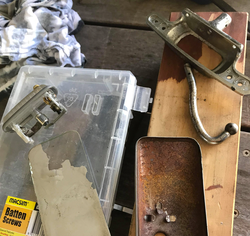

Luckily I had an old dental tool called a "bone scraper" which I used to slide down the side of the glass at one end and gentle prise the glass out. That worked out OK so it was game on...

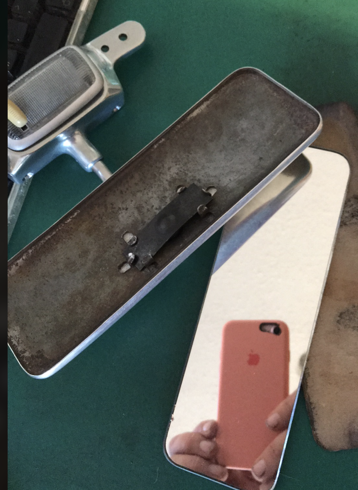

The glass I knew could be re-silvered here in Sydney for about US$70 at a specialist glass centre, so I sent that out to be fixed. There was a kit available in the US called "Angel Gilding" that allows you to resolver glass your self, but the kit was 200 bucks + so I gave that a miss.

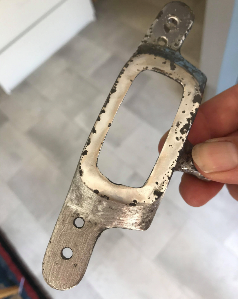

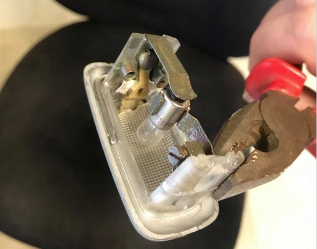

To start off I drilled out the retaining pin at the top of the shaft (corroded in place) and pulled the mirror assembly apart. As I did that I dropped the plastic lens for the light and that broke into 4 pieces , so I had to fix that first using a bent paper clip and some epoxy. To blend in the cracks from the repair I lightly sanded both sides of the join and spray painted around the edge to match the finish of the original...

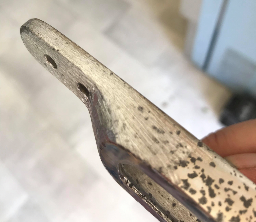

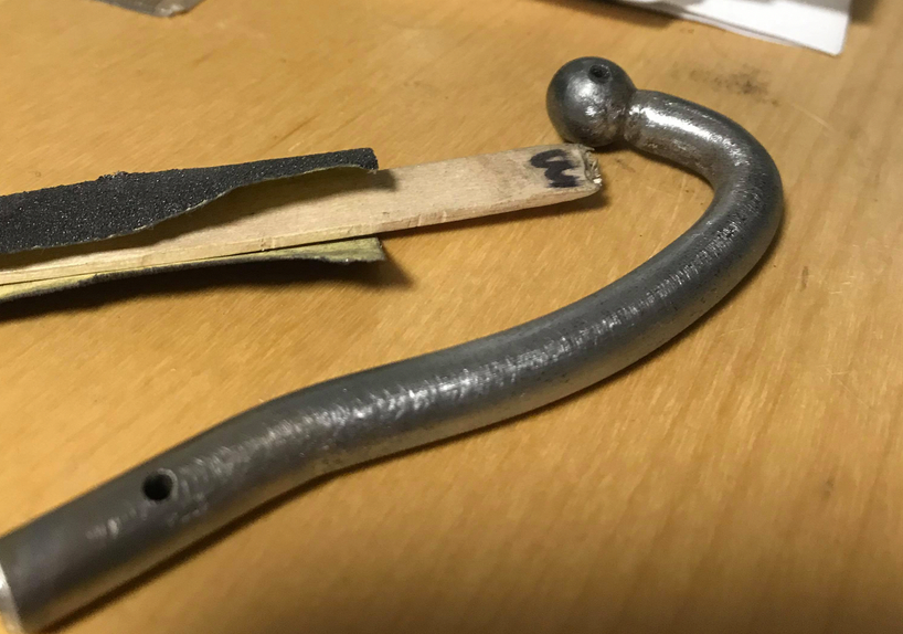

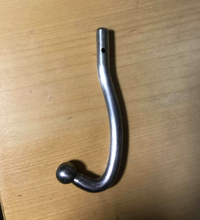

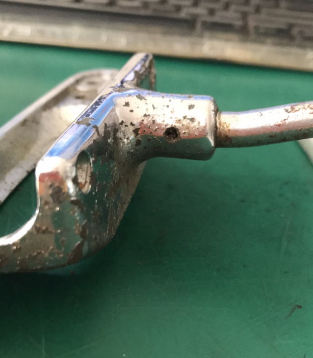

That seemed to hold together OK, so I had a good look at the state of all the parts. It seems the surface corrosion on all metal parts was not only making a bumpy surface but also making pitted holes in the surface. The shaft itself seemed to be the least affected so I rubbed back the surface on that with 120 grit sandpaper on a small stick, then used 400 grit and polish compound on a Dremel...
The back of the mirror had lots of deep holes so I methodically worked up and down the length cutting into the surface to get rid of the black holes using a Dremel 60 grit sanding wheel using circular movements. I used 120 grit on a sanding block to clean up the finish and circled in red that still had scratch marks from the Dremel wheel, I then progressed to 400 grit on a block...
The main body was worse, the holes were really deep! I used the same method as before as before but worked on each section as a plane so I did not make the surface all lumpy and bumpy...
Below, I've just finished the front section at one end and then I moved onto the curved section, all the time working the Dremel all over the plane and cutting down to remove the holes..

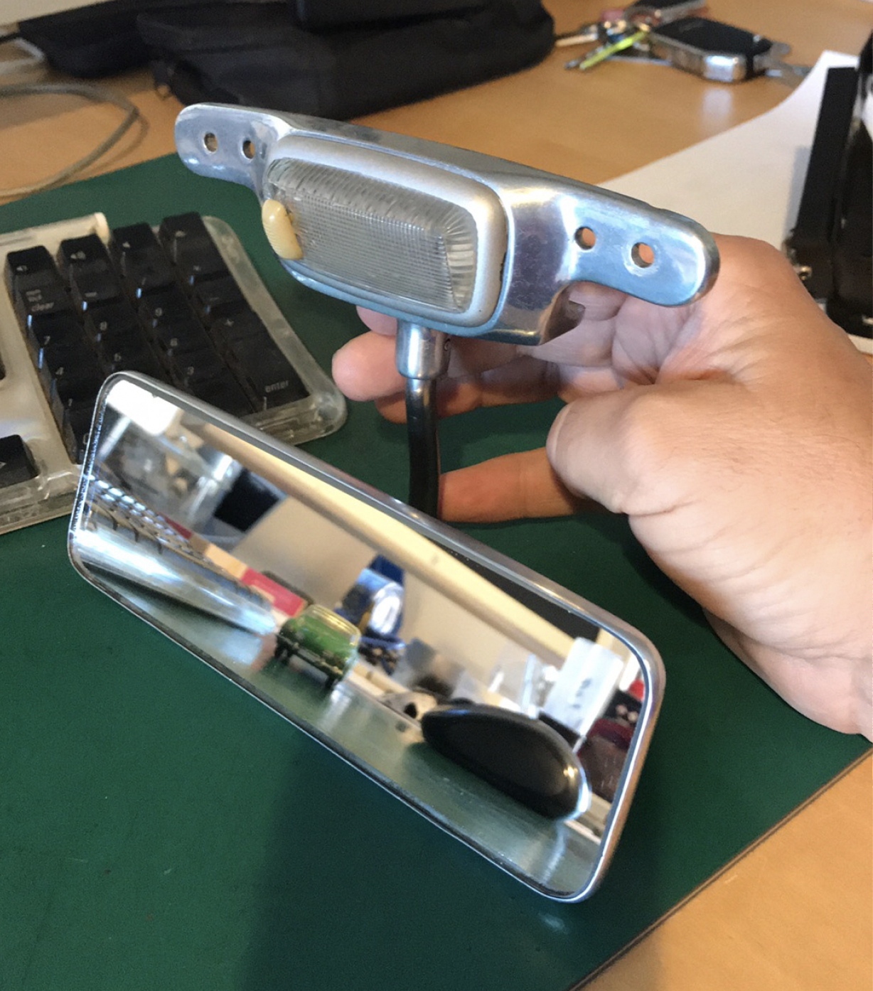

Working through to 400 grit paper again, I decided that the finish was looking OK and I'd just polish the steel rather than chrome it. The mirror back would not polish up well with Dremel polishing compound i just kept turning black so I polished it with Brasso and sprayed a Polyurethane finish to keep the lustre.
This pic shows the first attempt with the polish and some scratches and marks still showing, so I went back to 400 then 600 paper before polish again...
I swapped from the red polishing compound to a white finishing compound (with brand mops and brushes) to give the surface a nice bright finish, then also sprayed with a polyurethane spray to preserve the finish. I filed down a small bolt to back in as retaining pin when re-assembling. The fit was very snug so I'll just use a small spot of epoxy to hold it in place..

The glass came back today and re-inserted the glass gentle from one end (the same way I took it out, then press fitted the metal rim over the glass as hard as I could with my fingers.
I did think about a short tap with a rubber mallet, but erred on the side of caution (don't think it will eavesdrop out.
I've sprayed the polished metal with a polyurethane to keep the lustre sealed so I think i'm done.
Poor man's workaround I know (total cost US$75) but the money I saved on a repro can go towards bodywork bills!
New glass
Re-inserted:
Before and after:
