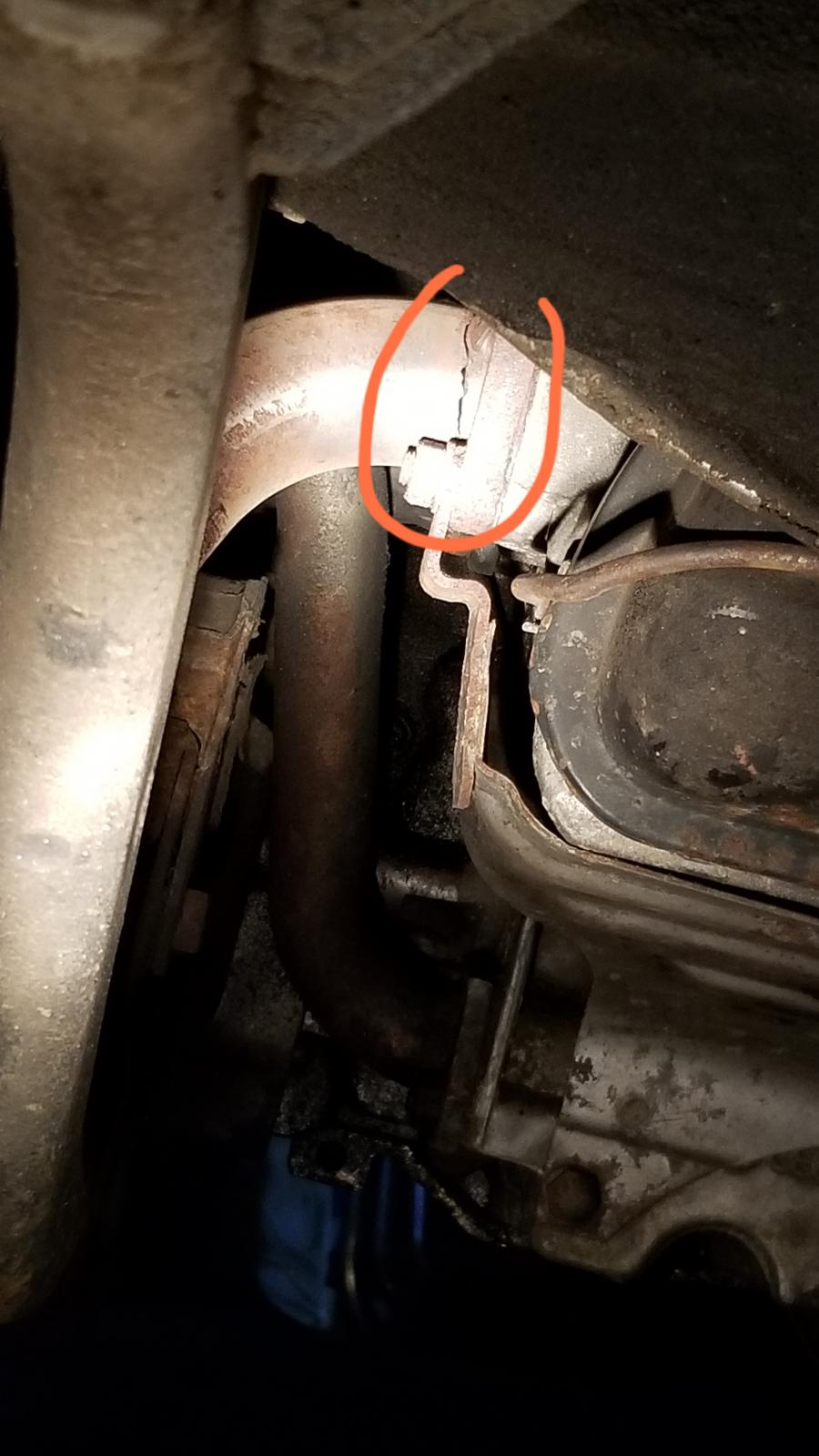

So when I was getting my brakes fixed, the mechanic discovered this.
Which cylinder is this for? The part is under 150 bucks so I doubt welding is worth it, especially if it would need to come out anyway.
Would JBWeld get me through until the new part comes?
Thanks for any thoughts or suggestions.

JBWeld will not work under that much heat afaik.

On my phone it looks like cylinder 2. It is totally worth welding the crack. It seems to be accessible installed. If not, removing it is a bit of a pain. Shipping on exhaust is expensive. Check CIP1. They are having a moving sale.

Sorry, I should have specified passenger side. Is that cylinder 2 & 4?
I also just found this which has got to be worth a try: https://www.autozone.com/sealants-glues-adhesives-...%20sealant

“2”

yeah, i'd try welding first. take it to an exhaust shop. an old one with a purple '69 Charger parked in front and the skinny guy with a mullet doing the work. it's the only job he's had since high school and he's rilly good at it!

Okay, but this is North Jersey so it's an 87 IROC and he's got slicked back hair, cropped on the sides with lines.
I can buy these pipes from Bus Depot for $150 shipped. You really think a weld would be much cheaper? I also can't imagine a blowtorch that close to my fuel lines, so these pipes would have to come out anyway, right?

It would likely be mig welded at an exhaust shop. A welder might TIG it. Low risk of a fire.
When you go to replace that simple exhaust and you snap a stud, you’ll really be wishing you’d have attempted welding it in place.
There’s an older thread. Owner tried this simple task an in the end it needed new cylinder heads and the van was off the road 6 months. He was head strong and went against advice.

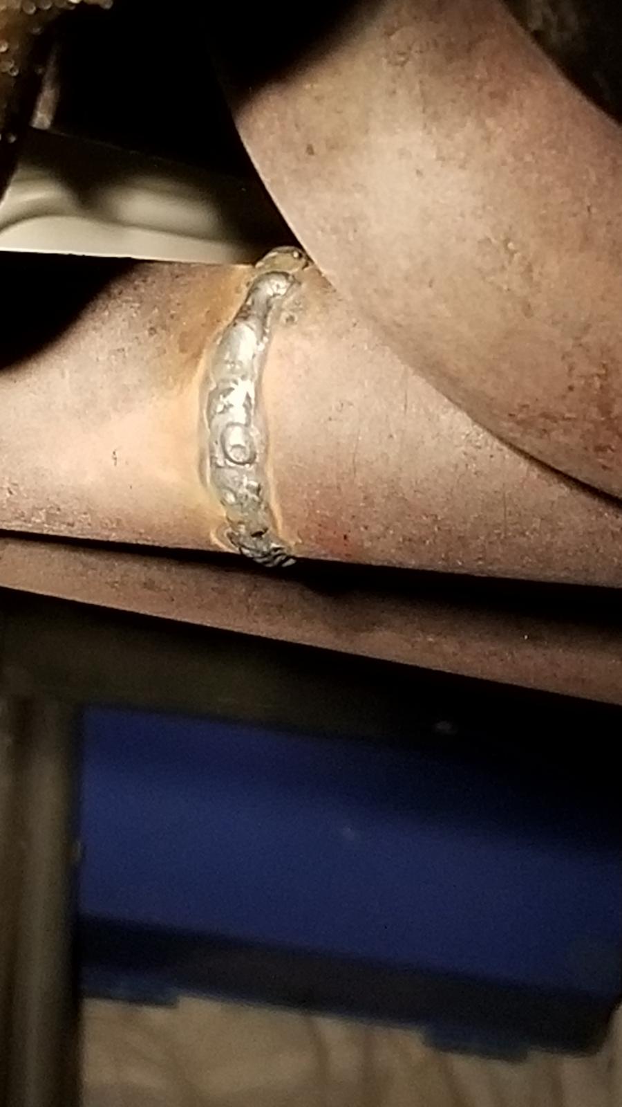

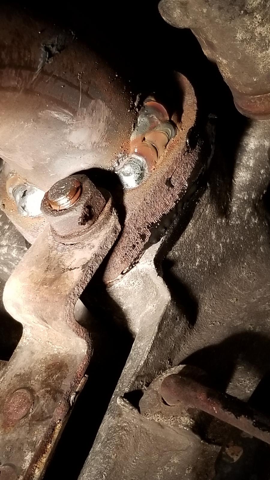

Closing loop: Meineke got this done for 200 bucks. I told them only to proceed if they could free up the pipe without cracking the stud. They could not weld in place. They cut the exhaust pipe on one side so only two bolts had to come out. They then welded the inside of the area near the flange in addition to the outside but only minimally to avoid blocking the stud for future removal. They did a good job as far as I can tell. The rig definitely sounds better now. Considering pipes and shipping would have been 150 alone, I'm happy with this result.
I'll try to post a picture later.

What I like to do is lay a full coat of weld bead over the bend in the pipe, this area gets really thin from the exhaust gases eroding the outside of the bend and in the long run the thin metal makes welding the crack ineffective as the thin metal will just crack again at the edge of the weld. I have had good luck with having a new elbow welded in so the metal if full thickness.
Clarification, please? Sounds like they cut the pipe at some distance from the flange, removed the cracked section from the head, welded the crack and reinstalled that section. Presumably they then welded up the cut they had made in order to remove that section?

Campism, correct.

The guy who did the world work was 70 years old. A younger guy in the shop originally looked at it and wanted to charge 475 for basically the same work. I said thanks but no thanks and as they were dropping the van off the left, the older mechanic said, "wait a second." His name was Garfield.
