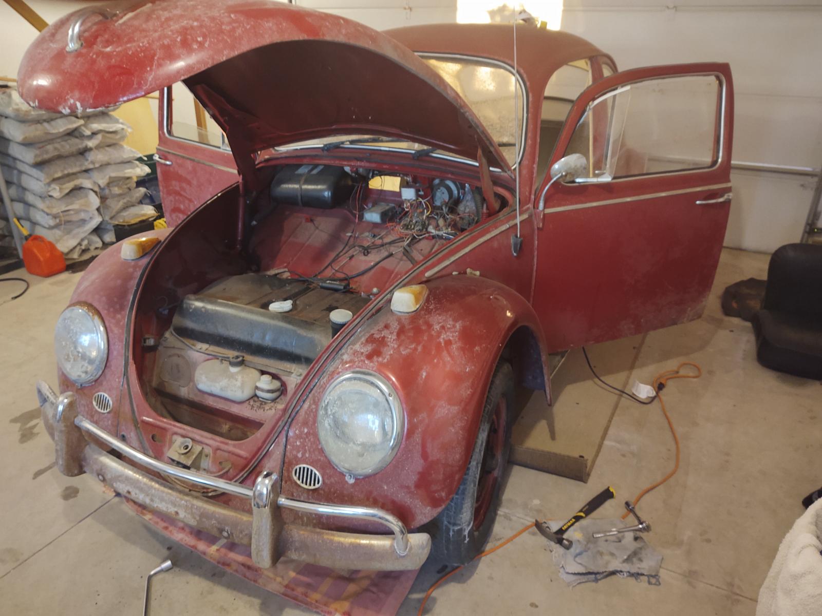

Hi all,
Starting my first ever VW restore project and I've got a fair amount of welding to do. The pans are in rough shape and the body needs a fair amount of rust remediation. I haven't done any welding in about forty years and back then I used an arc welder. In most of these online restoration videos I'm watching, a lot of guys are using mig welders. Presumably they're the preferred tool for sheet metal. So I'm looking for a 115 volt machine that will do the job and not break the bank. Your thoughts please and thanks in advance.
