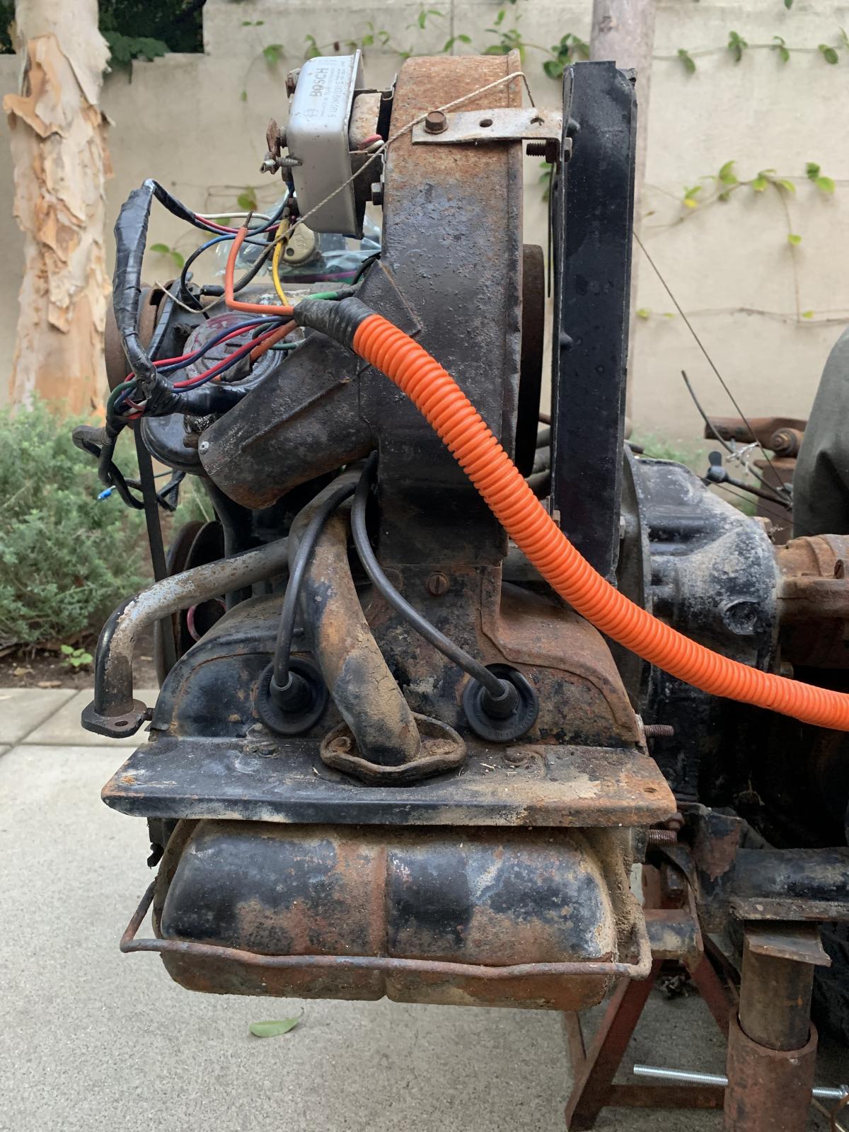

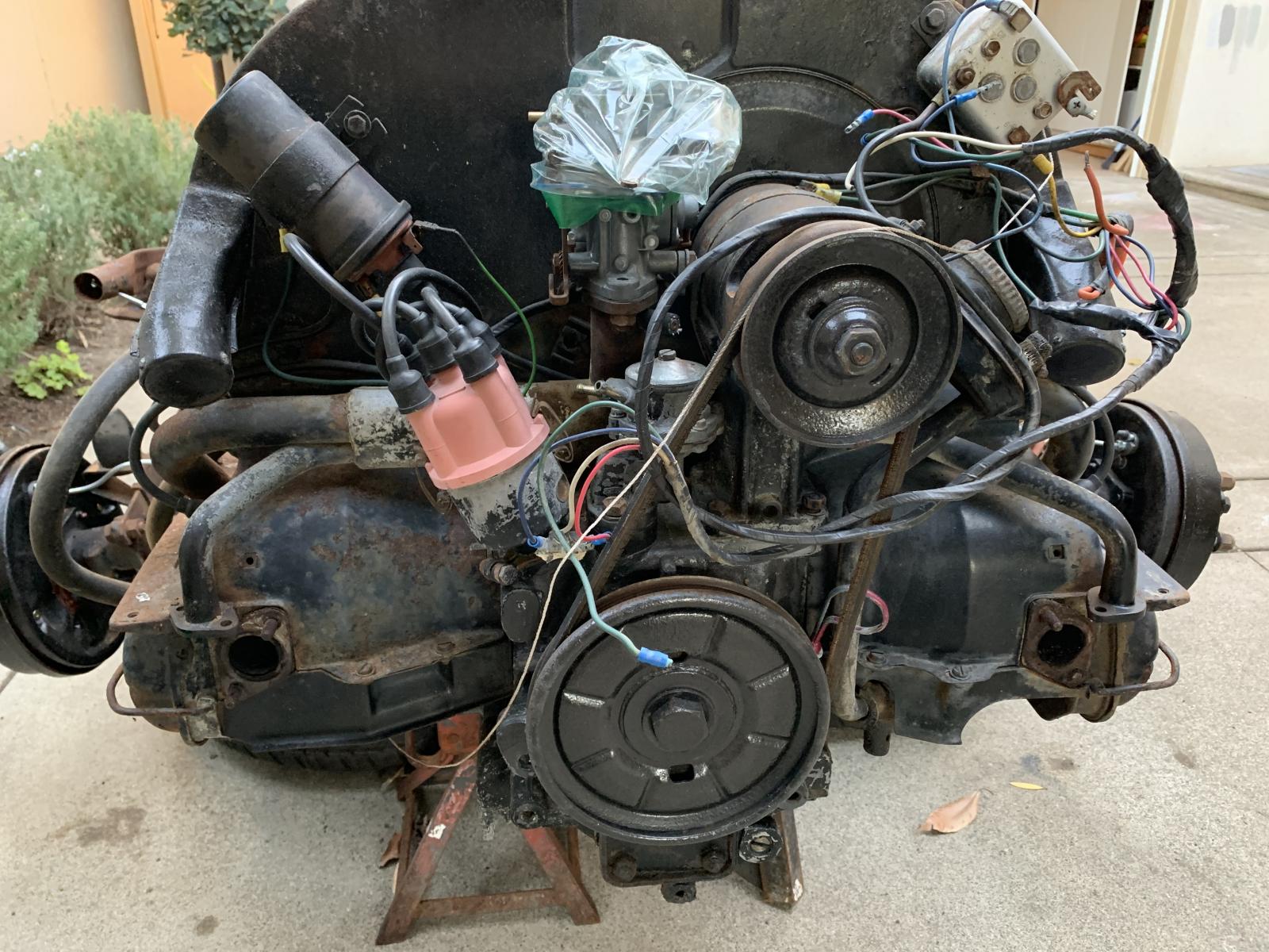

Engine pics, is it the original engine?

PostPosted: Thu Feb 25, 2021 10:45 pm    Post subject: Re: Engine number was erased - what to do? Reply with quote
It looks most likely to be a 1968-1970 Bug engine as set up. I see the lower tin for a single air filter heater pipe on the right side. Many Bug engines are missing those tins.
The heads, from the outside appearance, are 1966-1970 single port 1500 and 1600 cc. Older single port heads had the intake ports trait down where they exit the heads, later single ports had larger valves and ports and the slightly angled port.
The block is likely a replacement, thus no serial number. The distributor is an aftermarket Bosch 009. The oil cooling system is clearly not stock, the original system didn't include a filter and the cooler was inside the fan shroud. The voltage regulator was bolted to the fan shroud, so it is 12 volts (a 6V Bug engine has the regulator bolted to the generator.) The thermostat and its fan shroud flaps are missing.
It is a good base but it's not really possible to know what may have been done inside. I would guess stock because so much of the outside is still stock. I like these single port engines. I have a nicely rebuilt one in my buggy.

Agreed! Nice dependable engine if in good shape. A better one than the ‘64 would have been. Not the best for any major power upgrade but in stock or close to stock form it will give you good service. Needs a good cleaning and a few details taken care of.
