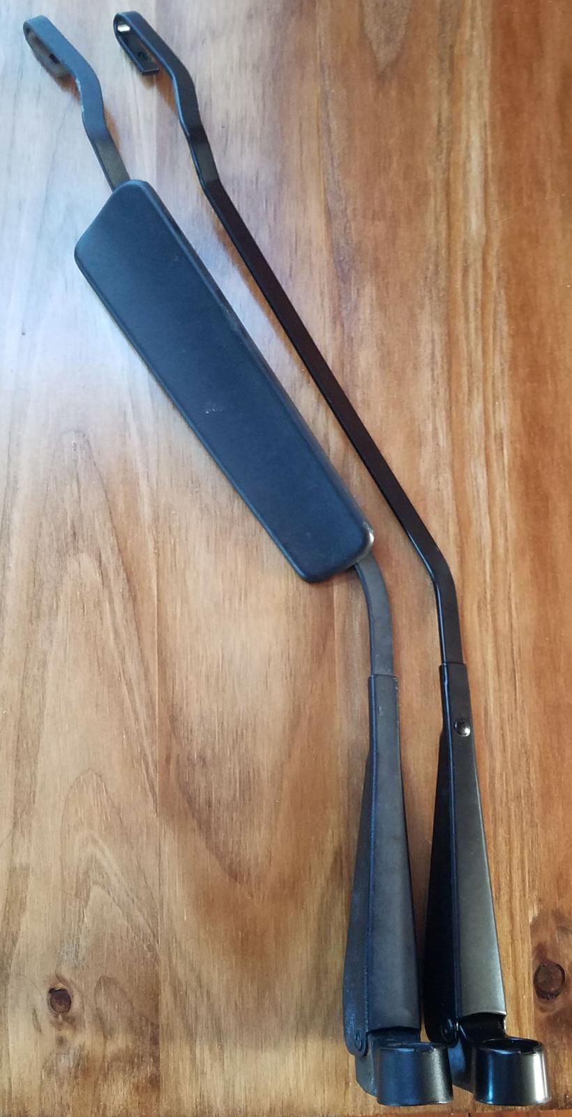

Here ya go. Just went through this with the arms.
Brickwerks T3 in the UK has original VW for 20.65gbp
Order on Monday receive by Friday.
https://www.brickwerks.co.uk/t3-parts/body/t3-washers-and-wipers/wiper-arm-t3-front-lhd.html
I do not fully fault GoWesty on this as they will stand behind their product they sell. They found a less expensive alternate arm originally from "Classic Line" I think from Denmark, distributed by Pacific International. Nobody along the supply line checked the size where it fits the blades.
I think however there might be blades with a mount that will fit two sizes, but I'm not going out to check which ones they are.
OEM VW Markings. Brickwerks is on the bottom.
VW OEM has full paint. Classic Line's does not.
Alignment in pic is not exact, but you can see the aftermarket has a different angle where the blade mounts. Not really a big deal as you can bend it for less pressure on the blades.
OEM on the right side. The difference in size is apparent.
VW OEM is on the bottom. The rivit holding the arm to the base is on the GoWesty alternate arm from "Classic Line" The length does not look to be the same, but this is only caused by the arms being side by side

Just measured the OEM from Brickwerks - 8.76mm.
And measured the GoWesty alternates - 9.07mm.
Just enough to create a non-fit situation if the blades are a tight tolerance.
It is definitely possible that something happened to change the thickness between batches coming out of Classic Line.

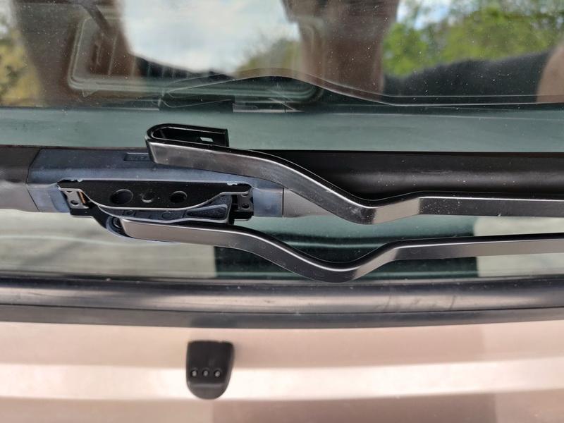

No, this is what the problem is that the original poster has and me too!
The OEM VW part is on the right and the aftermarket is on the left. The wiper blades do not fit into the aftermarket arm.
The conical shaft area are the same and a press on fit to force the splines mating shape into the arm.

...got it...I would call that the Wiper Arm to Blade pivot...
...and don't take this wrong, but before anyone is tempted to "zap them down to the correct width on a belt sander", note that the part marked in Yellow is a separate plastic insert, typically included with "multi-fit" blades (along with a bunch of other Arm adapters, to allow them to play with other Wiper Arm styles). Since the left arm is already wide enough, I suggest fitting into the Arm pivot without that piece, or with an interface piece which does not have those yellow protrusions...or maybe even just "zap" those protrusion away on the little plastic adapter (no touch up required!).
Cheers
Yep, I agree. It usually just unsnaps with a plastic detent.

That of course was the first thing I did. Without the insert in there the blade was not going to stay on the arm . All the "fitting bits" get thrown away when the blade goes on.
If I had a new blade that came with all the little "fitting bits" it probably would not be a problem. Being too cheap I was not about to go find a new blade when my old one is still working great.
Still, the original wiper arm because of it's narrower width gives you the option of being able to fit an adaptable blade with the fittings.
If you just have the wider arm then your stuck with the one size option.
Is it a big deal? Not really because at some point you need new blades and you're going to find ones that fit. At the time you're putting this new arm on and you get all finished and try to put your old blade on your looking at having to run out again to the store so it's wtf grumble grumble grumble more $$$... Of course it raining as your finishing the job!
You can make the old arms work as been stated by cleaning the splines and adding a washer under the nut if you do not mind old faded, chipped paint arms. You could go to the hassle of cleaning the old paint and repainting them when these were nice new painted one that look great...at least until a bird craps on it 😁
