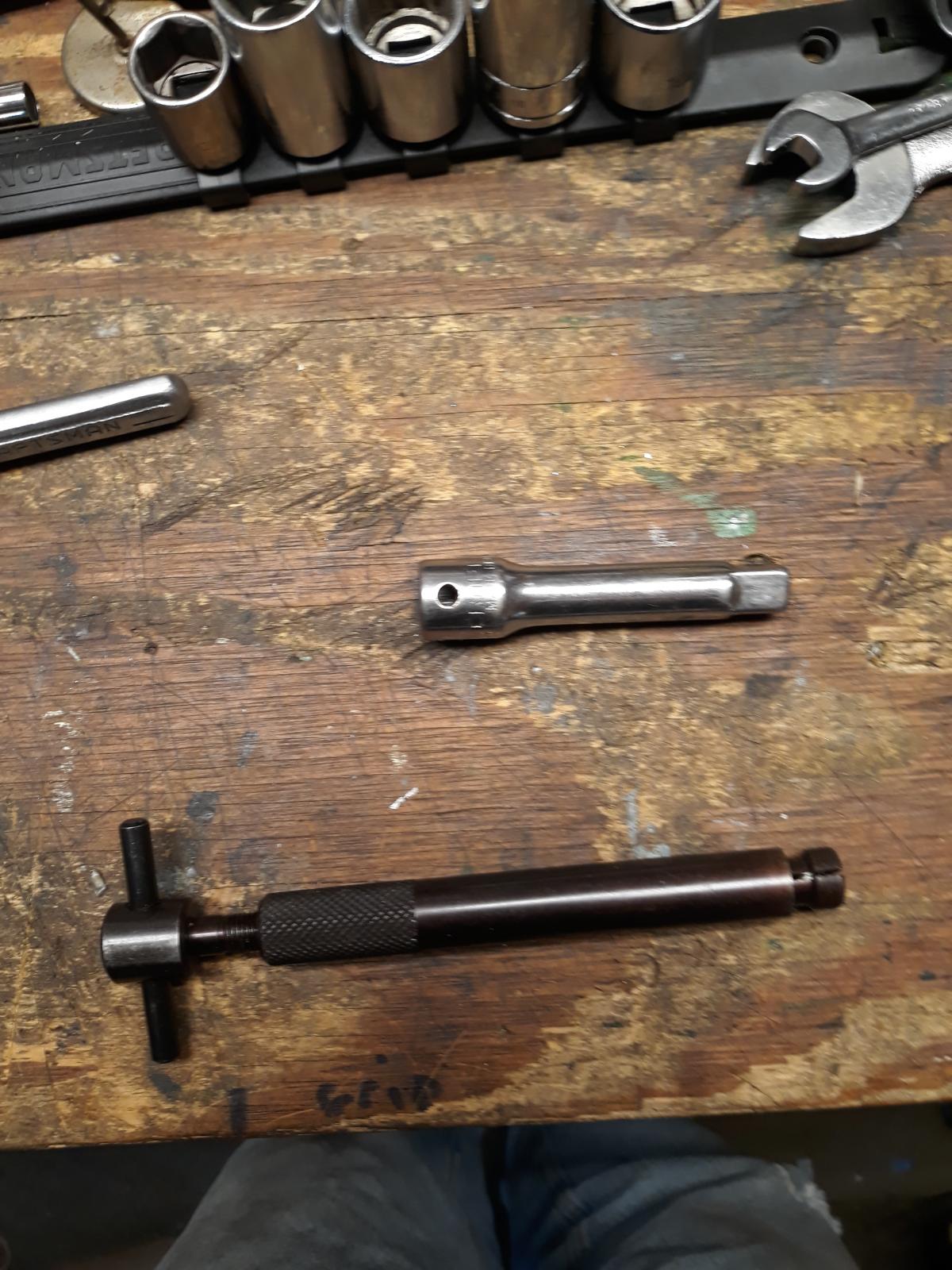

I have been tracking down excess oil pressure problems for too long. Today I started to inspect the valves. My car is a Formula so engine is tucked tight also oil pan in the way of rear access. I have the proper tool but its too long. I dont wish to pull the engine. Is there a different one or has someone here fabbed a shorter one, about 2 1/2"? I guess I could buy another one and cut it up.

use a tap that fits snuggly into the bottom of the piston.
Taps are rather short and the threads can grip the hollowed out bottom of the piston.
Unless someone has a better idea. You'll need to remove the sump to get good access to the piston.

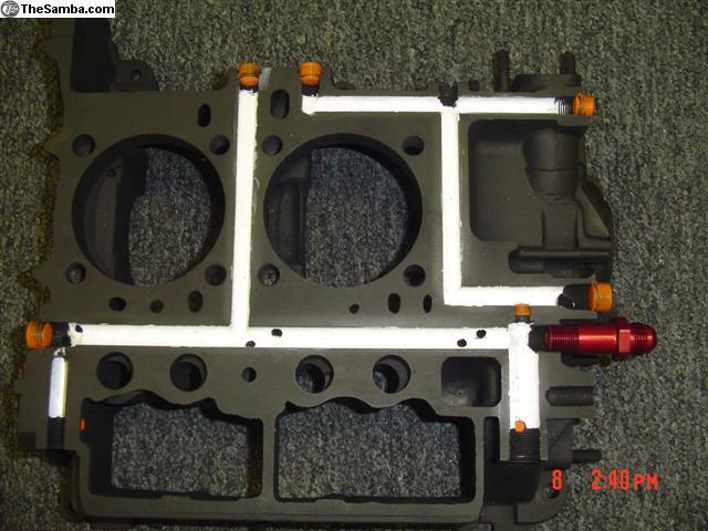

I was thinking the vent hole below the plunger should be dripping, but maybe it only does that if the oil is filled up to the top mark.
you can see it here highlighted in orange, it's higher up than I pictured at first

OK I think I've got it now.
Most people would jack up the REAR, of a rear engined vw car, thus the oil would be higher towards the flywheel, so it comes out that hole.
In your case I have no idea Wink

1/4" NPT tap fits real nice in a plunger.
Just get it started and it will grab it and rotate it. You can then pull it out..

rework the tool or remove the sump.
mark tucker
Joined: April 08, 2009
Posts: 23945
Location: SHALIMAR ,FLORIDA
mark tucker is offline
PostPosted: Mon Mar 22, 2021 8:42 am    Post subject: Re: Custom Oil valve removal tool needed Reply with quote
rework the tool/shorten or lenghten, or just a longer bolt for it. or remove the sump.
