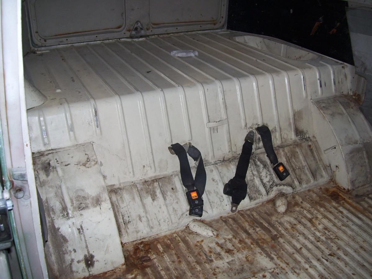

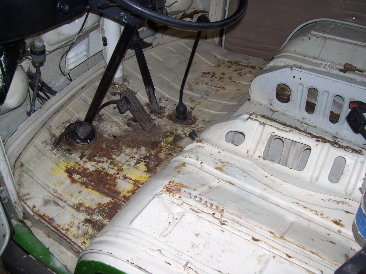

There are signs that this bus had had some bumps and bruises. Long panel on driver's side had some fill work done, driver's rear corner was replaced. Also signs that there may have been a front end clip job done, but really don't care. Not going to be a show piece or full restore, just a solid running driver to use and enjoy.

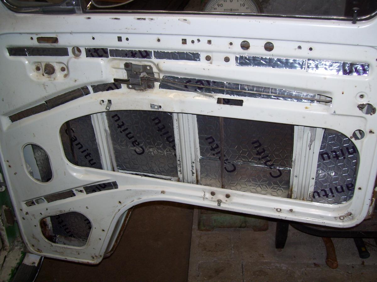

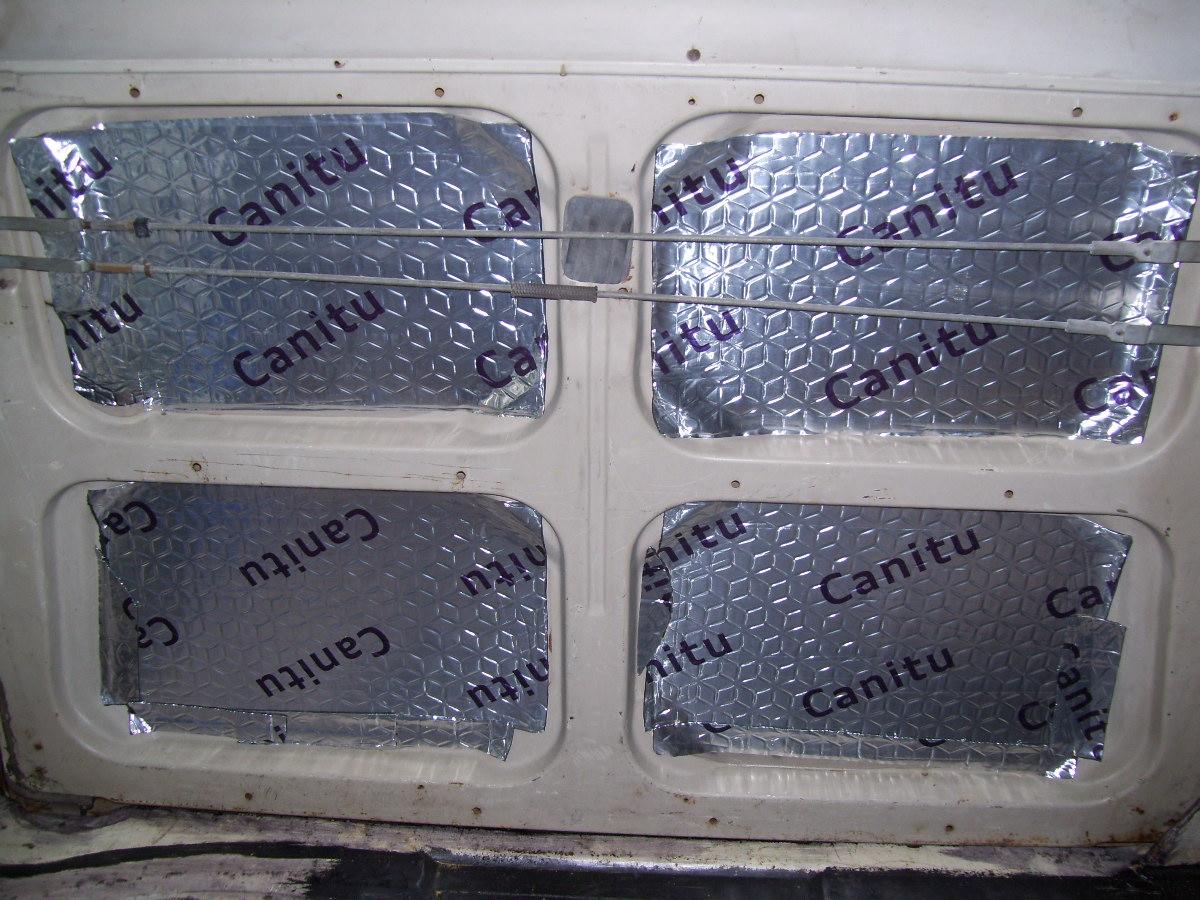

My wife worked on putting in sound deadener sheets on some inner areas. Planning for a double layer over the rear cargo area above engine bay. I will also install deadener behind fuel tank area since it is removed for deep cleaning.
My plan was to spray truck bed liner coating OVER all this sound deadener after it's installed so as to cover the shiny covering and also would be another layer of sound protection. That way, if any shows through around the cargo mats, it doesn't jump right out at you.

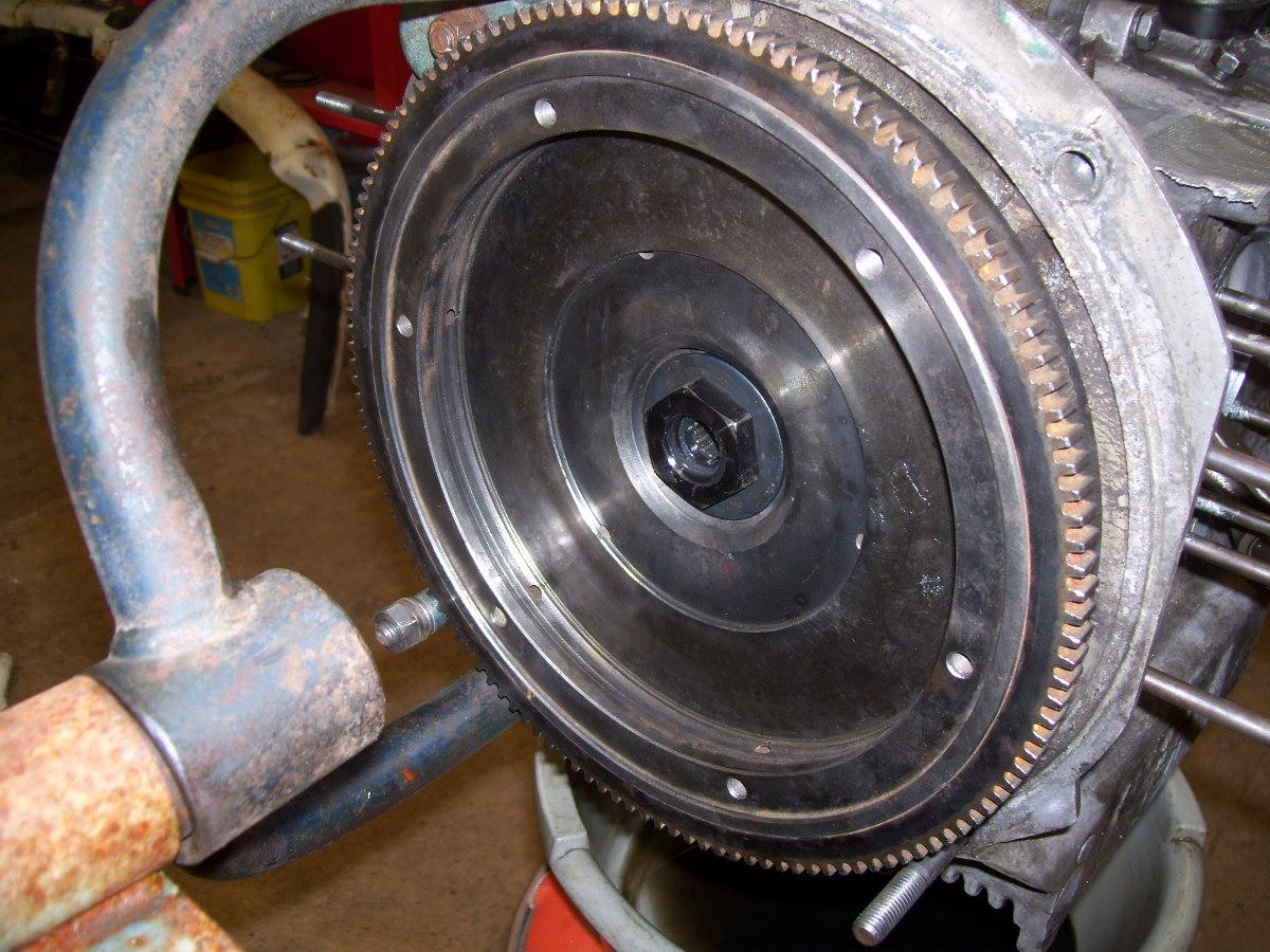

I meantime, finished setting the endplay and installed the new flywheel seal on the engine. Installed a new Gene Berg gland nut and washer set. Cleaned and painted engine tins in preparation when the new p/c's arrive. I dug out an original bus oil bath air filter I had, '71 model. Took a while to clean out the mouse nest inside that!

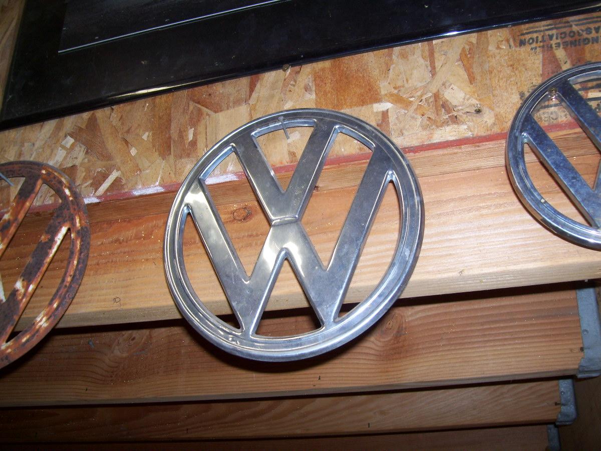

I also had a pretty nice front emblem for the bus, just hanging on the shop wall!

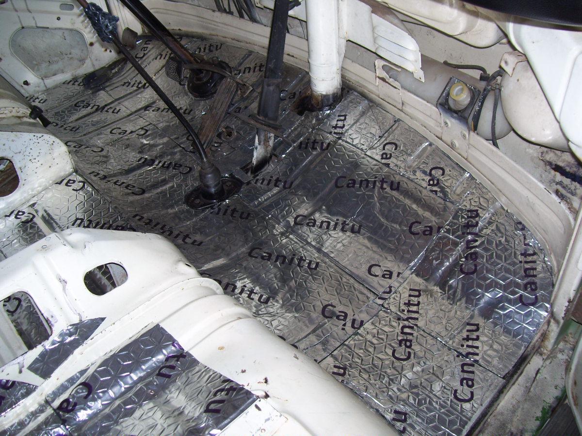

More progress: Wife is working hard at getting more of the sound deadener installed. She applied a second layer going across the rear cargo area in the opposite direction rather me having to apply it inside the engine compartment above the engine. She also started on some of the doors and hatches as well. I applied the same deadener to the inside of the engine compartment, but behind and under the fuel tank area.

The wife has finished applying the sound deadener to the front floor area and walk through. Only the driver's door left. She said she does not want to put on the main cargo floor area for now. We'll see how it sounds once it's driving. Can always easily put it in later.
I have completed assembling the long block, set valve lash. Cleaned and painted some more parts and tin.
Also completed sound deadener and final coat of sealant in engine bay area.

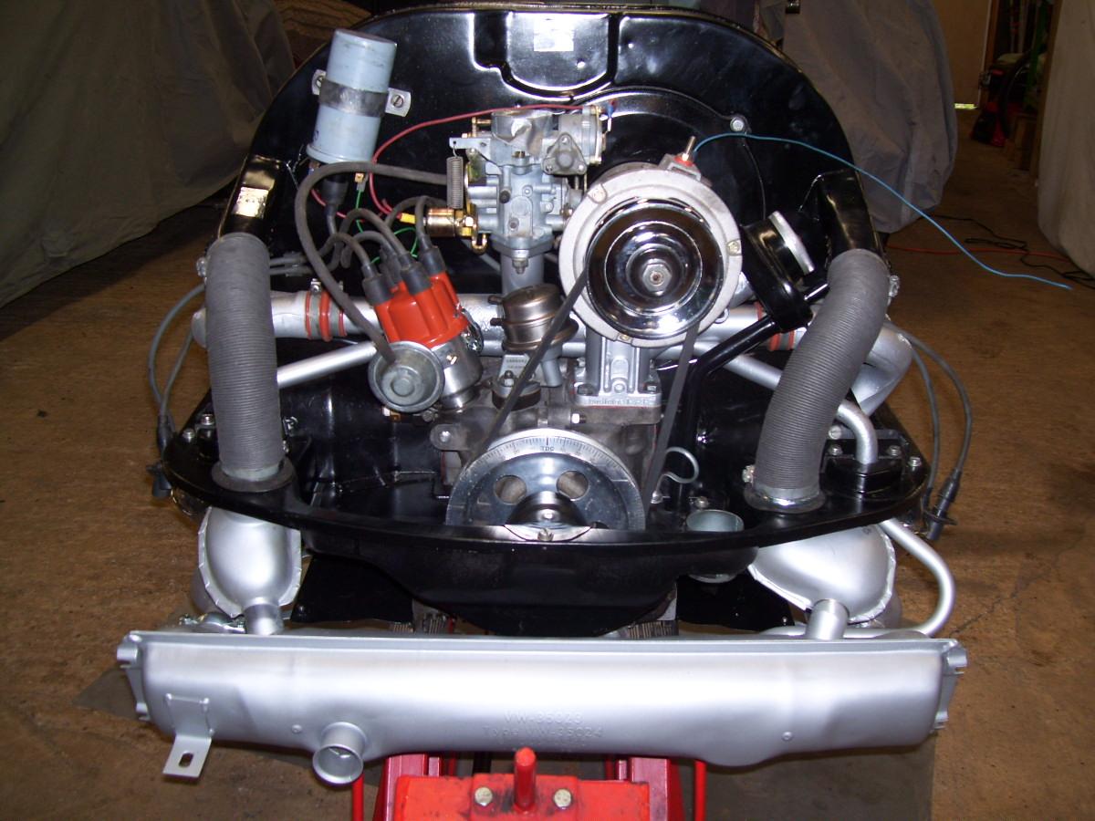

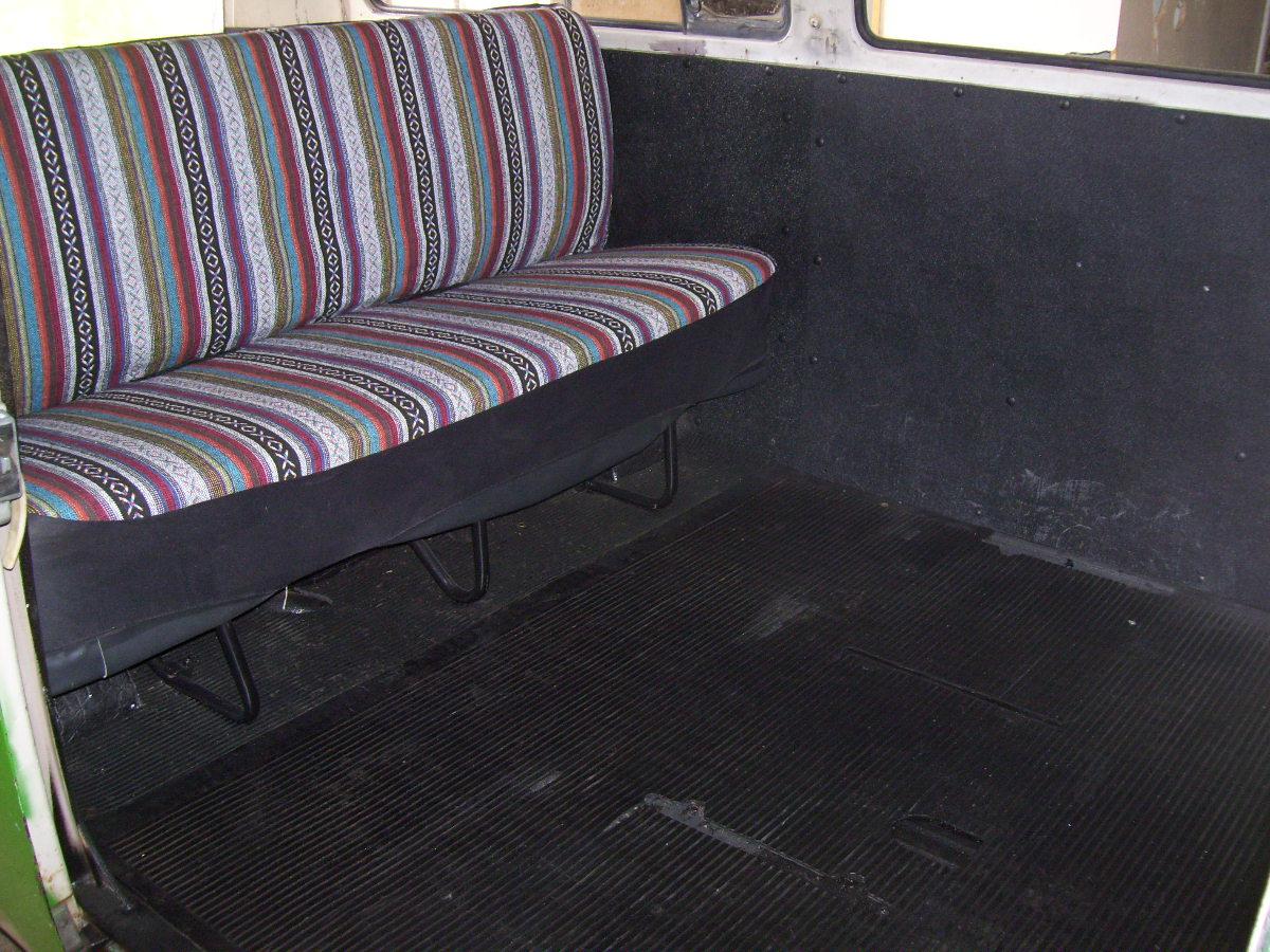

Progress update: I have pretty much completed the engine assembly and is ready for install. I re-installed the fuel tank, removed the hard start relay that was mounted in the engine bay, and will finish going through the wiring before re-installing the engine.

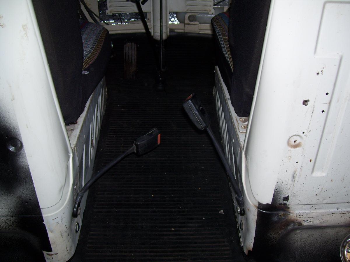

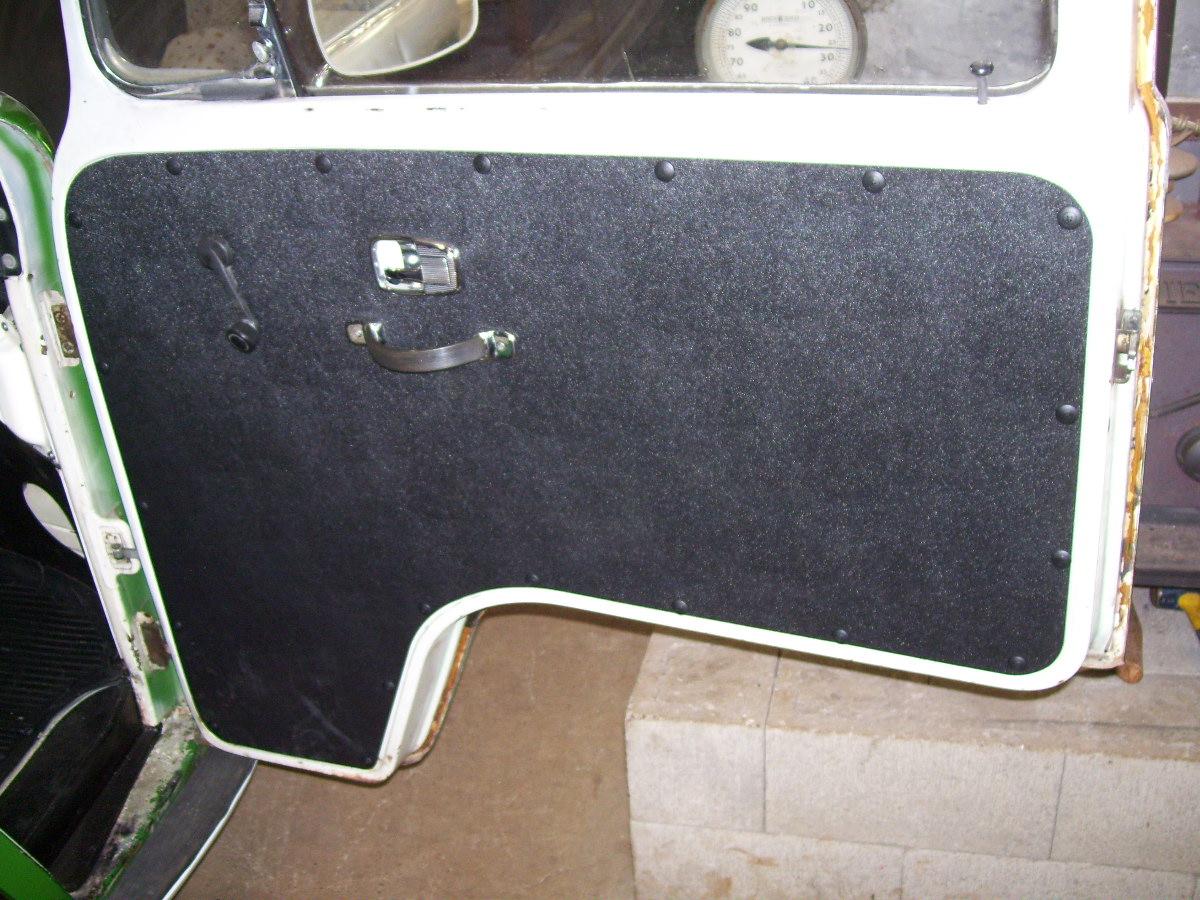

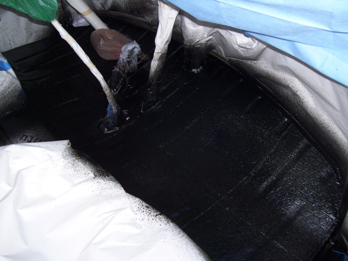

I sprayed a truck bed liner system over the sound deadener for extra protection. Wasn't really happy with the spray delivery gun that was provided in the kit, but do like the applied product itself.
The wife recovered the drivers seat, stripped and painted the lower bases of the rear and middle seat, then said she needed "something to do", so I told her the front splash pan needed some straightening. Here's her handywork after spraying some undercoat to the inner side. I told her she was a good metalurgist!
She also was home this week for a day to be around for the installers of our new metal carport we had purchased, so she spent some time "restoring" the glovebox!

Engine is in! Took some time to get it to fire up. Turns out, when cranking the engine over, there is no power at the coil, but when you let off the key, there is power...I'll have to figure out how someone wired up the aftermarket ignition. But by using a remote starter switch, voila! I also installed a fuel pressure regulator with gauge.

Not to be a Debbie Downer, but I hope that you do not regret using that black undercoater all over the place. I have had bad experiences with water getting underneath and surreptitiously causing rust issues. Then you get to remove it all, which is not fun.
Looks like this is going to be a really fun bus for you guys, though!

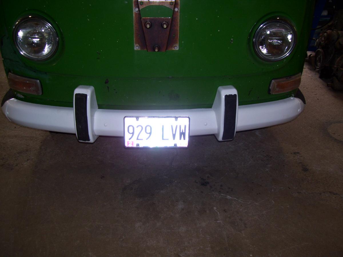

Been a while since an update, but we are making progress! All the ABS interior panels arrived from Werksberg. The wife really enjoyed installing them. Gives things a nice, finished look, yet utilitarian looking all the same! One more seat cover to go.
Mounted the front bumper. Rear brackets don't seem to fit the frame opening correctly, are '68 rear brackets special?
Agree. Great job for sure, but I also question the use of sound deadener and undercoat, especially on the front floor. Anyone have long term experience with that? It seems to me that moisture would get in there?
