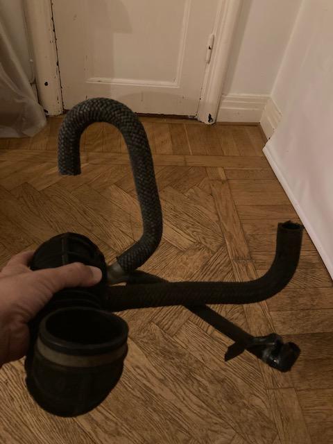

I need to replace these bent hoses in the picture below, they are attached to the S-boot. Three of them.
They are bent in a particular way, can I replace them with a generic vacuum hose or are there pre-bent hoses with individual part numbers that I can get?
If so does anyone have a links or part numbers?

Thanks busdaddy, however Iโ€™m in sweden so shipping would take too long. Also they were very expensive at 300 dollars, even if great quality, its still just some hoses!
Is the exact shape of the bends on these hoses needed for proper function, or can they be replaced by same length and diameter generic vacuum hose?

Unfortunately these are long NLA and very expensive to buy the hand wrapped silicone replacements.
What you can do is to go to your local auto parts store, and see if they will let you rummage through the various heater hoses in the back room. I was able to get one that was very close to the one that looks like a letter J, and it cost about $6 USD.
When the smaller one needs to be replaced, I'll be doing the same thing.

Try cutting down one of these sidewinder hoses

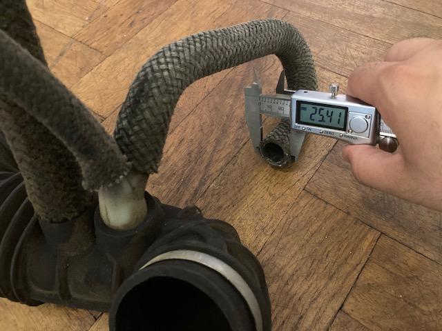

Whatโ€™s the ID on each piece? Can you take pictures with a scale in the picture?

I used someone else's tip from here and used some good quality hose and a "spring former" at the tight bend for the decel hose e.g.
https://www.carbuilder.com/uk/former-for-24mm-od-heater-hose
For the S-boot to breather valve I used a 90deg elbow and two pieces of hose.
These were temporary fixes that became permanent, although for the 'elbow' setup on the breather I'd rather find a hose with a 90deg bend and do that one better.
Volvo has a lot of evap hose in close shapes to these.
If you by ID mean part numbers, I'm sorry I cant find part numbers for these

Below is a picture using the hose former (as mentioned I borrowed this solution from another samba member). Not perfect, but it works.
The supplier I linked in the earlier post is in the UK and I assume ships to EU. I have no affiliation to them, but they are very quick usually. Happy to dig out what size and hose I used.

Some soft copper or aluminum pipe, a bender and straight sections of hose to connect it to the devices will be fine.
A place that makes hydrulic hoses can fab up the bent sections and then you just need to add the connector hoses.
The oil breather hose (L-shaped) is 022 129 973C. It's 22mm ID.
The decel valve hose (C-shaped) is 022 201 919. It's 18mm ID.
My company sells an 18mm cloth covered hose which works well to replace the C-shaped hose, you need to use a longer straight piece than the curved part (460mm long). I have tried for years to find a good replacement for the L-shaped breather hose, unsuccessfully.

When I installed FI in my '73, none of the formed hoses I had were any good. So I made up a mish-mash with some copper pipe (though when I tried formable copper tubing, it was very difficult for me to get a good shape made and I abandoned that idea), clear vinyl tubing, rubber hose, and angled connectors. It works, I guess, but it looks like kind of a mess.
I kept telling myself I'd spring for the silicone set, but like someone else said, the "temporary" setup seems to have become permanent.
