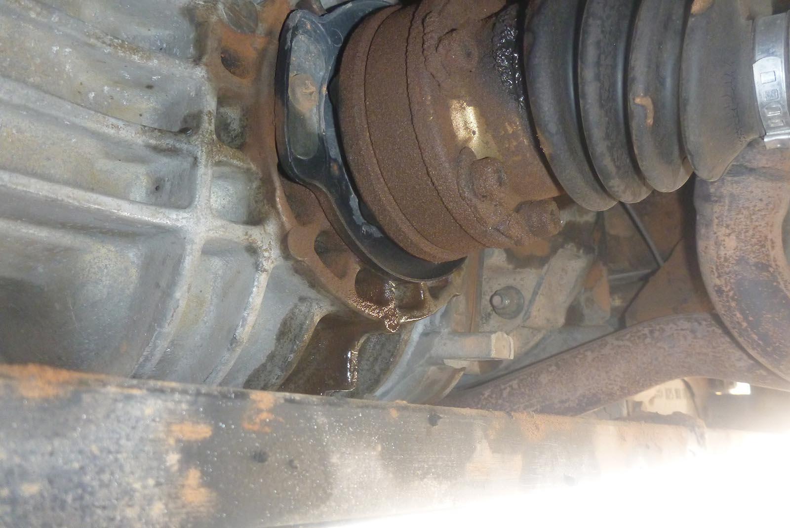

First a little sad history. In October 2019 the transaxle blew up on our 86 Syncro. We got towed into a town where we did not know any mechanics. We ended up having the transaxle re-built by Mr. Gas in Canon City, CO. Respected and experienced rebuild guy. We had the transaxle put back in by foreign car shop in town where the van had been towed after break down. Very bad experience with this shop on multiple levels.
While we were traveling they contacted us and said we need new rear axles and cv assemblies and they need them immediately and they had already ordered some. I was leery of what they ordered and said that we want the right parts and so had them overnighted from Go Westy. Now I have learned that the EMPI parts from Go Westy are not that desirable but that was what was put in. I also ordered the Rockford boot Kit. In the end I don't really know what they did. Far more to the story with these guys but I will leqve it at that.
Since the work was done we have only put 1K miles on the van. At 600 miles one of the rear axles became unbolted form the wheel. Another tow. It seems the hex type bolts had never been properly torqued.
Now - on the other side (passenger rear I am seeing this slight leak where the axle/cv connects to the transaxle. Photo is attached. If you look close it alos appears that there are wear/age cracks on the samll side of the boot and also signs of leakage around it. No way that boot only has 1K miles on it imo.
My question. Can transaxle fluid leak out from that point? Is there a seal that we should get replaced?
In a few days we are taking the van to a new shop that has been highly recommended from a very experienced and trusted source. They are putting on new rear shocks, new rear locker switch, power steering hose. I am going to show them this but thought to get some expert advice and opinions from you all first.
Thanks in advance!

Thatโ€™s 1000 miles? The leak appears to be from transaxle the seal/race adjusting ring. That would likely be a claim with Mr Gas. There is a side cover O ring and seal. The cv flange is where the trans seal seals. A proficient tech should be able to fix it. Worse case the flange may need a speedi sleeve repair.

Have you been doing a LOT of dirt road driving?
That level of dirt for 1000 miles is astounding!
You have two leaks, CV grease and differential oil.
I see a new boot to axle clamp so I'm guessing that extreme layer of filth is your doing.

Thanks to you both. Yes just 1K miles since re-built transaxle and (supposedly) new axle/cv assemblies put in. It's a new cv boot clamp but look at the wear/age cracks on the small end of the boot by the clamp.
Yes we do drive on a lot of dirt roads.

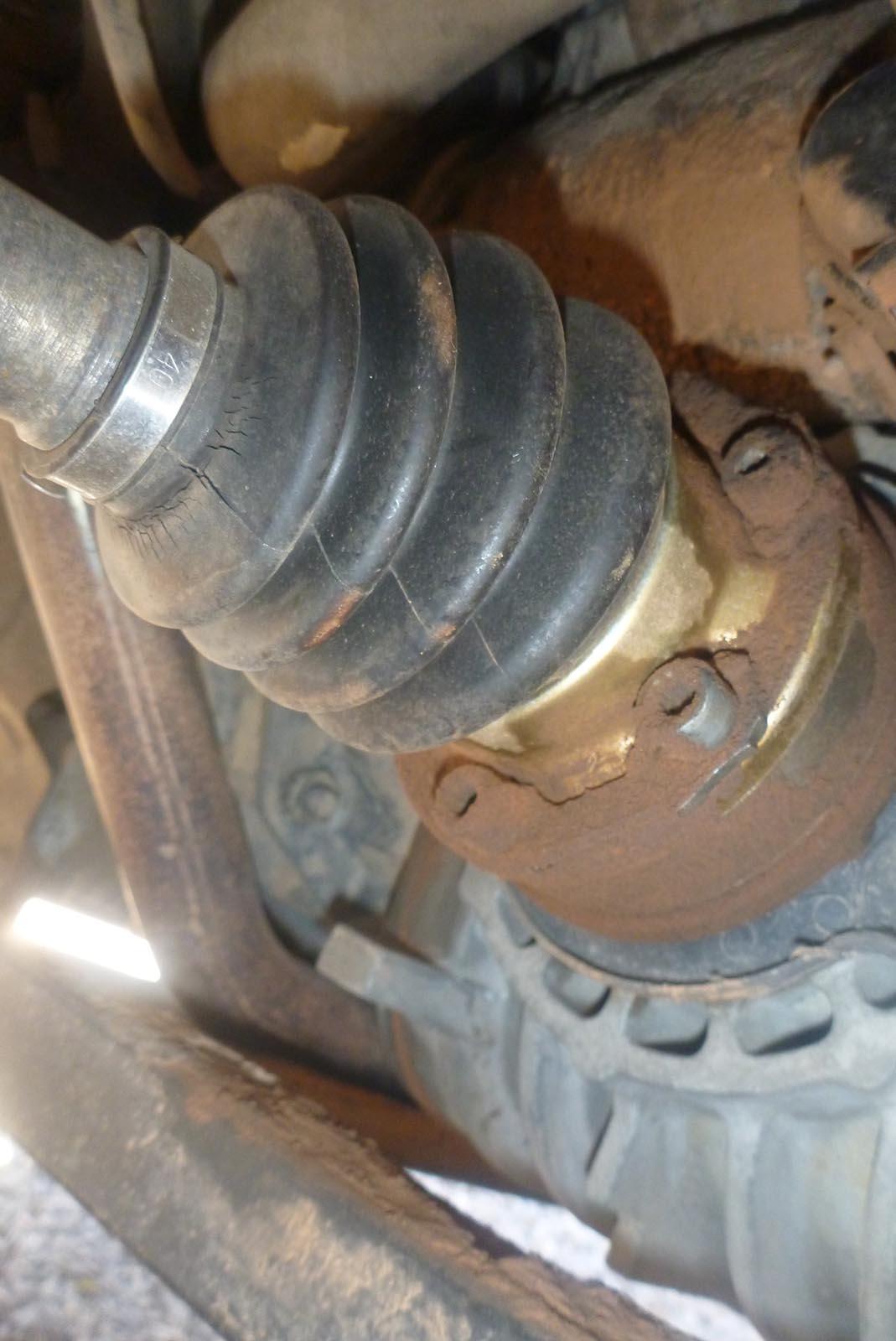

Photos of passenger side inner cv area attached for a comparison. Again both sides supposedly had new axles/cv/boots put on 1K miles ago when rebuilt transaxle got put back in.

These are brand new Lobro boots. 10 miles
Boots are a crap shoot. There have been posted issues with Rockford boots too.

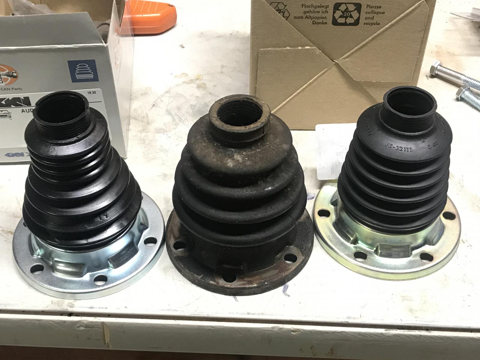

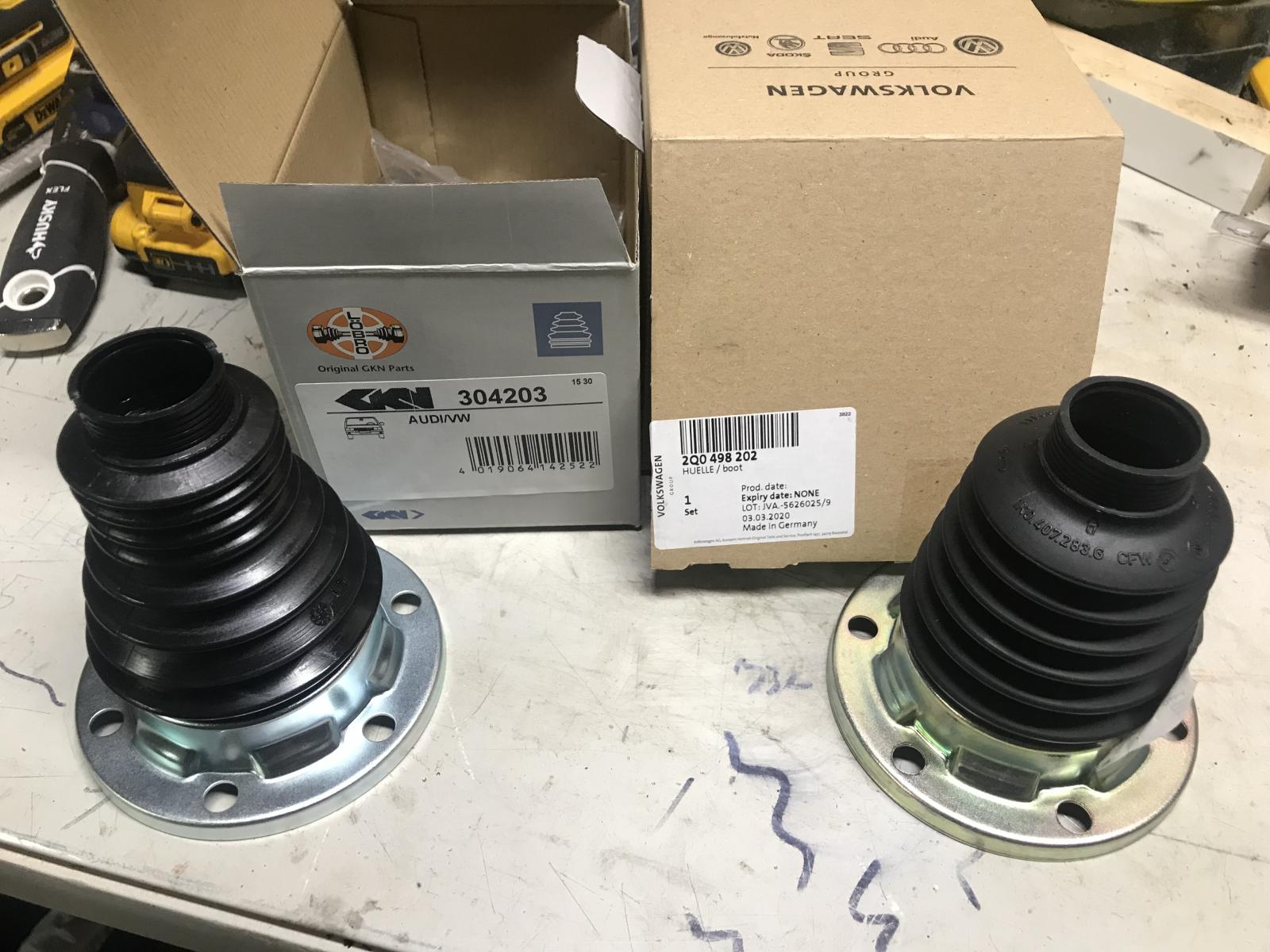

Axle boots have proven themselves to be garbage.
There is a new boot alternative.
VW Tiquan Boots.
I am currently running GKN boots on one axle and Genuine VW boots on the other.
A test to see if one is better than the other.
Initial thoughts? I like the VW boots better.
Order from FCP, they have a lifetime warranty. Yes, even on axle boots.
Link to Tiquan boot thread......
https://www.thesamba.com/vw/forum/viewtopic.php?t=...p;start=40
If it werenโ€™t fir the user I would call user error on this, but this guy knows his way around the shop.
Unbelievable new low in part quality

Tiquans are all over the place running OE VW boots.
I would NOT run any Vanagon boot available today.
I would, if pressed, say run VW's boot.
FCP has them.

That kit won't solve your boot problems.
The VW boots are $43 each.
https://www.fcpeuro.com/products/audi-vw-cv-joint-boot-rear-inner-vag-1k0498201

I am.
But you need answers tonight.
My opinion tonight is don't waste money on any Vanagon boot, you already did once.
Buy a Tiquan boot.
IMHO I prefer the fit of the VAG boot over the GKN boot. Also the OE VW boot has millions of proven users on the road right now.
My boots are nearing the mileage of yours where yours died. Both brands look brand new still.

You are using a boot for a different vehicle that someone discovered fits the Vanagon and solves a part quality supply problem.
The parts listing could say it fits on the roof, I don't care!
It is the part number that matters not the description.
This is a genuine VAG VW/Audi part.
You can get the exact boot at your VW dealer also ...... but no lifetime warranty.
Order four (4) ...... cry once.
Dave
