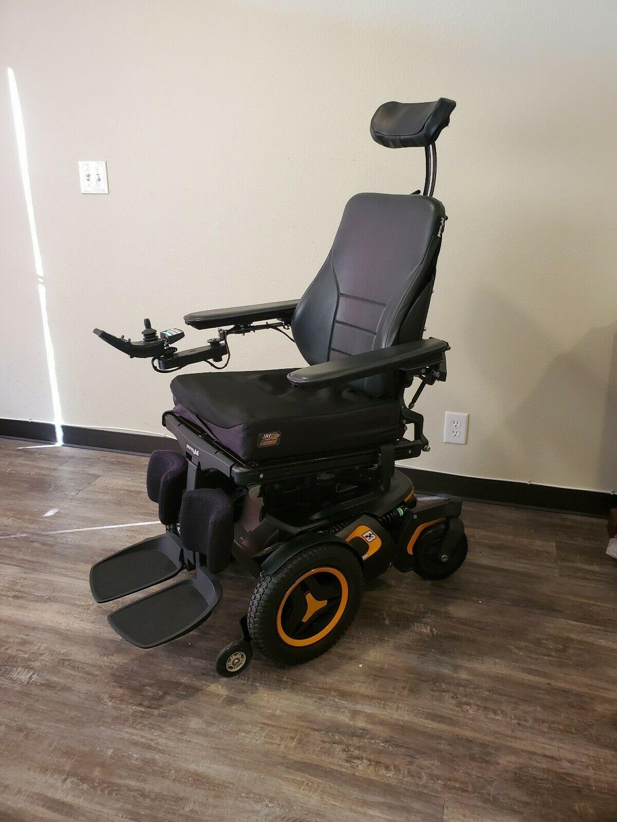

Due to wheelchair confinement, I can't go camping. The Problem: Permobil F3 400LBS (24" wide, 36" long) wheelchair needs to be lifted into the van side door with minimal effort. Ramps are too heavy, can't be installed in old vehicles by regulation. I need another set of eyes to look at the challenge, engineer a solution, supply a build list, installation instructions (including best place to drill the floor) and any other ideas are welcome! If you collaborate, tell me how to split the money! The vehicle is my '89 Tiico Westy, unobstructed floor. Remote push button controls necessary. "Where to Buy" components list at best prices appreciated... I've been driving campers since 1968, almost a million miles; I don't have many trips left. Please help me! 604-732-5674 or [email protected] You tell me how you want to be paid.

400lb max limit for this unit, so you're right there...but it's in your area and only $350. Looks like an easy install.
https://www.facebook.com/marketplace/item/1209814809350990/
