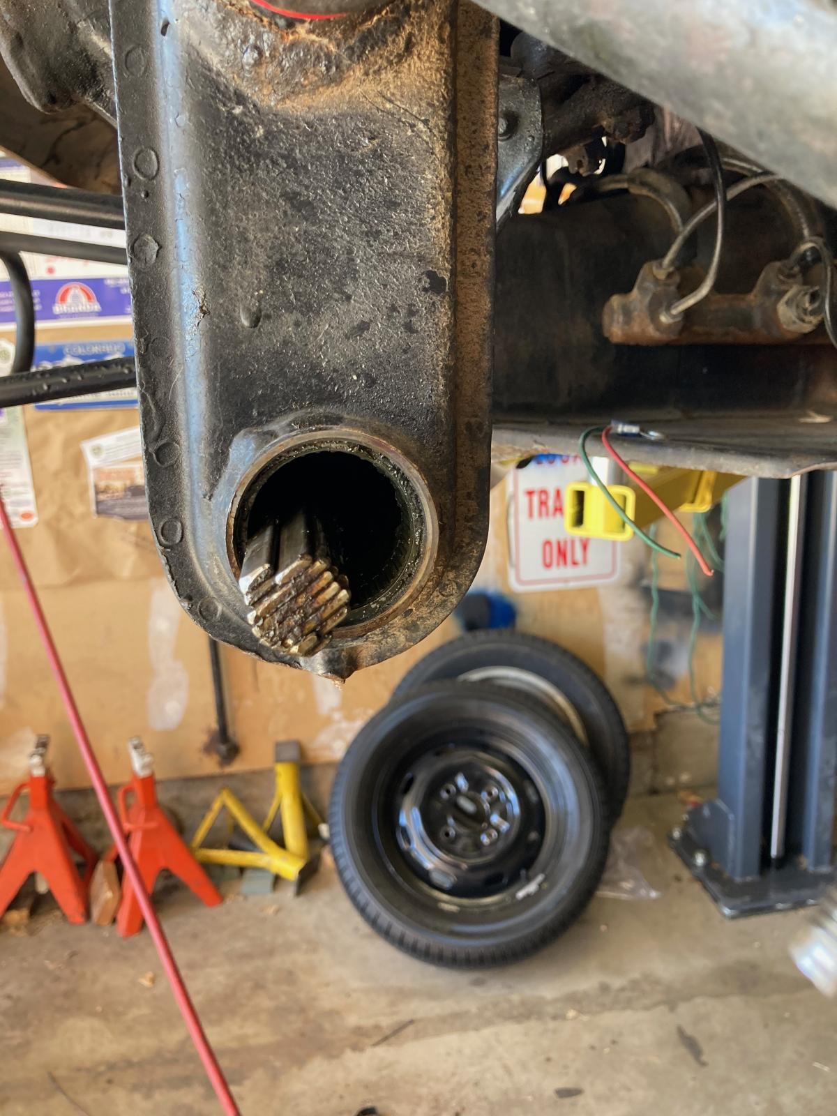

Ball joint front end. No adjusters. I removed all of the small leaves on the front of my buggy (there are 4 sets of 3 total), and the first time I did a hard stop the fenders rubbed the front tires. So I added one of the 4 sets of small leaves back in. I am now running all of the big leaves and one set of the small ones, and about 12psi in the front tires.

There are 4 big and 6 small (or wide and narrow if you prefer) leaves on a beetle front end. On a ball joint front end you can just remove the small (narrow) leaves as long as you do it in groups of 3.
On a King/link front end, you need to do a little bit more work. and have to figure out a way to fill the space the small leaves occupied. Some people cut the leaves and weld the small pieces to the big ones.
Some people add adjusters. Some remove all spring from one tube. There are different ways to do it, but bottom line is you need to take out some of the spring. How you do it is up to you.

modok wrote:

Thank you for that photo ! ! !

Look at the picture. There are 3 narrow leaves on each side of the group of wide leaves. If you remove any one from the group of 3 there is nothing to secure the other 2. It will become crystal clear once you take the front end apart.
Do you have ball joint or king pin front end? King pin needs a few extra steps not needed on ball joint front end.

They recommended trying a brake bias valve first off with added weights above the beam. Possibly stickier front tires, type 3 rear drums if needed, and rear discs if all else fails. Kind of more coin than I wanted to invest . . . I'd hoped to build this one out of parts in hand.
We'll see. Although I do sort of like idea if having a VW powered Fiat 600, I don't want this to become a life-style nor do I want to get upside down on the project from the beginning. It's a silly little car that won't return either money invested nor the joy that I might get out of it.
This one might well be ended before it began.
