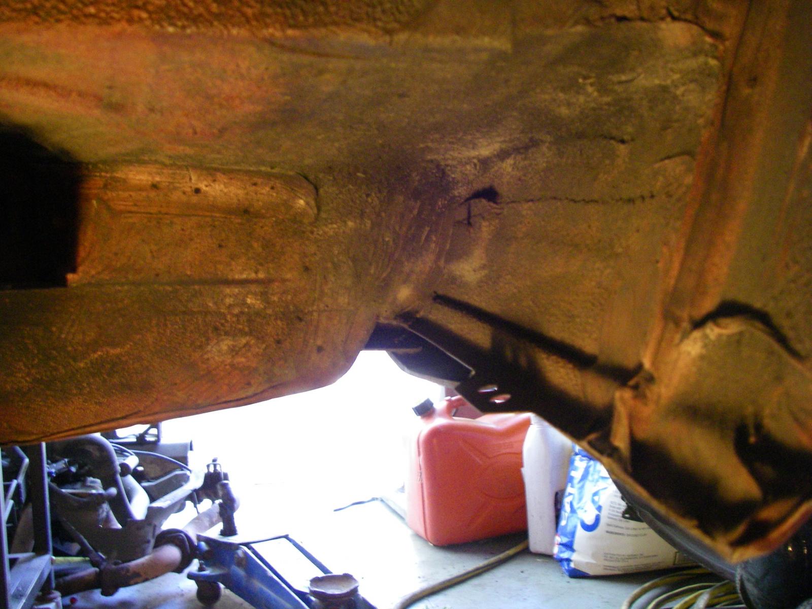

As I crawled underneath I found it to be rust free with no damage at all. The body was straight but for several small dings in the usual places. I was interested in body condition first and foremost and this looked great.
Reading about rust repair on Samba let me know how big a problem it can be.

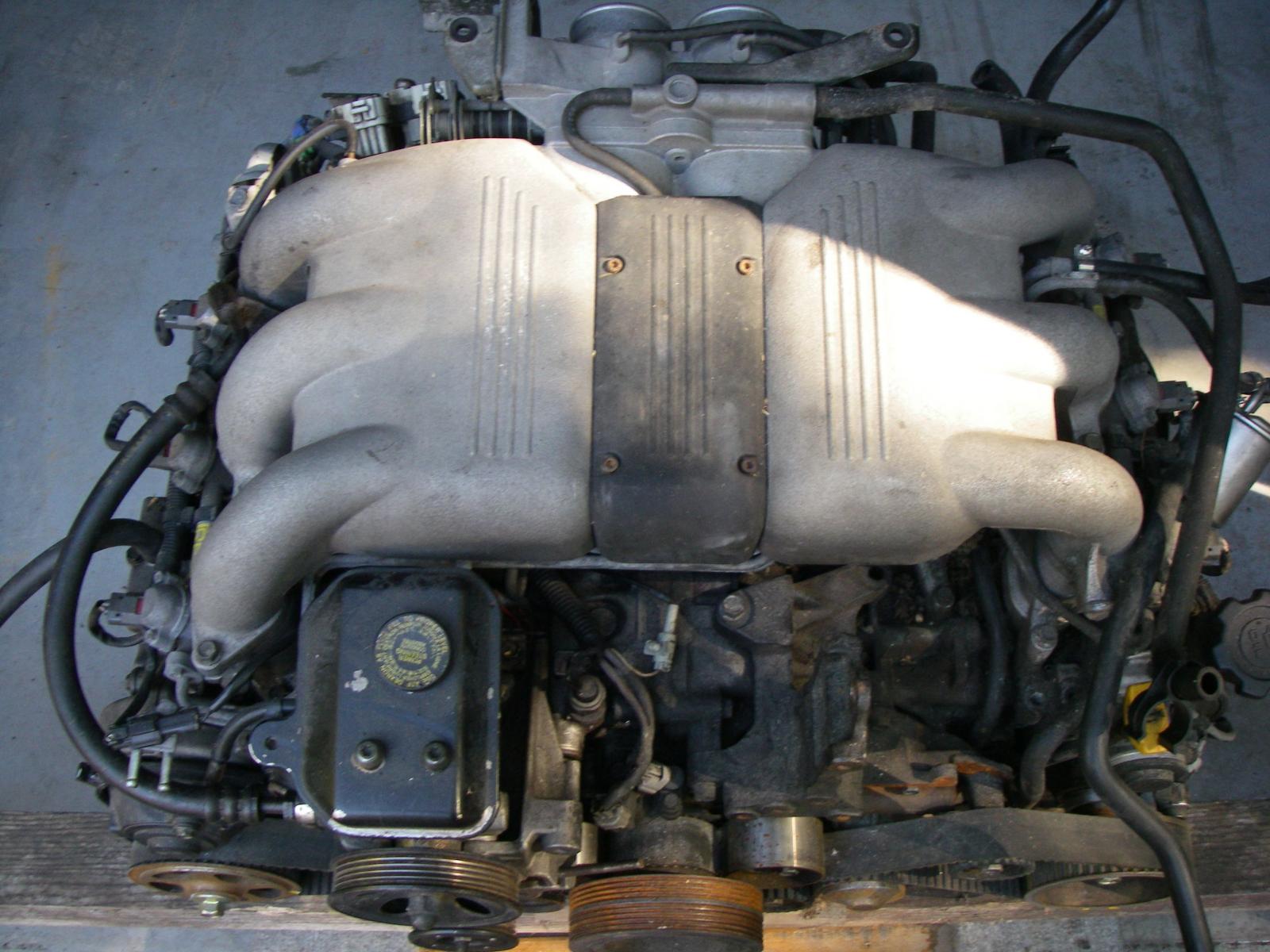

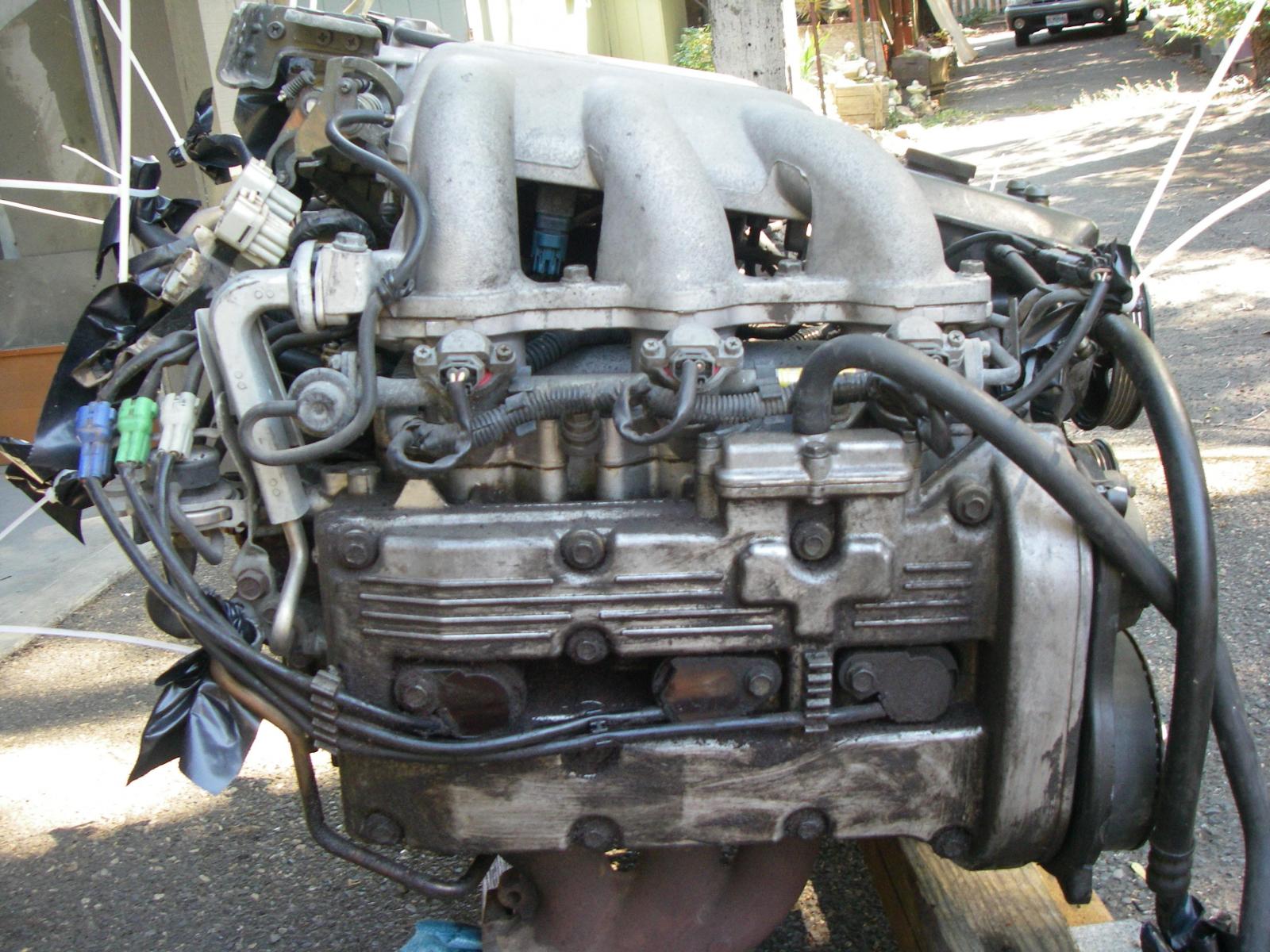

In the beginning there was the engine. I found it locally on crags list for $1500. It included all needed converion parts from SVX. plus two starters, manual fly wheel, two air flow meters,new timing belt and idlers, first gen SC bell housing, SC engine mount and a modified wiring harness. priced out over $2000 for the conversion parts. So almost like a free engine. Engine supposedly has less than 10000 miles and was tested and found in good condition. The seller had a beautiful Synchro with a svx and was collecting parts to build one for his wife. But decided to move to Hawii and so was liquidating. Nice guy probably a Samba member. I have loaded pics of my build so far, some 440 odd pics, in the gallery. I will be doing a small write up on each group of pics, but for those of you that can't wait please go to my gallery pics, there are only short descriptions but you'll get the jist of it. Cost so far - Engine and parts $1500, Vino $1000, car dolly $75. Total$2.575.00 and away we go.[img]

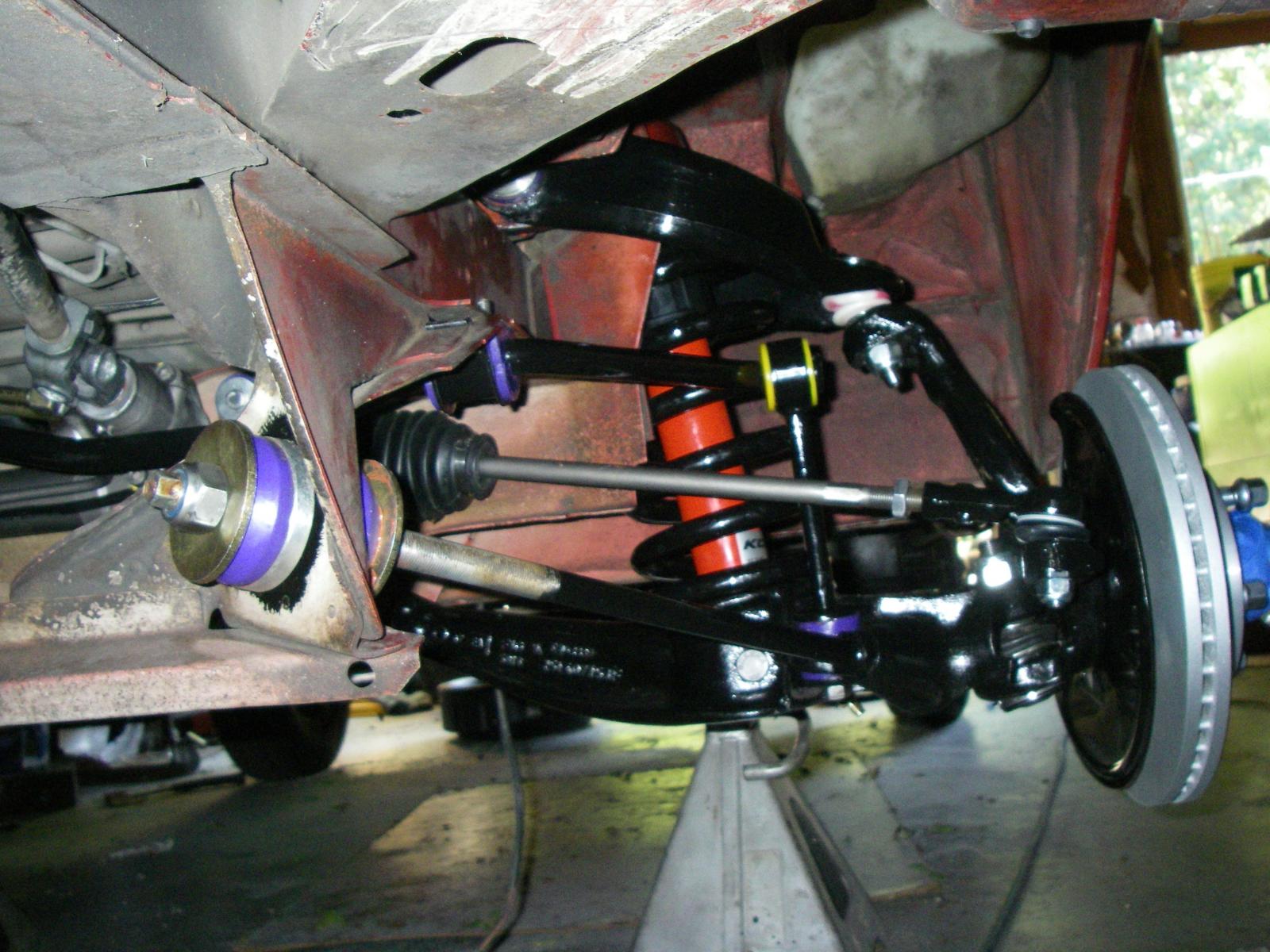

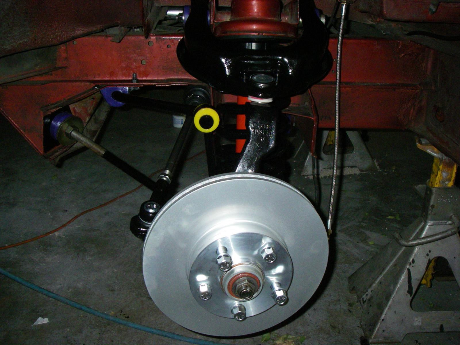

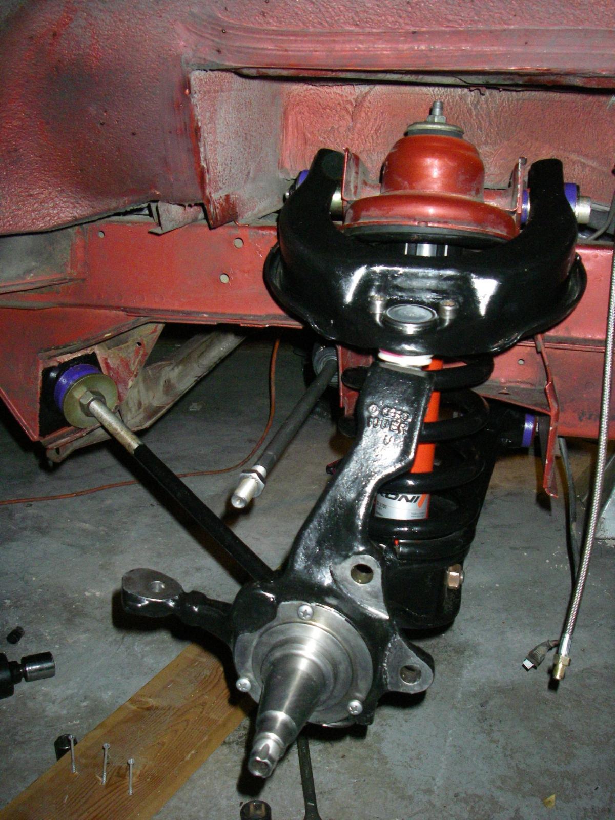

started with the front suspension. installed Rebuilt stearing rack, G60 break kit, SS break lines, new wheel bearings, new rubber stearing shaft connectors, koni shocks and power flex bushings through out. Went well, but I had to have a shop press my lower ball joints out and then back in after painting. had a time with the sway bar drop links, screwed two peaces of twoxfour to some ply, this made it fairly easy to pop the end links onto the bar. Unfortunately as i bolted in the end links, with the suspension at full drop, they continued to pop back off. I have sense read that they should be attached with no grease, ho well after three times on and off, I finally got it. So thats $33.90 for tie rod ends, $50? for lower ball joints, $16.95 for steering cupler, $688.91 for power flex bushings, $274.91 for rebuilt rack, $100.00 for carrot springs, $58.00 for wheel bearings, $200.00 for Koni shocks, Big break kit $799.00 . Total $2221.62 Running total $4796.67 After cleaning and painting everything went together as it should with no modification or extreme challings. I'm very happy with the results [img]

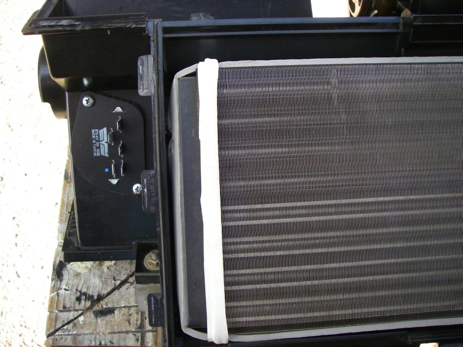

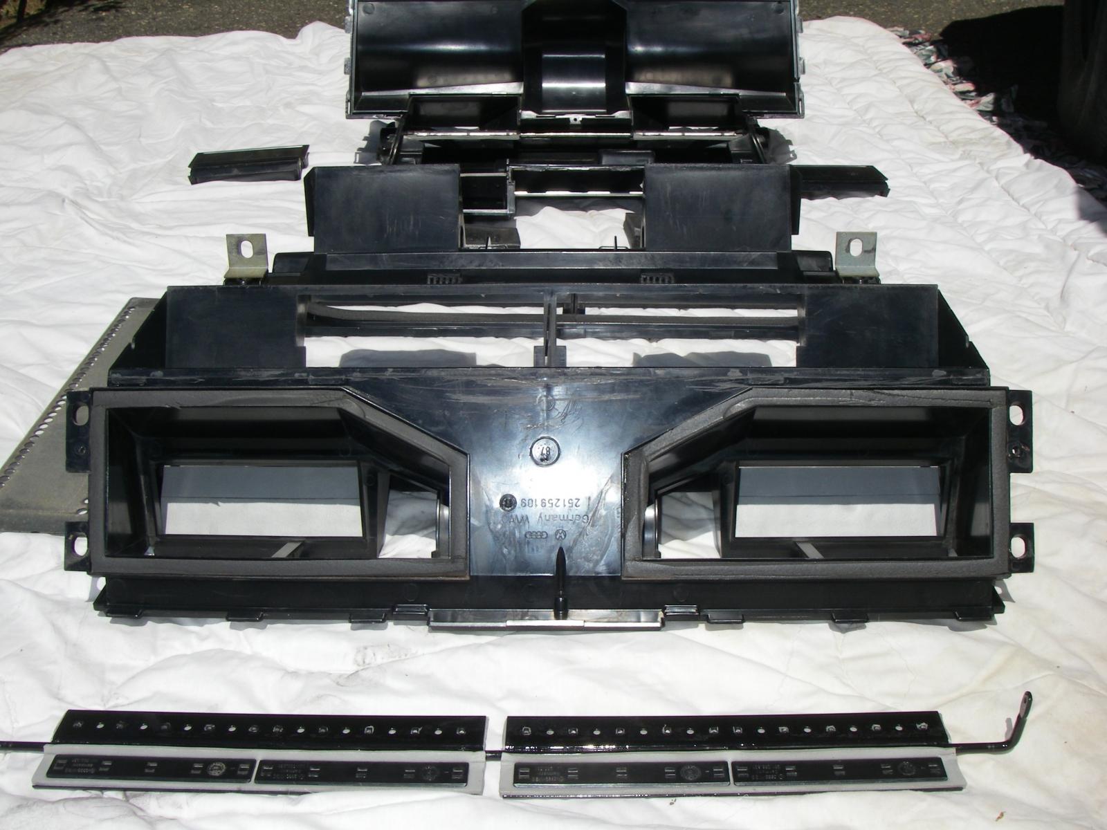

Removed dashboard and heater box. New fome seals (truck shell fome) on all three air control flaps, new fan, new jeep fan resistor (posted by dhaavers), And my old good heater core. Be carful splitting the box, I used a hot exacto knife, and careful with the internal flap retention clips. That have a little release button, do not force. Also take a pic of your flap orientation to refer to at reassembly. I'm looking forward to good air and temp control. $17.99 Jeep resister, $60.00 heater fan, $15.00 fome Total $92.99 running total $4889.66 [img]

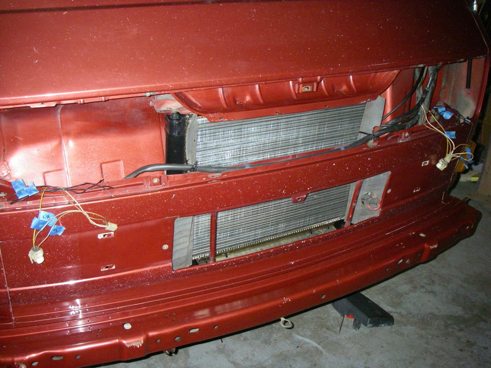

New radiator in. Easy R and R. Also took the opportunity to clean and paint fan shroud. $204.18 radiator, $79.95 front hose kit, $5.50 rubber pad washers. Total $289.63 Running total $5179.29 [img]

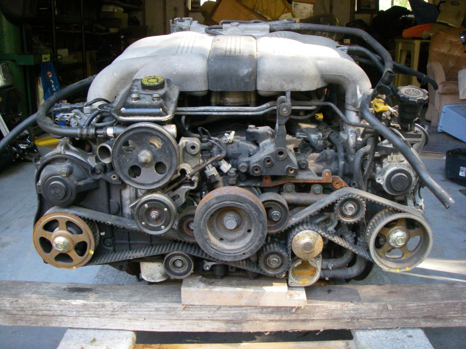

Got the engine ant trans out. Came out well. Easyer than I anticipated. Took a good look around plenty of dirt but no rust. Cost $0[img]

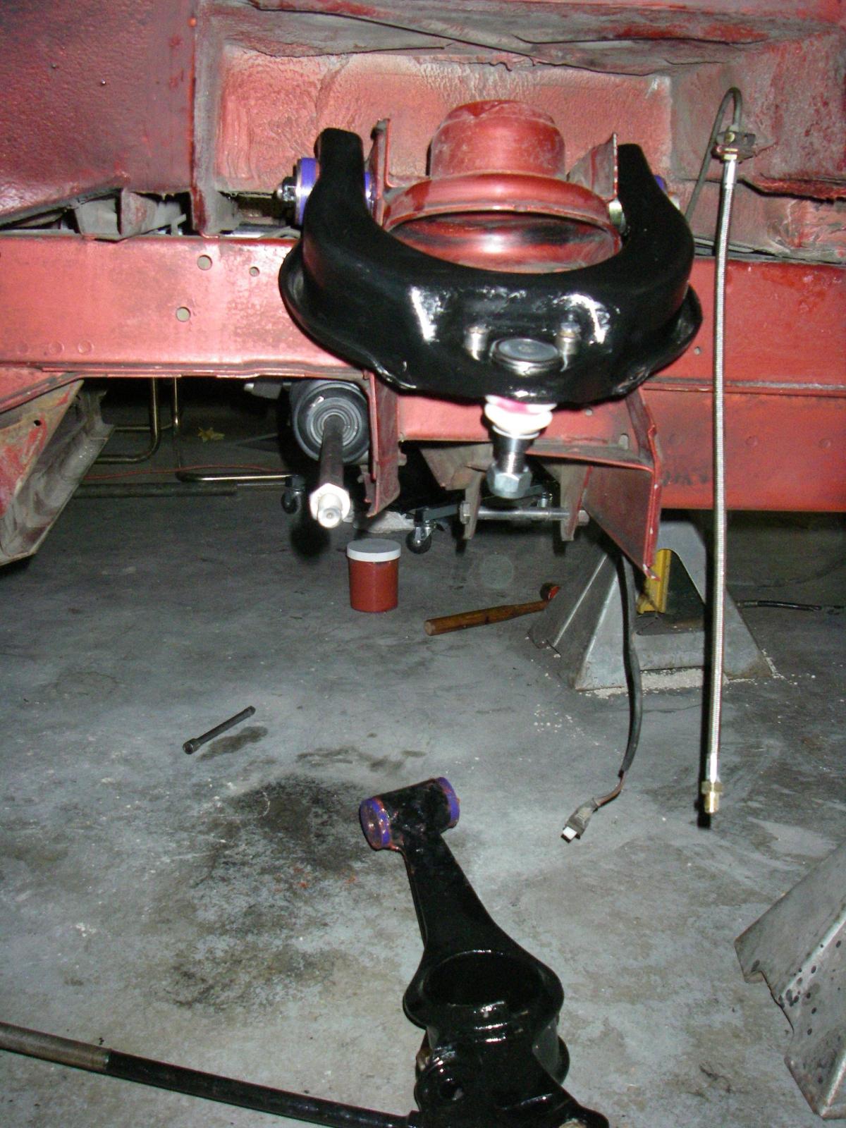

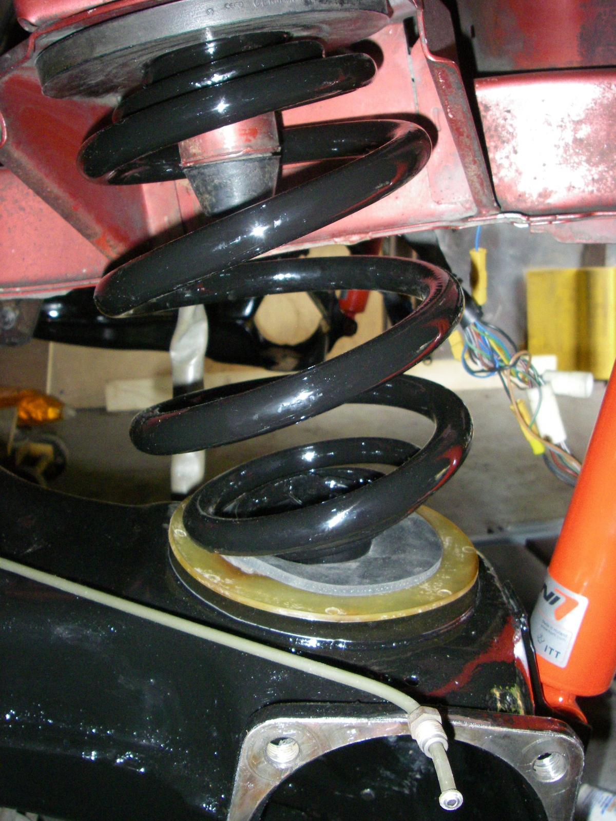

got after the rear suspension, again clean and paint Install new parts. Wheel bearing and seals $126.00, SS break lines $55.90, Slave cylinders $29.90, Break shoes $49.95, Break master cylinder $59.95, Koni shocks $215.20, Rubber spring pads $10.00, Power flex bushings $139.98. Total $686.88 Running total $5866.17[img]

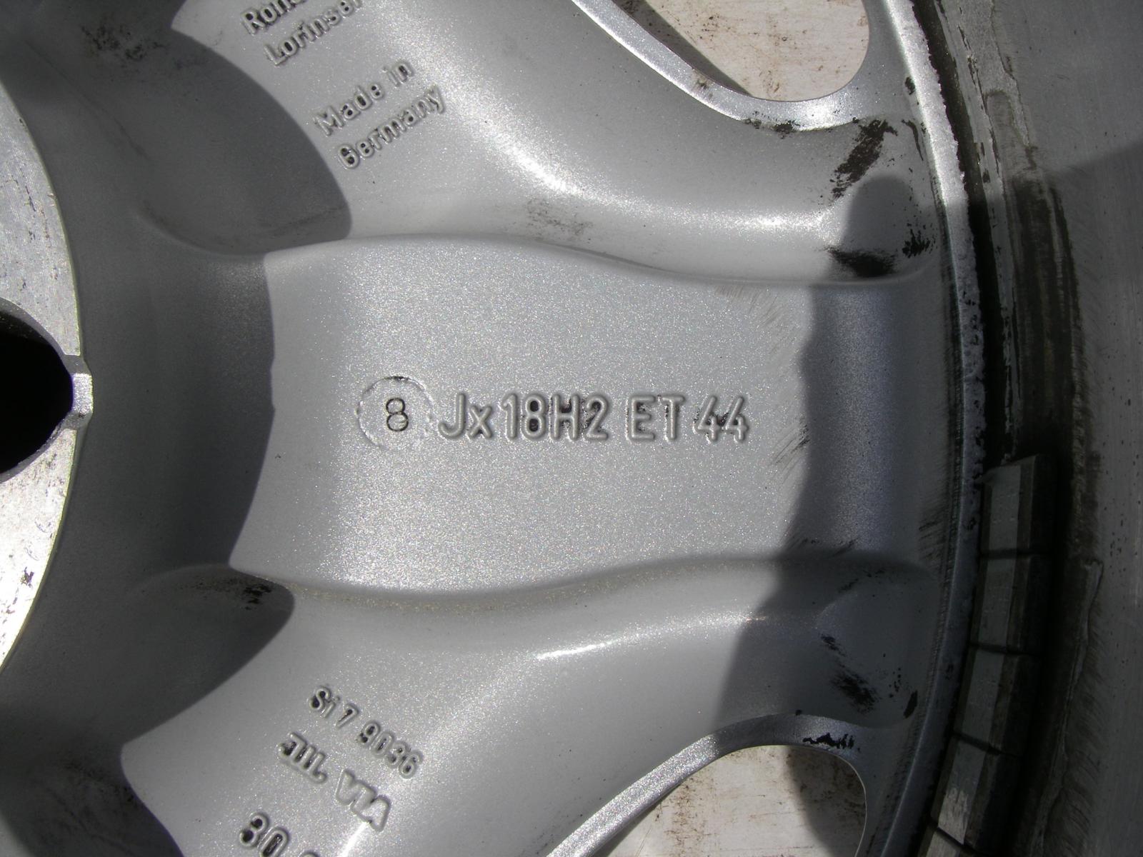

Time for wheels and tires. Lorinser and Hankouk, Fixed wheel curbing and repaint outer rim. Spacers, lug bolts, Studs and lug nuts from T3, Thanks Chris. Wheels $400.00 off CL, Tires mount and balance $804.80, front 12 MM spacers $79.89, Rear 20 MM spacers $79.89, Small ball lug bolts 45 MM $29.90, 65 MM studs $49.90, Small ball lug nuts $19.90. Total $1464.28 Running Total $7330.45 [img]

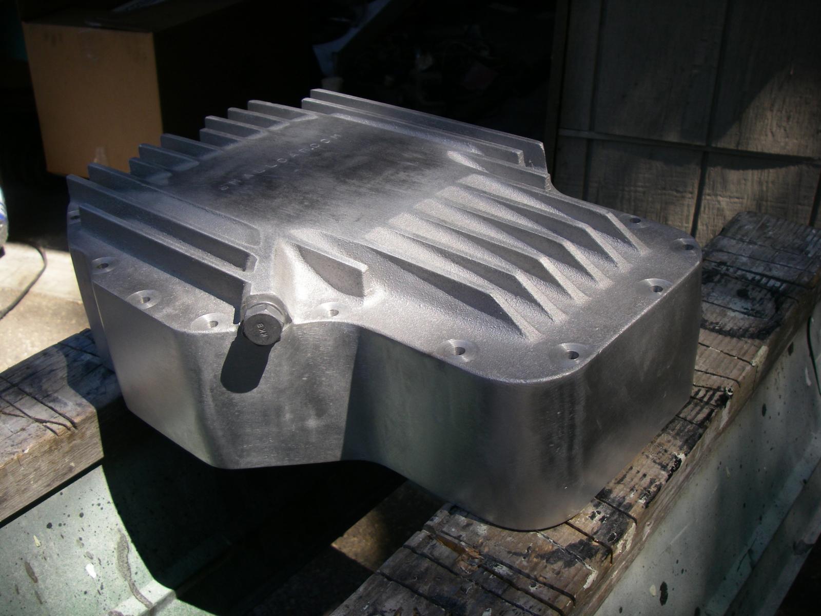

Took a belt sander to the SC oil pan, looks far better. Will ad pan to cost list on engine build up. [img]

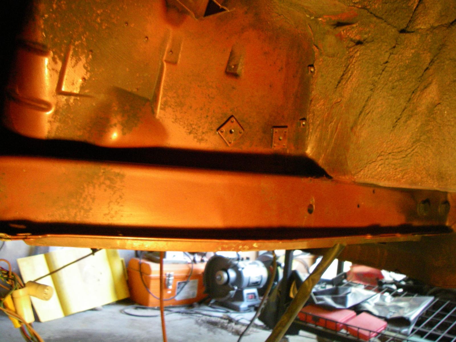

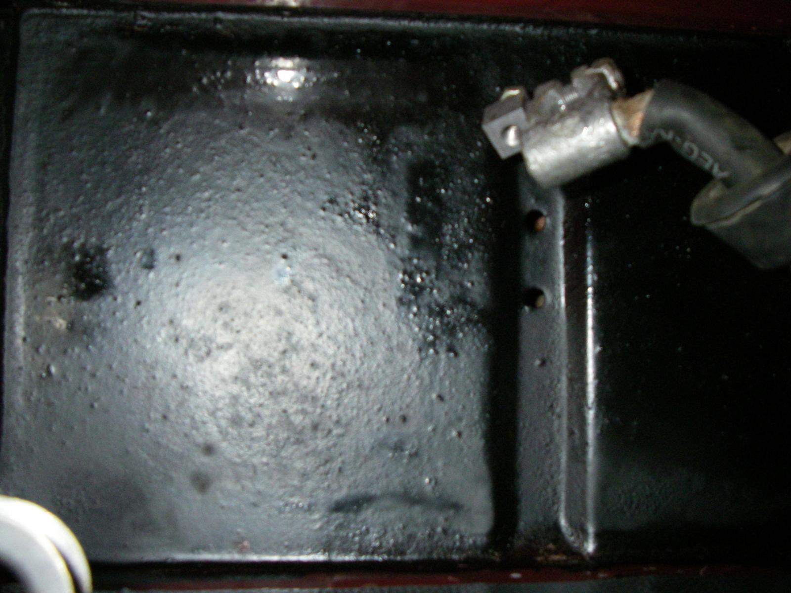

Under the seats looks great, I removed the battery and there it was, rust! Fortunately it was only surface rust, no flaking, so wire brushed, treated and Por 15. That should take care of it for a good long time. Also began installing Dynamat. [img]

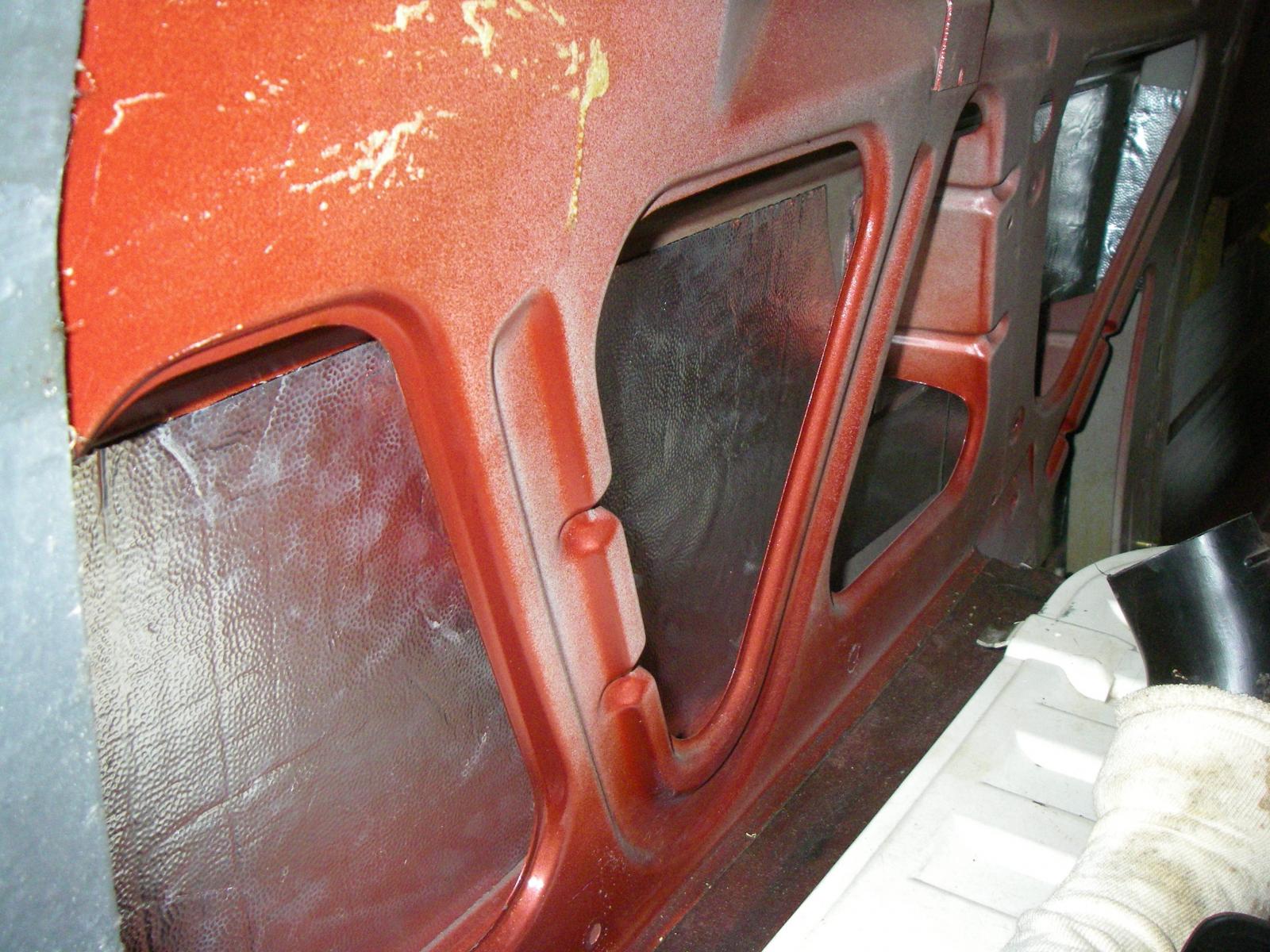

With the help of my friends, we installed Dynamat ( easy to work with) huge change in sound. What was once rang now it thuds. Also two to three layers of mylar bubble insulation. Applied with 3M spray adhesive. Cost Dynamat $178.00, Mylar $60.00, Adhesive $15.00. Total $253.00 Running total $7583.45 [img]
