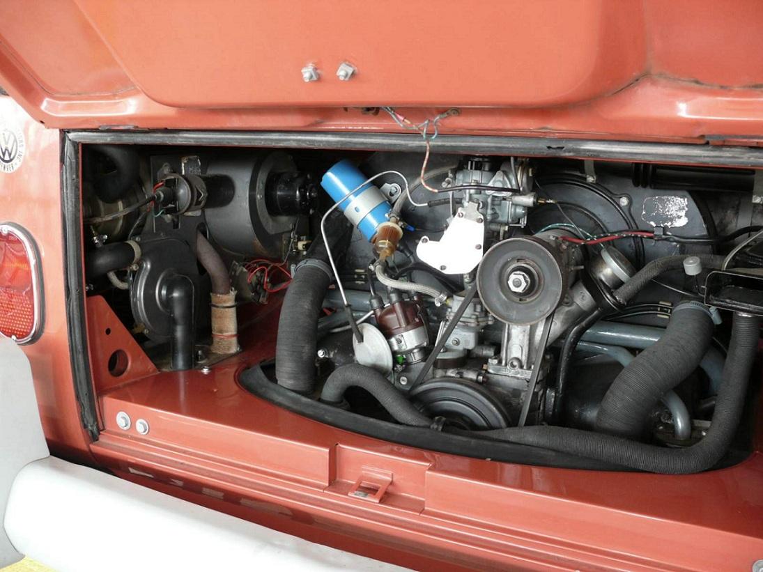

I searched the Gallery a little for an "original" 1965 Bus engine photo but didn't find lots of photos. There may be more in there though.
Here's one
from this search:
https://www.thesamba.com/vw/forum/album_search.php?search_keywords=1965+Sealing+Wax+Red+Microbus
Also

PostPosted: Wed Jun 25, 2025 4:58 pm    Post subject: Re: Stock factory engine 1965 Reply with quote
That’s pretty close. It does have a governor. The blue coil is not correct and I think they started out with the vacuum line upside down and bent it to fit that way which is distracting IMHO. And then there’s that fuel filter.contraption.

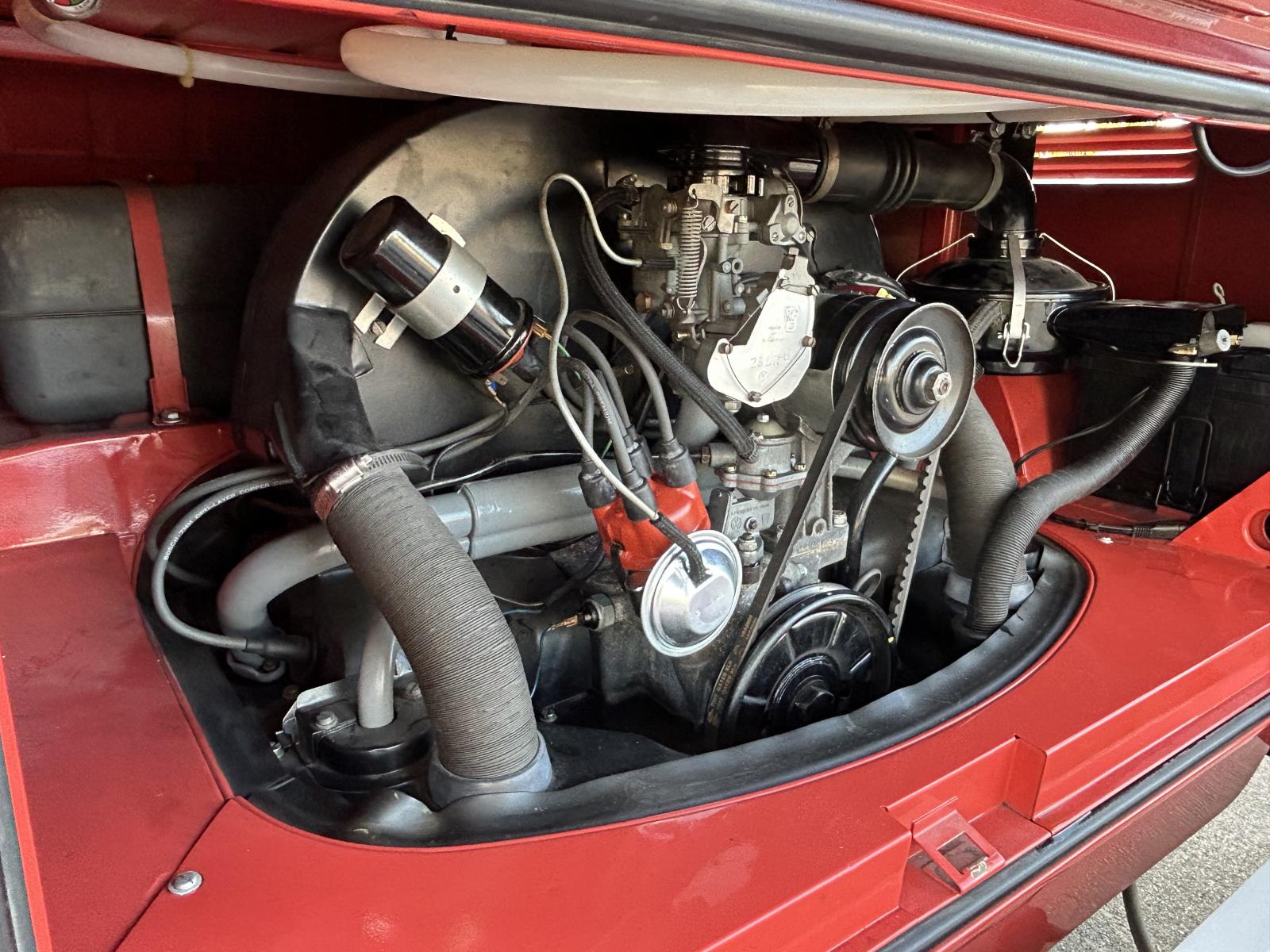

PostPosted: Wed Jun 25, 2025 6:07 pm    Post subject: Re: Stock factory engine 1965 Reply with quote
FWIW this is what I am staring with. Please feel free to tear it apart and tell me where I am wrong.
I already know:
- black is too shinny
- proper apron tin and hose hook. I have them.
- carb should not have vertical return spring
TIA

PostPosted: Wed Jun 25, 2025 7:12 pm    Post subject: Re: Stock factory engine 1965 Reply with quote
Looks really good. The lower vacuum hose should be reduced by about half its current length. The distributor cap should be dark brown. The tamper wire does not extend beyond the cover on the governor and should have a lead seal on the wire. The coil bracket needs to be exchanged for an earlier piece. The hose clamps on the air horns should be exchanged for original- they are fairly common.

PostPosted: Thu Jun 26, 2025 12:13 pm    Post subject: Re: Stock factory engine 1965 Reply with quote
Plus need hose clamps on top and bottom of each of the fresh air hoses.
Spark plug cables should be blue colored.
Spark plug plastic clips in the fan shroud should be a whitish color (nylon?).
Need proper factory style terminals on the generator. Not only for stock appearance, but for much less chance of voltage drops.

2. What would be a "OEM style electrical connector" other than not having the insulation?
3. Clarification on the copper comment. Your saying the vacuum and fuel hard lines are steel plaited with copper? Are you suggesting that what the higher end shops sell is pure copper? Why can't you use copper?
Thank you.
