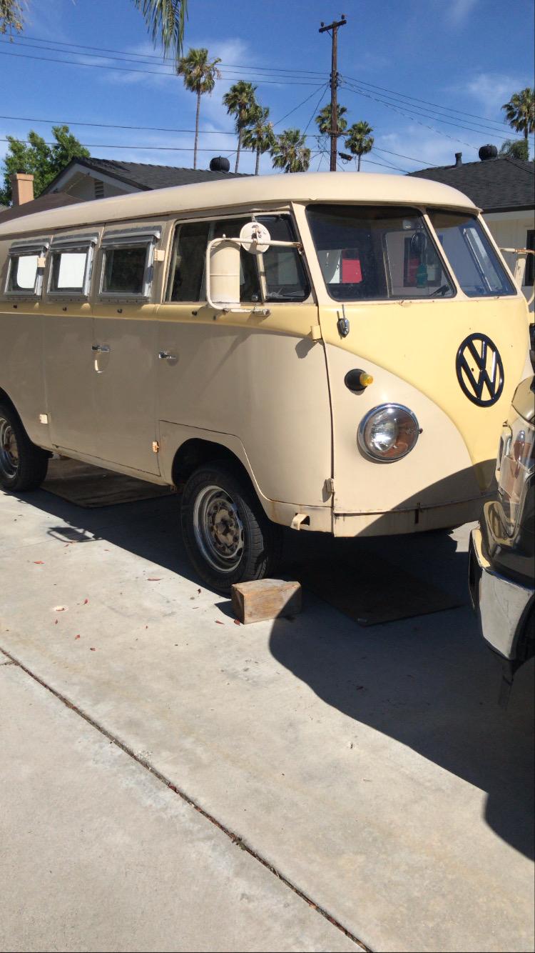

Hey I just picked up a pretty neat 1961 split window AKA the Butter Bus and looking to begin the project but I would love to know it’s original color before trying to put the panels back on and repainting it. The code it SK633B but I haven’t been able to identify the correct color yet. Any help helps thanks.

If that's original paint it's in incredible shape. If you go almost to the bottom of the paint code page to the SK codes you'll find SK633B is probably ivory, which it looks like your bus is. Maybe the B refers to the belt line color? Any idea who did the conversion?

I have seen that it says Ivory but it also puts a question mark after it so I was not sure. Also I have no idea who or when it was converted but it was originally in Oregon then came to California at some point.

I would caution original paint thoughts. The drums, door seals, custom cooling screen are paint matched.

Not original paint as the engine vent grate and gas door lock are painted to match. I would think ivory would be much more white.

Yep, you're right. Definitely a respray. See if you can find some factory paint hidden somewhere, like in the engine bay.

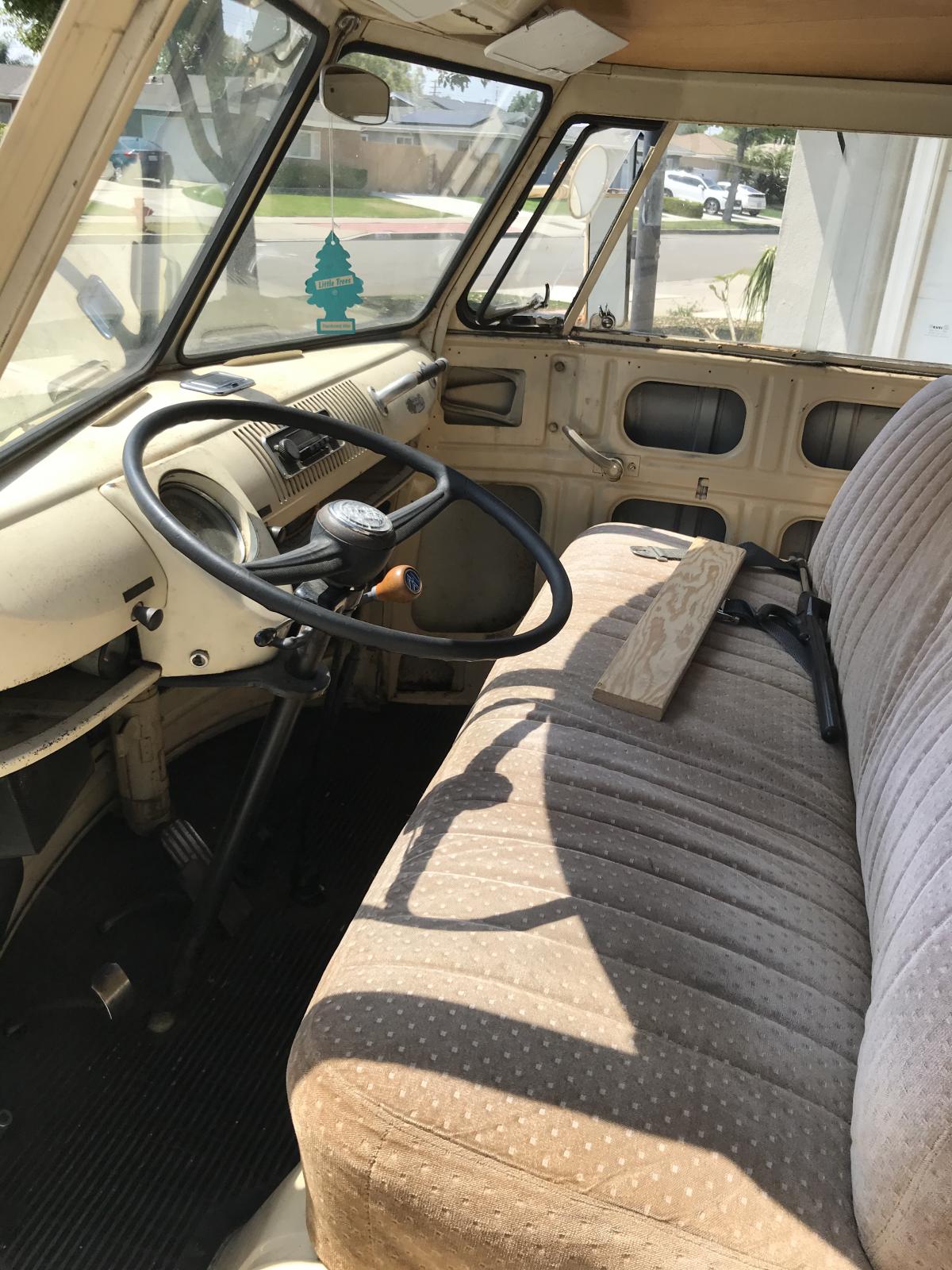

I’ll have to look but everything looks to be the same color as the dash and exterior.

Not original paint. Mechanism of the right front door is painted like the door.
Try to remove the front headlight and check if you see a paint code in the bucket.

It looks to me like this was an Ivory color bus. The interior paint on the dash and under dash area still look original to me. The entire outside has been repainted. You could try to remove the repaint on the outside and see how much of the original paint color is left. If it was me I would weld in the new rear wheel arches and weld in new rear engine cooling vents that were cut out and start stripping paint. I used Citri-stip on my old double cab and had pretty good success.
