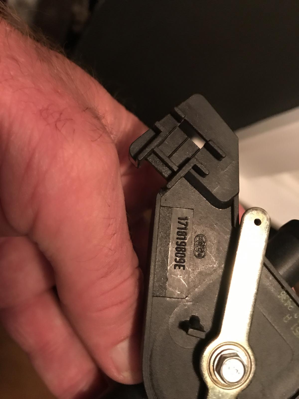

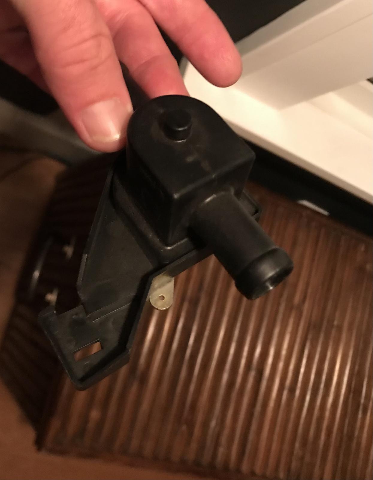

Here is the valve.
Apologies for rotten pictures. I’ve done some searching on the issue. Can’t find this particular part as a cure for Hot Foot. It’s probably out there Embarassed

do the ford valve

In the stickies is found all sorts of information.
This link to installing the Ford Valve is in there.......
There are location options, I've done the stock location up above the spare tire and I've done the location inside the vehicle.
https://www.thesamba.com/vw/forum/viewtopic.php?p=6335569#6335569

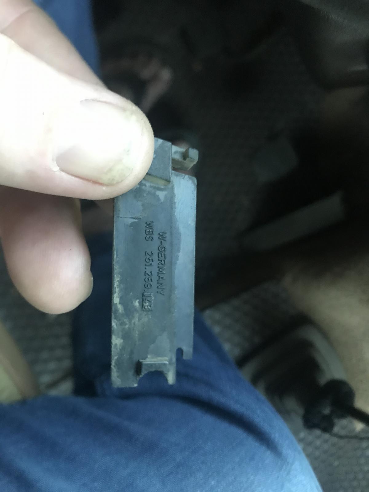

I took off the panel/cover in front of the shifter. This thing falls out. I look up part number and see it is this. Heater box bearing plate. Not exactly sure what it does or if it’s broken or where it goes. It just got dark so I’ll investigate later. Could this be related to my “Warmish foot” issue? If this is in The Bentley don’t hesitate to tell me to pound sand Wink
https://www.gowesty.com/product/fresh-air-heating/25016/heater-box-bearing-plate
This is marked L (Left) on the backside

This supports one side of one of the foam covered flaps that are moved about by the heater controls. Not sure if it is the reason for hot foot, but it is not in the place where it should be obviously.
I solve a lot of cold and hot exterior air problems with the Vanistan fresh air kit https://intrepidoverland.com/shop/cabin-air-control/ and have been very happy with it. I suspect that is not your problem, but if so, there you go.
I also took the dash out and the heater box and redid all the foam flap seals and lubed all the heater control cables. Made things work so much better and way fewer air leaks. This may help your issue and will certainly make it easier putting that little plastic part back were it belongs.

That piece is definitely broken - missing a tiny tab that you can see in the last picture in the GoWesty link. There are 4 of them altogether. If some are broken, and they probably are, the metal rod holding some of the flaps will slip down - I know - and the flaps will not close properly. Some folks have 3D printed them, but it's hard to get a good fit. Depending on your motivation, it might be easier to bite the bullet for the 4.95 and replace it. I tried taping one in place with duct tape - lazy idea that didn't last.

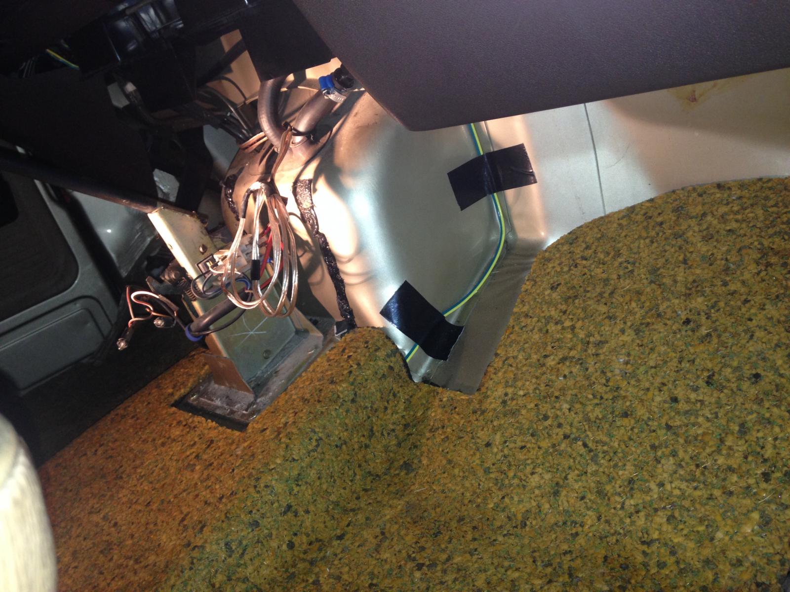

From my 86 build thread……..
I too am a barefoot driver, even in the dead of Winter across the Prairies with the snow blowing….. I hate those foot prisons others call socks!
A lot of my hot foot came as radiation through the steel floor.
The quoted repair below reduced the hot foot problem substantially!
djkeev wrote:
Last Summer on our 7000 mile journey West, the heat from the radiator radiating / leaking into the area around the shift lever was almost unbearable!
The entire tunnel area was blazing hot. This made for a less than pleasant travel experience at times!
Especially across North Dakota in Sunny 97* heat!
When I was redoing my Van I had read about insulating this area because of this heat but thought "How bad can it be?”
Answer?
HORRIBLY BAD!!!!!
(My heat is not from bad flap seals, which are redone ....... or from a leaking heater valve, which was replaced PLUS a TK inline shut iff valve installed. This IS radiator heat.
http://www.thesamba.com/vw/forum/viewtopic.php?t=237271
(Believe what you read here on this site kids!)
So I had picked up some reflective insulation in the Fall. I just took out my front carpet and lined the entire area with reflective insulation.
To hold it in place I used a combination of 3M double sided car trim tape and clear tape used for attaching plastic weatherstrip over windows in the Winter.
It went well..... I've no clue if it will work but it certainly cannot be any worse!
I also stuffed some foam pickup truck cap insulation down in the shift lever cavity (Automatic) which should mitigate any heat leaking through there.....

PostPosted: Wed Sep 22, 2021 9:11 am    Post subject: Re: Another Hot Foot question. Reply with quote
I added the ford valve on the interior heater hose and it works great. I left the stock valve open in place.
Notice that you can use the stock heater cable to activate the ford valve.
