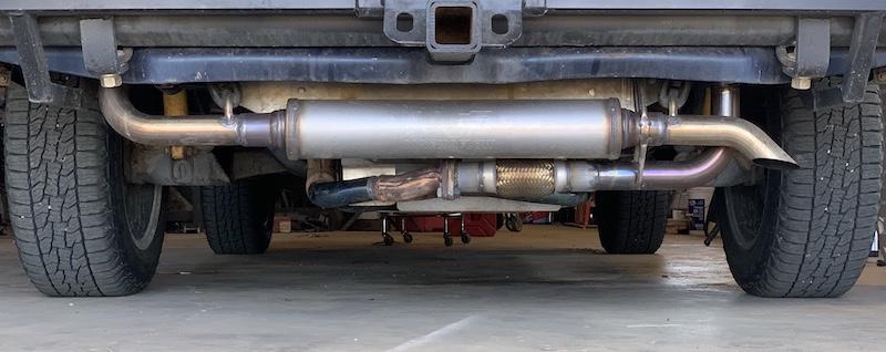

and exhaust system, made from Subaru parts, motorcycle exhaust parts, and pre-bent sections from Summit Racing.

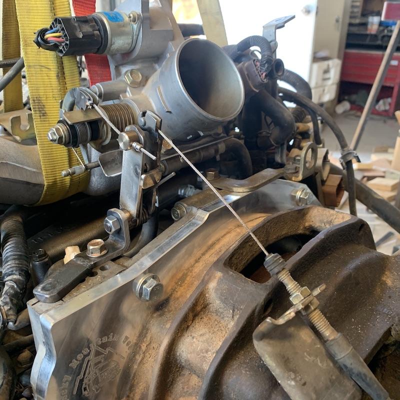

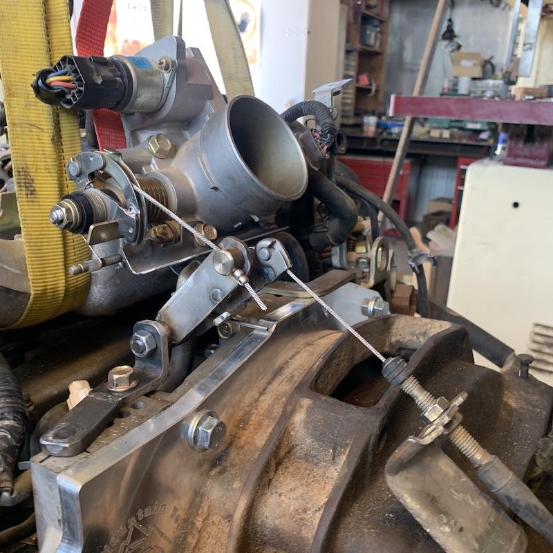

One of the cooler things I did was this little intermediate arm mechanism in the throttle cable system which allows the proper functioning of the automatic transmission kick-down. Basically, the two arms act as one because of a torsion spring sandwiched between them, until the arm which is cabled to the throttle shaft reached its hard stop. Then the other arm, cabled to the accelerator pedal, can move just a bit further, which enables the transmission kick-down. It works perfectly.

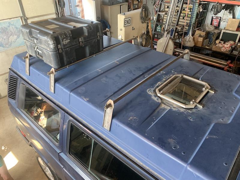

I also made a new sunroof (functional) and fabricated a quick roof rack from stainless steel, which certainly came in handy for removing the pop-top when it was time to replace the mouse-eaten canvas.

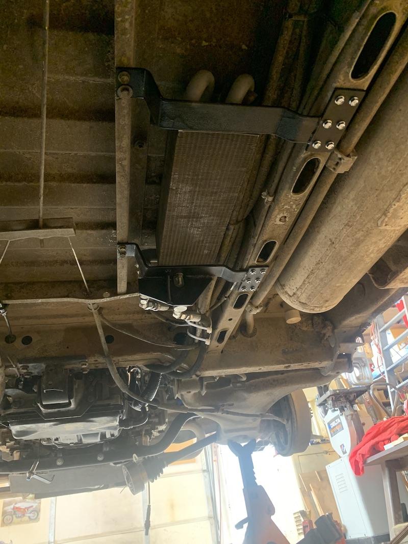

I set up an air-to-oil transmission cooler, using JIC hydraulic hoses...
as well as an air duct / tunnel to forcefully direct the air coming through the gas tank "valley" over the cooler.

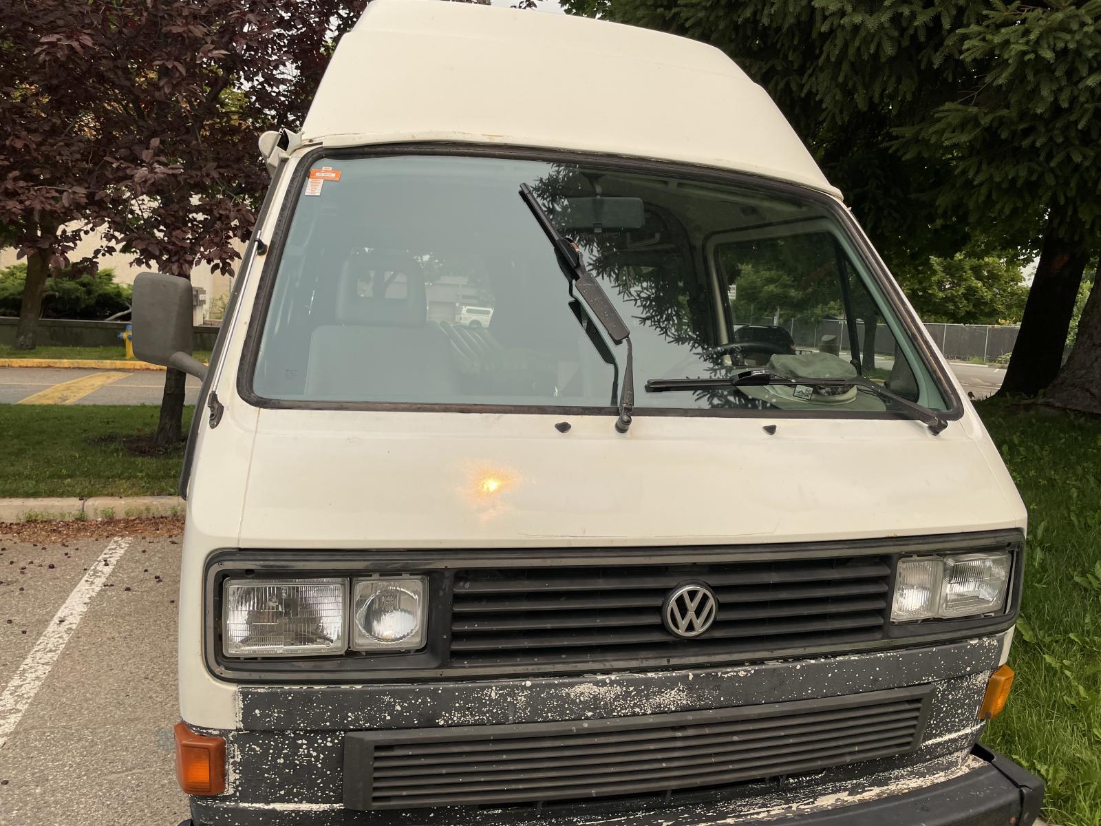

And lastly, I added set screws into the wiper arms to keep them from moving around... which they otherwise wanted to do...

Impressed! But, the mod to the wiper has me a little confused. It seems that indeed, the wiper problem exists and I have indeed had it happen multiple times. The issue with doing the shown mod is that the arm is actually designed to be the thing that gets wonky, strips, whatever --- and thus saving the rest of the wipers system that are extremely difficult to repair. An arm is super easy to replace compared to pulling the dash to replace the other bits. No?

Right. The wiper arm is the failsafe to protect the splined motor drive ah.. thingie, which is very hard to replace.
You pick out the brass or Al that is smudged in the grooves between the ridges on the motor shaft thingie, put new arms on, and everything is groovey.
hard to tell but his may already be worn/damaged... so if he has to tear into it again the motor will have to be replaced if the set screws are tight enough

All the folks with concerns about the wiper mounts:
Actually it did occur to me that the splined cone might be something like a "slip joint", protecting the rest of the system. I initially did a very good job of picking out the grooves, but the wipers didn't stay put for long. So... I decided to risk it with the set screw design. I'm aware there is a risk. Consider me a test case for this concept! I will update with results when they are available!

Interesting mod on the wiper arm. MIne were going funky and I cut the top off and drilled and threaded a bolt down into it. Works a charm. That one van has the wipers switched . the foils should be on the drivers blade.

Let 'em rip. I've been through too much crap with these. I've picked the splines clean, I've used Loctite, spring washers with proper torque... the day still comes when this alleged "failsafe" proves itself too eager to prove its function.
Cheers
if you own a macro lens, you might want to take pics of the cones
or just inspect carefully with a magnifier - my bet is they are worn
I dunno if you can buy new ones sep. from the whole motor, but even if so the labor to get the thing out of there is so huge that mere money will seem negligible in comparison

Happened to me, I had to buy new wiper arms the cones were so worn out.

Maybe go with a nylon set screw to provide fsilsafe function ?
