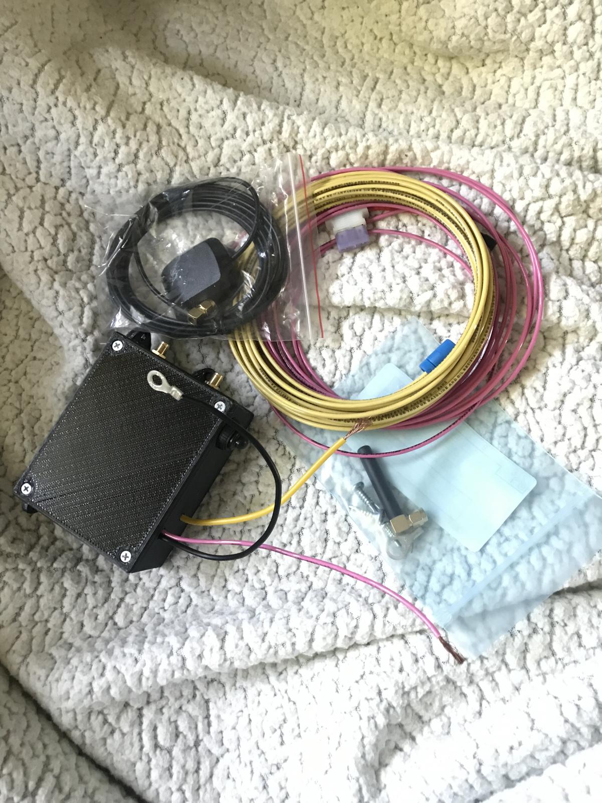

So I use my Van for work.
It is packed with tools and while not priceless or irreplaceable, I don't desire them to walk away.
In Jersey we had instances of contractors shopping for supplies and while they are inside, someone cleans out their work Van!
I want tracking of my Van if it is stolen but almost more importantly I want to be notified if a door is opened.
The Van Tracker does this!
https://www.thevantracker.com/
I've owned the Van Tracker for Months but have been too busy to install it. I think of installing it, or more precisely of NOT having installed it, every time that I park and walk away from my Van.
I am hoping that the next few days will let me install the Van Tracker.
I pulled it out this evening and began figuring out what needs to be connected and where the components should be mounted.
Josh has been super helpful as I Email him with stupid questions!
It really isn't complex at all.
I'll make a tutorial about my install and setting it up.

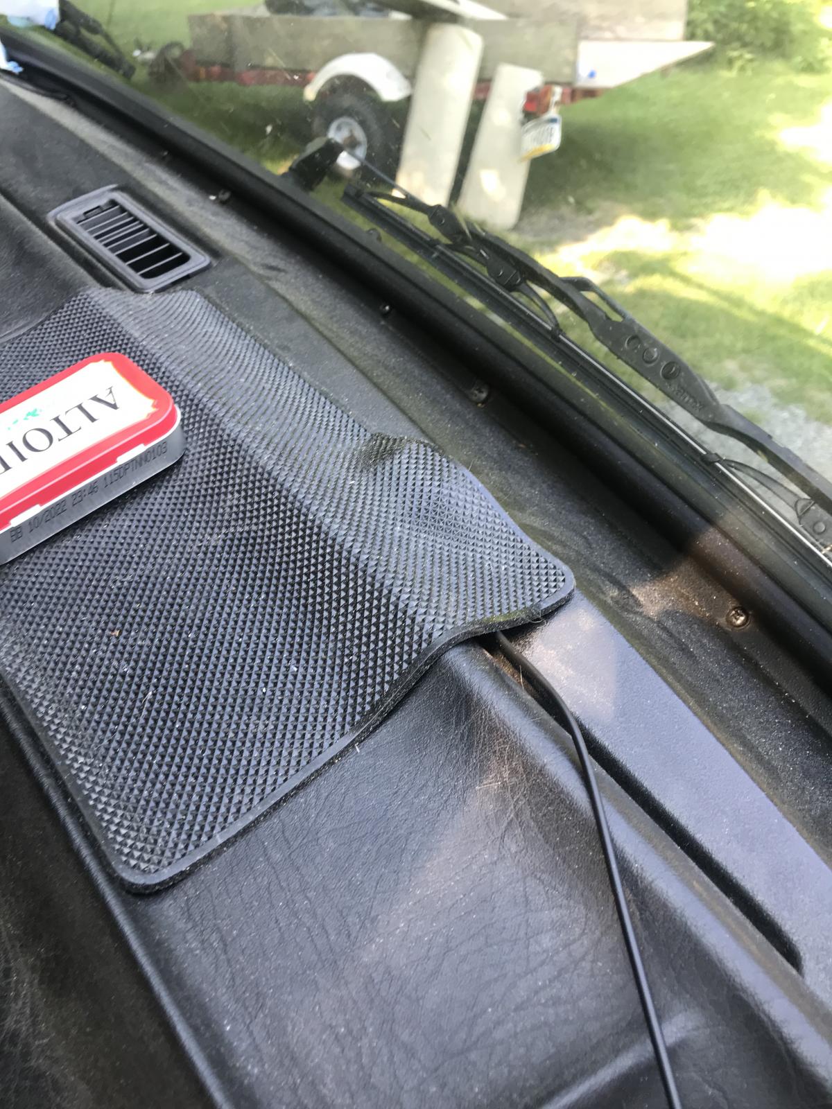

The GPS antenna is the black plastic item on the long wire.
I have a Tintop, any educated guesses or experience on where it the best installation spot?
I cannot see effectively hiding it as I did in my Westy, but then again? What do I know?
I am thinking behind the Right "D" Pillar plastic cover? But no view of the sky.
It may be better to not even try to hide it and simply place it on the dash in front of the passenger. Throw a map (a MAP?!! What the heck is a map?) on top of it.

dobryan wrote:
This would be a good question for the maker. He likely knows how good the antennae is inside a tin top.
It's a tad early in Texas!
Anyway, I think I have my solution, hide it in plain sight!
I have a anti-slide pad on my dash tray.....
It isn't a perfect fit and I've toyed with cutting it to fit but I really don't want the cut edges exposed.
To that end as I debate what to do, I installed it and it over hangs the front.
It just so happens that it covers the metal front edge of the dash assembly!
The GPS antenna is magnetic so it just grabbed right on tight!
I'm thinking of drilling a hole for the cable which will be covered by the mat also.

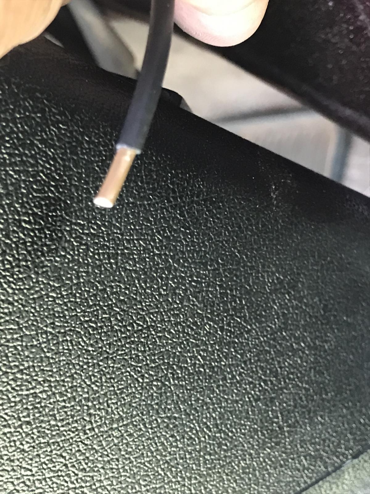

Josh suggests a fast dirty hook up to verify operation before mounting things and running wires permanently.
Because I plan a behind the glove box location I figured I would tap into the RF door brown light switch wire.
There was no brown wire to be found!
I looked and reached but only found a black wire!
Odd……..
I finally unscrewed the switch and tugged on then brown switch wire……
The BLACK WIRE MOVED!!
Odd……..
never have I ever seen a black door switch wire!
And where does it change to black?
I tried the fancy tap device Josh includes but the black wire was way to big for it!
Odd……..
Oh well, I cut the black wire to make up a plug in terminal connection.
I snipped it and stripped it.
But stripping it only removed the Black!!
Inside?????
A brown wire.
Must be some sort of an abrasion protection sleeve.
Oh well, live and learn.

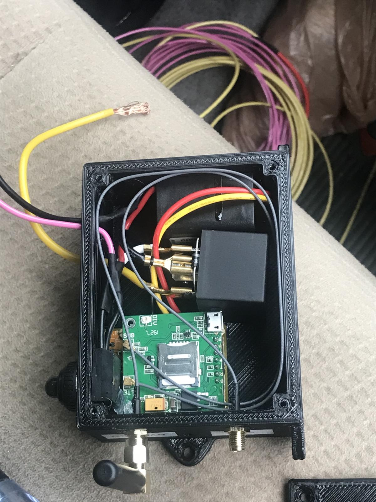

A few days ago
I did some final placement and hooking up wires.
My unit is up behind the glove box.
You need to have available access to the unit but not a daily access. So a hidden spot also needs to be accessible.
It has an on/off switch and it has an indicator light that blinks. This is why access must be available.
By counting the blinks (not unlike an old OBD I system) you then can understand what is happening and if you have connectivity.
Anyway I initially used command Velcro strips on the back of the Van Tracker and mounted it on the side just above the ram air/crash beam vent into the door jamb.
This location was GREAT!
Until I closed the glove box and the anti fall open hook smashed into the side of the Van Tracker and knocked it off of the velcro mount! Rolling Eyes FAIL!
Right now it simply sets upon the crash beam awaiting a better placement but it is secure.

Right now I pulled +12v unswitched power from the fuse panel in a dirty male fitting into the unused #1 relay plug (top left).
This doesn't satisfy my hidden requirement so I'm going to tap into the cigarette power right there where the Van Tracker lives.
But again, I'm still in the testing phase of this installation.
I've had a few stumbles but I think they are mainly because I am NOT electrically or technology savvy.
I've had to figure out the text commands. Josh lists far more commands than the unit accepts.
There is a GPS location bug that makes the unit think it moved when it didn't and I get a text in the middle of the night.
Josh knows about it and is sending me the fix for it.

I'll add some photos.
Because I’m curious and need to see what is inside things……
You can see that I also added labels to ID the various plugs And wires.
