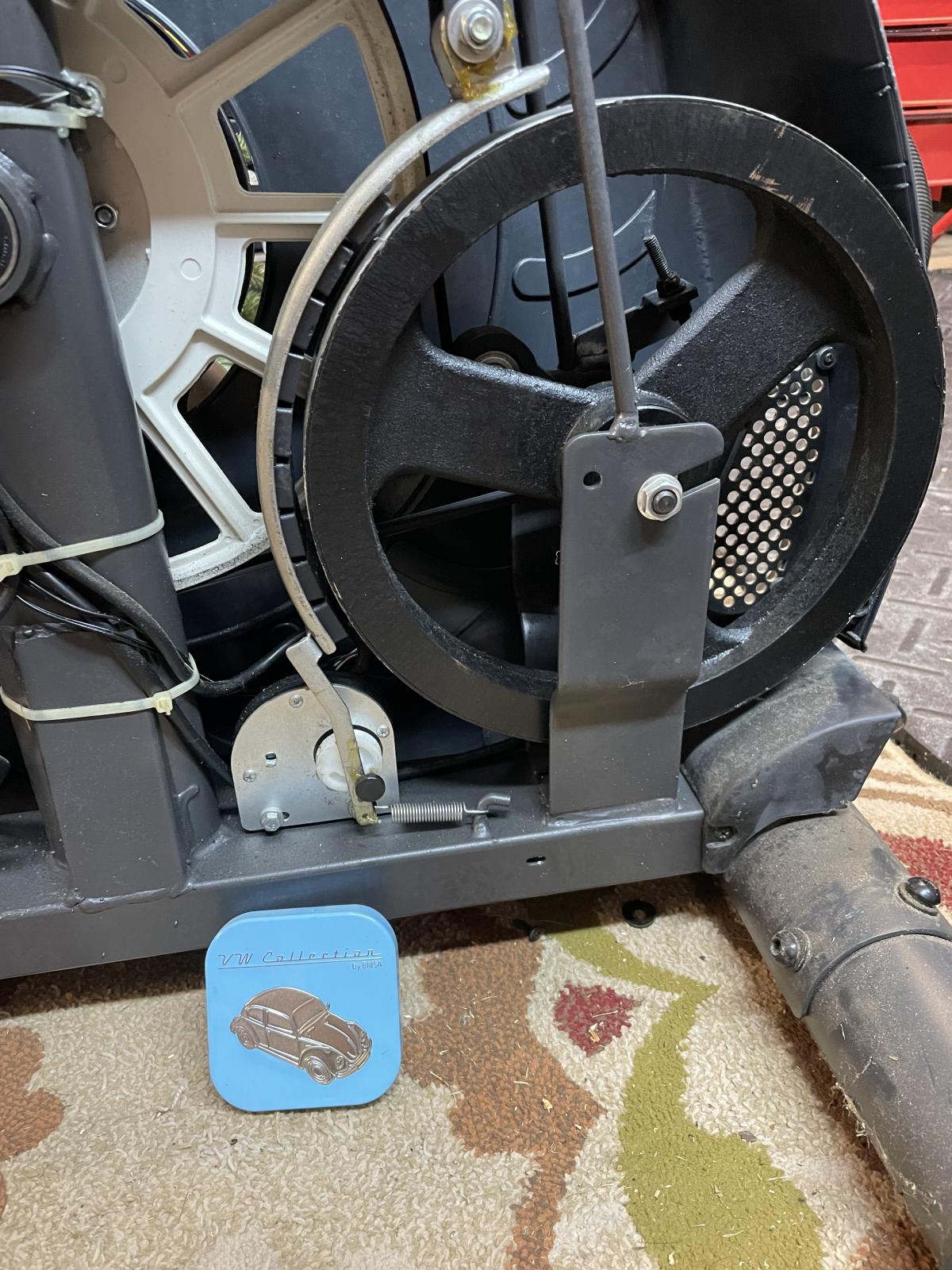

I have had this Schwinn elliptical for about 5 years so it's out of warranty. The problem I'm having is with the resistance. When you turn it on, it resets to the lowest setting like it's supposed to. Then you start start in the manual mode and everything works as it should. But when you start to add resistance, the motor works and it keeps cycling to all the way on then all the way off, continuously. You can turn it off and it goes back to the lowest setting. I've tried googling and about the only thing I know to do is replace the motor - or I may just take it to the dump.
I've tried turning it on and off multiple times.
I've tried unplugging it multiple times.
The motor works and varies the resistance but won't stop cycling.
I am using the manual mode, as I have always done so it's not a program problem.
The motor does not have an on/off switch.
Does anybody have any other thoughts?

I should probably clarify further, I'm thinking if I have to replace something, it would be the motor control board.

is it possible to bypass the motor control board and rig up an on/off switch to the motor instead?

It's not power assist - it's inductive resistance to make it harder to turn the wheel. Of course, in the OP's case, I'd be tempted to simply hook the magnetic band to a rheostat to see if the resistance can be adjusted that way.

The motor moved the bank of magnets closer (to make it harder to pedal) or further away (to make it easier to pedal).
