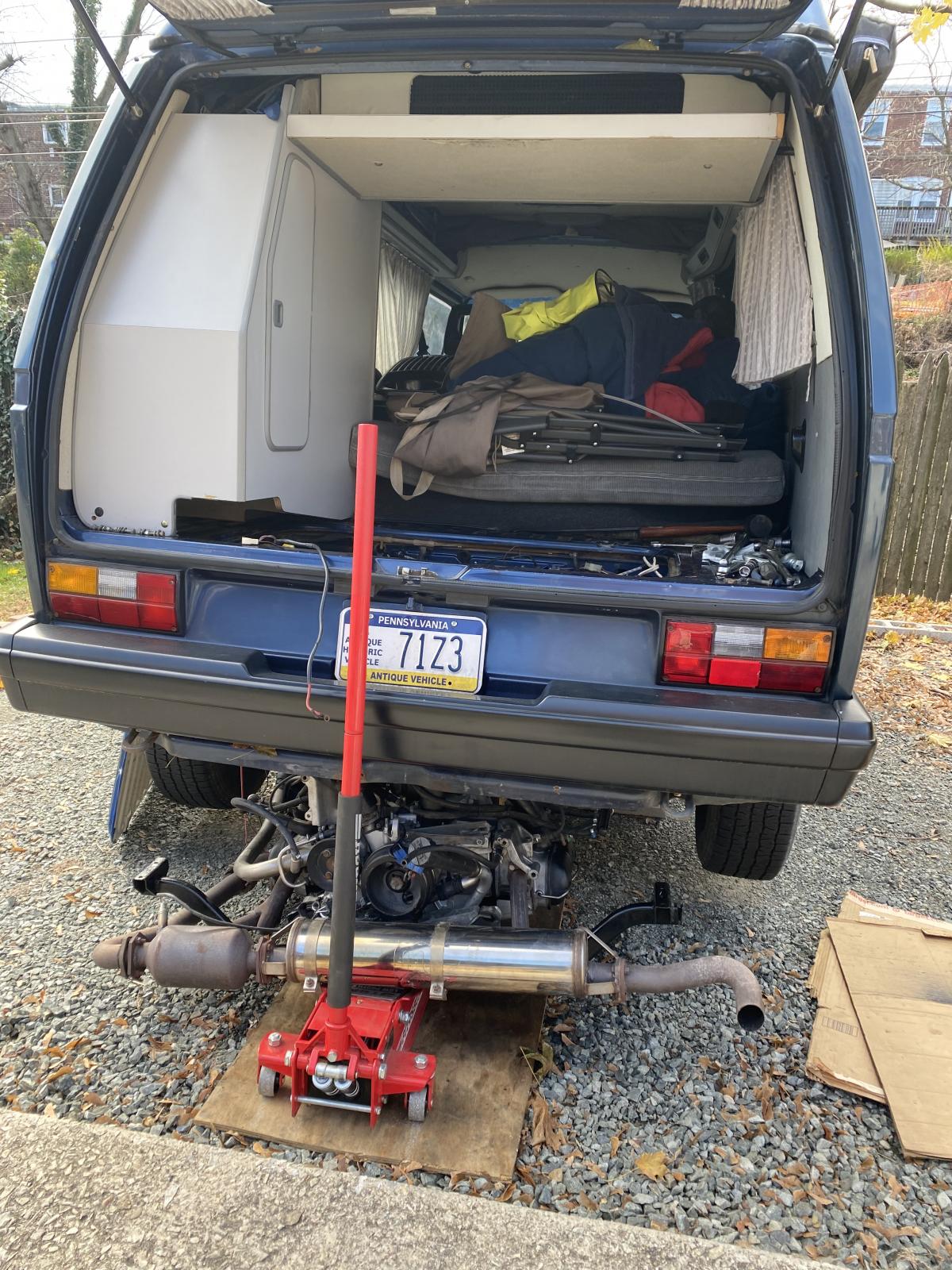

i've stopped using the wench above the engine method in favor of a floor jack. it allows great control when connecting/disconnecting the engine to the tranny.
the transmission MUST be supported when the engine is removed. i lower the engine still connected to the transmission (it pivots on the front tranny mount) and rest it on blocks about 1 foot from the ground.
the engine will easily pull back once disconnected while supported by the floor jack. once the lower studs are clear of the bell housing, the engine can be lowered fully on the floor jack and pulled out from under the Vanagon.
DO NOT remove the torque convertor from the transmission... i use zip ties to hold it in place once the engine is out. this will keep fluid from leaking, prevents damaging the spline shaft, and keeps the threaded hole in the proper location for attaching the flex plate when you reconnect the engine.
the ideal height from ground to the sheet metal below the bumper is 24" - this allows the alternator to remain attached.
i've done this too many times. also, use a shop vac to remove the coolant, takes about 10 minutes, crack the radiator bleeder just a little.
i really should have documented the entire process i use. i have a feeling i'll be able to do just that next summer Smile

Jacks work but they are tippy and in my humble opinion dangerous.
Things slip and fall.
The winch prevents the fall. I still use a Jack but as an added boost in certain areas, not carry the complete load.
Oh! the number of boxer engines I've dropped on a single Jack………

PostPosted: Thu Dec 23, 2021 7:03 am    Post subject: Re: dropping engine with automatic transmission? Reply with quote
i should note that i have mounted a wooden support on the jack to prevent the engine from wobbling and falling over. the ability to pivot the engine on an axis allows for rather easy alignment to the bell housing.
ymmv.
