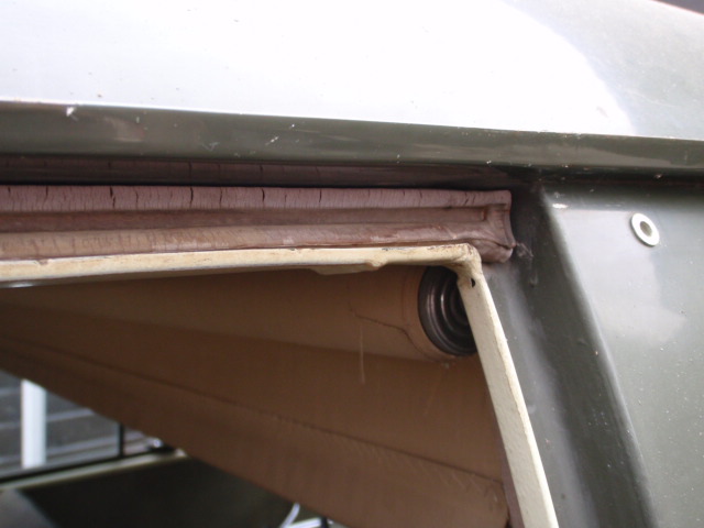

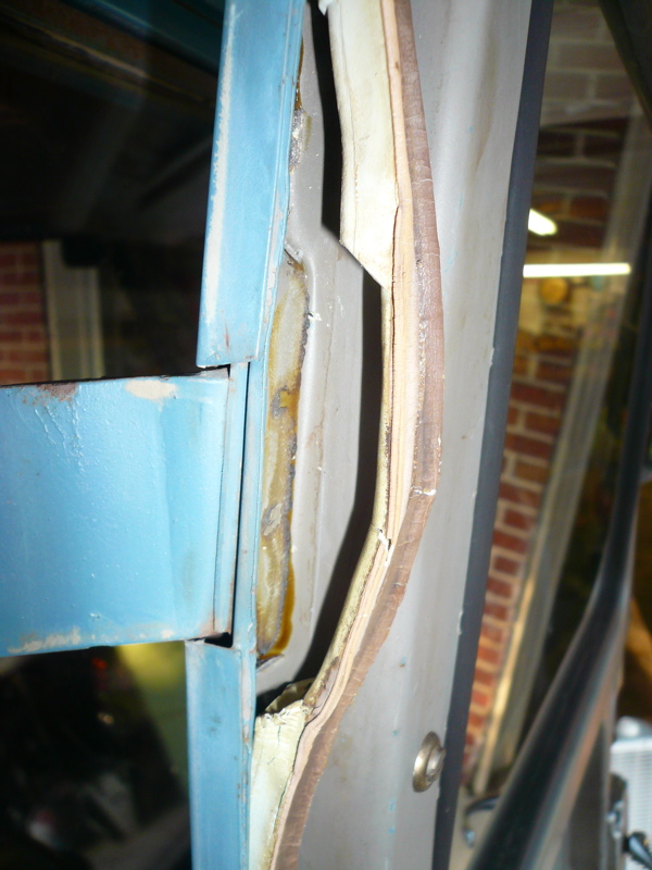

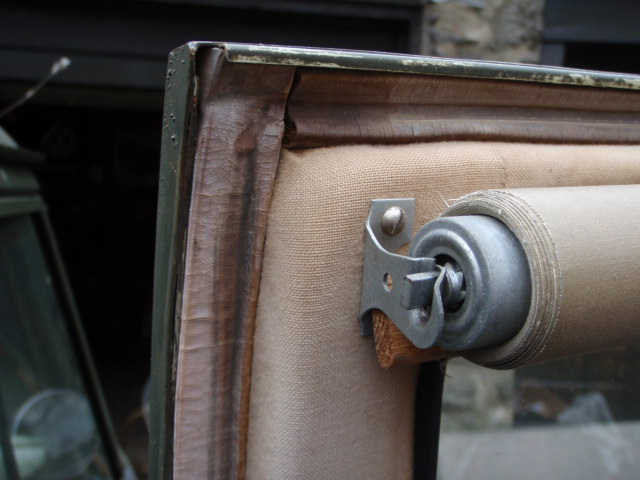

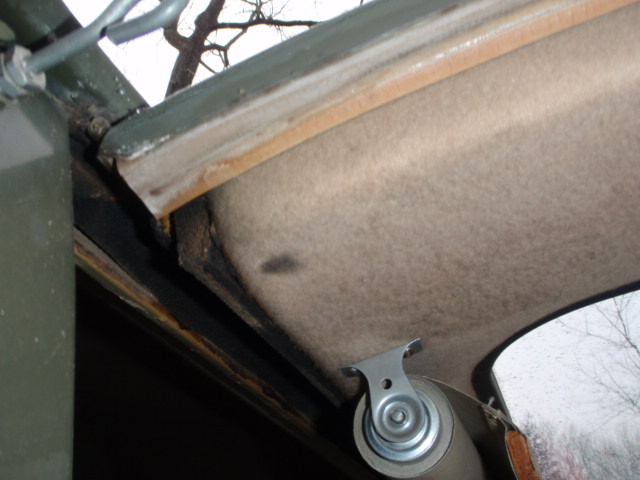

npbusguy
Joined: February 08, 2006
Posts: 1661
Location: Budapest, Hungary
npbusguy is offline

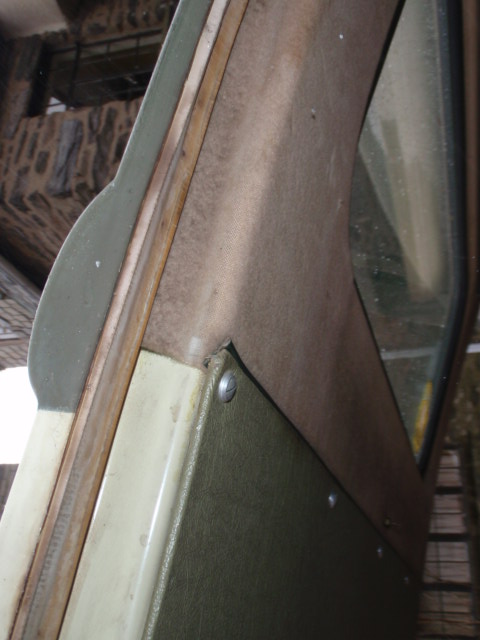

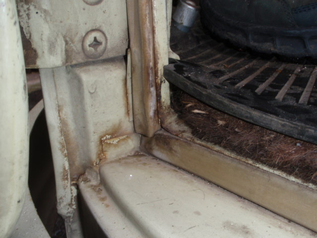

PostPosted: Tue Oct 20, 2009 1:43 pm    Post subject: Reply with quote
Pix are of Gibbs' 57 standard which is an excellent resource when trying to restore a late 50's bus. Cool

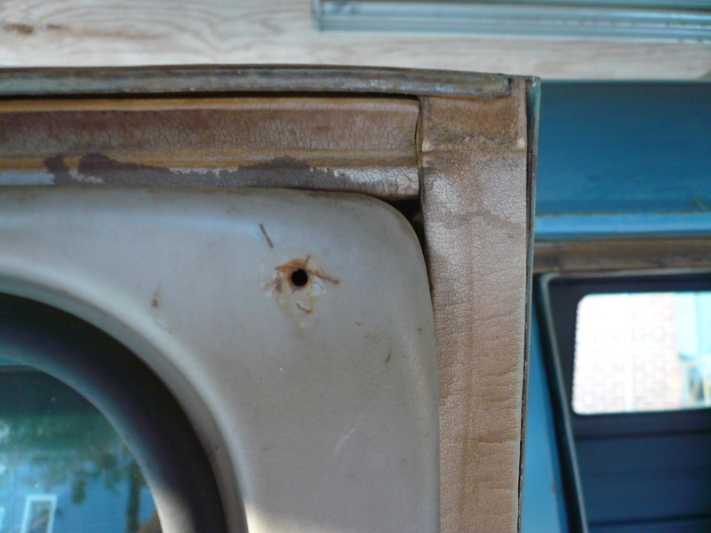

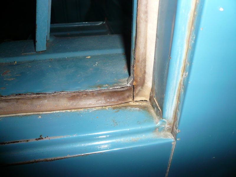

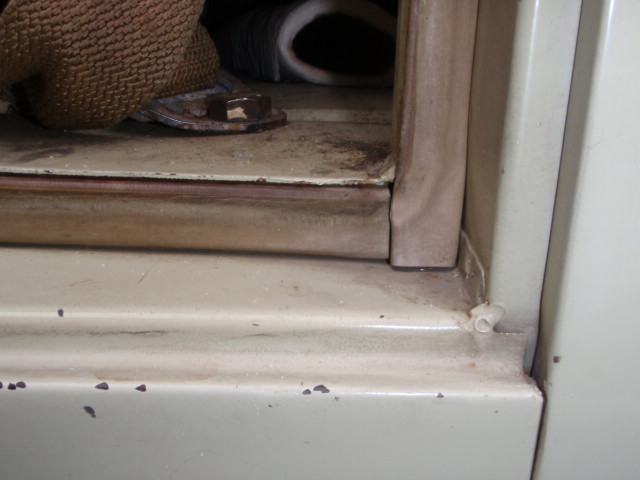

PostPosted: Thu Oct 22, 2009 6:06 am    Post subject: OG door seals 1956 Kombi Reply with quote
Joey,
Not sure that anyone has posted the funky shape the seal has around the hinge area on the cargo doors - I trimmed my new seals to a similar shape to lie flat. The other pics are just my OG seals and placement. Wish they were soft enough to keep, but they don't seal very well.

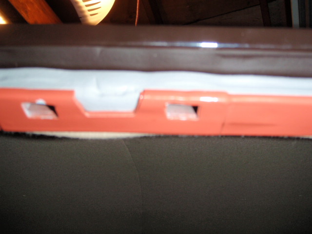

PostPosted: Thu Aug 01, 2013 10:14 am    Post subject: Reply with quote
Some more pics I found
Some cargo door rubber install pics from Neil's '58 Deluxe
NOS cargo door rubber, this is the horizontal piece on the body, you can see how it is shaped around the locking holes on the body

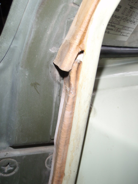

PostPosted: Wed Aug 27, 2014 2:08 pm    Post subject: Reply with quote
With the OG front door seals, they were sliced and lap glued...over each other, where the body bulges out...just above the beltline. I'm using the new WW grey seals, and I'm guessing they should just be straight on glued in with no slicing and dicing? Like to hear from anybody who has installed the WW door seals as to whether they glued them in as a solid piece or did the factory type build up at that point.

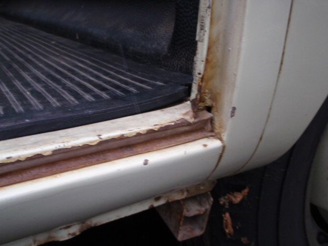

PostPosted: Sat Apr 01, 2017 4:03 pm    Post subject: Re: Door rubber pics and information Reply with quote
Just wanted to show how the upper/lower pieces of the weatherstripping for the cargo doors are.
It's tapered by about 1/8" thickness at one end.
Here's two 211 841 829 211841829
I thought the tapered area would be placed over a raised metal pressing in the base of the door weatherstripping channel.
But, what I thought was a little odd... is that it means the sharp cornered side of the seal is in the channel recess.
The sides of the cargo door opening (on the bus) have their weatherstripping placed with the rounded corners in the channel.
I guess there isn't a 'rule'... that sharp corners always in/out.
