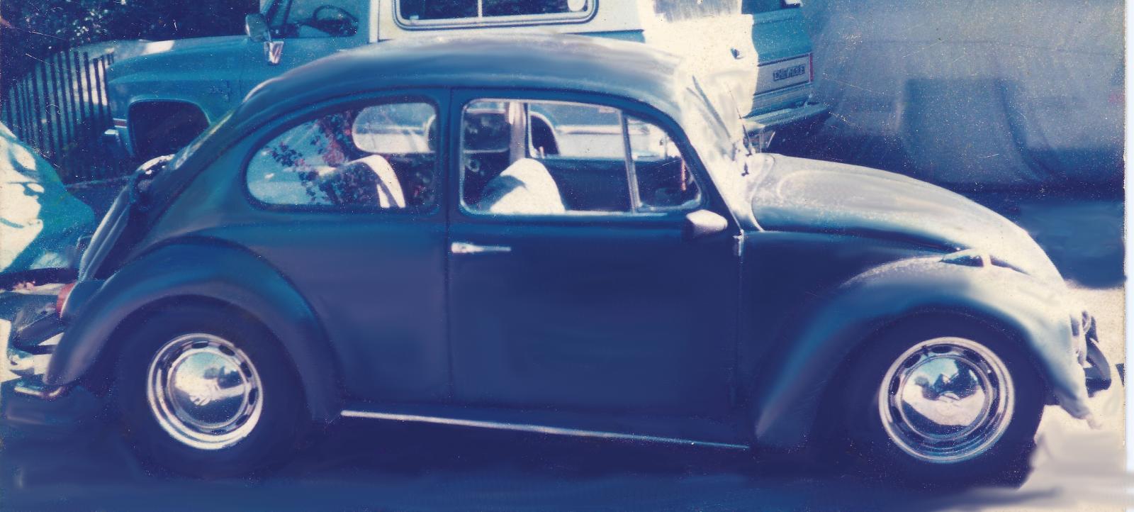

PostPosted: Thu Apr 14, 2022 8:46 pm    Post subject: Re: How did you lower your VW back in the day? Reply with quote
Select-a-drop was a popular choice, but didn't go that direction.
Sway-away beam adjusters were the better alternative, but those cost money that we didn't have. WAIT! I REMEMBER NOW! I did get some for my birthday!
My dad and I pulled the front beam out of my '67, used a pipe cutter and cut out sections of both beams and welded the adjusters in...the wrong way! Meaning it would raise the front end, contemplated the baja build instead for a few minutes, but really wanted the Cal Look...I mean Santa Cruz...come on!
We ended up drilling another hole, threading it and putting the center grub screw back in, dropping the front end about 5 1/2". The rear end was already drooping so the bug looked pretty good:
The front sway bar sat at about 1-2" off the ground, I remember driving and hitting a sewer cap on a crowned road and knocking the right lower arm out about an inch...it was low.
