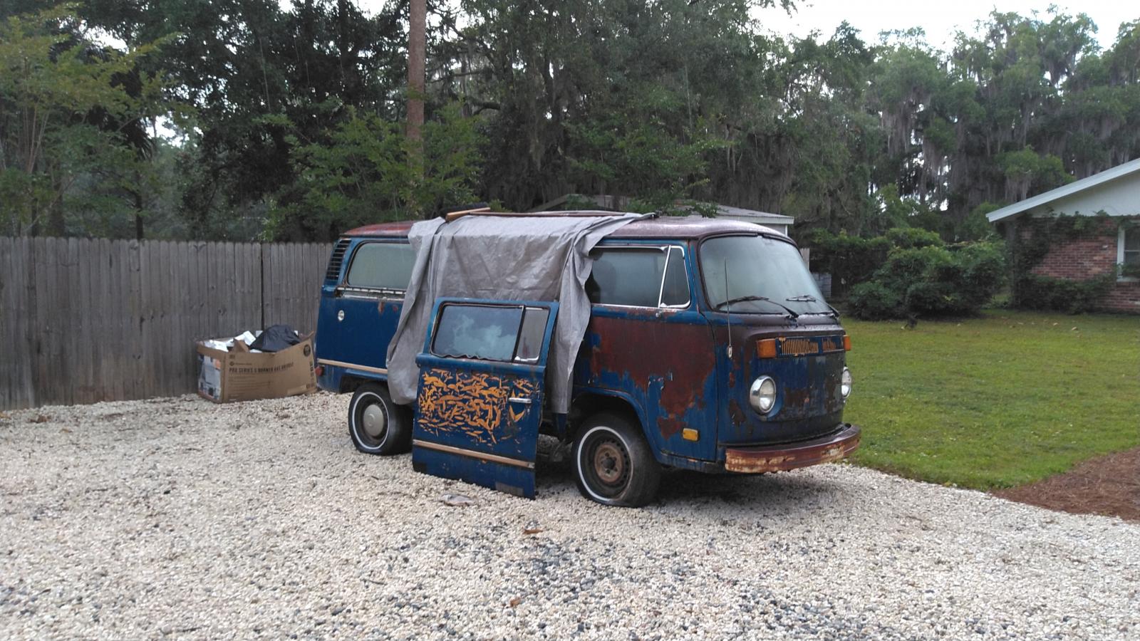

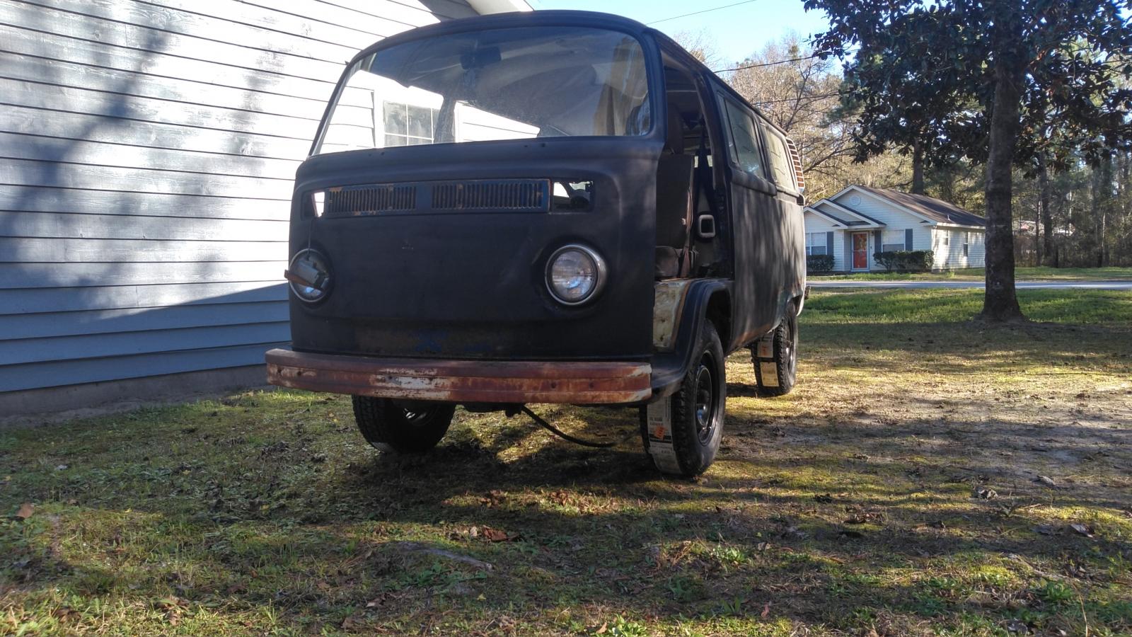

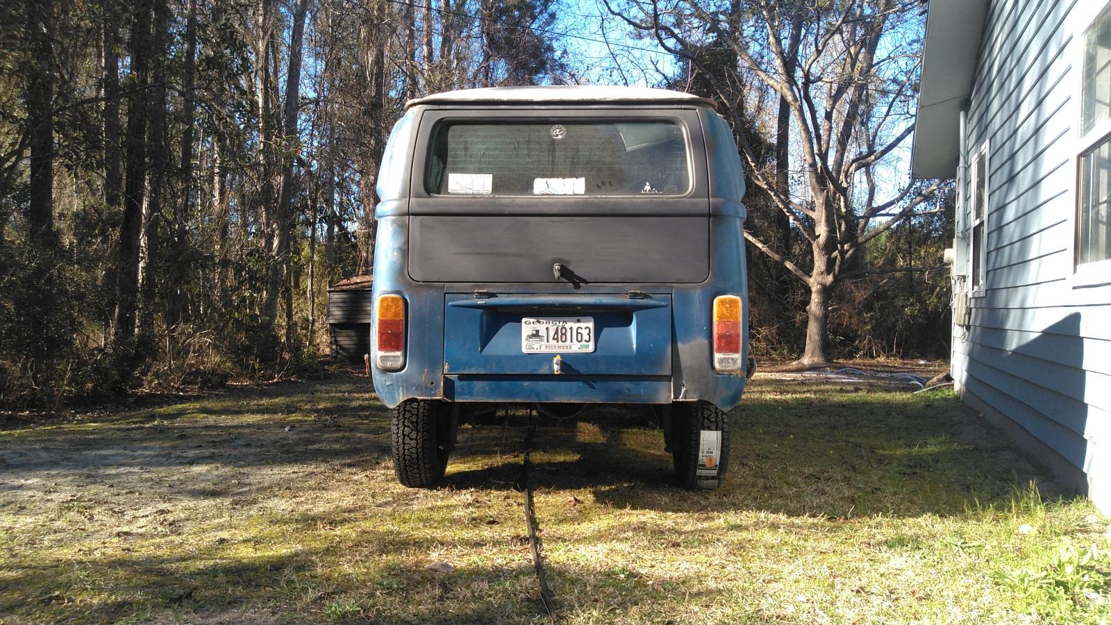

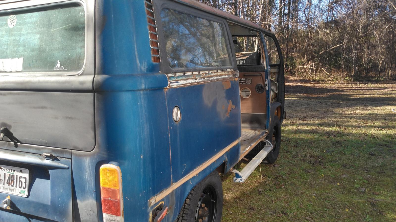

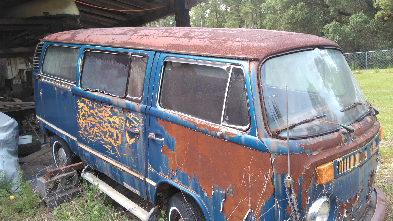

This is my first post! A few months ago I purchased this 76' Bus for 1200usd, despite the exterior rust (which I have been attacking aggressively), underneath and inside was mostly intact.
I ripped everything out of the inside, ground the floor down to a paintable surface truck bed lined the floor to seal everything up for a proper floor later on.
Underneath the windshield had an enormous amount of rust as is to be expected. So I mig welded in a repair panel using my Miller multi-process, this was done only a few days ago, and I still need to grind off most of the welds. The thin rectangle patches were areas that needed replacing that the repair panel was to small to cover, so I patched in pieces of sheet metal.
I am really excited to join the community, I am 24 and I have longed for this for as long as I can remember. I am in school for welding and work as a mechanic part time. I plan on doing a full restomod on it, with ac and hopefully if my plans work out 250hp, I hope to put an EJ20 in it and add some substantial reinforcement to the whole thing. I still have a lot to think about as far as implementation. I will update throughout the way. One question I have to send it off is, how does Porsche Forest Green sound for the paint color?
