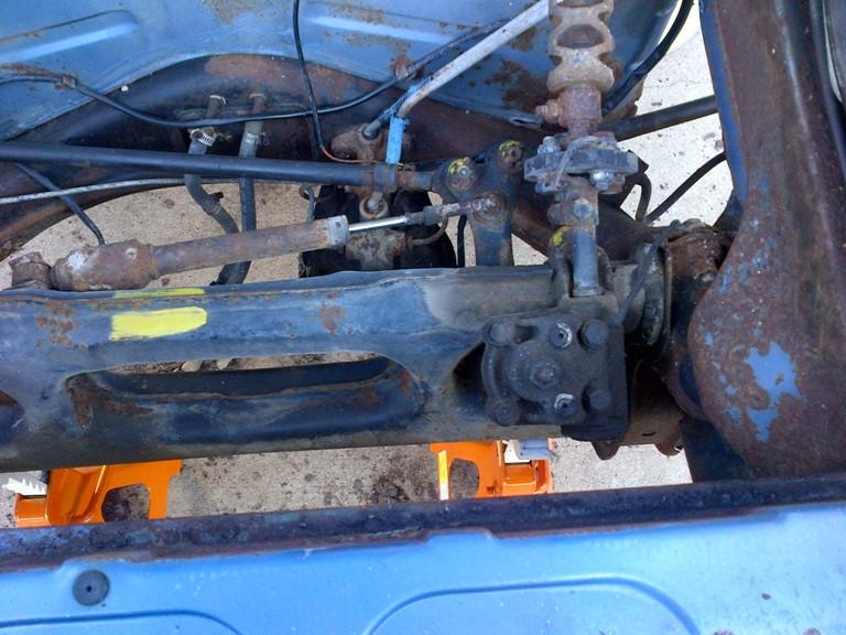

Here are some shots of the underside and bulk head. Would like some opinions on how bad this is. Is it worth turning into a hoodride?
I got it running last night with the E2000 fuel pump setup. I need to figure out the wiring the mice chewed up on the MAF. The last photo shows what i have. Its 4 wires that i need to figure out what order they go into the MAF plug.

PostPosted: Sat Oct 20, 2012 4:58 am    Post subject: Reply with quote
If you buy/install a set of new 1/2 pans from Gerson/Klassic Fab ($600) you can have it back on the road structurally sound. Masterseries silver/black is good for all your undercarriage/suspension. Replace all the original woven cloth covered fuel lines as they will have pin hole leaks in them!

PostPosted: Wed Nov 28, 2012 7:04 pm    Post subject: Pans are shot no doubt Reply with quote
I got this car on the road. Gotta say I love the FI at this point since its working right. I was suprised when i went out and started it today it was about 45 degrees out and it fired no problem. I will update some pics this weekend.
