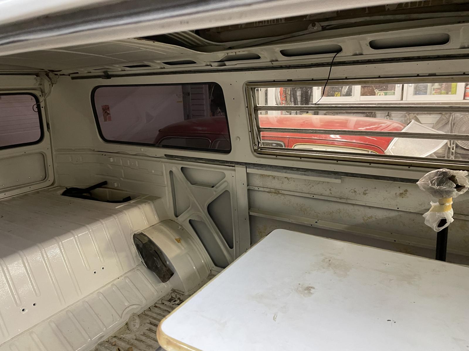

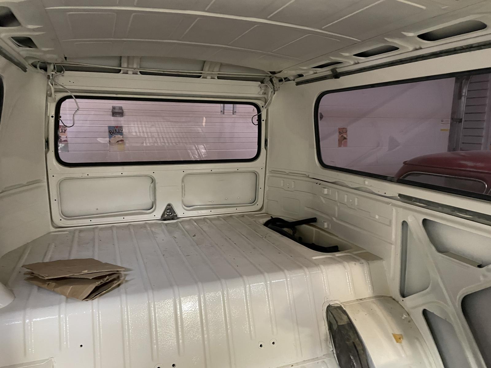

Along with doing research on the Subi swap, we pulled the transmission, axles, fuel tank, crusty hoses, and a pile of ratty looking wires.
the engine bay needs a better paint job to fix the 2 tone sprayed over dirt one, or maybe just white rhino liner and be done.
Laid under the bus saturday with the pressure washer for a while trying to get all the road grime off so I can get the bottom side all painted and sealed up, it's much nicer not having dirt fall in your face every time you touch something
Cut a big ol' hole for the type 3 hatch that I chopped out of the 65 parts car
cleaned up and drained the transmission, built a skid to attach the transmission, just need some strapping to finish up boxing it up so it can go off for a rebuild and gear change.
Next up tear down the rear suspension and add to the powder coating pile, that's always a good winter job, keeps the garage warm Wink
still watching the local ads for a cheap Subi donor car to give up it's 2.5

The rear Running gear is stripped off and in the blasting/ powder coat pile. I’ve been sanding and cleaning the engine bay. Still more paint over dirt to sand .
Welded the type3 hatch in , yes it’s flipped around, it just fit better in the bus that way , I didn’t have to cut into the front bar over the gas tank, and I always take the hatch off when working on my square, so it doesn’t really matter anyways
The transmission was sent out last week for the gearing change for the subi swap.
Removed the dash ……. Not sure what to do with the radio hole at this point , someone used the plier method to get a radio to fit

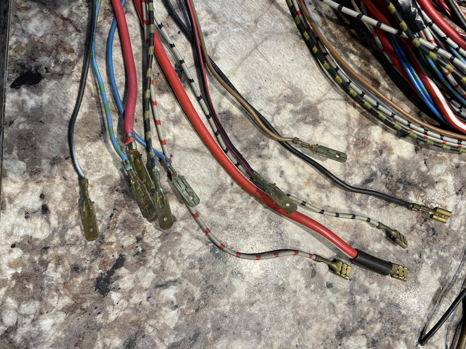

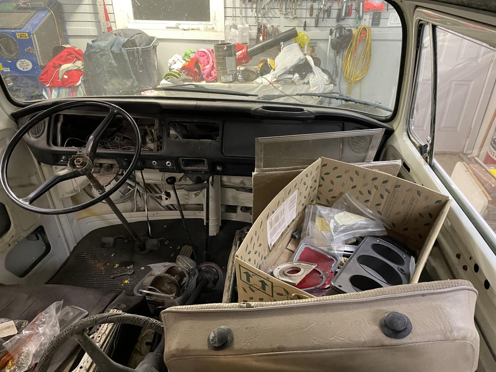

I pulled the harness to clean up the wiring and extend some wires for the Subaru harness connections and add a few for the gauges . No motor and the body was empty when we brought the bus home.
There is one black 20 gauge wire that doesn’t show up in the Bentley manual that is part of the front 8 connection. There are a lot of loose wires and the dash is out at the moment, so I’m not sure what it’s supposed to connect to at the rear. Any ideas?

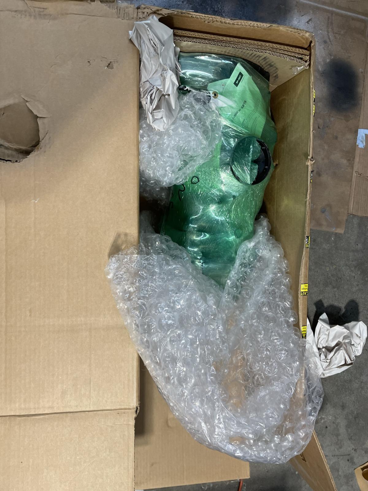

The gas tank is off at the radiator shop to get cleaned

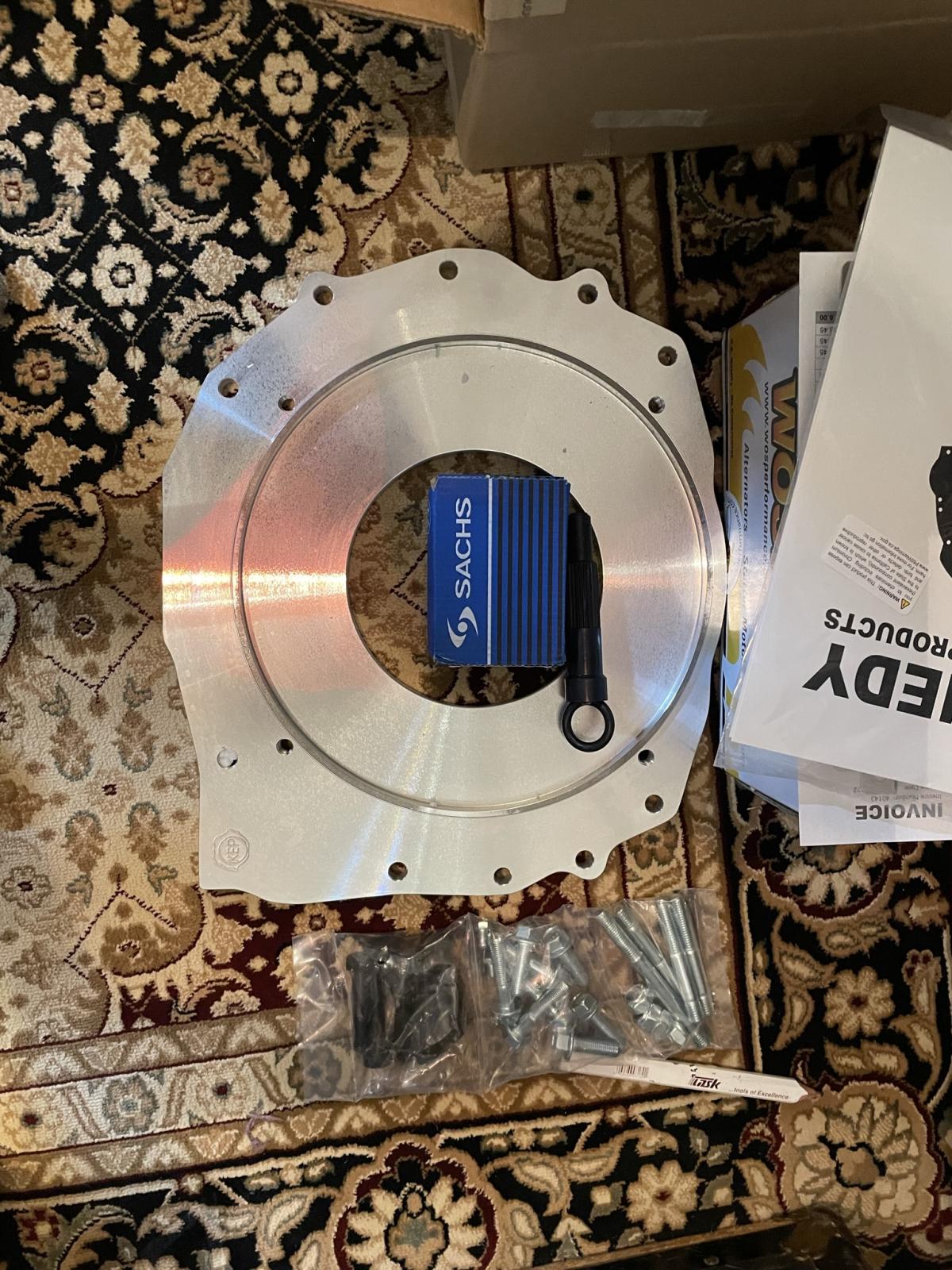

Trans is back from Benco, subaru adapter, and starter from Kennedy, and Busaru engine mount, all got picked up last week from the border

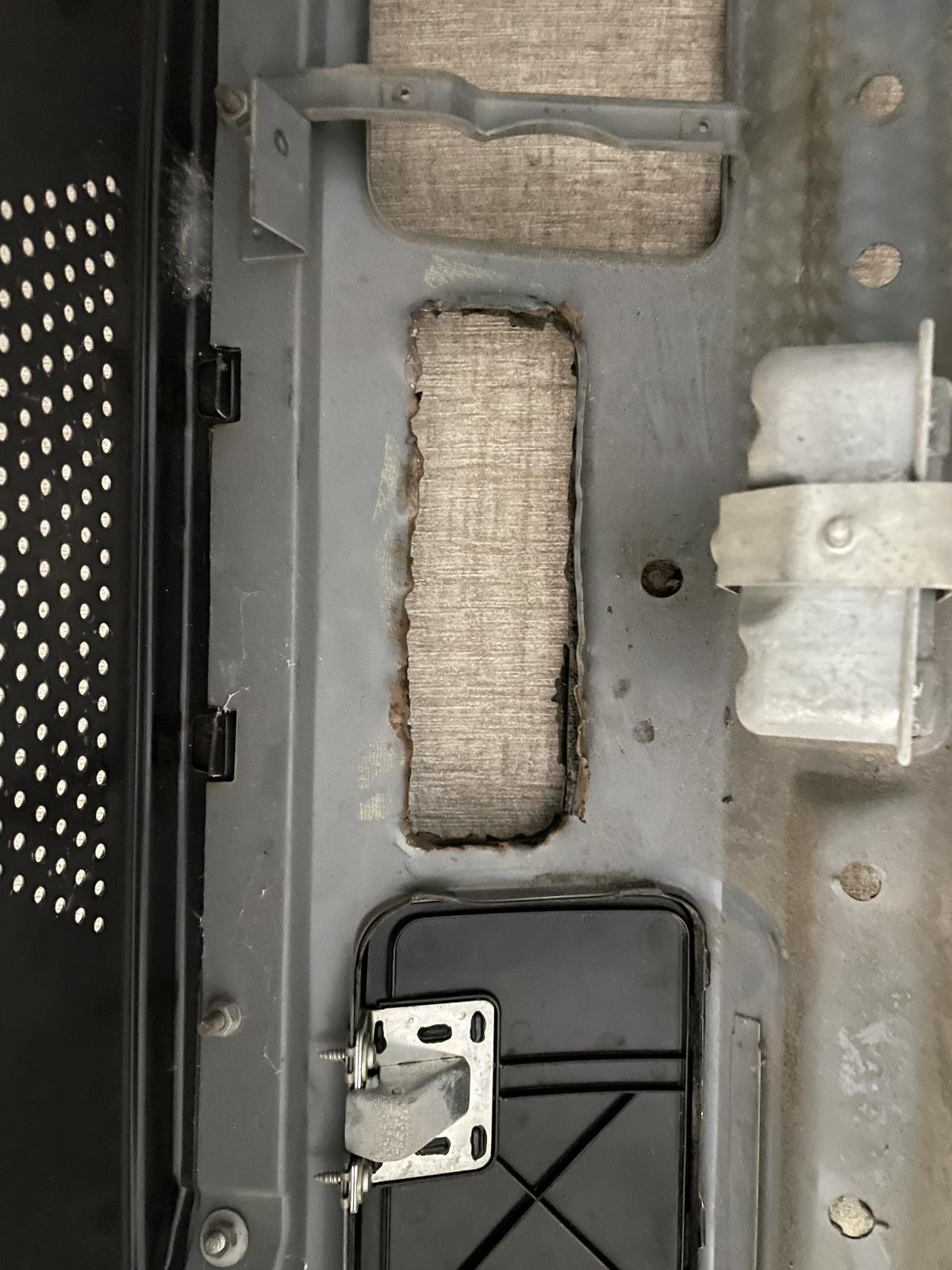

any ideas on what these holes are above the mirror?
looks like a bracket was bolted on there, nothing on the pop top I can see

PostPosted: Mon Jan 02, 2023 3:12 pm    Post subject: Re: 71 westy project Reply with quote
https://www.thesamba.com/vw/forum/viewtopic.php?p=5680767#5680767

well dang, I'm gonna have a look through the spare parts that came with the bus, but I don't recall seeing that bracket Confused

got some cleaning and painting done while the dash is out, I have a nice replacement that needs to get picked up in a week or so.
Might as well clean up the wiring, wipers, ducts, and all that while there is easy access. Need to order a 12v washer bottle upgrade and a couple switches that were trashed too
