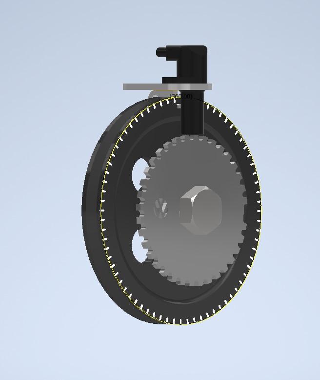

PostPosted: Fri Dec 09, 2022 10:24 pm    Post subject: Re: Gauging Interest: Cheap New Bolt-on Crank Trigger kit Reply with quote
Some updates:
Design has been refined, trigger wheel is much smaller.
Working on 3d printing everything now to check the design on a real engine.
Crank sensor bracket is still a WIP and the sensor may end up being moved over to the right and tilted 10 degrees or so to allow for better belt clearance with different size pulleys.
I'll be taking orders hopefully by the end of next week, if you're interested feel free to send me a PM.

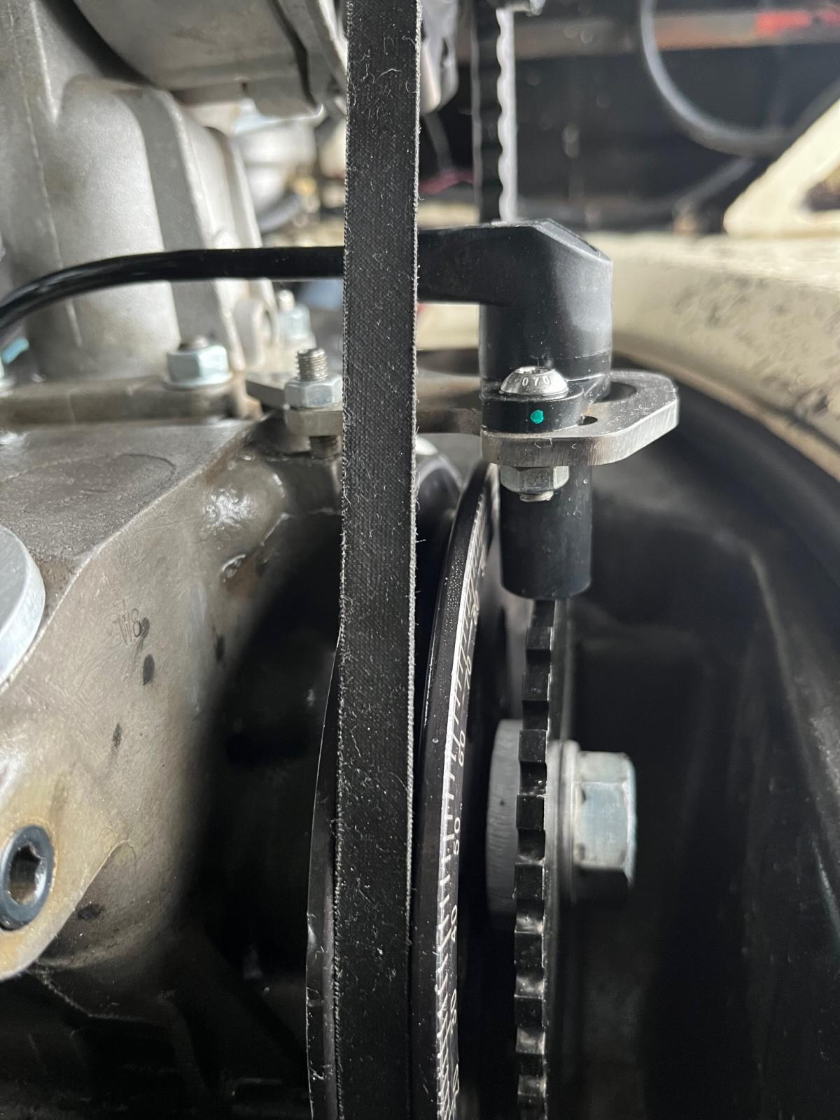

PostPosted: Wed Apr 05, 2023 12:43 pm    Post subject: Now Available: Cheap New Bolt-on Crank Trigger kit Reply with quote
Finally back with an update, and it's a big one:
I got my bus up and running on full EFI about 5 weeks ago and have put about 1000 miles on it without any major hiccups. I feel totally confident about this crank trigger setup I've created, so now I want to offer up what I've made to those who are interested.
Here it is setup on my personal engine. My setup provides a clean look while still showing off that the engine is running crank trigger.
The trigger wheel is a 36-1 toothed wheel made from 3/16" black zinc plated steel. The wheel is attached to a 6061 aluminum hub that keys to the front of the crank pulley. This allows for repeatable alignment and near perfect concentricity of the wheel.
Crank sensor bracket is made from 3/16" stainless steel and CNC bent. It bolts to the top two 8mm case half studs and features a jacking screw for vibration reduction and fine tuning of the sensor gap. The sensor itself is a VR sensor from a Chevy Aveo and can be found at most local parts stores. The bracket fits all pulley sizes from power pulley to 7" without interference.
Finally we have the distributor plug. I wanted something that was super functional and low profile and would blend in with the curves of the case. This cap is held in place using the original stud and is made from 6061 aluminum to blend in with the engine case. Unlike other distributor plugs, this is low profile and positively attached to the block, so it doesn't stick out like a sore thumb and there is no possibility of it popping out. The plug accepts stock VW distributor seals.
This kit is available for sale now.

PostPosted: Wed Apr 05, 2023 9:29 pm    Post subject: Re: Gauging Interest: Cheap New Bolt-on Crank Trigger kit Reply with quote
I think this is pretty sweet. I’ve been thinking of going with crank trigger ignition when I switch to dual idfs because they don’t produce enough vacuum for an SVDA.
Now that the CB Black Box is up to $250, crank trigger is looking even better. With this kit, a Speeduino, and a “New Beetle” 4 post coil, you could have crank trigger for under $350, with the ability to go to EFI later. About the same as the Black Box and a locked cheapo 009.
Couple questions:
Is the trigger wheel press fit on that aluminum hub, or just clamped over the pins with the crank bolt? Are the pins an interference fit? How precise is the fit with the keyway? Within a degree of rotation?
Is there any adjustment for the VR sensor to dial in TDC? Shim it with washers? Or is that all done in the software anyways?
Does this kit work with a stock stamped steel pulley?
Is the distributor plug several piece bolted together? Or pressed together? Is it steel or aluminum?
Is there any concern about the distributor drive gear rubbing against the distributor plug?
Somewhat unrelated question: what are you using for throttle bodies on your setup? Curious how you are doing idle control?
-Austin

All excellent questions! The main thing with the design of this is that it was all designed around being laser cut from flat stock, so that's why there's some different design choices.
The dowel pins are a press fit. They're mainly for positioning, but they do keep the assembly together pretty well. What truly holds everything together is the crank pulley bolt. The fit to the keyway is very tight, to the point where I've had to tweak the fit on a couple of them. I've had the trigger wheel off and on my engine a handful of times and the timing has remained exactly the same. It's definitely within a degree or less.
Having the sensor exactly on TDC is not necessary, but I do include some washers as shims to help with alignment. The actual alignment itself is done in the EFI software with trigger offsets (This wheel has a 88-89 degree offset). The kit works with all pulleys, stock pulley won't be a problem at all.
Distributor plug is multiple pieces bolted together. It's all well sealed together with a good quality thread sealant, and the fit of the plug is very good. I've had no problems with leaking on this design.
As far as the distributor gear goes, this design (like almost all others on the market) requires that the drive gear be removed. They're just aren't any good reliable options for keeping the gear in place without it causing damage.
Throttle bodies are 45mm SherryBerg units. They're from Aliexpress and do come with a handful of issues out of the box, but I was able to fix them up by throwing $30 and a couple hours of my time at them. When I bought them they were less than $200 for the pair.
Idle control is done through ignition timing in Tuner Studio. The throttle bodies have adjustable stops just like an IDF carb.
I see you're in Utah? I bet I've got a couple things you'll be interested in. Shoot me a PM and we can chat.
