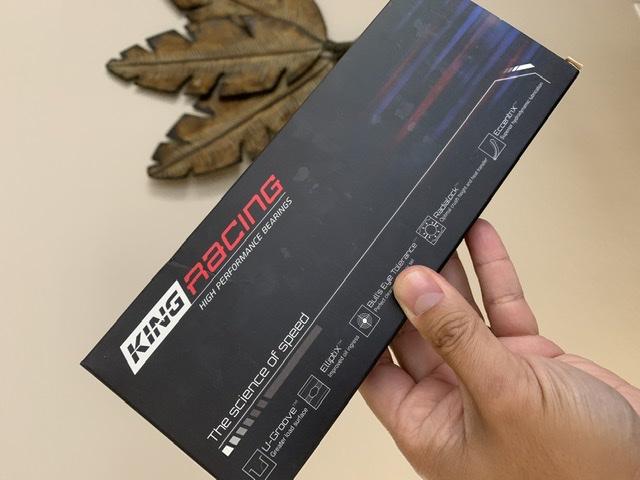

PostPosted: Mon Oct 12, 2020 9:34 am    Post subject: Re: Flanged Main Bearings from CB Reply with quote
I wound up buying these bearings. They're basically 411 adapters for standard type 1 mains. I opted out of doing the thrust conversion this time around since it is built into the bearing.
