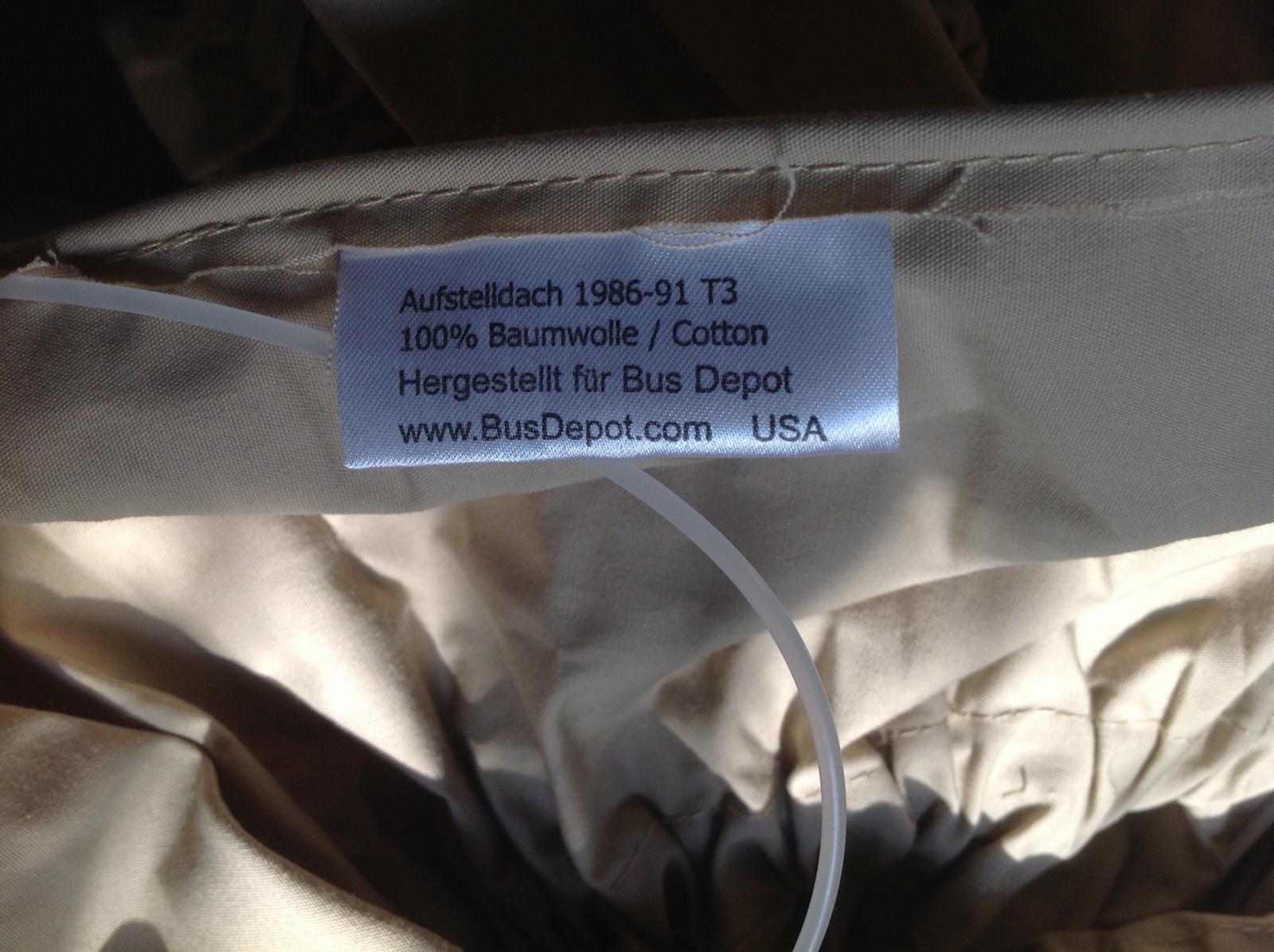

I opened the tent itself, which is a surprisingly small bundle.......
Nice.......... real nice !
As mentioned by others, the canvas is thinner than the old Westy canvas, but really? Who cares? Isn't this camping game focused on weight reduction?
I don't know canvas..... Is thicker and heavier better? Or is there a quality to lighter weight fabrics? I imagine this canvas is a blend rather than all cotton.
Ummm........ Nope, 100% cotton......
Anyway, it looks well made, the seams are pretty and straight.
I'm not a seamstress but everything appears even and neat.
Yes, there are some stray thread fibers here and there but I don't think that's at all a problem.
The zippers are plastic and Velcro is used on the front window.
Time to get busy, pull that top off and start the rebuild!
And the top is even Numbered on the back of the tag! Smile
Dave

PostPosted: Thu Apr 04, 2013 10:12 am    Post subject: Reply with quote
I have the Pop Top off of my 86 Westy to repaint it.
I've removed the original VW canvas which does indeed feel thicker.
Got out the micrometer and the OG Canvas measures .014 thick while the Bus Depot Canvas measures .012 thick.
A difference of .002.........that is the thickness of a strand of my hair! (Micro shows almost 3, I bumped it setting up the photo) ...............
