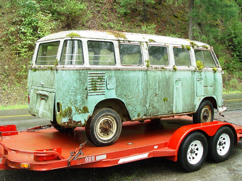

I had a 62 w/t 15 window that was IRS’d and last registered in the mid 70’s.
By the evidence of the wheel wells it had some pretty big meats in the rear at one point in it’s life…

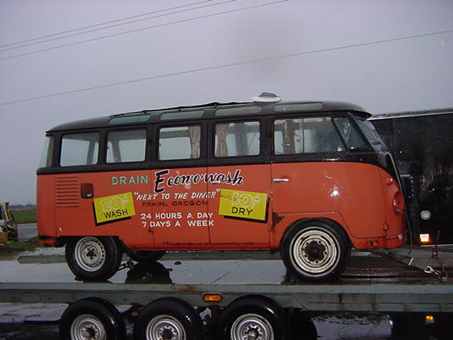

I bought a 21 window back in the late 90’s that had the entire IRS suspension from a late bay. The bus had been parked since 1980 in a garage and forgotten about. The woman was very old and was finally letting go of her late husband’s stuff. I didn’t catch it that the bolt patterns on the wheels were different until getting it home. I remember being bummed out that the original stuff had been removed and the mounts were welded in. I wound up just selling it on to a friend. He unfortunately decided drugs were more fun than busses and I don’t know what happened to it. It was In Anderson SC. So maybe still there? I think the bus was a 67. I am not digging through discs of digital photos from back then but pretty sure I didn’t document what I considered a hack.
Not sure of exactly when or who did the conversion just that by 1980 it had been done and then parked in the garage when the guy decided to not drive this bus anymore. But the idea had come to fruition before the 80’s

Not sure when this one was converted but it has been off the road for a long time…
Small five lug pattern, though…

This is exactly how the 21 window I had was done. Small five bolt on the rear. I was very disappointed to discover it once I got it home.
