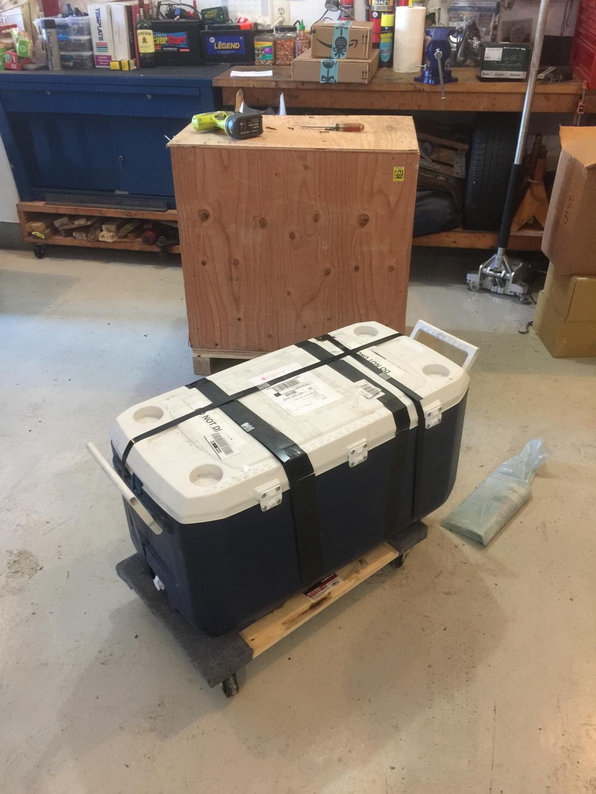

A very large cooler that the trans will fit into is a great way to ship them.

I advocate using the closest rebuilder to you so that you can drop it off and possibly go and see the beast when it’s apart.
I had the box in my 2WD Westy rebuilt with no major problems while running and with shipping and rebuild it was $3400.00. This is not a place to be cheap.

Does anyone have the general dimensions pf the transaxle? With bellhousing still on. I can measure after i find time to get mine dropped, but figured if I ended up near a walmart I could see what cheap coolers were available. Thanks.

PostPosted: Wed Nov 01, 2023 7:43 am    Post subject: Re: How to know it’s time time for a tranny rebuild? Reply with quote
It'll fit in a 27 gallon plastic box. Weighs in at 100 lbs. This is an 82 AC type 91 on the way to the Rancho tranny spa in Fullerton. UPS picked it up. Easy peasy.
It's about 31 inches 26 inches nose cone bolts to the end of the input shaft. I loosened the bracket for the clutch slave so it doesn't stick up. Bell housing just fit under the cover.
