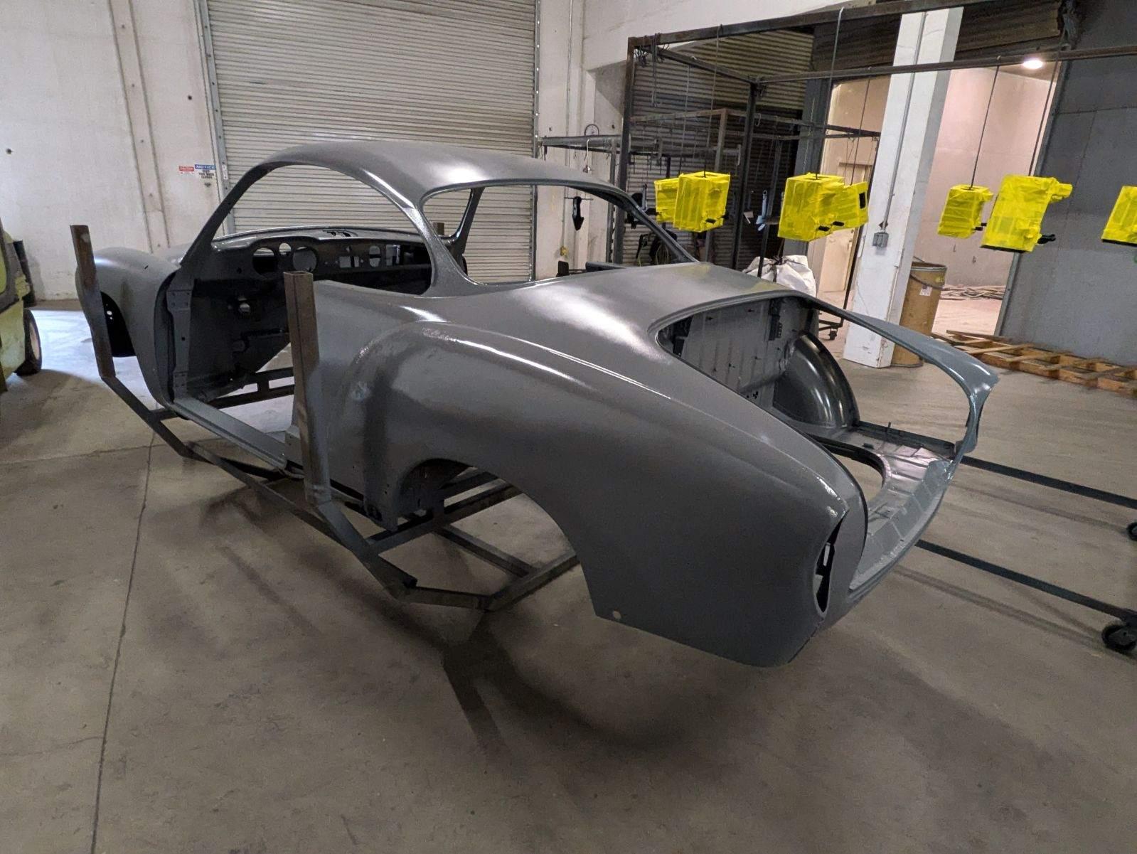

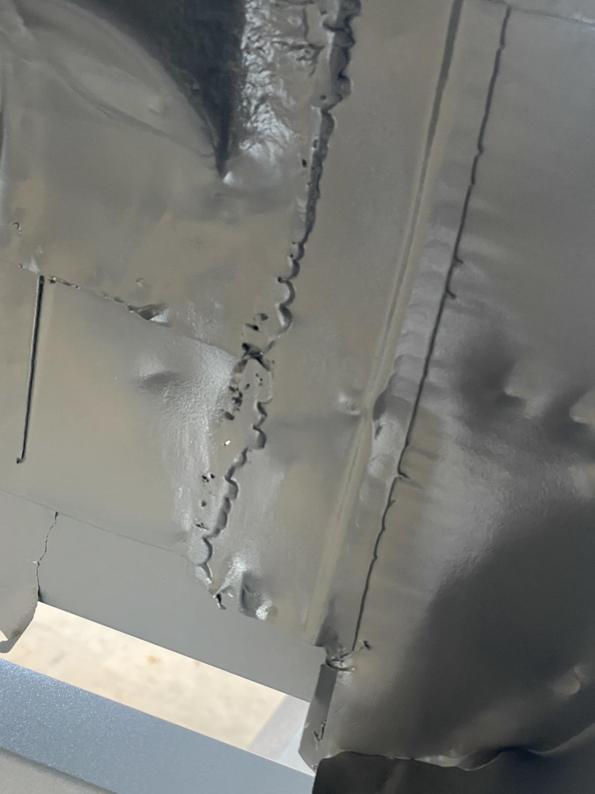

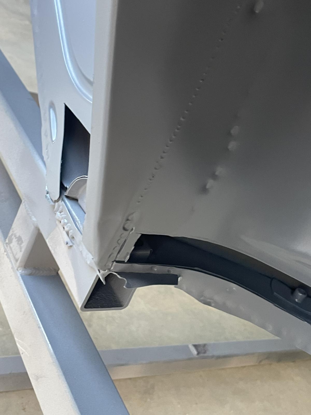

Ok Folks I’m back at it again. This time it’s a late model Coupe.
This will be another one that was taken from a shop , now I can redo and finish it.

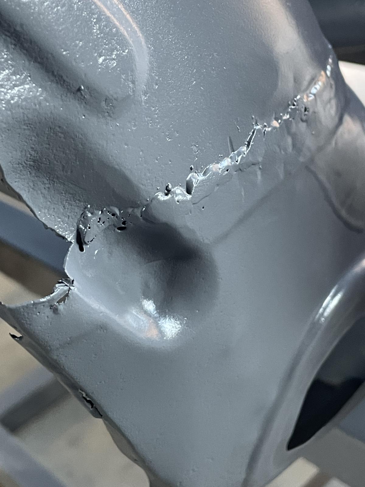

Unfortunately the passenger side heater channel and rear quarter got put on in the wrong position. Not only did the holes in the channel not line up to the pan but the whole back portion of the body would not sit down flat on the pan. The owner told me that the previous repair was done on a rotisserie with little to no bracing when he we cut away the channel. I suppose that’s where it all went wrong. I will need to remove the channel and start over once it gets back from blast and prime.
I will need to use a pan and the layout table together to try to sort out the mess.
This should be a fun and challenging one.

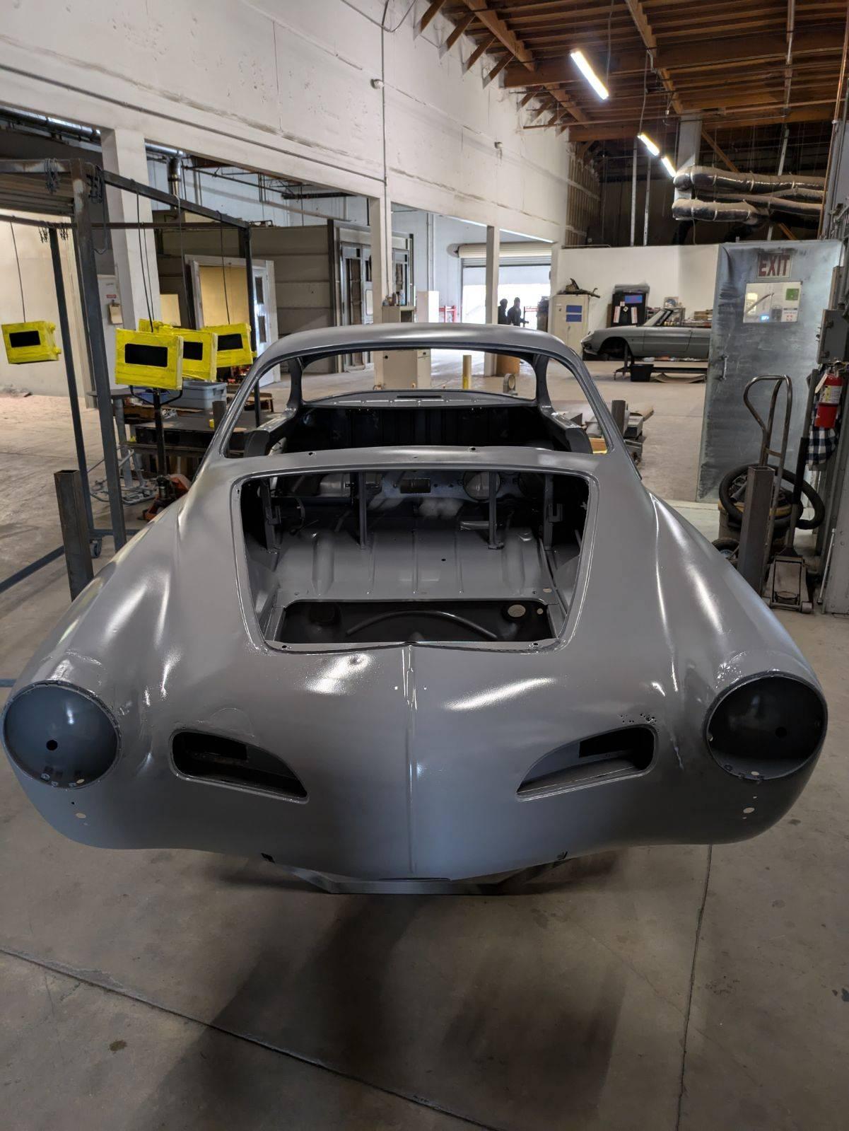

PostPosted: Wed Nov 27, 2024 4:18 pm    Post subject: Re: 60’s Ghia Metal Restoration Reply with quote

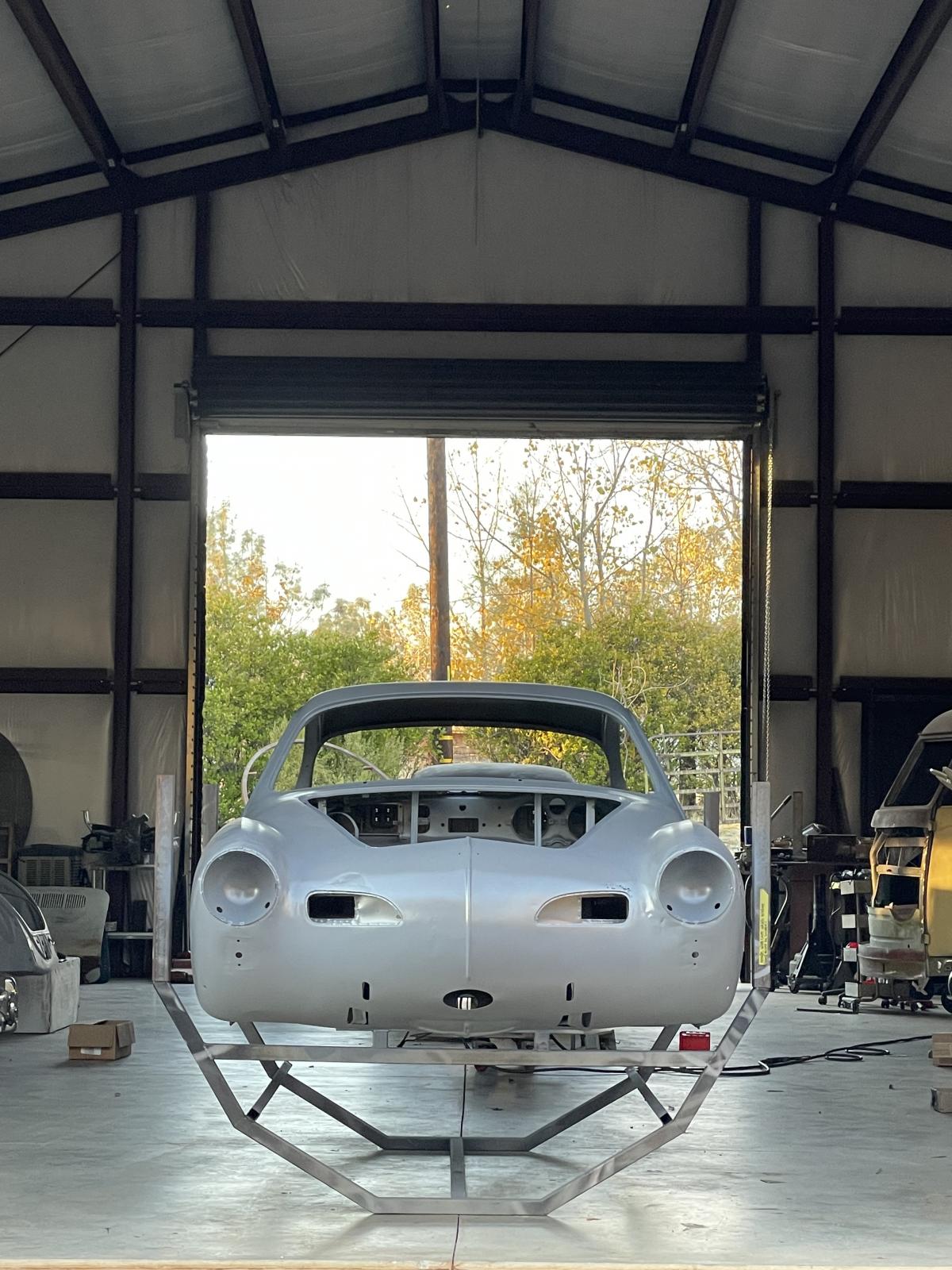

Che k it out folks.
American Stripping got this one knocked out real quick for me. They sent me these shots when it was still wet. Love those guys down there.

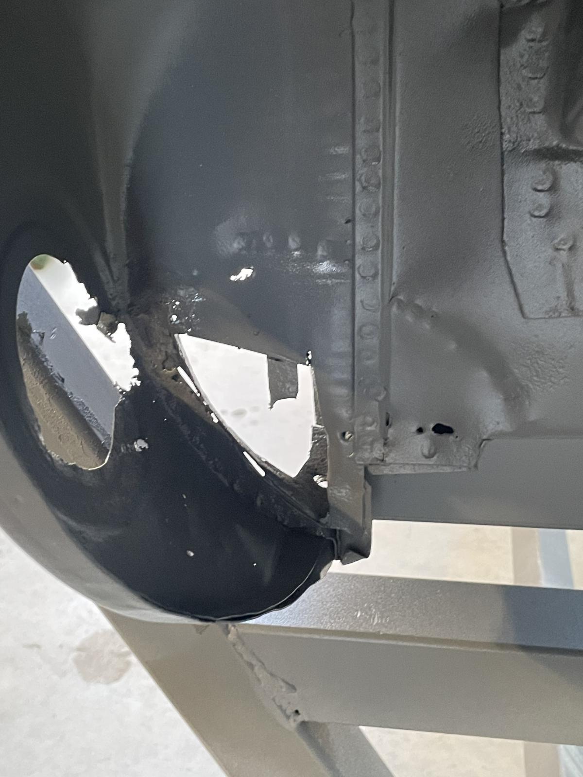

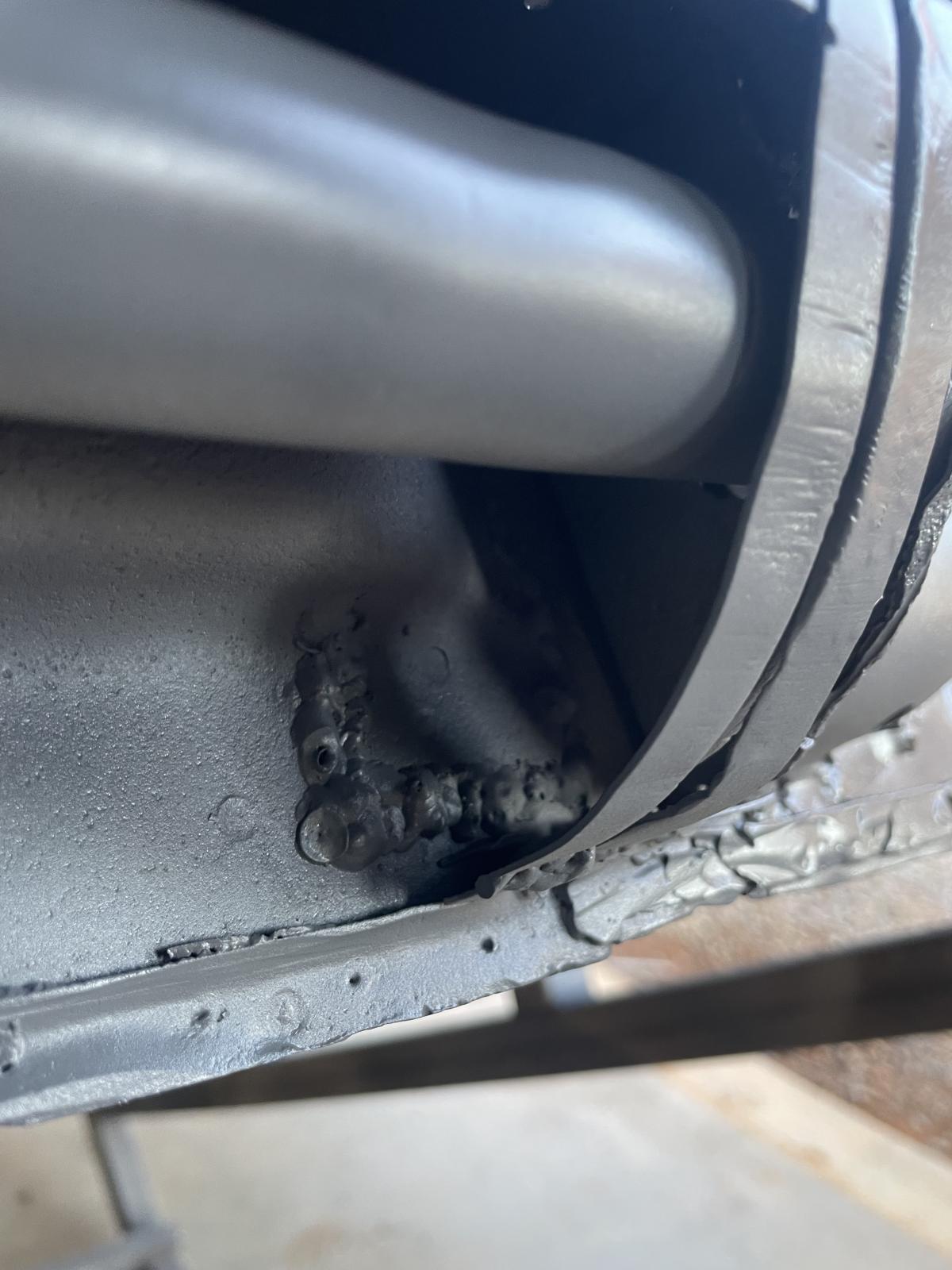

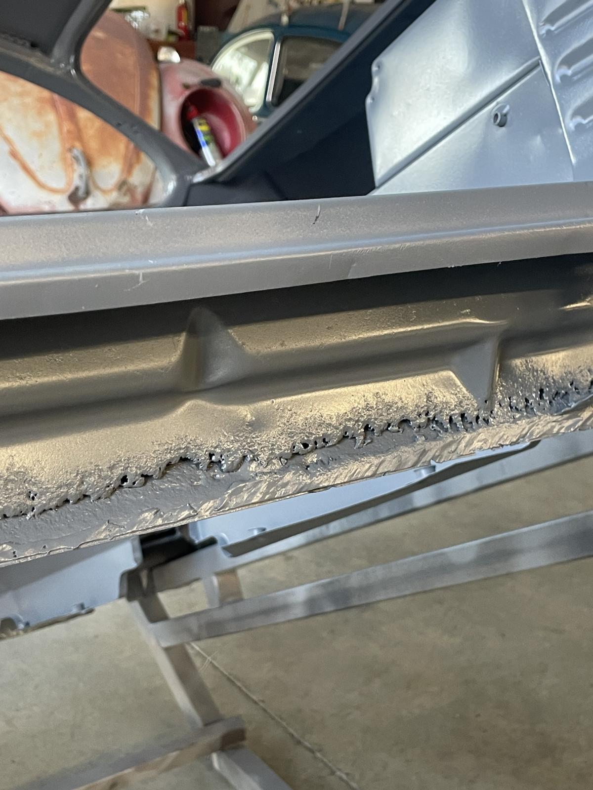

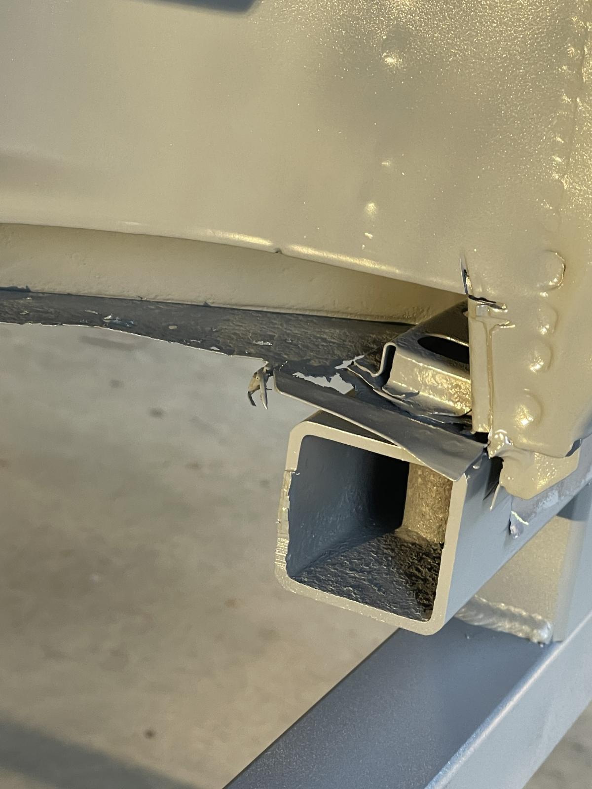

Man! This thing looks good from far, but it’s far from good. Lots of crappy repairs to repair.
