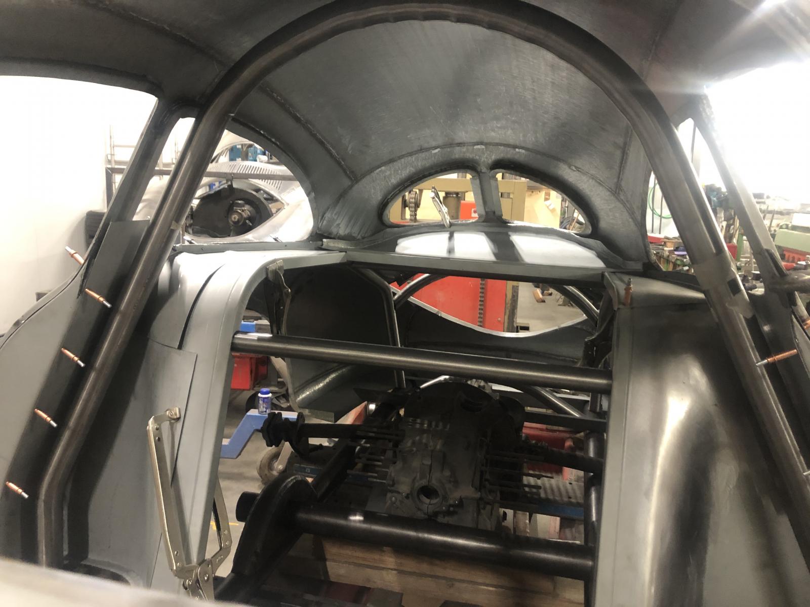

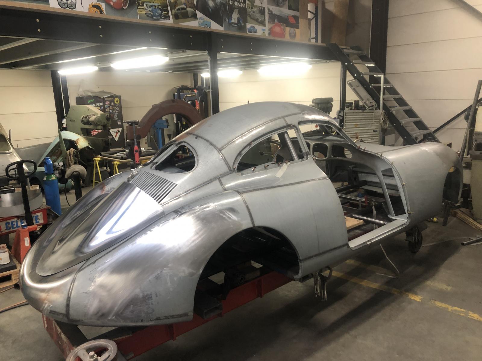

Four years ago when Covid hit, I came up with the idea of ​​building a car with my children. my daughter 17 who was going to school at the time. to become a welder. she was no longer allowed to come to school due to covid and my 21-year-old son was unemployed, so we started building a car. I decided to build a steel car because it is much more complex than an aluminum car. and my daughter was not yet ready to weld aluminum and after all she was the one who would weld most of the car, I decided to make a Porsche type 114/2, a car that was designed in 1938 but never built. the car was designed with a water cooled v10 engine but i would make it with a vw 1944 KDF / Denzel engine in the coming weeks I will share the construction of the car with you

so did you already have the wooden buck? is that another - aluminium - body in the background?

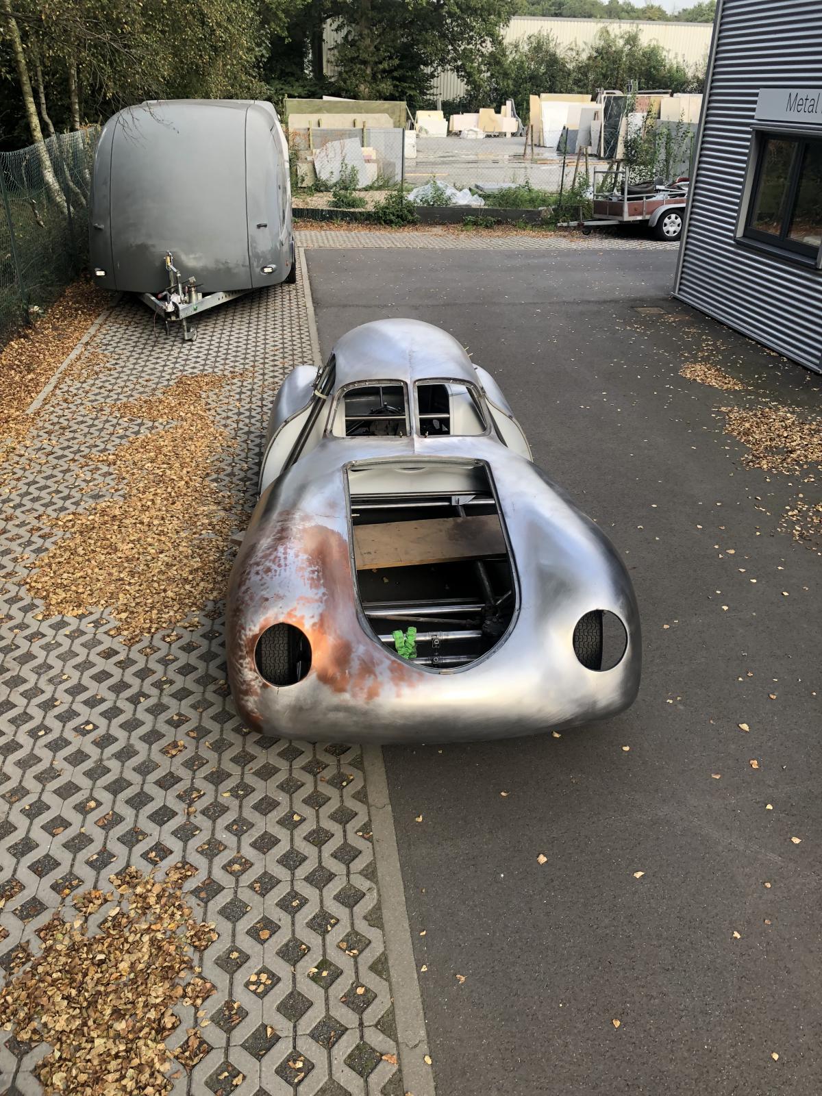

mid engine 1944KDF gearbox & KDF/Denzel engine is Currently built by Speedwell USA

I'm wondering if you are gonna be adding more vents for more air or are you just relieing on just the vents under the rear window ...

There are slots under the front bumper and a duct runs through the floor for fresh air for the engine.

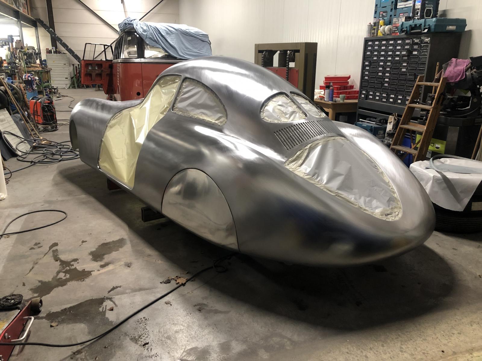

differences between type 114/2 & type 64rear
split window
rear of hood more pointed at the bottom
tube frame
bumpers
air intake in the front
water-cooled V10
