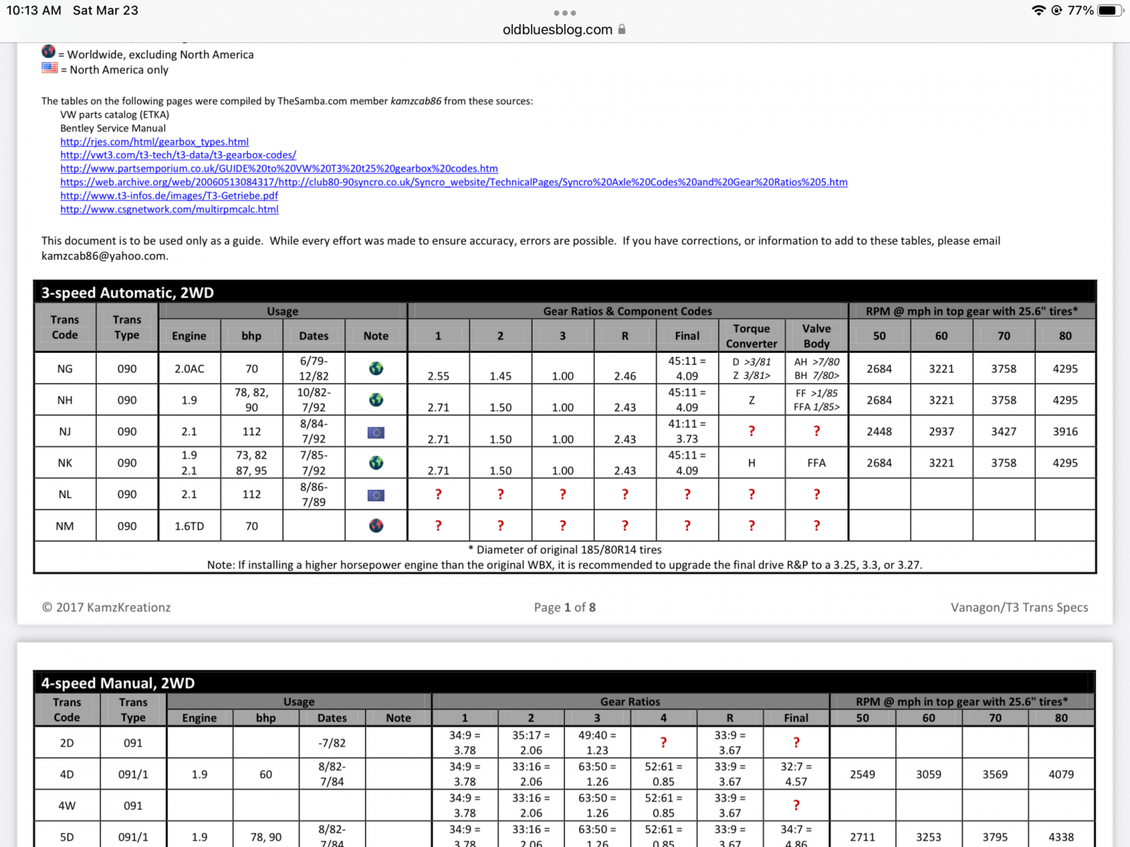

Then I was googling any reference information and I ended up on Kam,s old blue site.
I found a chart about rpm and speed.
I found it unsettling that the rpms on her chart are significantly less than we are seeing
Forgive me Kam but I shamelessly stole your chart.
You have the powers to edit it away or properly insert it with proper credit given......
your site is the only place that I've seen it.........
A) I used the calculator that was listed as a source in that document. Online calculators automatically use a standard 0.7 ratio for an auto trans, which I didn't know until now.
B) I used 25.6" for tire diameter, which is slightly off from the 25.3" it should be.
C) Online calculators do not factor in the torque converter. According to Roadkill Garage, a torque converter can add anywhere from 3 to 12%, depending on condition.
D) I've now redone those tables using Excel for a more accurate calculation, based on each transmission's stock final drive, the revised stock tire diameter and adding 3% for torque converter (manual trans section also updated).
Those figures should be more in line with the VW transmissions in stock form. Those figures, obviously, do NOT take into account road conditions, tire condition, tire tread, weather condition, vehicle weight, and so on. The tables are based on mathematical calculations of when the vans were new, NOT an average of what drivers are seeing 30+ years later, after hundreds of thousands of miles, after untold rebuilds, after modifications, after installing larger tires, with worn out gauges (or reassembled), etc. In other words, math is being used to get set parameters, instead of using multiple variables resulting in multiple parameters.
To answer your question, my 1990 Westfalia with rebuilt (in 2008) transmission and 205/65-15 Cooper Discoverer tires, which have a diameter of roughly 25.5":
68-70 mph = 3850-4000 rpm
^That's using GPS for speed & the tach has never been taken apart. Note that RPM is basically in line with the revised table. Who knows what it was reading back in 2008 after its rebuild (didn't buy the van until 2010).
