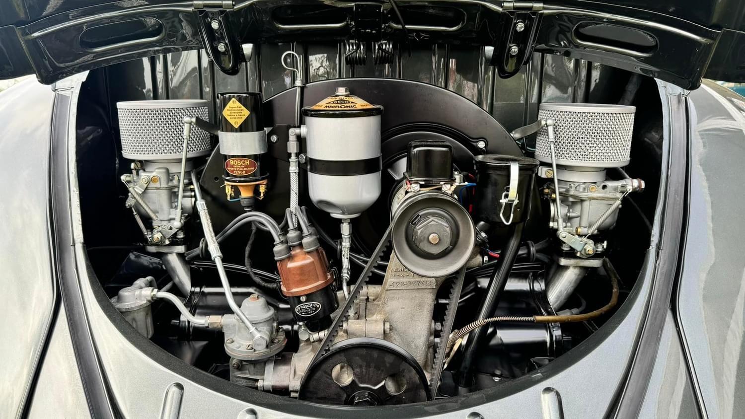

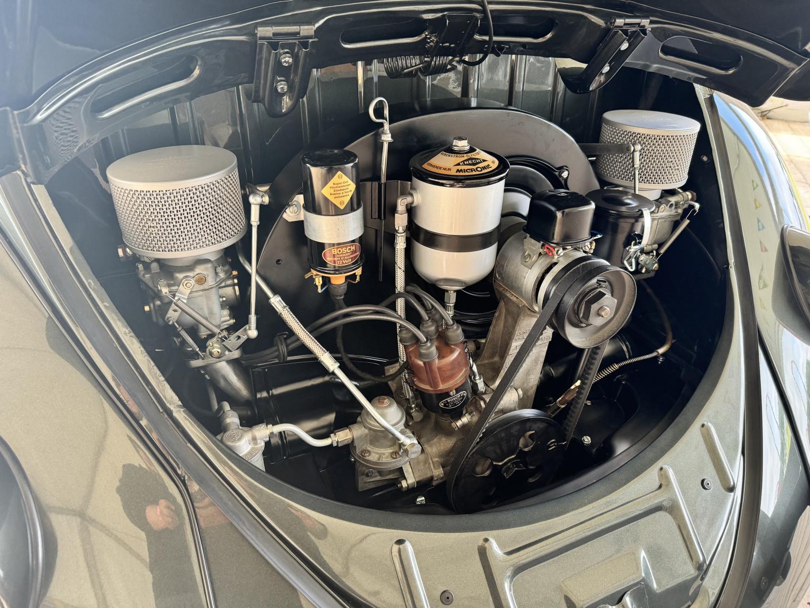

Nice engine, looks familiar.....
My carb setup...
Carbs: Zenith 32 NDIX – Porsche 356 “Normal” Jetting
Main Jets: 120 (modified by Whitey Worsham)
Main Air Correction Jets: 230
Idle Jet: 50
Idle Air Correction Jets: 120
Pump Jets: 50
Venturi: 24mm
No clue as to why yours are "leaking". Possibly a good cleaning will solve. Tear down and inspect thoroughly. Good luck.

PostPosted: Tue Jul 23, 2024 8:29 am    Post subject: Re: Zenith 32 NDIX leak problem and fine tuning Reply with quote
yes yours was a huge inspiration. classy and so beautiful.
I have to move away from your settings with my much larger valves and the higher displacement. I will eventually find the problem. Apparently since my last tests it seems to be fine. I no longer have the leak.

PostPosted: Tue Jul 23, 2024 9:08 am    Post subject: Re: Zenith 32 NDIX leak problem and fine tuning Reply with quote
Pydesign wrote:
Erik,
What modification did you on the main jet?
Your carbs look very clean inside!
120 jet is not an available jet size, he enlarged a 115 jet to 120. The next step would have been a 130 and he thought that was too big for my setup.
"He" being Whitey Worsham. He has since passed away. Super guy, with a lot of knowledge on built 36hp engines.
