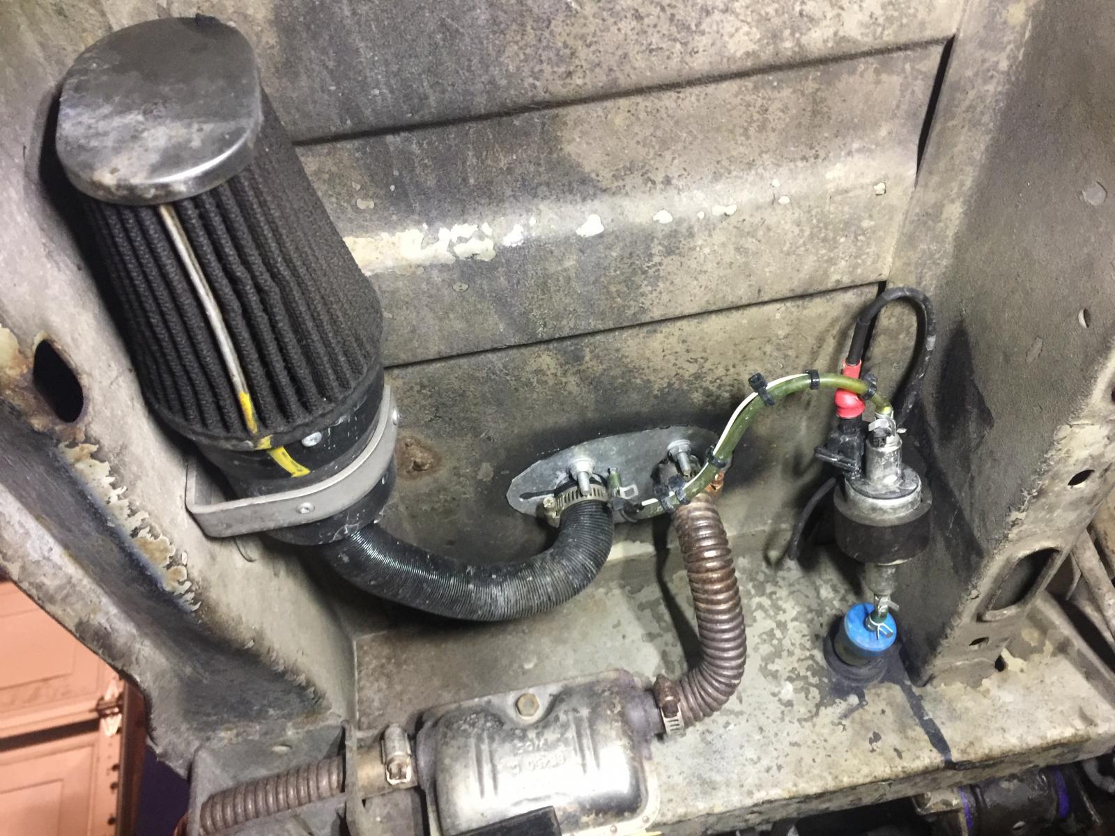

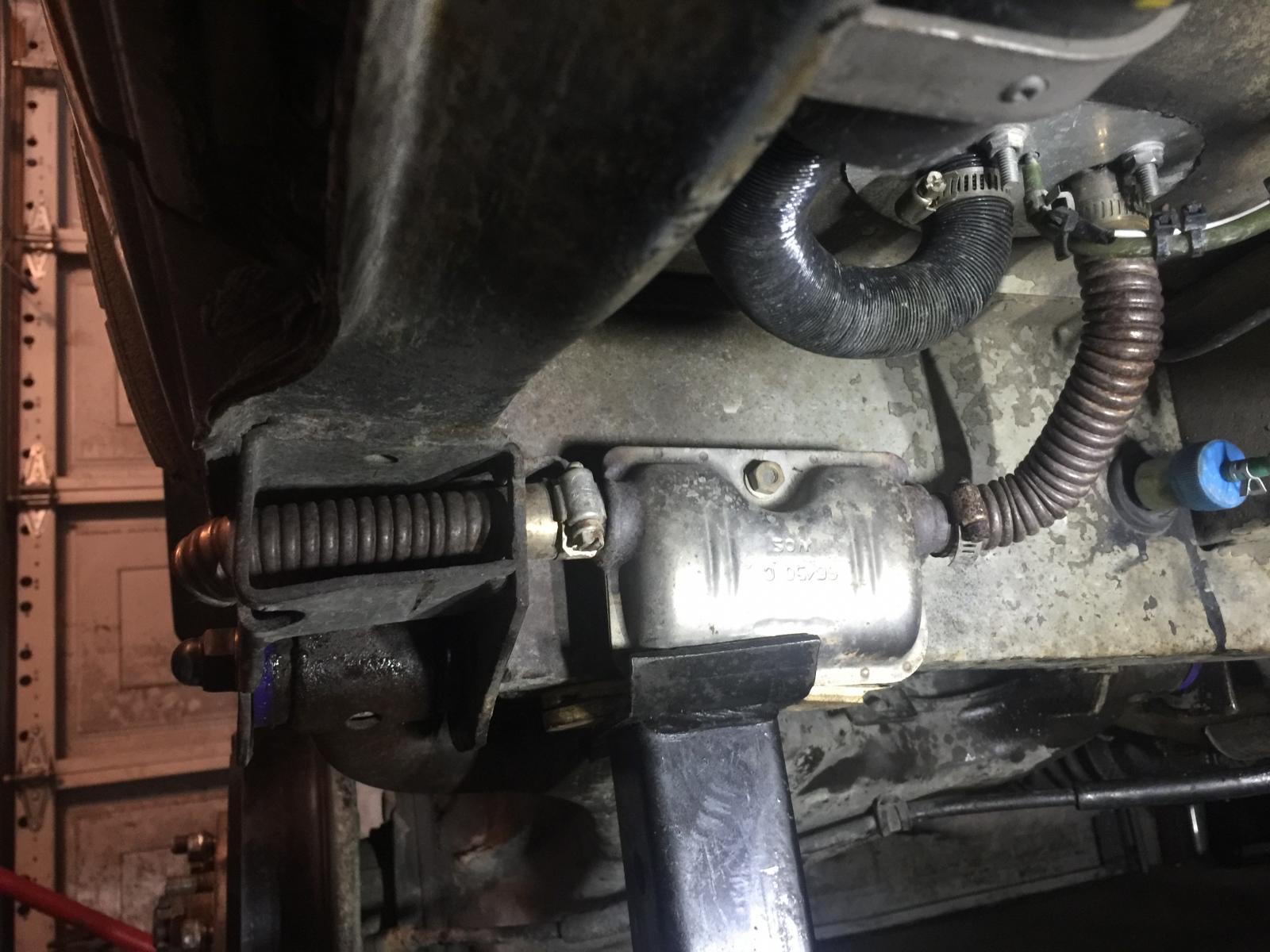

Call me a worry-wart, but if Espar/Webasto does not make it, I'm not using gasoline in my heater. With my CDH, I use diesel fuel with confidence about safety, despite the complication of two fuels.
As a veteran of several Beetles with gas heaters, I remind everyone that these gasoline heaters don't use catalytic converters or precision fuel injection. My Beetle gas heaters stank! Many will say that the CDH smells like an old Mack truck. I say they smell like a home furnace fired by heating-oil, and have very low emissions when adjusted properly on the controller.
A quick look at the photos tells me that GW sourced most of this unit from a Chinese supplier and added their own fitting bits, including the well-executed under-seat cover. Still too much worry for me with the gasoline, though.
The GW installation instructions show a poorly-executed exhaust pipe installation. I go to areas with brush, long grass, weeds, etc that would catch on that exhaust pipe. Deep snow would do the same. More thought on that GW exhaust pipe install is required. I think a section of 1" steel electrical conduit might be better for part of that exhaust pipe install.
Another niggle - - my propane tank, even with a new main valve, lets out a tiny "puff" of propane when opening or closing the main valve. These tanks are not completely contained. I installed my CDH to exhaust on the passenger side, away from the propane tank.
View from Below:
View from above:
