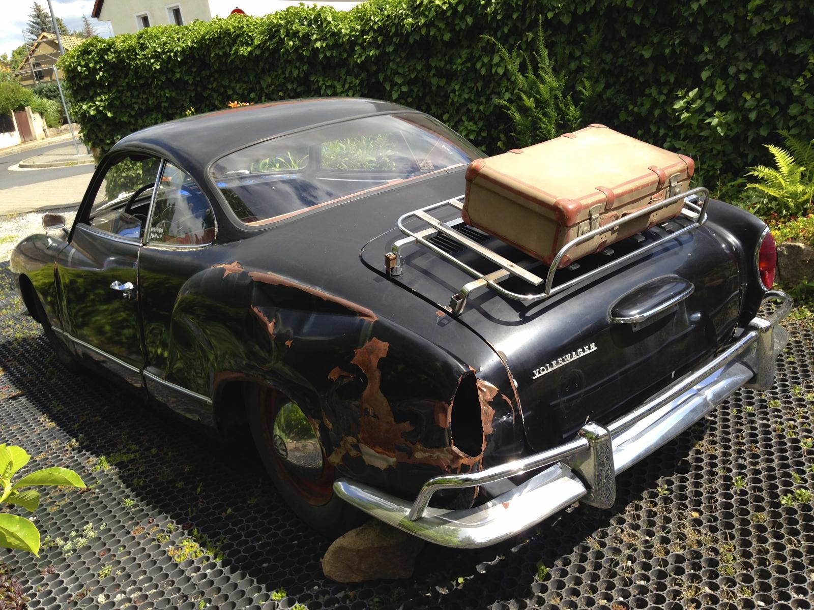

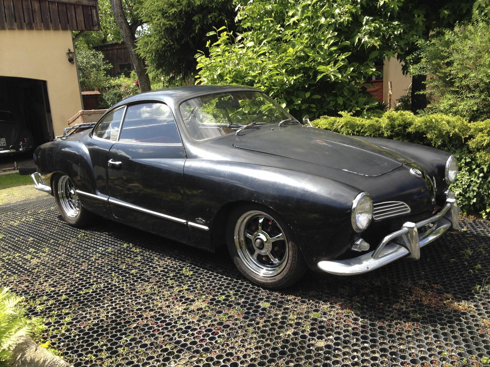

Hello Ghia friends.
I have been thinking about starting a new thread here for a while but in fact that I haven´t done much to the car except of collecting parts I was just studying the existing topics here to get a bit more into the Ghia world. But now the Ghia has been moved out of its corner and I started to take a closer look to it.
Some words to me: Aircooled cars have accompanied me since my childhood. I grew up with beetles. There is no picture in the familiy albums without beetle toys, shirts or cars. My parents ever took me to numerous vw meetings and it was just a matter of time when I wanted to have an own vw. I finally bought my first 1961 Ragtop in 2005 (21st of November) so almost exact 11 years ago now (how time flys). For the resto of this car I had a lot of help from my dad. He is some kind of a metal magician and restoring beetles since more than 35 years. With the growing experience I startet an own body off project in 2011 (1962 Beetle) and I was now able to do almost everything on my own except of the welding but there were just a few little corners.
Whats next...?? That was a good question. I didn´t know if I should start something else because such projects aren´t cheap and take a lot of time and more cars need more space...BUT I wasn´t able to resist and wanted to try something else. I took some beers with my dad and we were just talking about past builds and then he just asked "What do you think about a Ghia as a last "Father-Son-Project". I thought why not and he just said: Listen, I can help you with the metal work again but you need to do the rest IF I can drive it from time to time Smile >> DEAL!!...or it was more like Cheers Smile
So I started checking out some cars here in Germany but I didnt find a payable project. I even flew to sweden to see a Ghia in Stockholm but at the end it was too rusty for its price so I continued to look around. Finally I found a car in the south of Germany. It was a 1962 Ghia which has been reimported from San Bernardino. Unfortunately it had a crash on the driver side but the seller still organized a good spare part so after a short visit I bought the car last year and just picked it up some weeks later.
Choclate side Wink
Some people told me they never would have bought a crashed Ghia but sometimes its better to have a car with obvious weaknesses compared with a hidden nightmare for a lot of money. The car is almost rust free and we think we can handle it...
I think this is enough introduction so far. I will keep you up to date
I hope my english understandable.
Cheers
Rob
P.S.: Maybe someone has seen the car before? Just let me know. The history would be very interessting to me.

Well first of all Rob, welcome to The Samba. Smile
Let's get this out of the way first...your written English is very close to perfect...better than many for whom English is their first language.
Yes we see many nightmares uncovered here on a daily basis...you're very wise to have waited for the right Ghia. Often people are seduced by a pretty face only to find out that the real character lies a little deeper. Wink
Looking forward to watching you and your father's progress. Smile

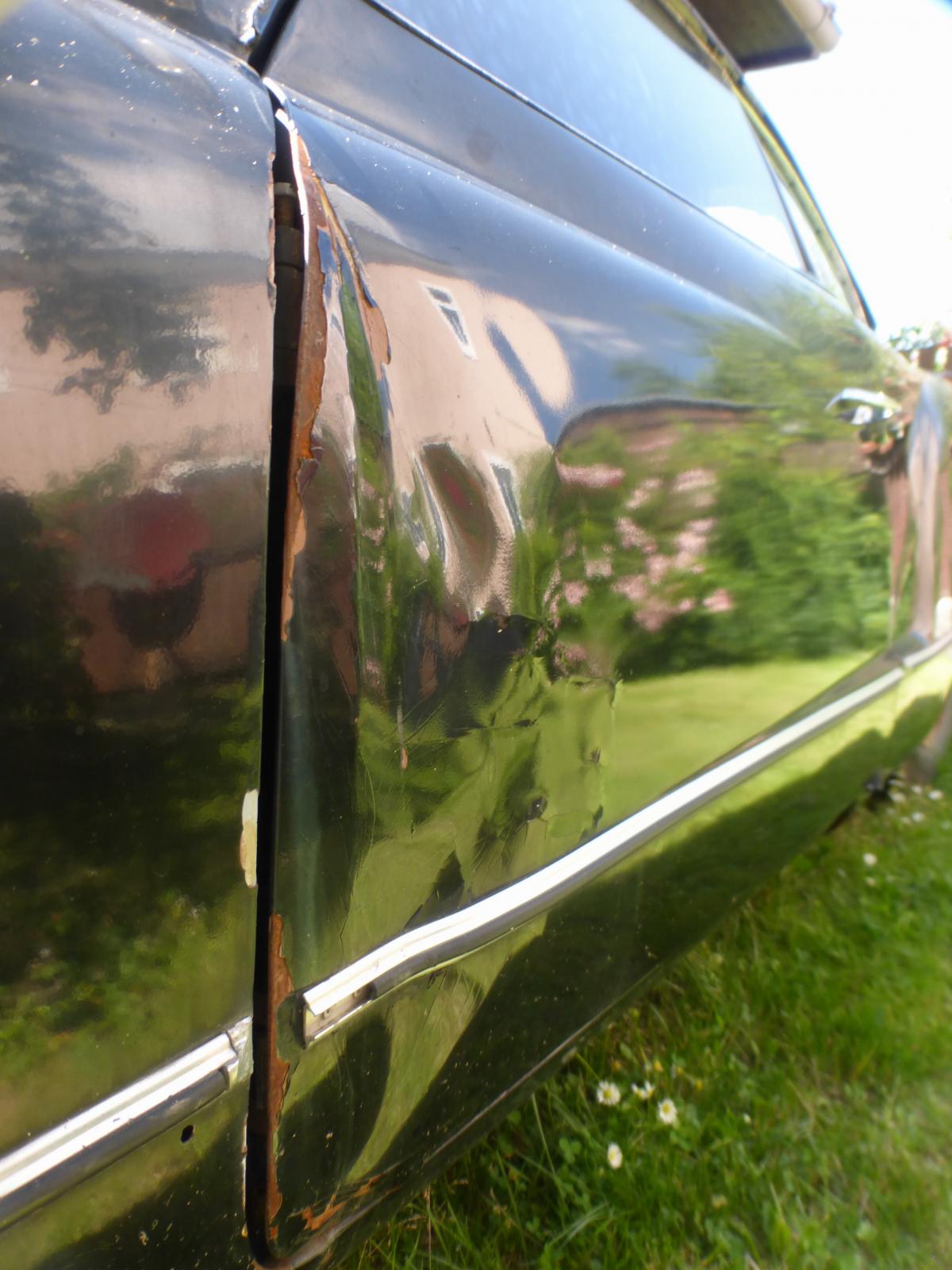

By the way the factory color of the car was terra brown L571 with pearl white roof (580). The doors aswell as front and rear hood seem to be original according to the inside paint.
Unfortunately the driver door has been overstretched...maybe because of a torn door check strap. BUT I think the door can be rescued although somebody still tried to fix it "professionally".

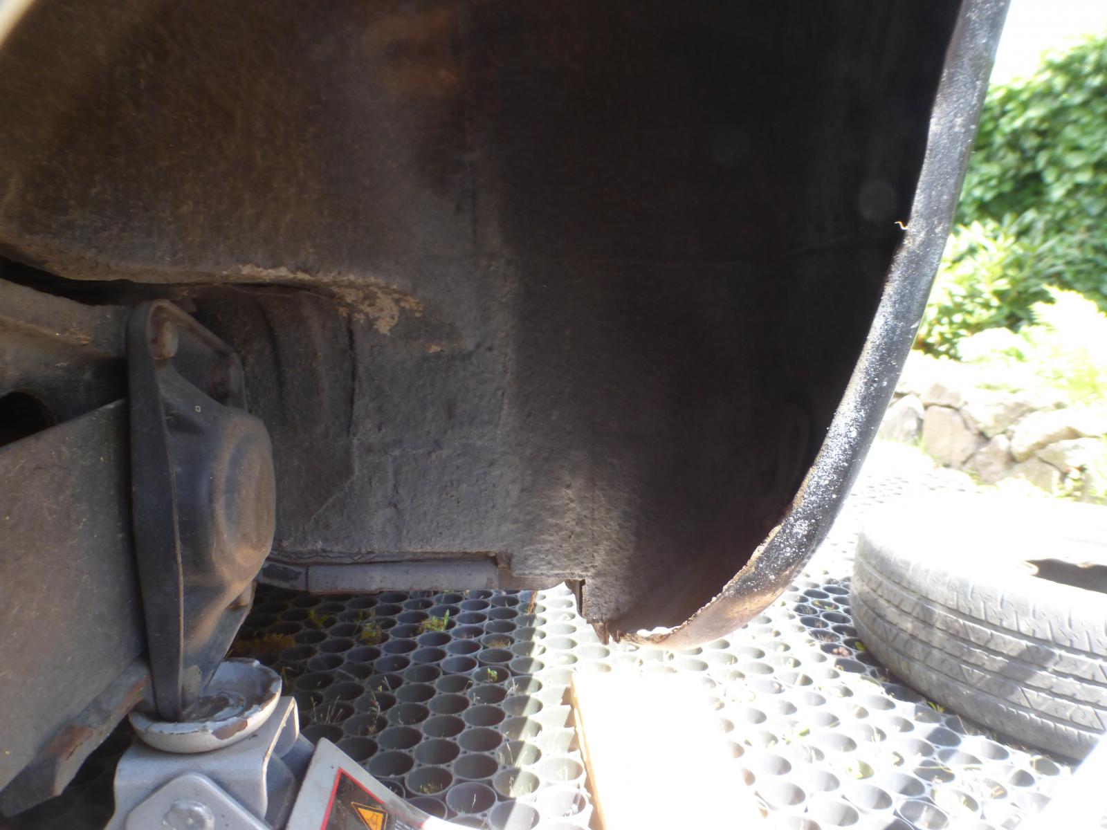

Here I have some more pics I took last summer. I hope there will be no big suprises..

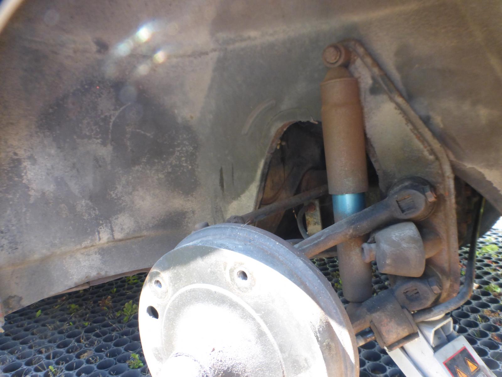

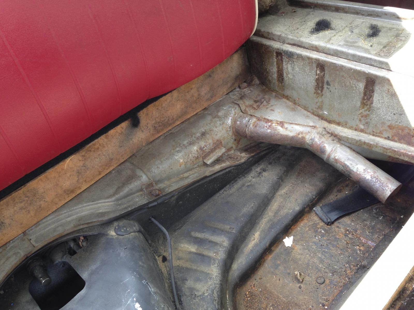

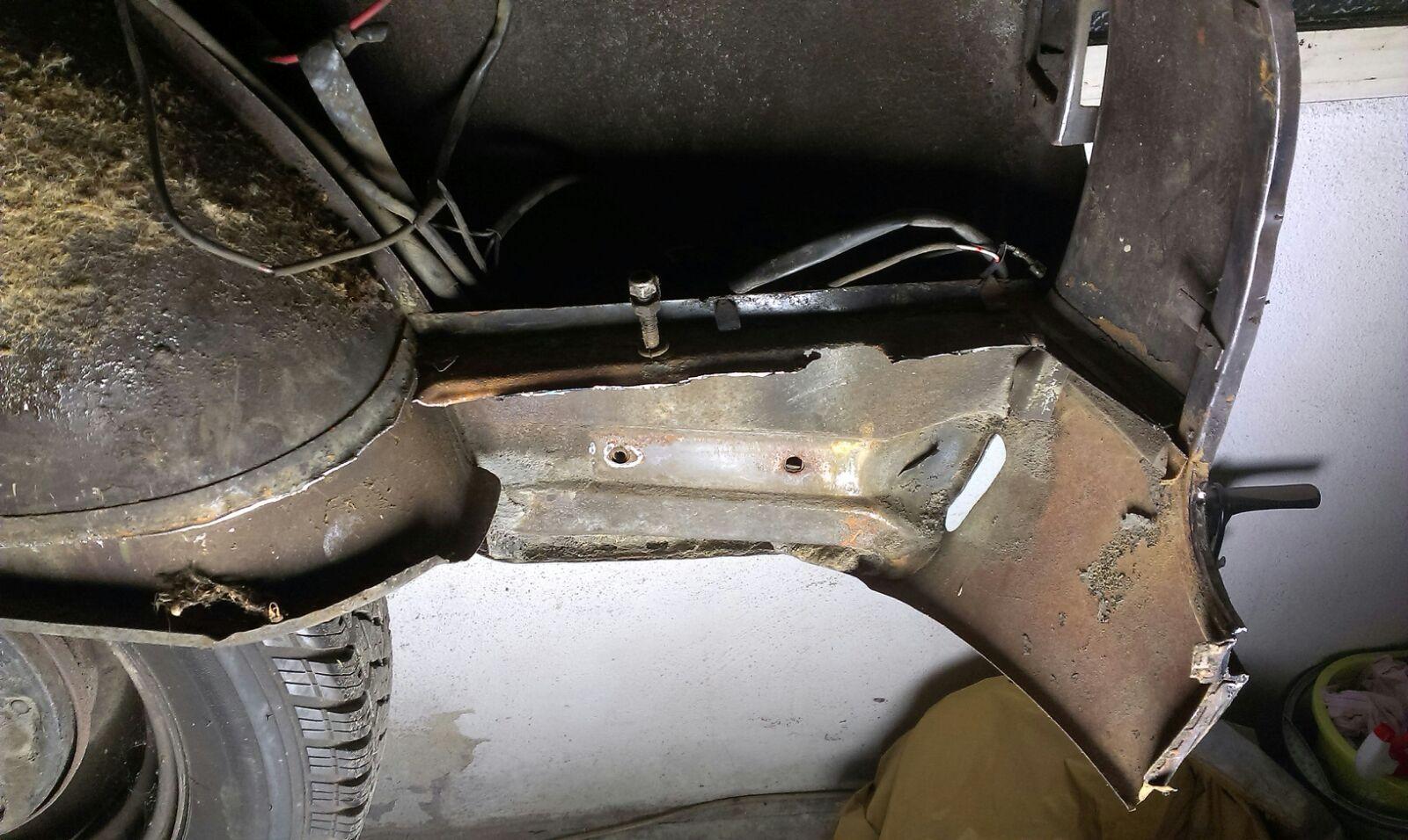

Today I did the first cuts on the Ghia. I first removed the fender and just noticed that someone replaced this fender one time before. Fortnutately it was not welded in with many points so it was quite easy to put it off. I suppose the welder was drunk while doing the job...really bad done!
Here are some pics.."enjoy":
Just to get some XMAS atmosphere...
No worrys with the heater channels. Nothing bended and almost no rust...
Maybe I gong rescue the bumper mount metal....

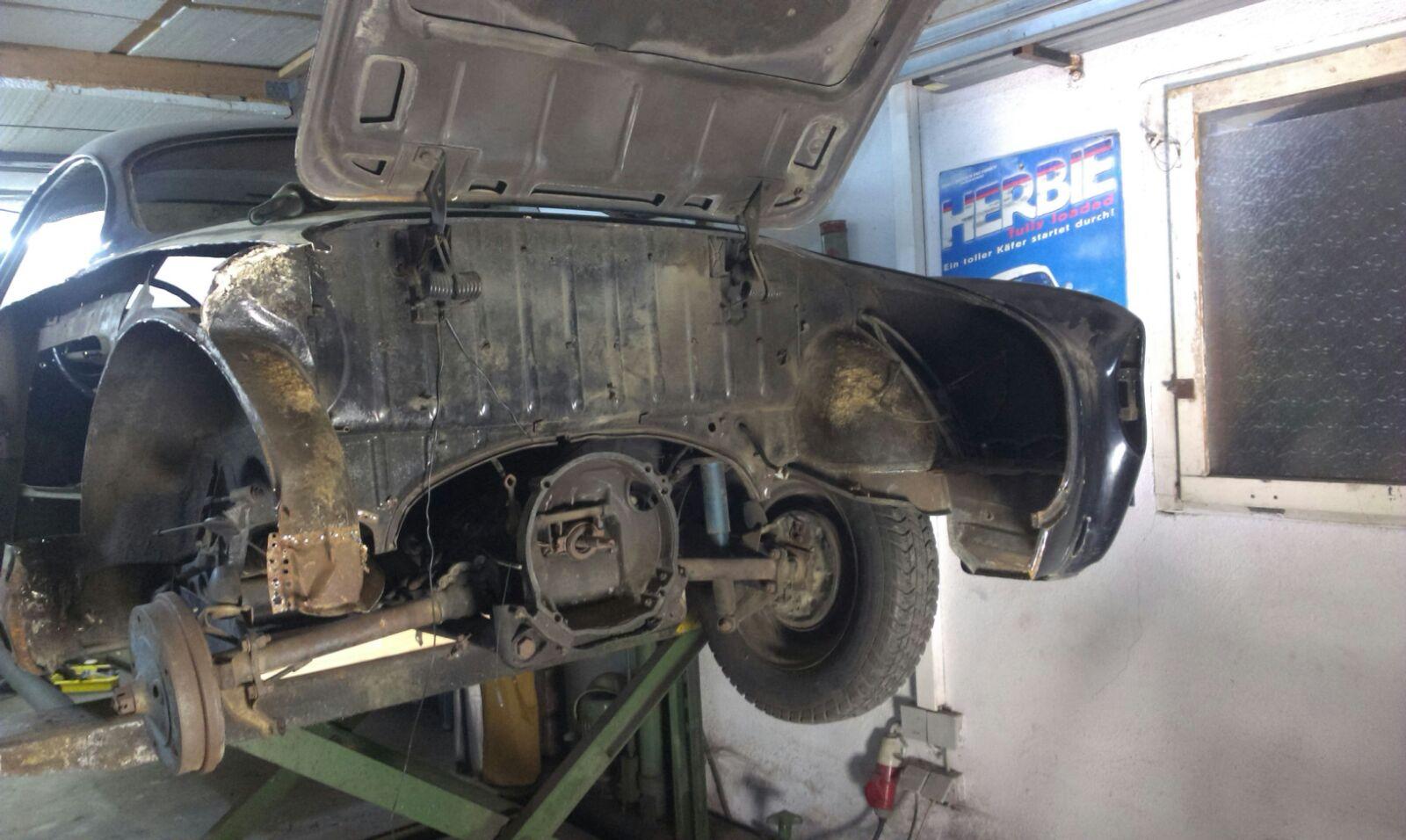

Here are some pics of the progress yesterday. I removed the engine bay and the outside of the wheel shell...
Bumper mount looks quite good..
Not sure if I keep the inner shell or not...I have to measure the differences to the passenger side first
I think can save the apron (middle section) incl.seal channel... so if somebody needs a spare just let me know Wink

PostPosted: Mon Nov 28, 2016 5:50 pm    Post subject: Re: 1962 - "San Bernardino" - Ghia Project Reply with quote
Have you given any thought to how you are going to install the new engine tin, valence etc? It seems to me that everything kind of floats in there and it will be difficult to get the correct alignment of everything before you make the final welds. Maybe using the rear hood will give a reference position. I'll have to look at mine tomorrow.
Dave
That's a really good point.
Given I did an almost identical repair.... I omitted to properly check the fit of the engine tin before the replacement of the valance and "battery" panels. Luckily mine do fit but only just. If there was an extra 5mm at the rear and more particularly the side that was replaced then it would be an easier squeeze with the tin and the rubber seal.
Better too large than too small and given the seal itself has a "tongue" of some 40mm, it can cope with a bit of extra gap than no gap at all.

Dave / Nicholas...really good points...sounds like a really good plan.
My plan is the following... I am going to use/mount an engine block (just an empty case and some heads) with all necessary metal around it to have an orientation for the engine bay and seal. So I am going to leave the body on the pan. The original welding points at the wheel housing should have the almost correct position at least for the passenger side so there I could fix the spare with some screws first. For the hight of the rear valance I can check the gaps of the hood. The final step will be the bumper mount.
But this is just the theory. Of course I have to check everything several times before welding all the metal in...especially in Kombination with the new fender.
Dave..thanks for the hint with perpendicularity...I think this will help too. I am curious of your next results so keep us up to date in your thread!

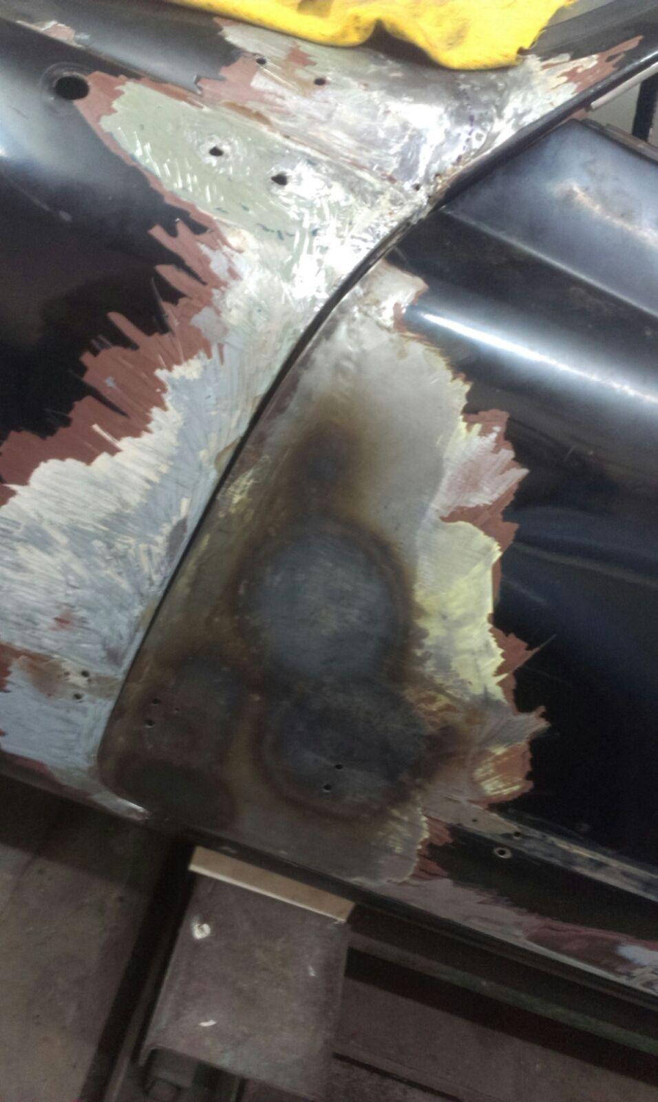

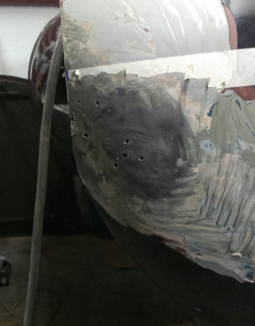

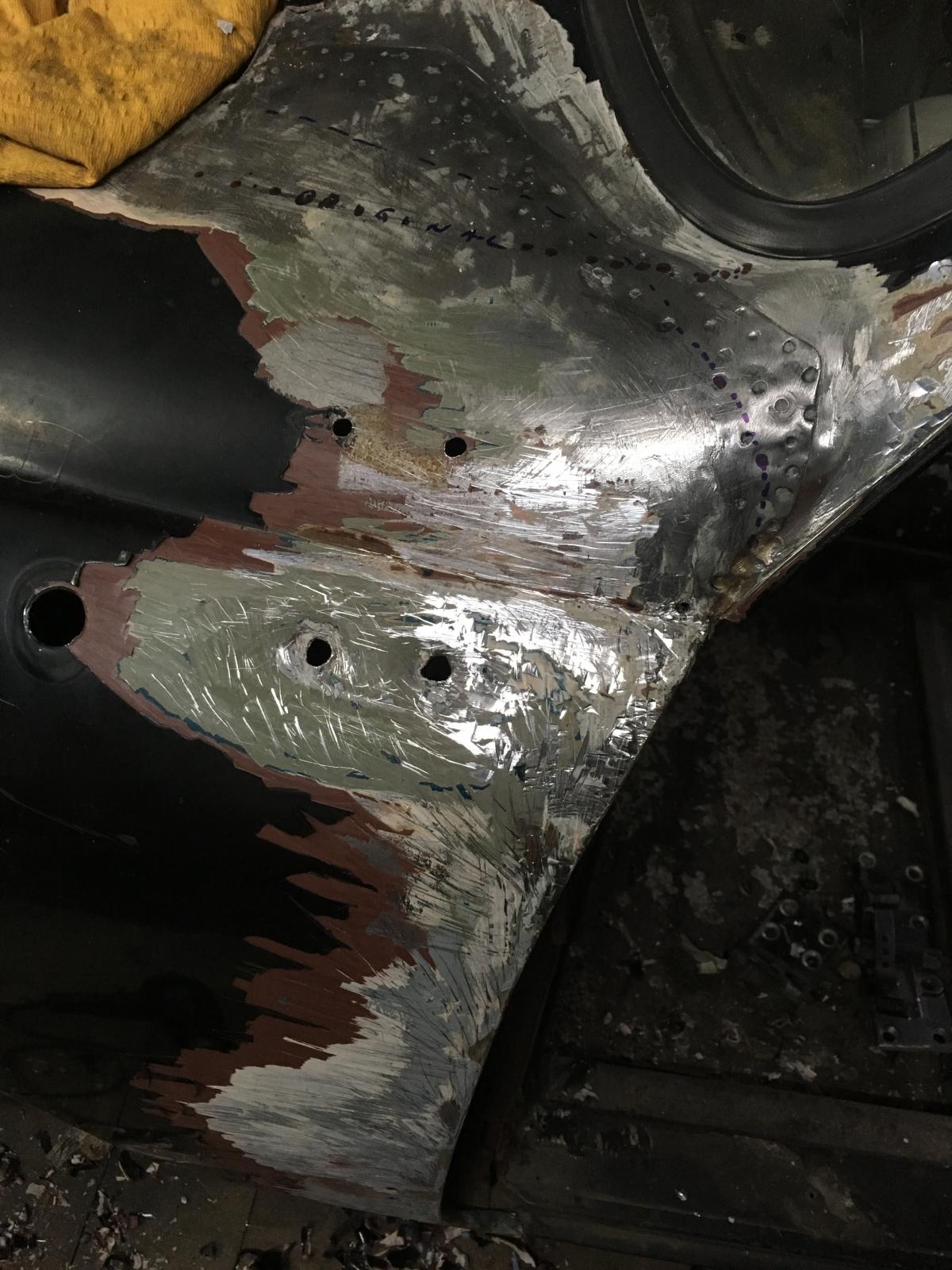

We started the first preparations for the fender replacement which is a straight door in the correct position. Fortunately my dad was able to rescue the original door with a little "metal-massage"...
I think with some lead/ pewter this will be a really good result at the end.

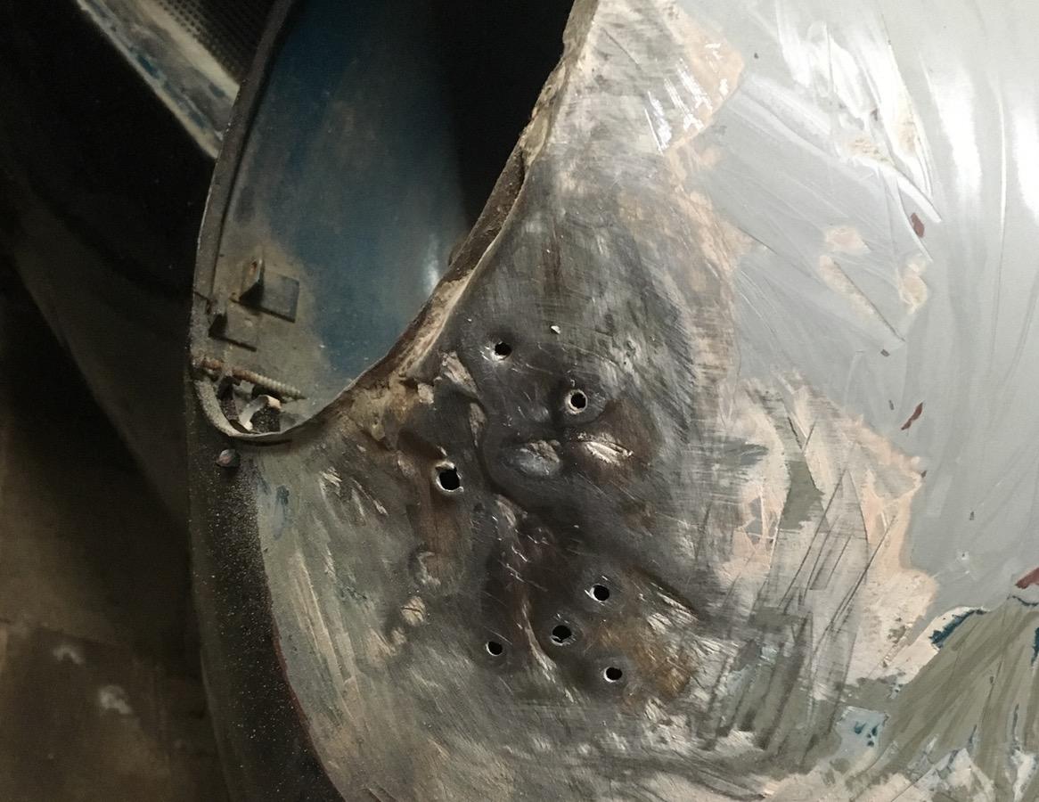

BUT I also discovered a bad thing....the front fender has been replaced in the past and the execution is more or less appropriate. Despite the upper area (next pic) I can live with the repair but I am going to replace this section because this is a mess....
Futhermore we have to correct the gap of the door becauce the guys who did this have ignored the line of the roof so the gap is opening at the top.

We had some time for the Ghia between family and eating and made a good progress in investigating of what had happened to the car and what the next steps will look like.

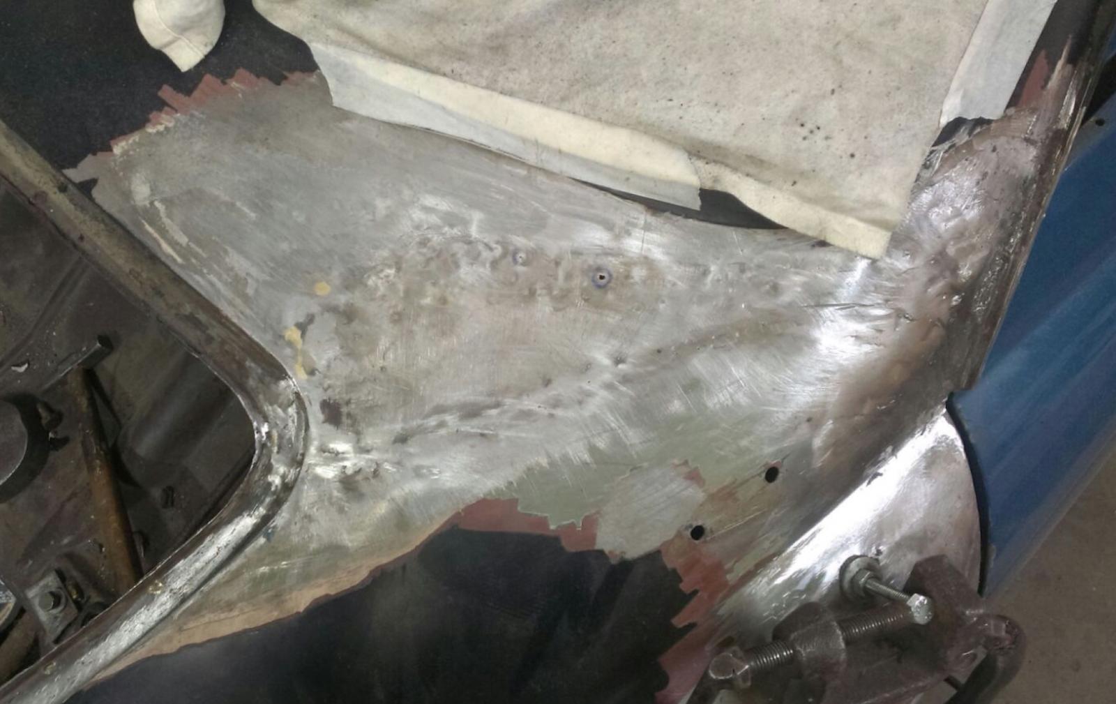

Step number one is still the right fit of the door. At the top the front fender seems to be about 3-4mm too far forward so we definitely need to correct the door gap later. BUT with the help of a really nice "new" door we have a good base for everything around.
Anyway we started to beautify the previous welding trial. The previous owner just overlapped the metal in this area and fixed it with some welding points. We just removed the excess material and connected the original and the "new" fender with a continuous weld.
Furthermore we removed the headlight bucket to smooth the metal in that section:
