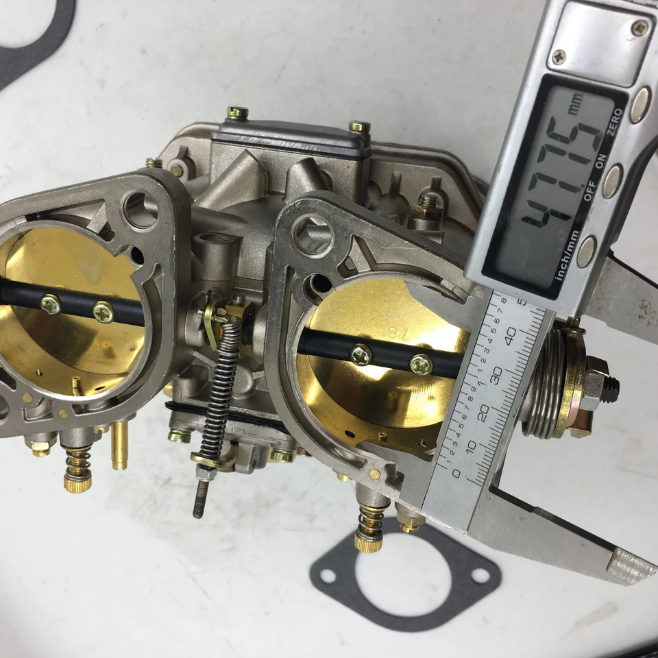

China IDF.
Has anyone seen this one ??
Interesting 40 IDF, different castings, 26 mm Venturis, F7 emulsion tubes.
edit.. also looks to be set up for Center pull Linkage.
wondering what anyone might think about these for a smaller displacement engine.
https://www.ebay.com/itm/356011841530?_skw=racing&...Swnuhm19P8

Here is a link of the same ones with the extended fuel bowl:
https://www.ebay.com/itm/326236075464?_skw=40+idf+...BM4Nnrjc1k
I dont know anything about these. These are from the seller that sells the FAJS idfs. For that reason, im suspect if these come from their also. In the past they were not as good as one of the other larger factories with the other non FAJS IDF's. Maybe they are great though, who knows. That casting looks super clean.
