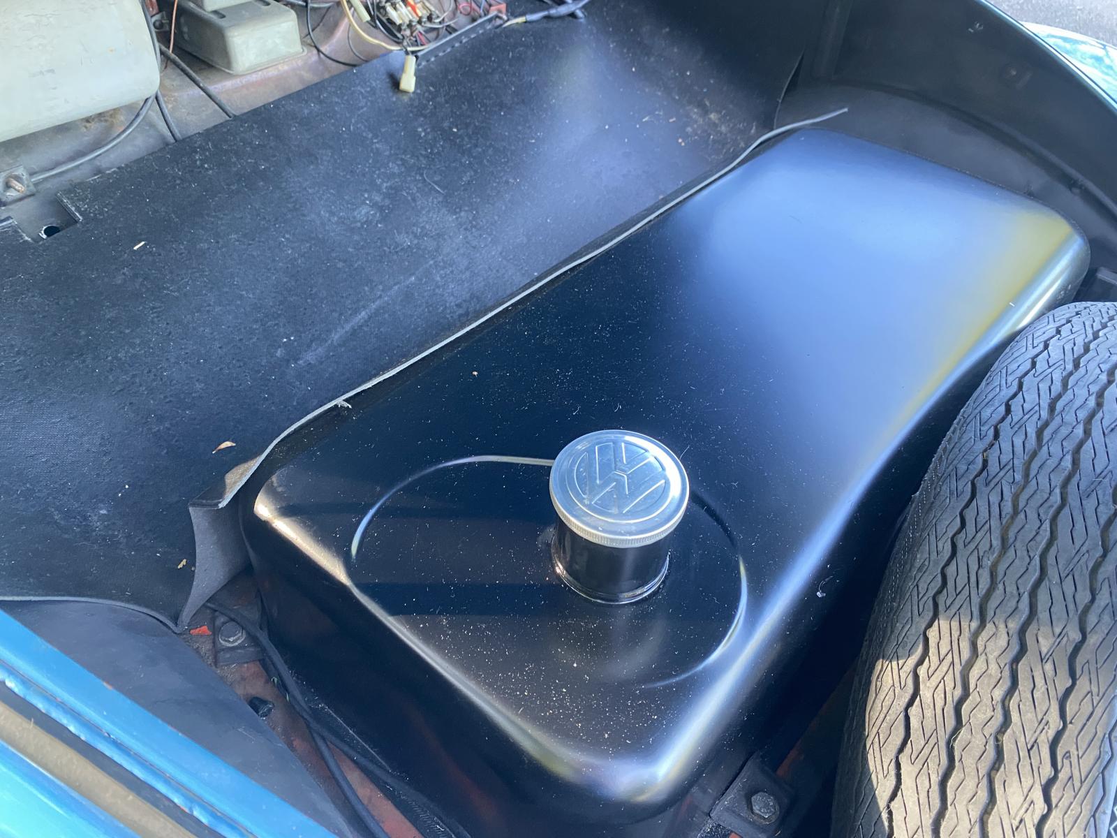

Update: In the '60-61 thread someone showed me the exact tank mine has. I ordered a cap from them, and that solved the issue of fumes. Apparently the old cap I had was stripped out. New one seals great.

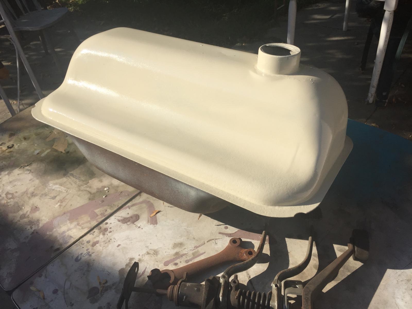

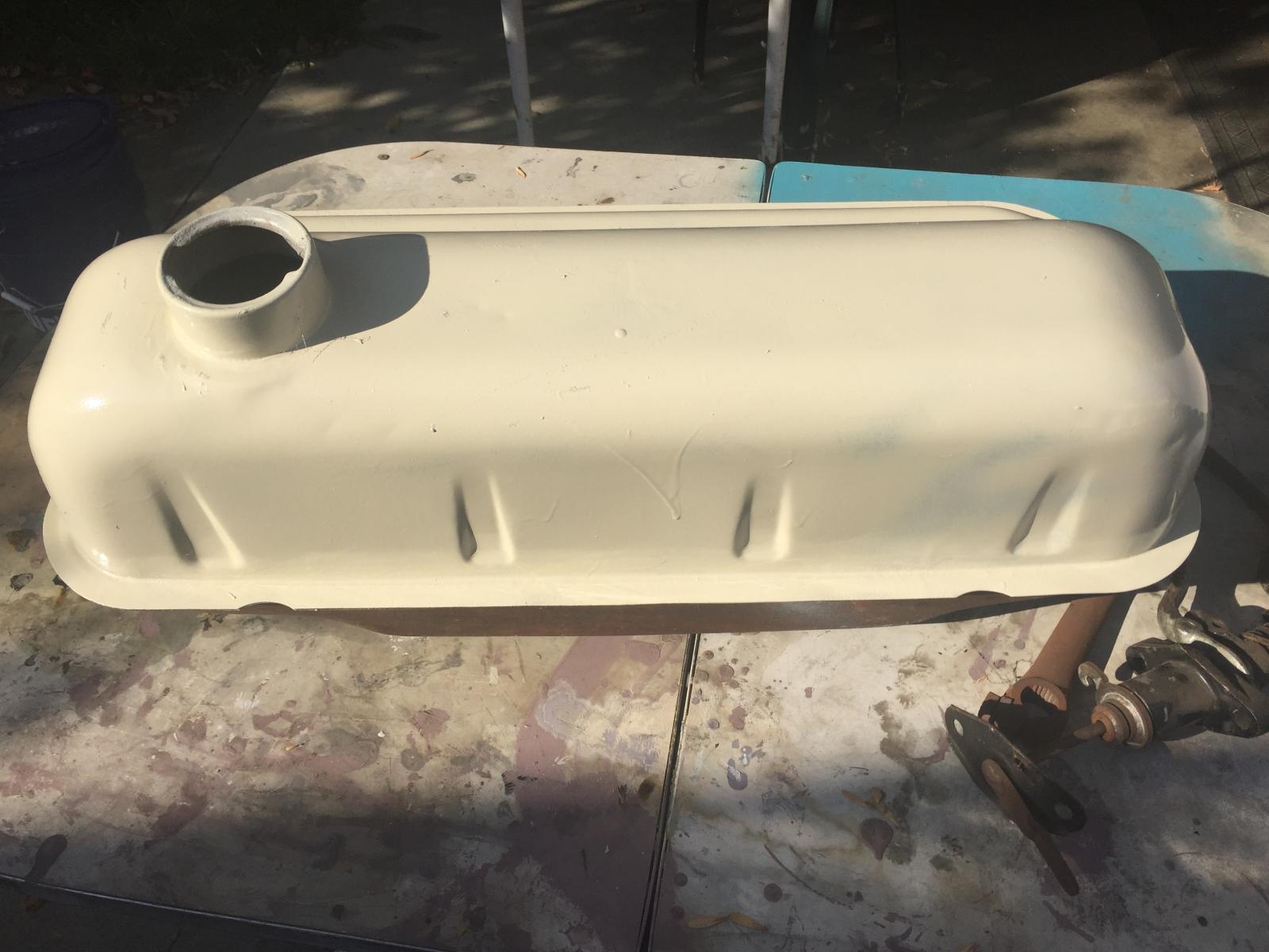

This is not a '60 tank:
A '57-'60 tank looks like this:
The photo was posted by ATLvolksfan
I also notice in this photo the gas cap extension setup that provided a sealed and vented tank. Normally the 1960 and older Bugs run a vented gas cap and they do tend to have a bit of a gas smell because of that. The sealed and vented topper should move the gas smell out of the trunk area to an open vent behind the tire, like on 1961 through 1967 Bugs. If you park it in a garage you will likely still notice a bit of gas smell. This is pretty much true for all Bugs (and all other cars) too old to have a charcoal can vapor recovery system.

To be correct this is a 1960 only tank, notice the notches on the lip where the mounting tabs hold it down Very Happy
