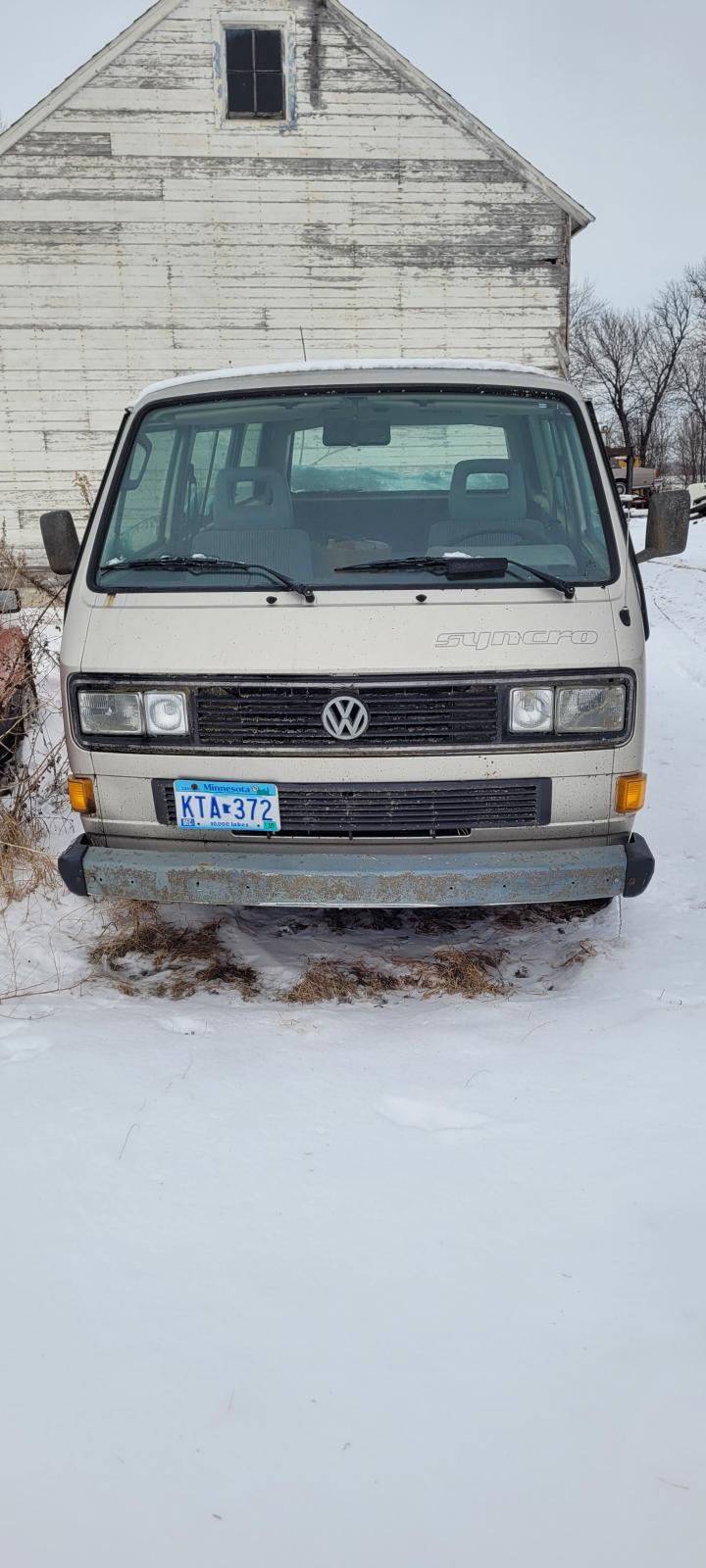

Hello all, I figured I’d give a little introduction,
I’ve been an aircooled owner for a long time and been into the bays but I decided it was time to get something a little newer. My current daily is my 71 westy I dragged out of a junkyard last year and subie swapped, it’s been great but I’ve always wanted 4wd since I like to do a bit of off-roading and go to school in a very steep, snowy town of Houghton. I sold my 72 westy I restored in high school recently and was thinking about another project. I was between a diesel rabbit truck and a Syncro.
A while ago (maybe year) I saw two syncros projects for sale in Minnesota that were for sale on here that were clean, but I still had the 72 and higher than I was looking to drop. The ads went down, I forgot about them then the ad came up again recently for the 87 (currently still for sale). I talked with the owner, and he said he had a 91 he’d sell for not much more and was cleaner, I got the pictures from him and it was extremely clean.
It was a Minnesota van that he bought with the 87 from the original owner. The previous owner bought it new on a trip to New Mexico and drove it back. He used it for ski trips out west and took car of it well. It had 170k miles but minimal rust and very few dents. It was parked in 05 and was inside/ on gravel outside for a long time.
After much think and debating, I decided I wanted to get it. I got my dad to come with me to pick up with me (big thanks to him). We visited family in Indiana over the last few days and then hit the road early this morning to pick it up in Minnesota. We got it, the seller is a great guy and helped get it on the trailer and he had a lot of cool VWs, he still has an 87 Syncro for sale too.
It’s in amazing condition to say the least, the interior is perfect, it’s very complete. I only found one rust hole and the cat was cut off. It even had the original rear bumper and hubcaps. It also came with dealership receipts of work done. I found it had 7K in work done on it between 2002-2005 Shocked I believe it got a new engine in 02 even from the one receipt, it seems like it was well taken care of compared to my last projects.
This seems like it should be an easy project compared to my previous, it wasn’t full of rotting things or driven into the ground. It was made more recently than my previous projects had been on the road Laughing To say the least I’m excited and lucked out to find this one and be able to get it.
More pictures and details to come. I’m passenger as my dad is still driving across Wisconsin right now. I’ll start on it tomorrow once I get back home later in the day with it.
I’ll probably need some help with a few things since I’ve barely touched a vanagon before. I helped my friend with his 87 Wolfsburg edition a little and got the chance to drive that. That’s a bit what pushed me to get one and seeing vanagons at the campouts I went to over the summer in my 71. And my 71 is what convinced my friend to get the 87 going to it’s a dangerous cycle Laughing
Thanks for reading, Aiden

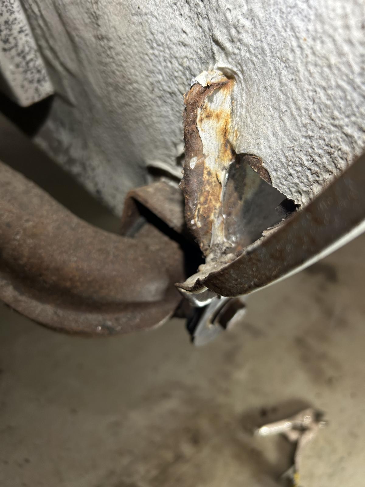

On the way home yesterday, I stopped and power washed it on the way home, it cleaned up nice. When I got home, I started and threw out the home carpeting that was put in it. It was covered in mouse crap and poison. Then I went through the interior vacuuming it, then taking a wet soapy rag and wiping down everything in the interior that wasn’t cloth. It cleaned up really nice and is all in good shape. There is one small section where the stitching came undone on the passenger seat but otherwise it’s perfect. The floors are solid and zero rust.
The engine got a quick wash when I washed the rest of it. It’s all there. I pulled plugs and turned it over today and inspected it with a scope. It turns over nice and smooth. Tomorrow I plan on trying to get it going. I had to do some work on my 71 before I could spend too much time on this.

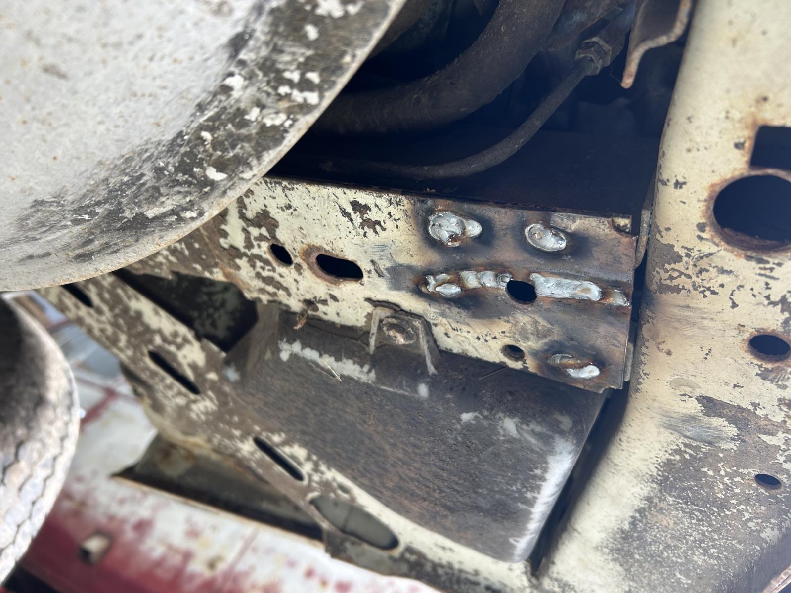

The worst thing I’ve found for body damage is someone hooked to the front edge of the frame rails by the bumper and tore the metal. Not too badly though, I’ll just clean it up and re-weld it.
I put the rear carpet and mattress on the roof while I worked on the engine
I also pulled down the spare tire, there were climbing ropes in a bag in it Laughing
I also found this in a plastic bag twist tied to the heater lines, it looks like it’s used for filing up coolant Question anyone that can confirm or knows?
Is this just a test plug?
I also hooked up a battery to test the electrical, most everything worked! The turn signals and hazards work, wipers, squirters, dome lights, driving lights, high beams, dash lights, rear heater fan, horn, AC fan, radio, side markers after giving them a tap, brake lights, starter and a few other things I’m forgetting.
What didn’t work was the low beams, they came on with the brights but when I hit low beams, all the lights went out. The front heater fan didn’t work. The reverse lights didn’t work either. I was happily surprised. There was only one burnt out bulb.
“Rome” 91 Syncro

This morning I got the front frame patched. I pulled the one piece off that was barely hanging on. I flattened it out, drilled the spot weld holes bigger to weld and ground the edge smooth of the piece. I hit the pieces with weld through primer before welding them in place. I also welded the crack in the other side
I did a temporary fix to a coolant leak it had and filled it with coolant so I could run it for a minute. We have a long driveway so I gave it a quick run to see how it did. The clutch feels great, brake stop good, it runs good, steers easy, shifts great, for sitting 20 years I was impressed how good it felt. It felt like it never sat, I was really impressed. The driveway isn’t long enough to get to 4th, but I got into every other gear, R,L,1,2 and 3rd and they all went in easy, were smooth, and they didn’t make any noise.
Then I started on fixing the rust spot on the lower rear quarter. I formed a new panel for it and plan to weld it in tomorrow. Thankfully the structural part was solid. It looks like the pitting is worse but it was just the light I was using. I also have the small triangular part in the wheel well I need to replace.
