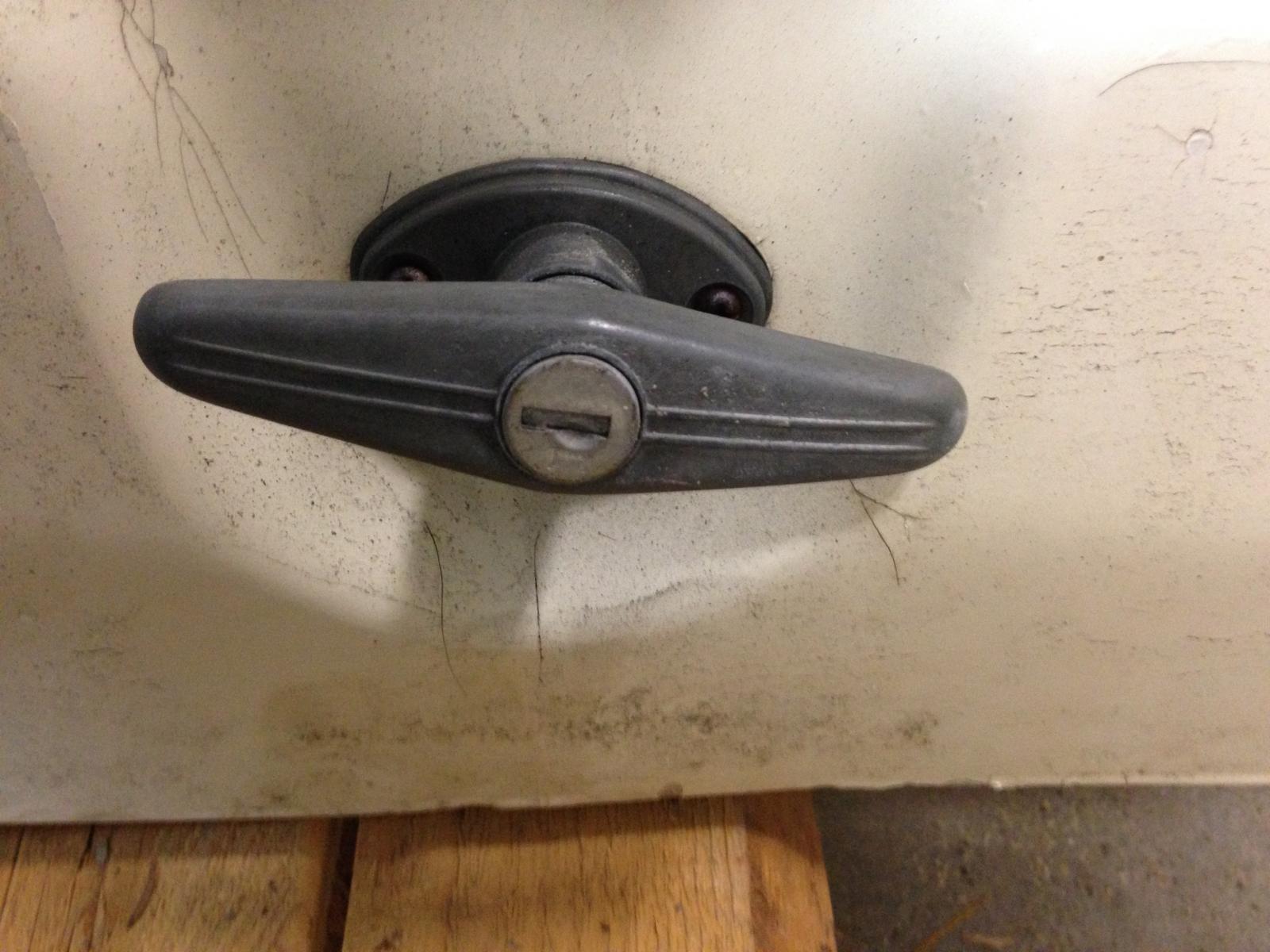

My doka's Vindic canopy is getting old, rusted and cracking. I'm looking for a quality fiberglass repair shop that preferrably isn't for boats.
I've tried a few in the Vancouver area but no luck so far. They mostly seem to specialize in boats here and the truck canopy shops don't seem to do repair work.
Ideally I'm looking to have the surface refinished and any edges that are cracking to be fixed up. It also has rust from certain hinges that could be buffed out.
I'm willing to go across the border to somewhere in the PNW if there are quality fiberglass shops elsewhere.

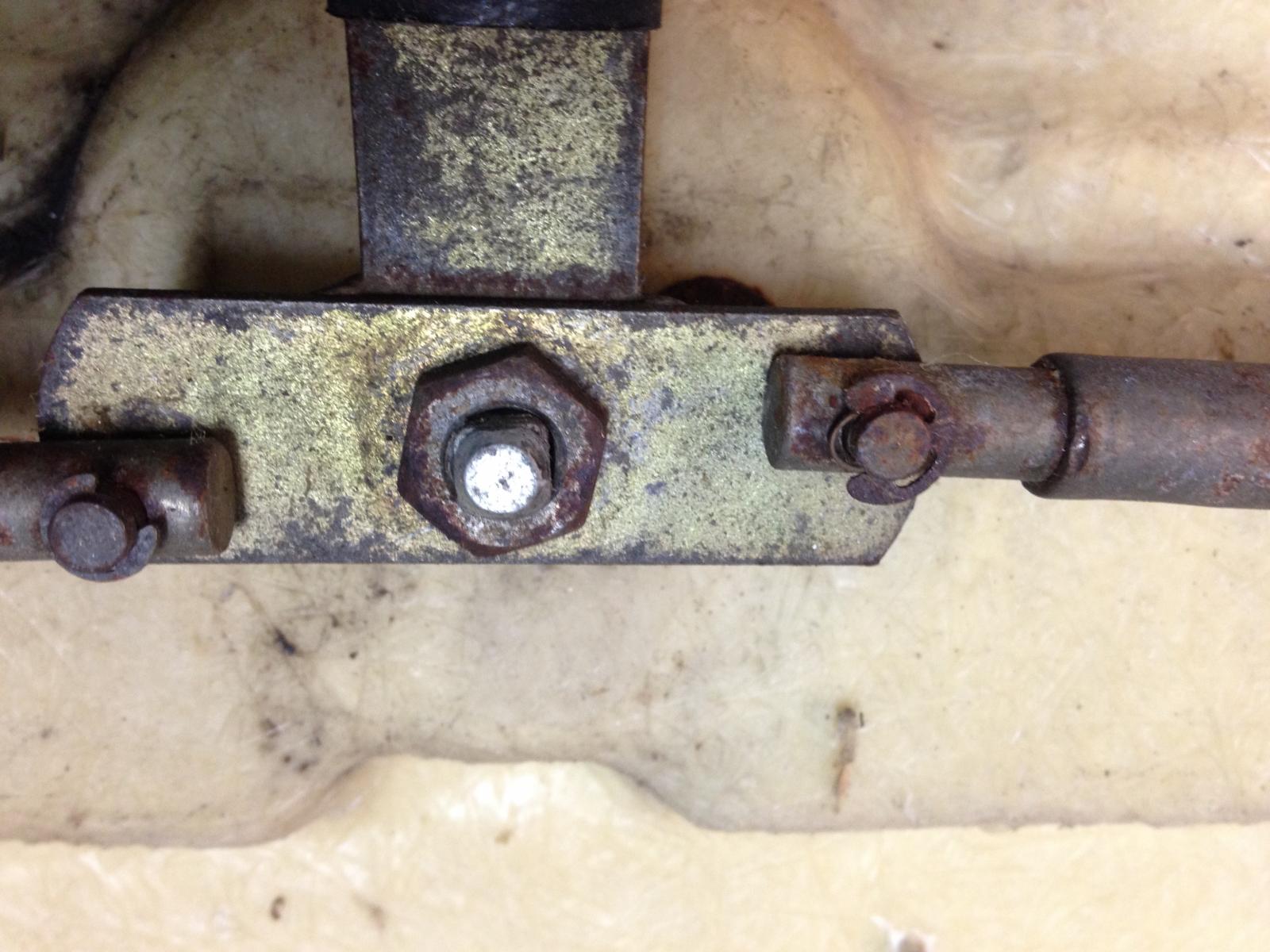

On top of the fiberglass work, my canopy doesn't have working locks. The T-handles are rusted shut and would require a replacement. It is also missing some of the hardware for the locking rods that lock to the frame of the canopy.

I had my Vindic fixed a Corvette Body shop. Childs play to a Fibreglass guy. I bought a set of matching handles from Mc master Carr for under $30.00 shipped. The rods and all the pieces are just off the shelf hardware.
I've seen some guys use rods from a regular Camper shell but they wer smaller in Diameter.

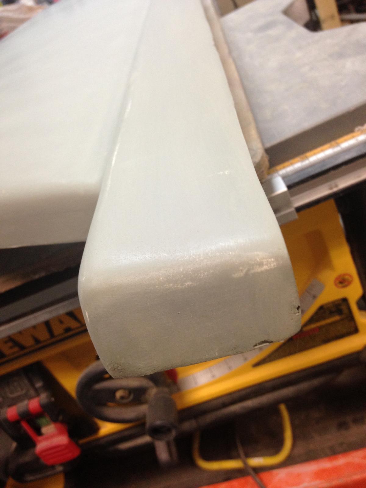

Hey syncrodemaya, from instagram it looks like you guys been putting some mil..er, kilometers on your Doka! Way cool (yes, jealous...)
I’ve been tackling the fiberglass repair for my Vindic, not rocket science work by a long shot but without a shop space it would be pretty difficult - so no leads for you there unfortunately.
But on the hardware side, I went back and looked at those photo’s you sent me way back when I was scratching my head as how to fix mine (thanks again!), I see now yours is nearly identical. And missing three locking rods.
On the handles, these - http://www.technologylk.com/truck-cap-locking-t-handles-pair-set-lk-TC311SET.html - match up to what I’ve got on my canopy - same size, hole pattern and stem. I haven’t ordered them yet (got distracted finding and eradicating rust on my doka Crying or Very sad ) but I emailed a query as to getting matching key/locks and was told hey are all keyed the same so can order three and use the same key. Very straight forward swapout with those.
The long locking rods are just lightweight conduit like this - https://www.mcmaster.com/=1egopz - from the McMaster-Carr as per 16VC’s post. Tho slightly larger diameter than the euro version - might have to toss the plastic insert in the end “holders”. Again, I haven’t repaced any yet so no tips past that.

My progress - doors
...now just the main canopy left to do...(ughh)

Thanks for the links, I think the handles will be easy it's mainly the locking rods that were a question mark.
Mine is missing almost all of them so it won't lock at all even if the locks worked.

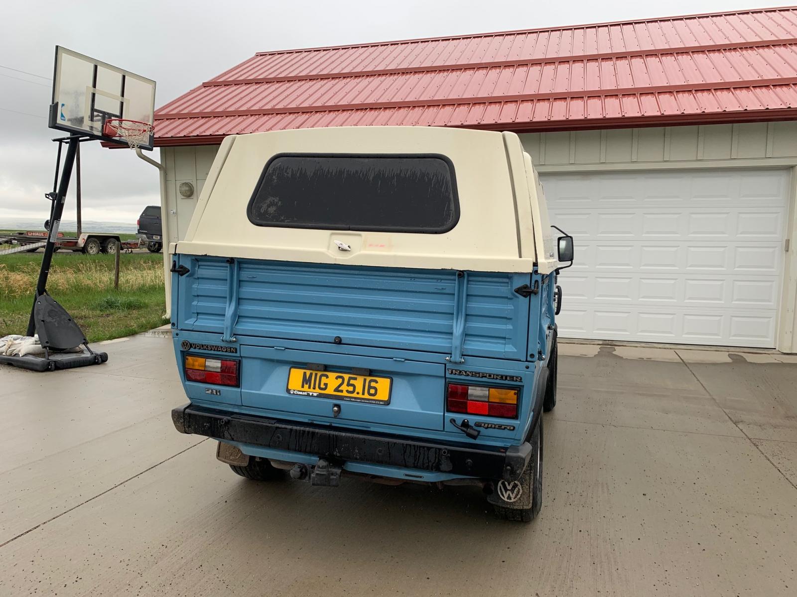

Old thread and kinda silly question, but do any of you guys put your Vindic on and take off by yourself? I do it with my Tundra shell all the time but its much smaller and lighter. We live in the boonies without folks to help nearby, and its too heavy and awkward for the wife to help much.
I tried building a support/lift in our haybarn but it really doesn't work will with the unbalanced weight, 3 sides that open, etc. Probably need a forklift or tractor, which I don't have. Just thought I'd ask to see if anyone has any brilliant schemes!

It would be nice if someone would post a photo of a vindic.
Maybe then some removal ideas may surface?

Good idea Dave! The pieces and parts in the above pics don't really help much do they?

I used the trunk lid handles from an MGB. The parts are available new and they were cheap when I restored my Vindic top.
