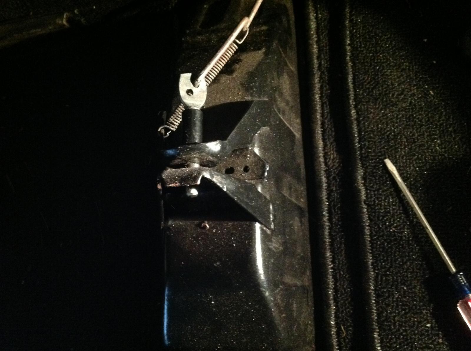

Well, it's been two years since I took these seats out.
I know they had rear travel stops on them.
I found this funny piece of metal in a Baggie..... Hmmm what is it? I called upon the collective brain power here and found out!
http://www.thesamba.com/vw/forum/viewtopic.php?t=555224
Aha! I remember now! One seat had a bolt in the front hole...... One had this clip!
Well, I set the clip on the seat track to show how it works........
NOTE..... I have it off to the side in the photo so you can see both pieces and how they fit together.......

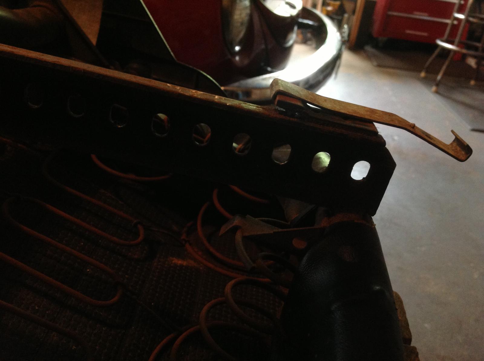

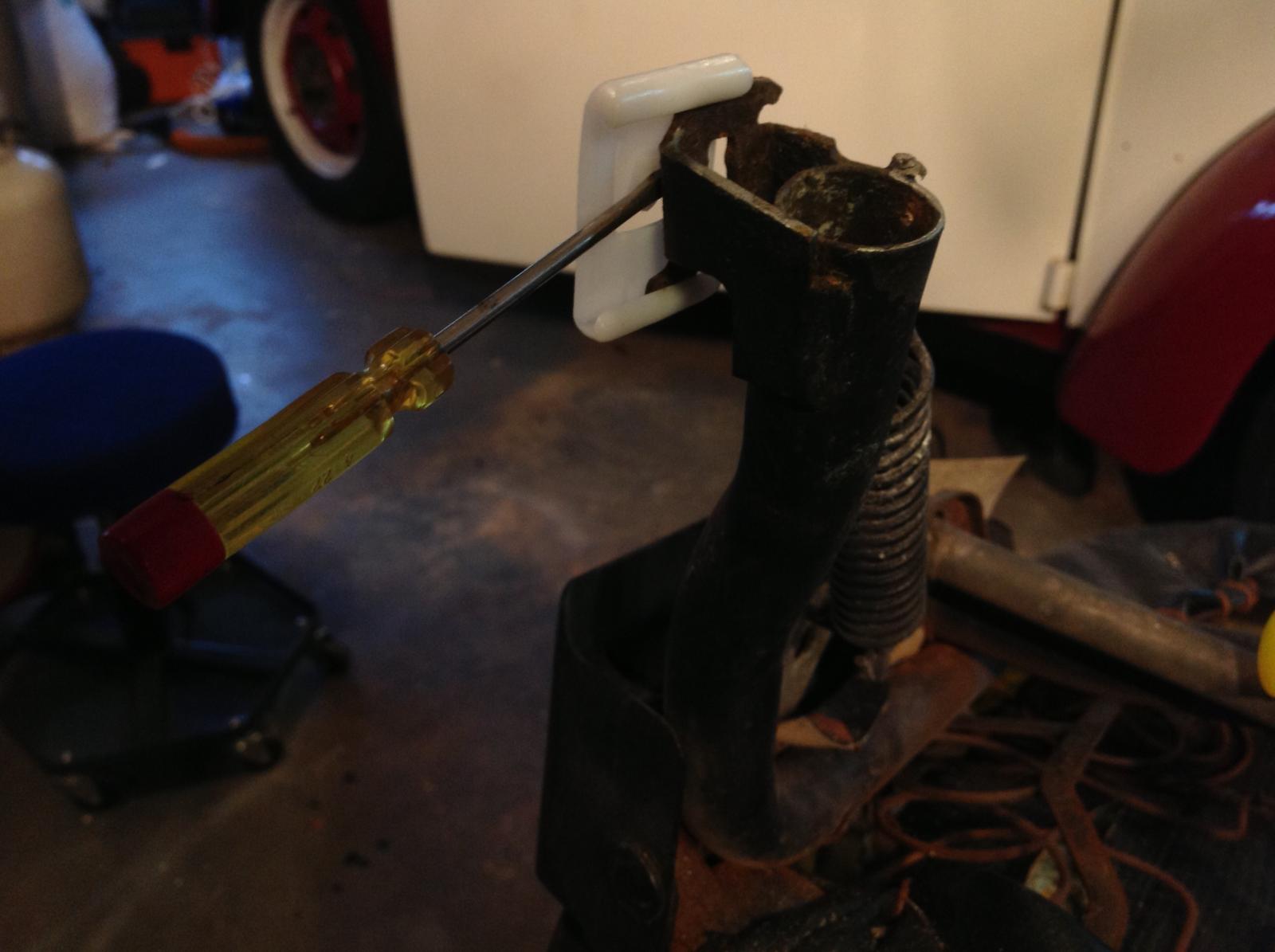

PostPosted: Fri Dec 27, 2013 12:07 pm    Post subject: Reply with quote

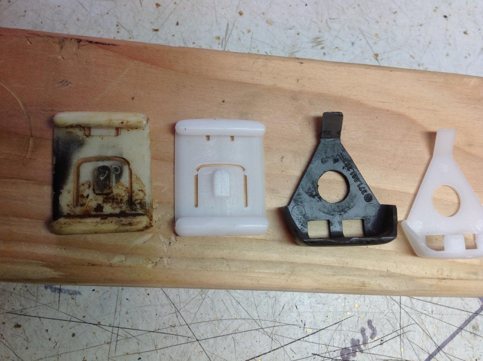

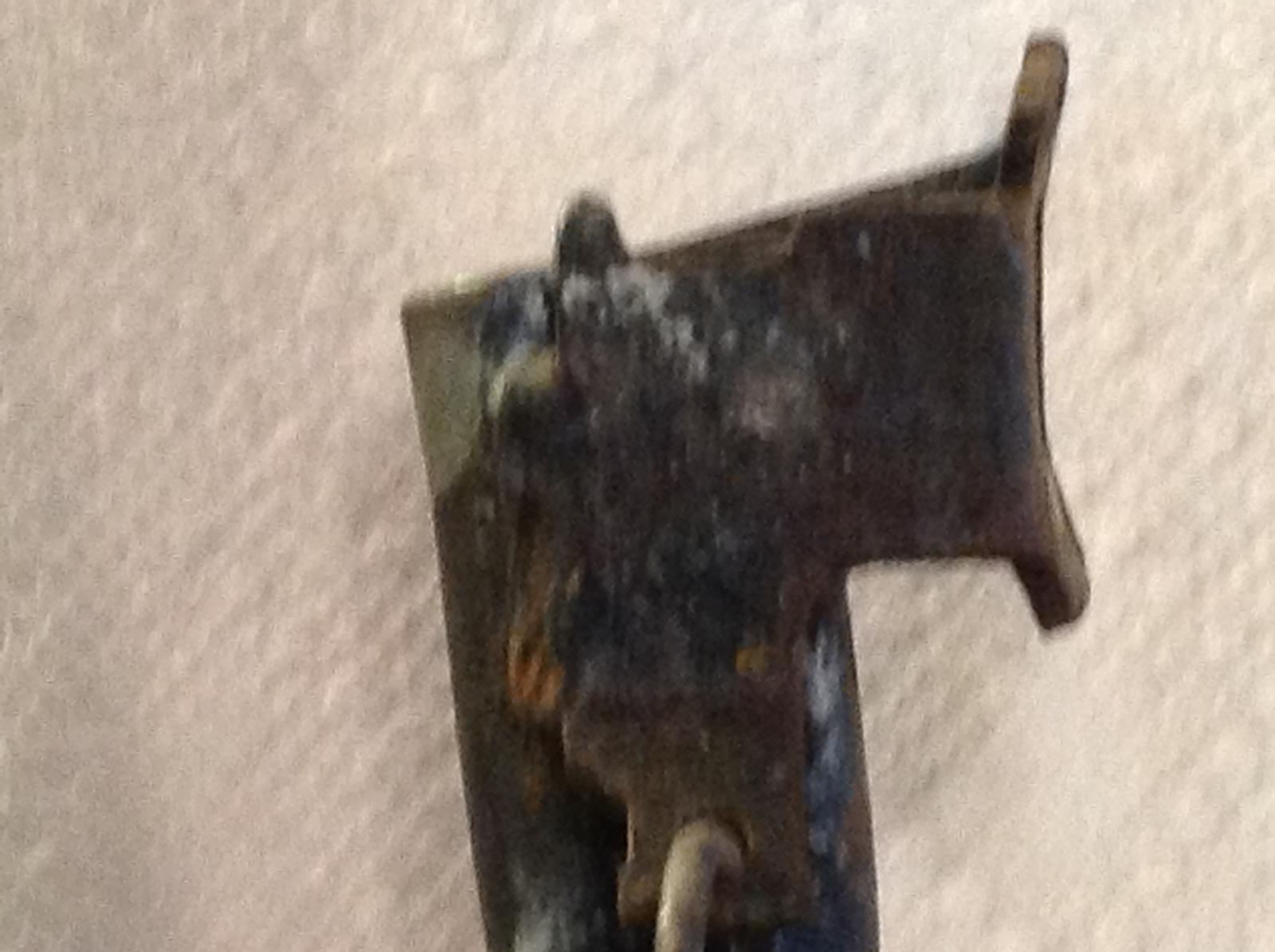

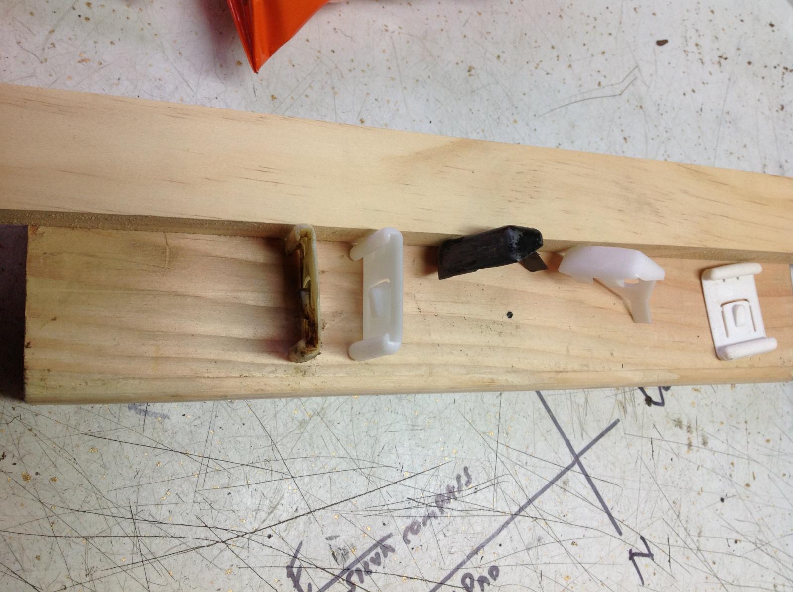

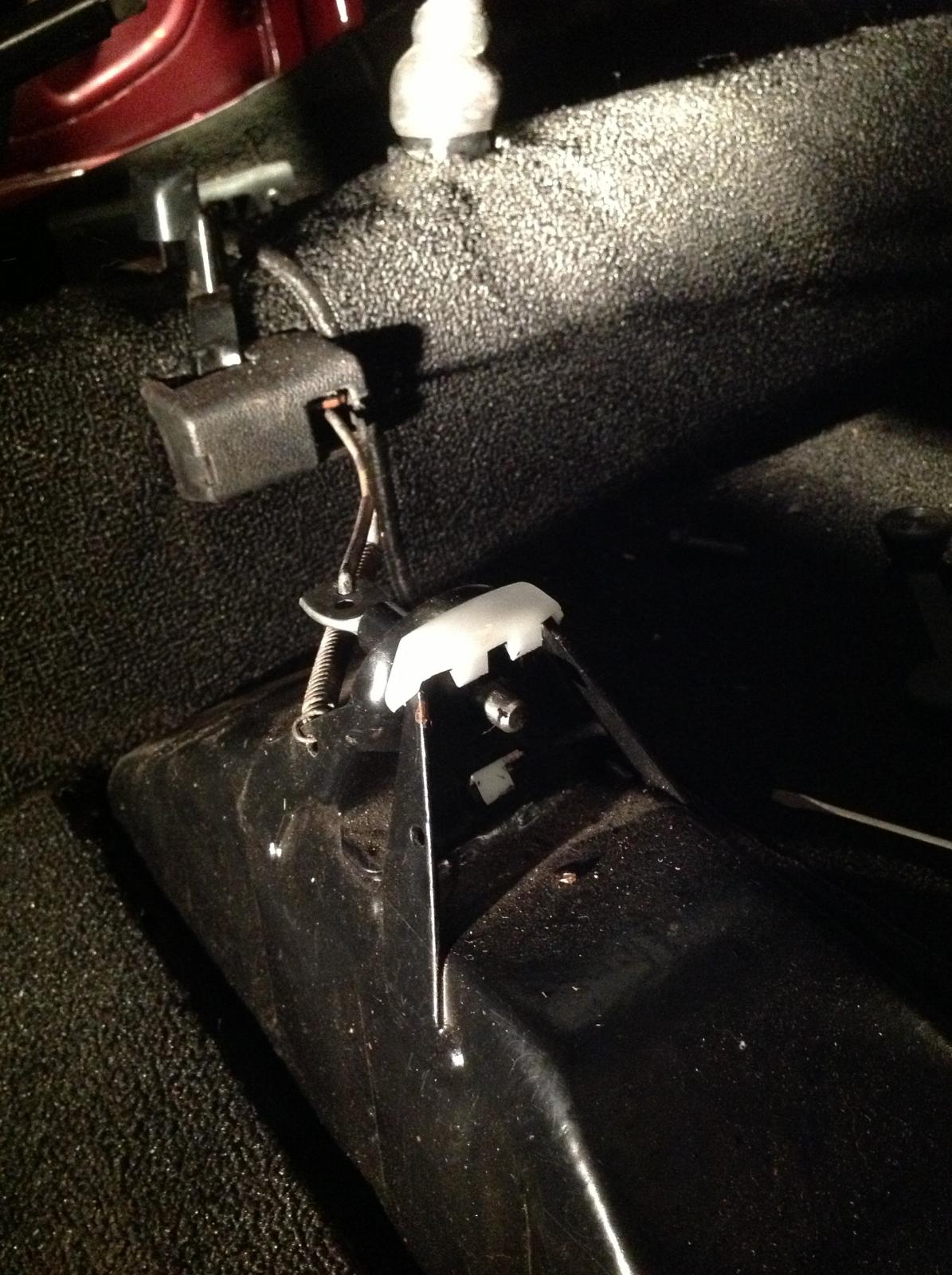

This pic is the drivers seat looking at it from the front. Here is what must be done to remove the seats from a 78 vert. Remove the small bolt circled in red. The yellow arrow is pointing to the pin that holds the seat in place from sliding front and back. Slide that pin out and slide the seat towards the rear of the car out of the tracks.

PostPosted: Fri Dec 27, 2013 5:06 pm    Post subject: Reply with quote
I like the "bolt" set-up better than the memory spring.
I found the seat springs (the flat springs to keep the seat from sliding off the rails) in the PO's box of parts that he gave me. Screwed them in and all is well.
But that bolt on the later models certainly looks more heavy duty to me.

PostPosted: Sat Dec 28, 2013 5:53 am    Post subject: Reply with quote
I only had one spring on my 74, the other seat had a 1/4-20 bolt and nut in the first hole as your photo shows.
Thanks for adding it!
Interesting seat release mechanism, completely different, can you post more photos of it and how it works?

PostPosted: Sat Dec 28, 2013 7:12 am    Post subject: Reply with quote
Dave
That lever that is in the pic is the lever that you push towards the center of the car to slide the seat front or back. Nothing more to it than that. Very simple design.

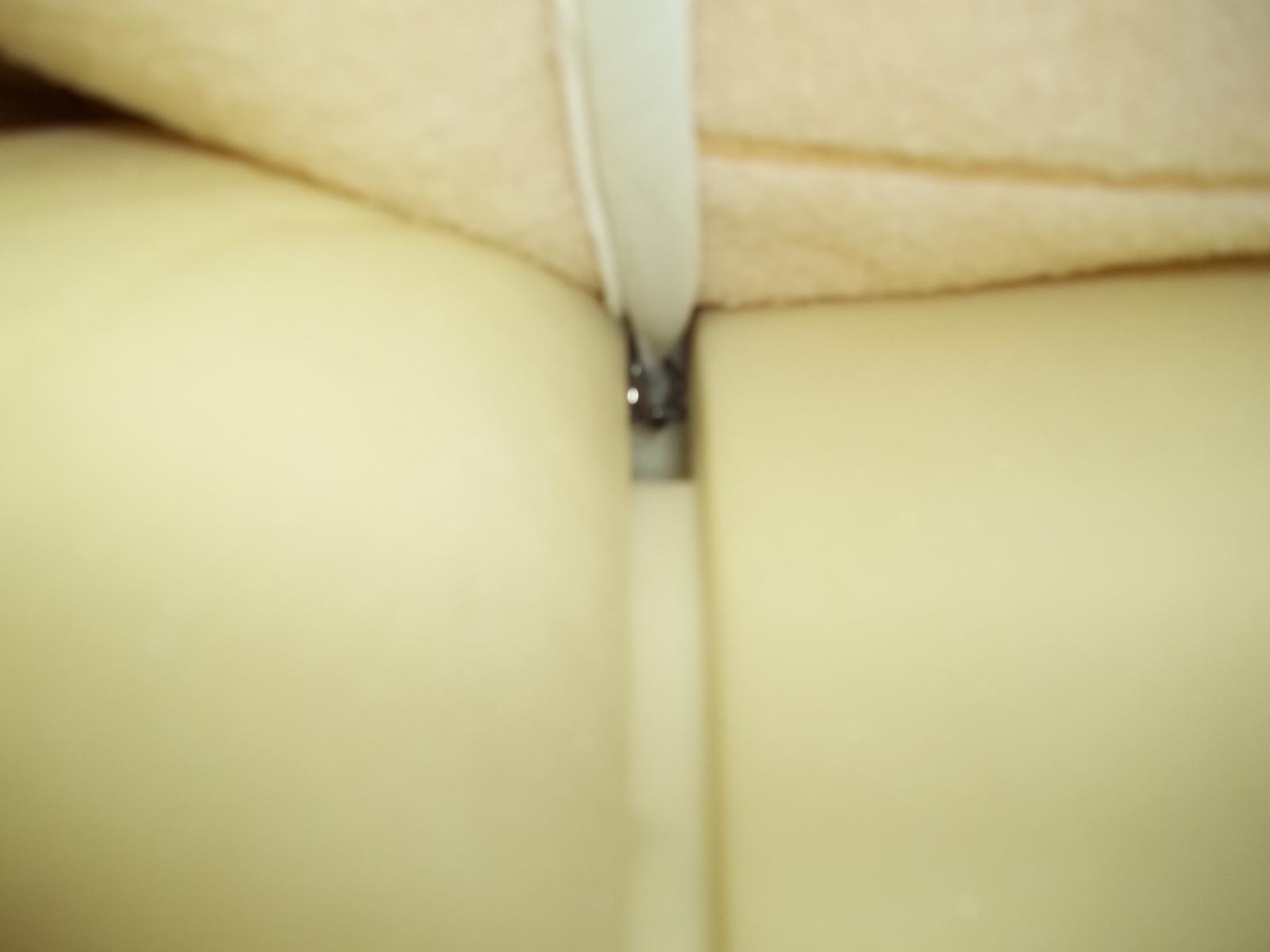

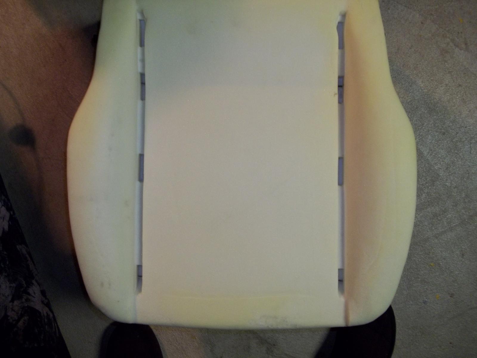

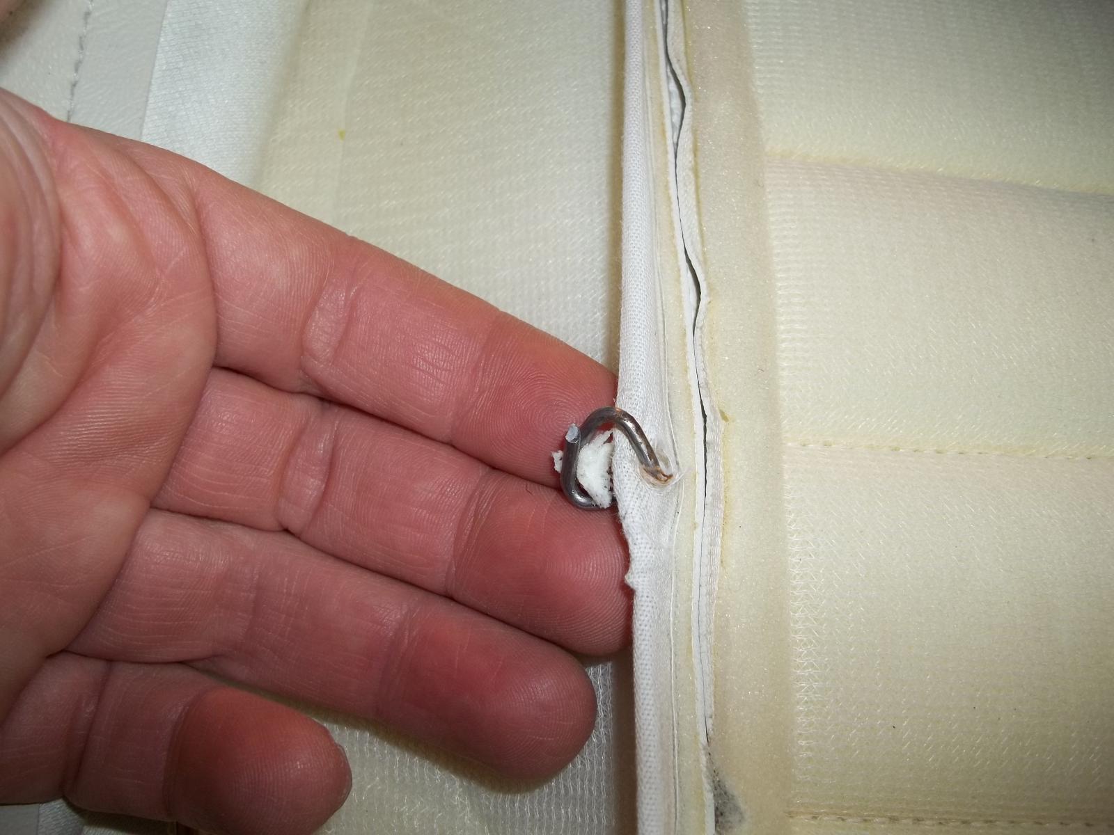

While I am at it here is how the bottom seat covers are attached. I believe the 77-79 use the same seat cover. A little different than previous seats.
In the bottom cushion there are 2 rods that go thru the foam pad.
The seat cover has the wire that must be fished thru around the bottom of the cover just like older style seats. There are also 2 wires that go front to back that must be fished thru the center of the cover in the white sleeves.
You must hog ring those 2 center wires at 4 places and attach them to the 2 wires in the seat pad. That is the most difficult part of the job.
The rest is pretty much self explanatory and just like older style seat covers.
