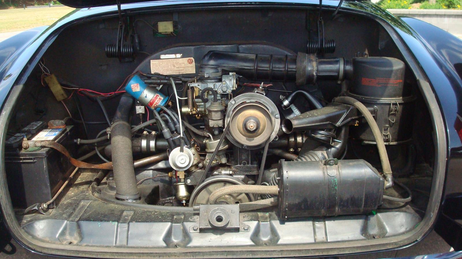

Engine compartment:

Aside from the fresh air hoses coming off the fan shroud, which should be corrugated paper hose, that engine bay is incredibly factory original for '74. Don't see that very often!
One suggestion: please move the fuel filter out of the engine bay. Ideally down beside the trans where the hard line exits the frame horn. They have been known to be the cause of engine bay fires.

Thank you. Yes, the car is very original. Surprisingly so. One of my little projects is to try to replace any of the hoses that look to be 50 years old, and I think it might be all of them.
I'll see if I can find the location you suggest for the filter. I believe there is a hard line in the engine compartment in the feed to the fuel pump on the engine, but I haven't traced it forward of the cooling shroud. Still, there needs to be a connection inside the engine bay because the outlet of the fuel pump is larger in diameter than the inlet on the carburetor. Somehow or another, there has to be a reducer, and it takes two different size hoses. Right now the filter is serving as the reducer, in addition to just being the filter.
One hose that made me scratch my head was the crankcase vent that runs from a nipple adjacent to the oil fill to a nipple on the air intake. It's a plastic hose rather than rubber, and it is in an S shape, but the bends are so sharp that the hose is almost completely kinked off at both ends. That can't be right. (Yes, I know that crankcase venting isn't creating any problems, it's an emissions thing. But still I want this car to be as "right" as I can make it. Remember, I think like an aircraft mechanic.)

I installed one of these brackets on my 69 Ghia.
https://www.thesamba.com/vw/classifieds/detail.php?id=1901747
Its not required, but nice to keep the filter good and secure.
Yes, there should be a fuel hard line in the engine compartment that passes through the tin between the engine and transmission, bends around the fan shroud, and gets close to the inlet on the fuel pump. Then there only has to be a small length of fuel line connecting the hard line and fuel pump. The recommended filter location is in front of the hardline, next to the transmission.
One thing you may want to check is the hard line where it passes through the tin has a rubber grommet to prevent the tin digging a gouge in the hard line from vibration. If there is no grommet, a lot of people use a short piece of fuel line, cut it open lengthwise, wrap it around the hard line, then shove it into the tin opening. That serves as a rubber grommet.
A stock fuel pump and stock carburetor use the same size fuel line, a reducer should not be needed. I can't tell what fuel pump is installed from the photo, but something isn't right if the same fuel line won't fit between the fuel pump and carburetor.
This crankcase vent hose? This is a 74 I used to own. If you search through the more original '74 models on Bring a Trailer, you'll find a similar looking vent hose.
This pic is on an older car with swing axles (you've got CV axles on your 74) but this is the general location where you want the fuel filter, beside the transmission.
So that this doesn't happen
If you need a reducer for the the fuel pump, then you have the wrong fuel pump. It's probably an inexpensive aftermarket pump. If you want the original German Pierburg pump, you can buy immaculately restored ones from Bill at sparxwerks.com. Bill can also rebuild your distributor if you ever think you need it done. And if you feel like your carb ever needs rebuilding, Tim at volkzbitz.com is your guy.
