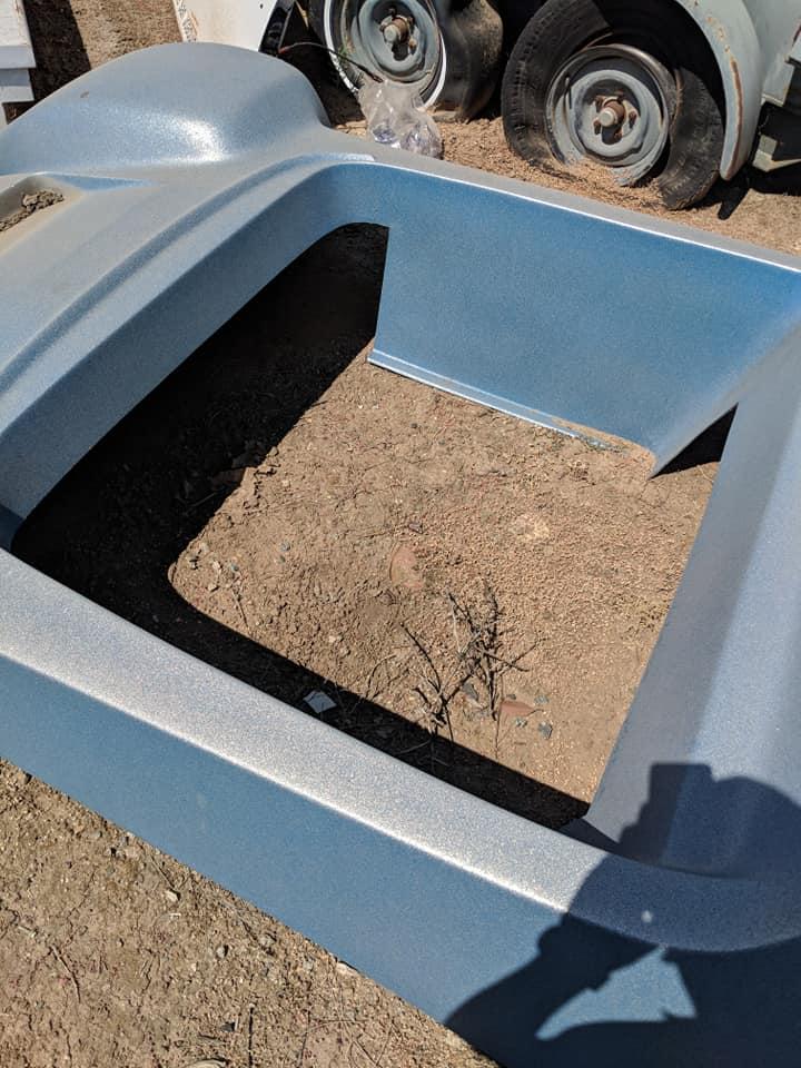

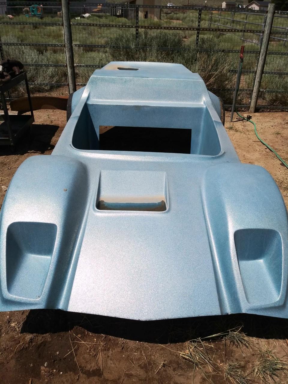

I am going to pick a Buggy body next week, Does anybody by chance know the manufacture and when it may have been made?

PostPosted: Fri Aug 02, 2019 7:12 pm    Post subject: Re: Can-Am style Fiberglass body Reply with quote
Doesn't look like a traditional buggy body as it doesn't have a formed flange to follow the VW pan. Still, I like it - very unusual. I'd be very tempted to put that on a tube frame and mid-engine it.

PostPosted: Fri Aug 02, 2019 8:26 pm    Post subject: Re: Can-Am style Fiberglass body Reply with quote
The last picture does show a chassis mounting flange for the cockpit section. Makes me think there might be others we can't see in these pictures.
Fitting a windshield will be interesting.

I intend to make a frame for it, I will have a very limited budget because of unexpected retirement Medical. but I have a 75 Bus drive train 1.8L and automatic I dont think there is enough room from the rear firewall and the fender flares for a mid eng if there is then maybe a 914 trans
this was sent to me, after i get it I will know more
about 11'10" from front of nose to back
about 6'10" 82" wheelbase from center of wheel to center of wheel front to back
about 5'6" side to side at widest point of fender flare

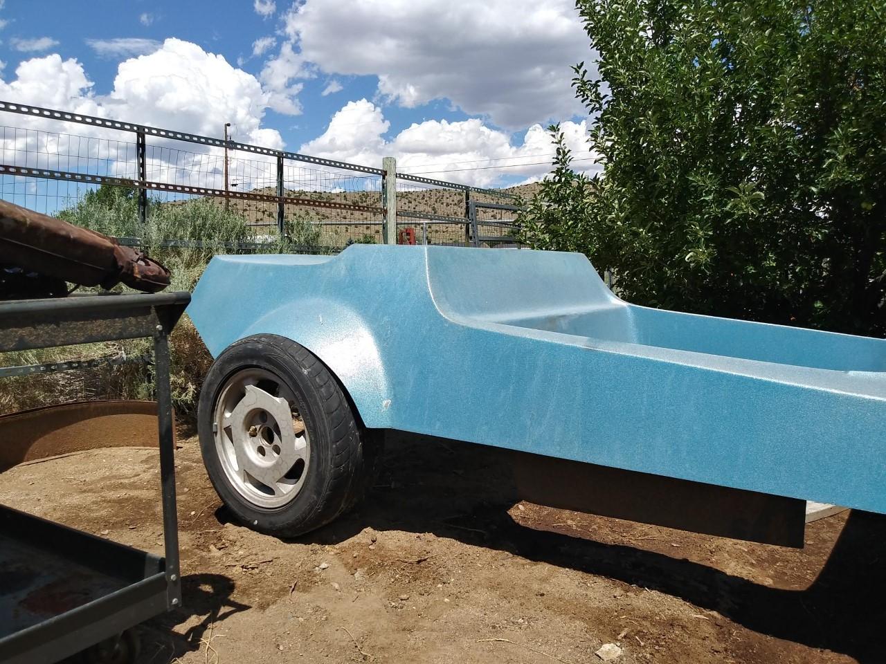

PostPosted: Wed Aug 07, 2019 1:48 pm    Post subject: Re: Can-Am style Fiberglass body Reply with quote

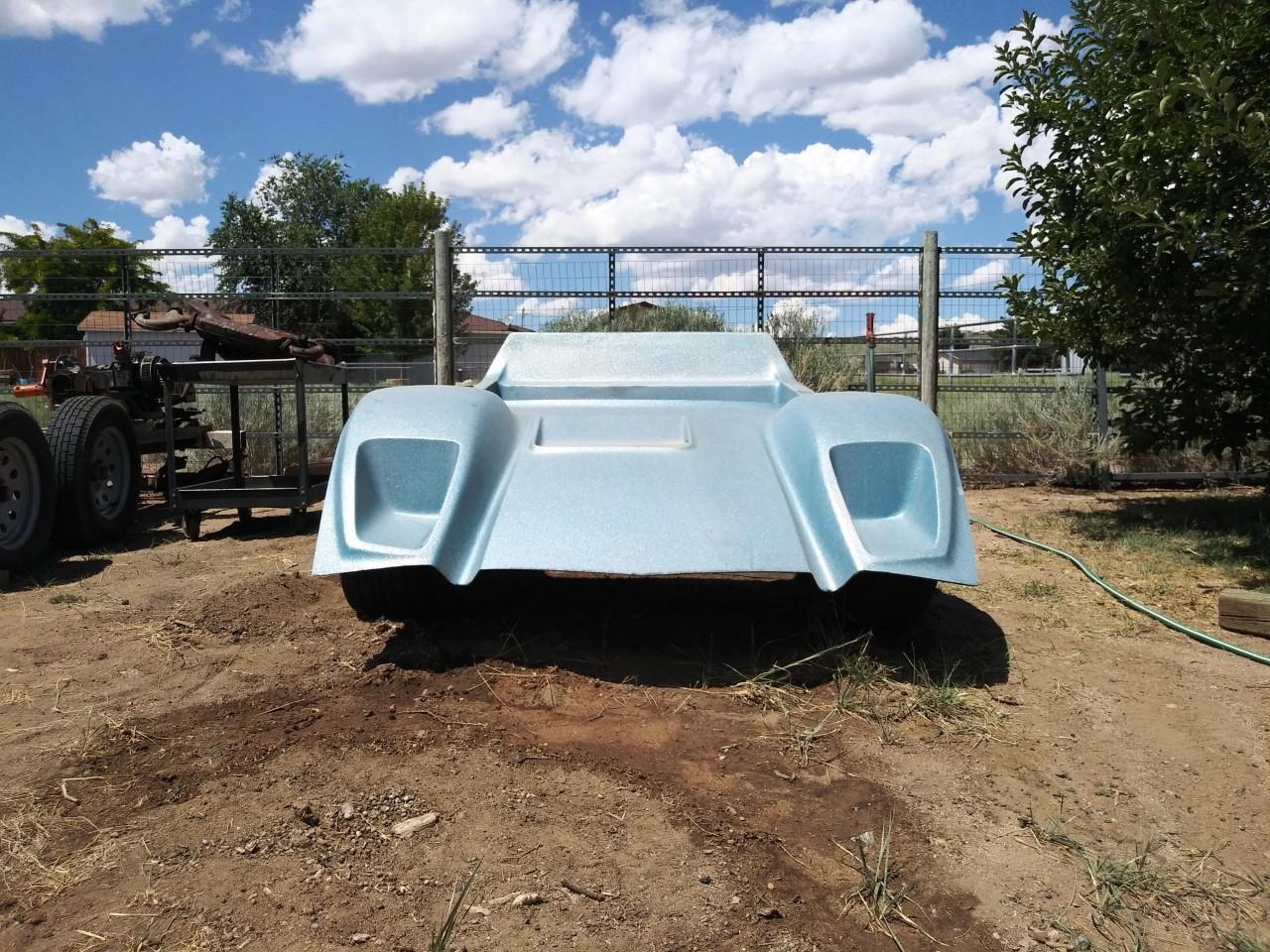

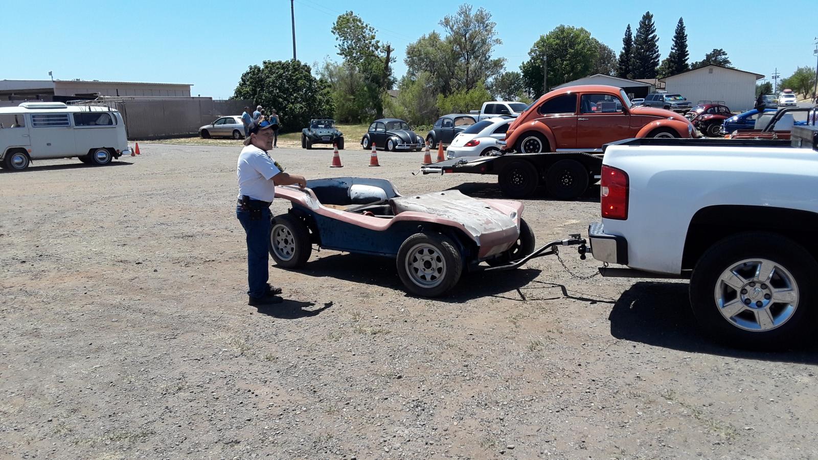

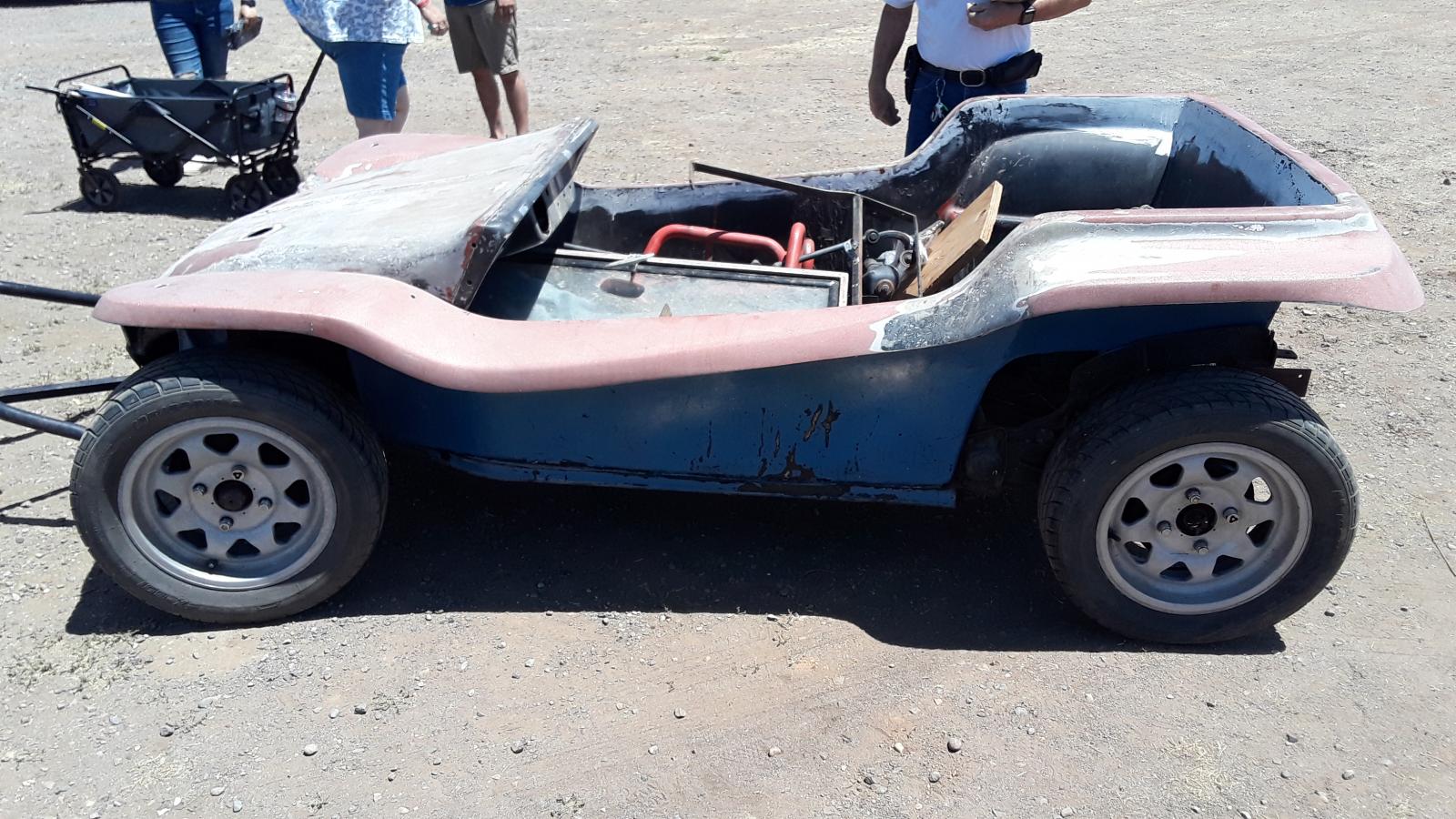

Got the Body home and now have a new perspective about it, has a funny car look after seeing it up close, I put my 88 Corvette wheels under it 255-50-16 bring it into focus no matter it will by made into a street / autocross. It may have room for a two seat layout but i'm looking at a single seat. mid engine layout may be possible but will require a big expense for a transaxle and setup,as you can see in the pics i will have to make more mounting pads, all it has right now is just the two in the center

PostPosted: Thu Aug 08, 2019 5:27 am    Post subject: Re: Can-Am style Fiberglass body Reply with quote
^ Nicely done! Never seen one or heard of one. I'd like to see some finish work under the nose and on the sides, but other than that it's cool!

PostPosted: Thu Aug 08, 2019 5:52 am    Post subject: Re: Can-Am style Fiberglass body Reply with quote
It is begging for a bumper or something to soften the edges on the front.

PostPosted: Thu Aug 08, 2019 6:51 am    Post subject: Re: Can-Am style Fiberglass body Reply with quote
I more than agree. It does seems like it needs lower body panels like the Sterling. And something in the front as well.

PostPosted: Thu Aug 08, 2019 7:30 am    Post subject: Re: Can-Am style Fiberglass body Reply with quote
I thank you for the info. Funny I have a horse named Pegasus also. as i said i will be using the type 4 running gear that i have. i will get more pics of it today sometime. this will be setting for some time as I have to get a lot of other honey dues to finished first, including a 73 super Baja for the wife.

I agree this is what i plan on doing with it along this style

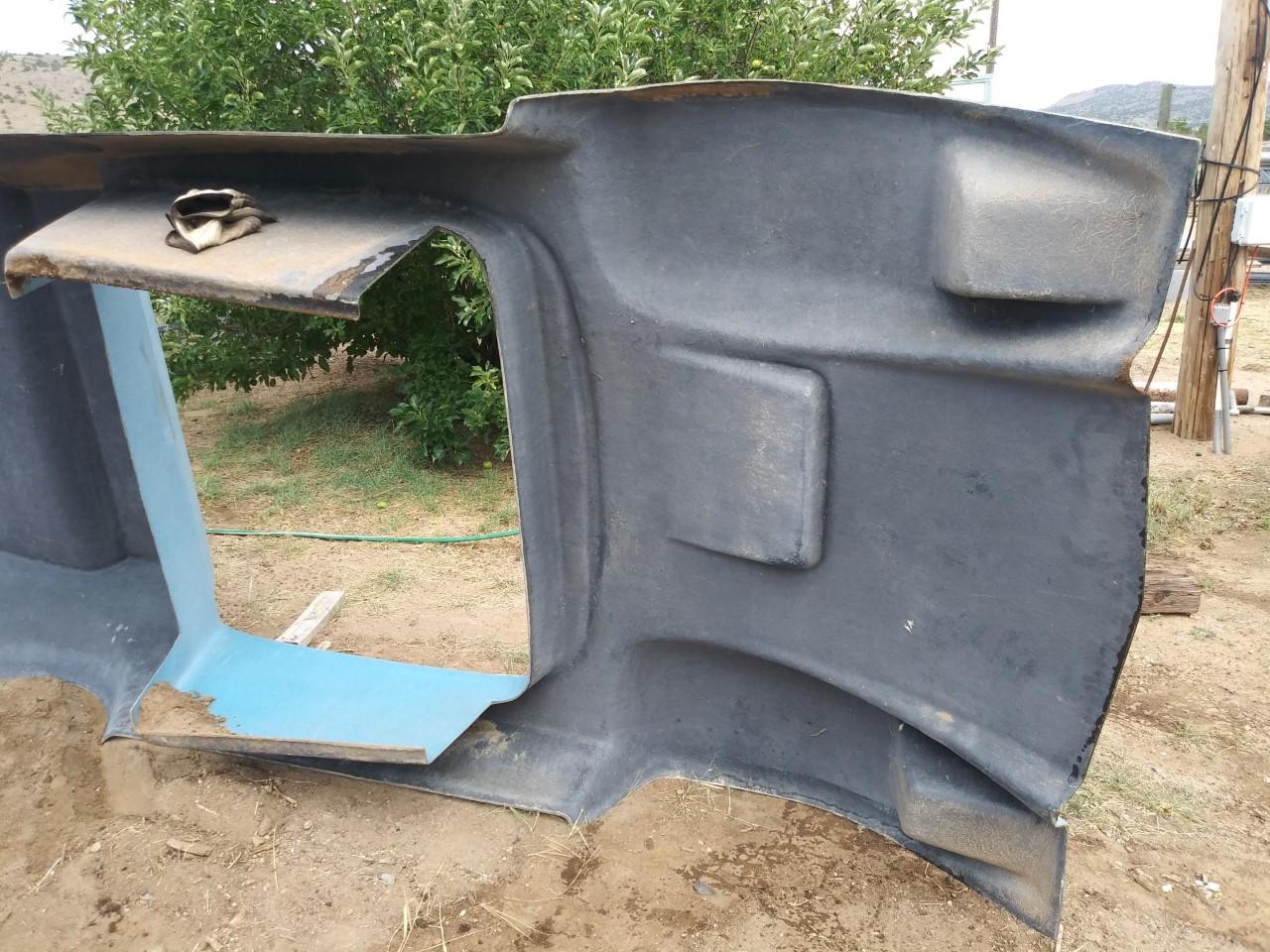

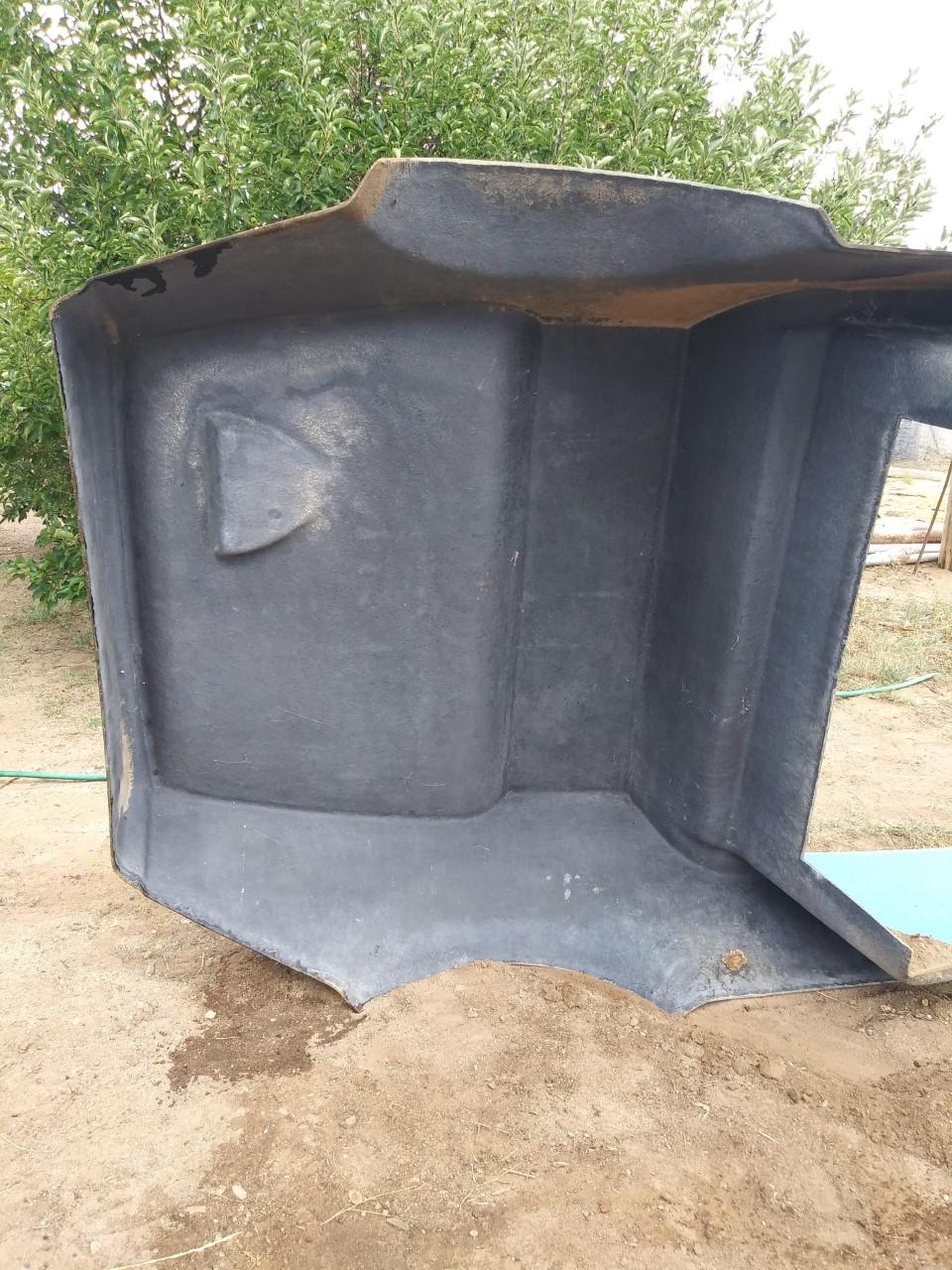

some underside photos, only mounting in in the center

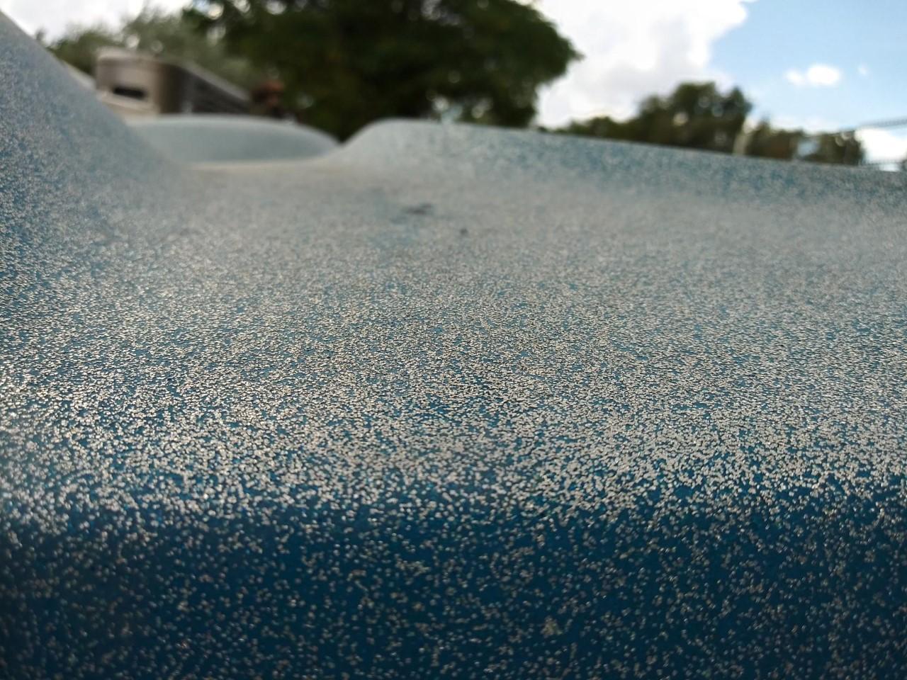

No ID tags or numbers on it. the finish gel coat is dead surface is like sand paper
BL3Manx
Joined: August 29, 2006
Posts: 6768
Location: Northern California
BL3Manx is offline
PostPosted: Fri Aug 09, 2019 5:17 am    Post subject: Re: Can-Am style Fiberglass body Reply with quote
You can see in this picture from the Pegasus article that the forward end of the prototype inner "tub"had a pretty much standard glass buggy tub type bulkhead above the Admiral's hat and on both inner fender walls
The reason that its missing from yours is that your body (like pretty much all buggy bodies) was molded in one piece. On other buggies the hood and dash are separate moldings. On your body they molded the hood and dash as part of the body. That made a more rigid structure, however it would have made it physically impossible to also mold the tub's forward bulkhead at the same time.
When you mold a fiberglass buggy body, the mold is usually one big piece. The mold sits upside down and the wet fiberglass is lain in it and allowed to cure, then its lifted straight up and out. If the one piece Pegasus mold also included the forward bulkhead under the dash, the body would be locked into the mold.
I believe the plan with the Pegasus was to mold the forward bulkhead as a separate piece then bond/fiberglass it onto the main body. You can actually see the vertical seam on the left in the picture.
I recommend you find a real cheap, non-running, old beat up, short wheelbase dune buggy, use its chassis and running gear as your basis then cut that forward bulkhead piece off the junk body and bond it to your Pegasus body. They were all originally molded off the Meyers Manx so any one you find would work
