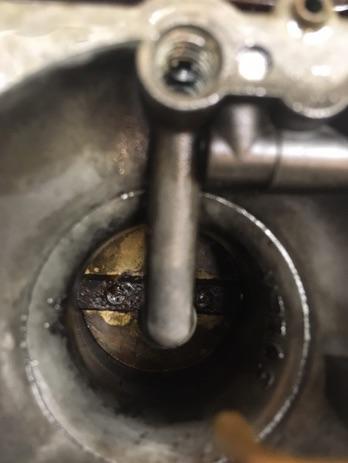

First Update. I wanna' try some of the other solutions offered, but for now...
So I removed the carb. I pulled the top off and took a few things apart and cleaned them (I circled them in the diagram). When I put it all back together it didn't seem a whole lot better; maybe slightly. One thing I did note when setting the idle again was that the bypass screw seems incredibly sensitive. I swear I saw a change in RPM's by just pushing on it with the screwdriver (as opposed to turning it in or out). I didn't fully remove the bypass screw when I had the carb off the car. Looking back, I should have Embarassed
Upon reviewing my carb diagram, it looks like there's a rubber o-ring on the bypass screw. Is that correct? If that o-ring was wonky, could that give me my erratic idle and stop sign stall?
And finally, I road tested it and although the idle did drop a lot as I engaged the clutch and came to a stop...it didn't stall (it sounded like it was gonna' though).
How about that corrosion on the lower butterfly valve? That can't be good. Confused
Almost forgot. I'm not sure when the carb was last rebuilt. The previous owner had no idea. I think it would be safe to say a looooong time. Sad

PostPosted: Tue Aug 28, 2018 6:04 am    Post subject: Re: Stalls Coming To A Stop (Intermittent) Reply with quote
Did you pull these parts and flush them and their openings with carb cleaner? Specifically the idle pilot jet (34). When the small hose in this jet gets clogged it directly affects idle.
When you removed the top did you check the fuel level in the bowl? Was it the correct height?
Yes there is an o-ring on the bypass (13) and the volume (1Cool screws. If these are worn they will allow air to pass into the carb and impact a smooth idle. You should be able to remove either while the carb is on the car to replace the o-ring. Be sure to flush out the openings in the carb to clean out any dirt or o-ring pieces before reinstalling.
Did you run the tests I suggested to isolate the problem to dropping from high rpms to low or a deceleration related problem.
FYI, there was someone else with an electrical problem that pulled current away from the carb when the brake lights turned ON. The idle would drop because the coil voltage dropped dangerously low anytime the brakes lights went ON.
Not good, but common. If it has spread into the throttle shaft bores it will lead to faster deterioration of the throttle bores.
If you are worried the rust will impact the air flow... it is probably negligible.

Here's a popular diagram showing the inner workings.
I think you found your problem. Those little o-rings cause so much grief.
My Build: '69 Baja - Dark Earth Version
~I'm almost done. I just lack finishing up.~ Anxious
Grug
Joined: January 25, 2015
Posts: 176
Location: Bridgewater, NS
Grug is offline
PostPosted: Wed Aug 29, 2018 12:56 pm    Post subject: Re: Stalls Coming To A Stop (Intermittent) Reply with quote
That 'slice' look like it might be enough to give me idling grief? Think It's not all the way through the ring, but I did easily notice it upon close examination.
It's interesting that the diagram you included lists the 'Idle Air Mixture Regulating Screw'. I've been calling it the 'Volume Control Screw' as I thought it had very little to do with idling Confused
