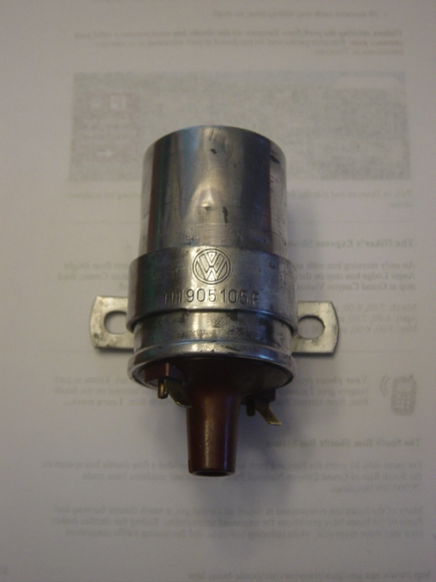

The GL coil has an aluminum jacket and is a tad wider than the Bosch coils. The bracket is unusual and sought after because it has a VW logo and part number emblazend upon it.
The coil is 6v and has the GL logo on the bakelite.

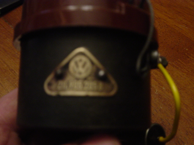

Here are a couple of pics of the non vacuum or mechnical advance distributor that Garbe Lahmeyer produced. The J likely came after the earlier vacuum versions but I am not sure yet what the advance curve looks like. I have been rebuilding distributors for a few years now and I have only seen two of these.

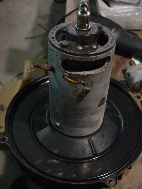

This is the GL generator that I suspected existed. It appears very similar to the Bosch counterpart. There are likely many more lurking about that are assumed to be Bosch. Note the VW symbol lower left and the GL symbol upper center in the bottom pic.
sorry for the blurry image it's the best I could get with the camera.

Here is an interesting Garbe-Lahmeyer item:
This is a mechanical advance distributor manufactured by GL in December 1955. that should end the "VW used them in the mid 60's" assertions.
Interesting features include the badge which is gold in color. The cap clips which are a true spring with no hinge. The end of the spring sits in a small hole in the housing. The lack of a spring clip to hold the drive dog pin in place. It used the same cap, points and rotor throughout production. The condenser has changed periodicaly being mounted in different locations on the housing.
How much is this coil worth? Couldn't find any for sale in the classifieds. One came on a used 40hp I picked up to stick in my '64 Beetle, but the car has already been converted to 12v. I was thinking about swapping over the bracket to a 12v coil. But if the coil and bracket are a matched set, I might be better off saving it for another project.

The GL coil is probably not worth any more than its Bosch counterpart IMHO. The coil and bracket are a little wider diameter than Bosch so the bracket may not hold a Bosch coil tight enough.
