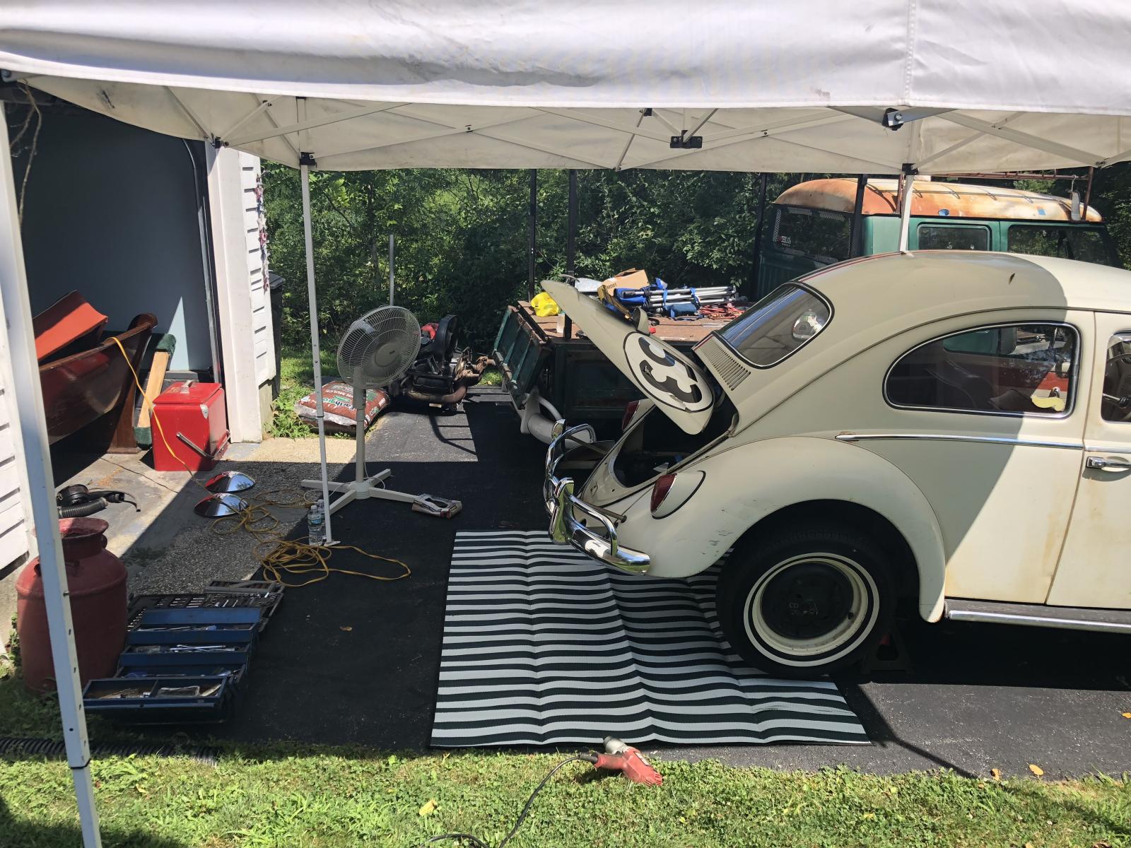

The car got rear-ended two weeks ago. Thankfully the tub is OK. The rear bumper is bent, along with the over riders, and the mounting bars. The engine lid pushed into the generator, which is now locked up.
Insurance was out to see the car, and it was decided that because of the fender needing replacement along with the decklid that they can't paint blend and will be painting the whole car.
It is at a shop and I dismantled most of the exterior already. 4 fenders are off, glass is out (except the door windows which I'll get to) and I removed the lights, trim, etc.
I'll be asking for help and photos on how to do some stuff along the way but for now can anyone help me by telling me how to get the interior door handle and window crank off? LOL
Photos of the car to follow.

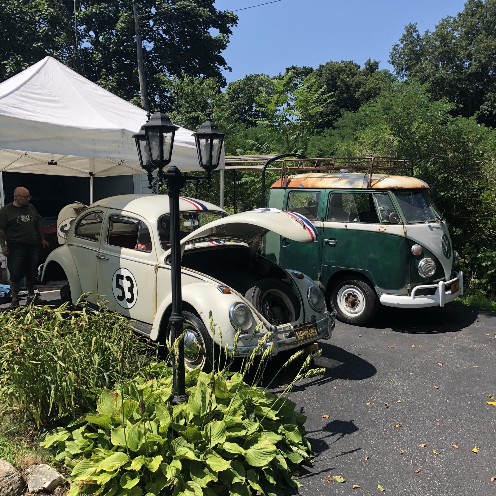

So, as a follow up a few weeks back my 64 was rear-ended by a Jeep Wrangler.
I was pretty fortunate, and impressed at how well the bug actually took the hit without as much damage as I expected. The engine lid and light housing took the brunt of the hit, along with the passenger rear side of the bumper, fender, tail light. Additionally, the rear shocks broke loose of the bolts (the rubber grommets tore out) and generator locked up.
I had the car towed home, and after trying to start the car I realized the pulley wasn't moving. I popped off the belt and tried to fire up the car. It started right up and sounded like it's usual self.
I tried chasing the insurance company to work on the repairs but ultimately brought it to a shop near home who is known for working on old cars. Their business is body and they have a big following with the local hobby.
Bob over at BelAir Auto Collision in Commack, NY really took care of me.
Hagerty sent an appraiser out to see the car, and together with Bob they went over the car. Because the car was original paint, and a color-match and blend would be nearly impossible Hagerty agreed to paint the car!
Bob let me go in to dismantle the car. I removed the fenders, lights, engine lid, windows, hood and all to save on some labor and allow the most amount of money from insurance to go to painting the car.
They got the car stropped down 90% - they still need to do the front hood and quarters - but it's down to bare metal and in surprisingly solid shape. Five of the captive nuts broke free in the wheel wells and they'll get replaced and welded in.

I have all new rubbers, pearl white fender bead, seals and window trim for the car. I replaced the front fenders and rear decklid with those from a 63 for that earlier look.
I know putting Herbie decals on a bug is rather cliche, and looked down upon by the VW Gods, but I am seriously contemplating puting them back on. I spent so many years with a bright green bus, and now having a plain white Beetle seems so generic. I love the reaction the car got from kids and even adults who ran up to it to take a photo.
