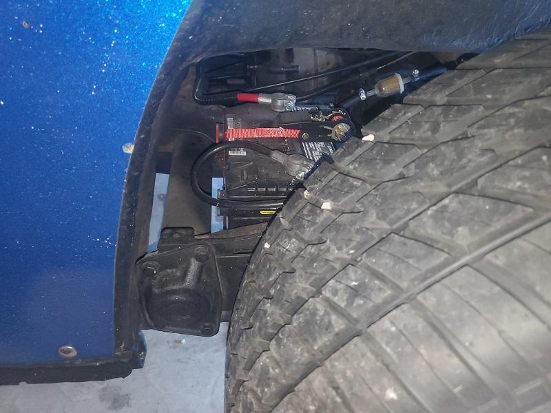

The battery is sitting on the pan behind the right rear wheel; outside of the body. It appears the only way to access it is to jack it up and remove the tire and then pulling it over the axle. I'm hoping when I get it to the body shop I can get them to either make an access point behind the passenger seat or build a battery well behind the passenger seat. Looking for suggestions on which would be the preferred course of action. Thanks.

That's a wild color! My buggy came with the battery trapped like that also. There's absolutely no way to get it out without removing the tire, like you I was concerned I should change it. After some years owning it, in practice it has turned out to be a non issue. It's super easy to put jumper cables or a charger on, and the cables are tidy being so close to the starter. I've come to like it this way.

Thanks for the feedback. It's one of those things that really isn't an issue (yet), I'm just anticipating possible problems. I'll leave it be for awhile. The color wasn't a big deal to me. It's unique, but my preference is a candy apple red. I've always wanted either a red or blue buggy. I'm more partial to the red. I've got a soft top on the way.
